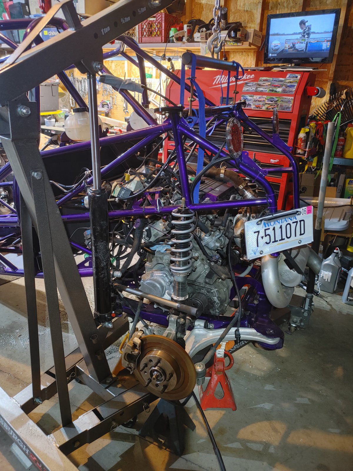

I think you are going to have to remove the engine the same way it came out, through the bottom, engine, trans, and subframe. You should be able to remove the axels and leave the suspension though.
You might be able to pull just the engine... it is real tight in the DF frame. You might have to lower the subframe 4" to give you more room, but you can leave the clutch, transmission cables etc, on, and still lower it that much.
In 2020, I replaced my clutch. In 2021, I replaced my transmission, both times I removed the 4 bolts from the rear subframe. I left the rear swingarms and axles on the subframe, and lifted the DF frame up and over the engine. I spent more time draining the coolant, removing the electrical, brakes, clutch and transmission cables.
Sluggonaut
I used that method and found the engine hoist bar from Summit very handy. I agree with Ross that coolant and all the disconnects were more work than separating the subframe/chassis.
I reassembled everything a couple of weeks back and can confirm the rear maintained its alignment using this method.

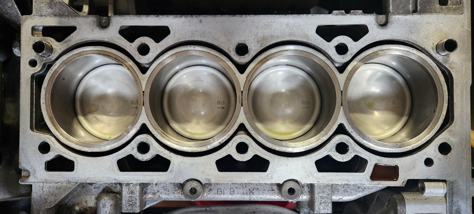

Does anyone know which passages are coolant and which are oil? I'm doing some leak tests since I have the head off again but am not 100% sure where oil and coolant are supposed to go. I know the 10 round are the head bolts.

Just out of curiosity, when you pulled the head off were all 4 cylinders full of coolant?(or even just a little puddle on the piston) or just one or two? and which ones? It would take more research to pin down exactly which intake valves would be open but if the PCV hose was connected to the cooling system, coolant COULD run into the intake tract only and then past any OPEN valves into the cylinders. And with the cams installed and resting in any position, intake valves would only be open to admit coolant into 1 or 2 cylinders. And if the cams were not yet installed, when you put on the head, all valves would have been closed! (A "good" closed intake valve shouldn't let water pass in any big volume, maybe a drip?, but not enough to fill a cylinder.) This is all so curious! and it would be nice to find out HOW this motor is leaking and WHY? And how is it getting into the bellhousing area? (Small Block Chevys had two freeze plugs{the middle one was the butt of the cam not a freeze plug and would leak only oil} on the rear face of the motor and they sometimes rusted and leaked into the bellhousing area, a problem usually only seen on boats.) Now that you have the head off, lay it on the bench upside down with sparkplugs installed and tightened, with the combustion chambers level, fill them with water. They should not leak overnight. A cracked exhaust valve seat will usually leak enough to be noticeable and the water won't be in the exhaust ports but in the water jacket in the head coming out where the large coolant hose is connected to the head on the passenger side/ front of the motor. Cracks in aluminum are hard to detect. I believe machinists use air pressure, a deck plate fixture, liquid dye and black light.
