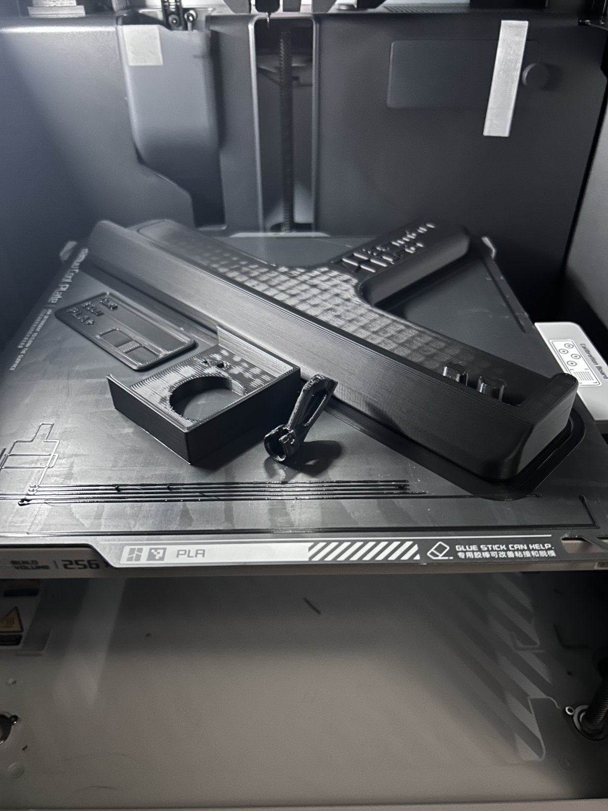

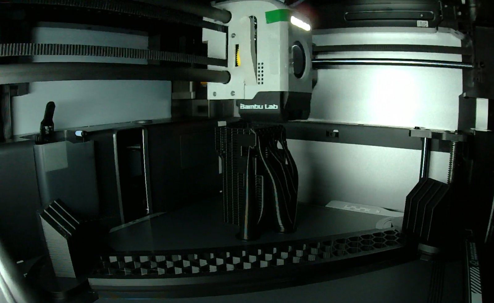

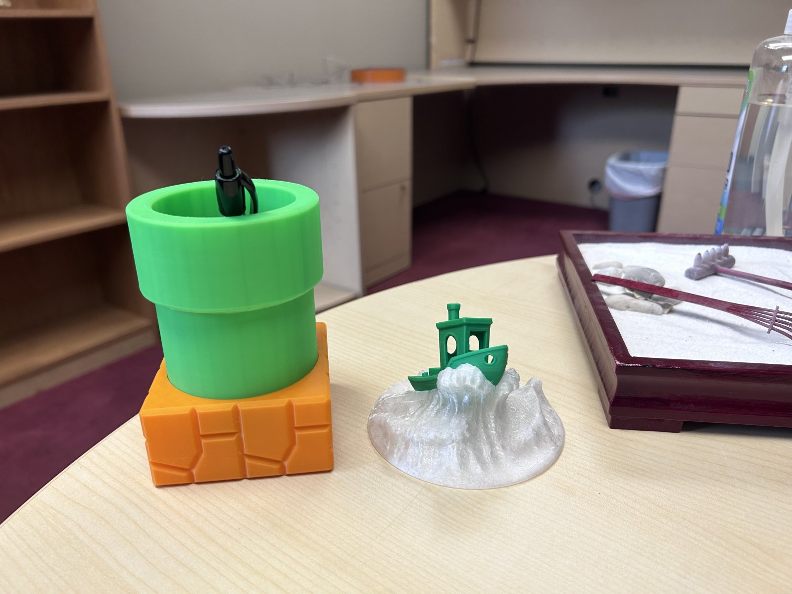

Yeah; this guy has done well even with not a lot of meat against the table. Printed my first items with supports (trees) last night, came out good enough for what they’ll be used for (desiccant holders in the AMS filament holder). I have no idea why bambu would think that plate holder tool needs a raft though...
The bottom of the flare on the Mario pipe didn’t come out great but I’m simply an idiot for not printing it upside down. :cool:

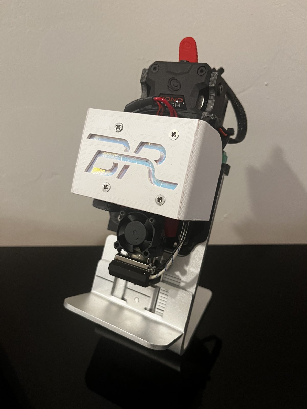

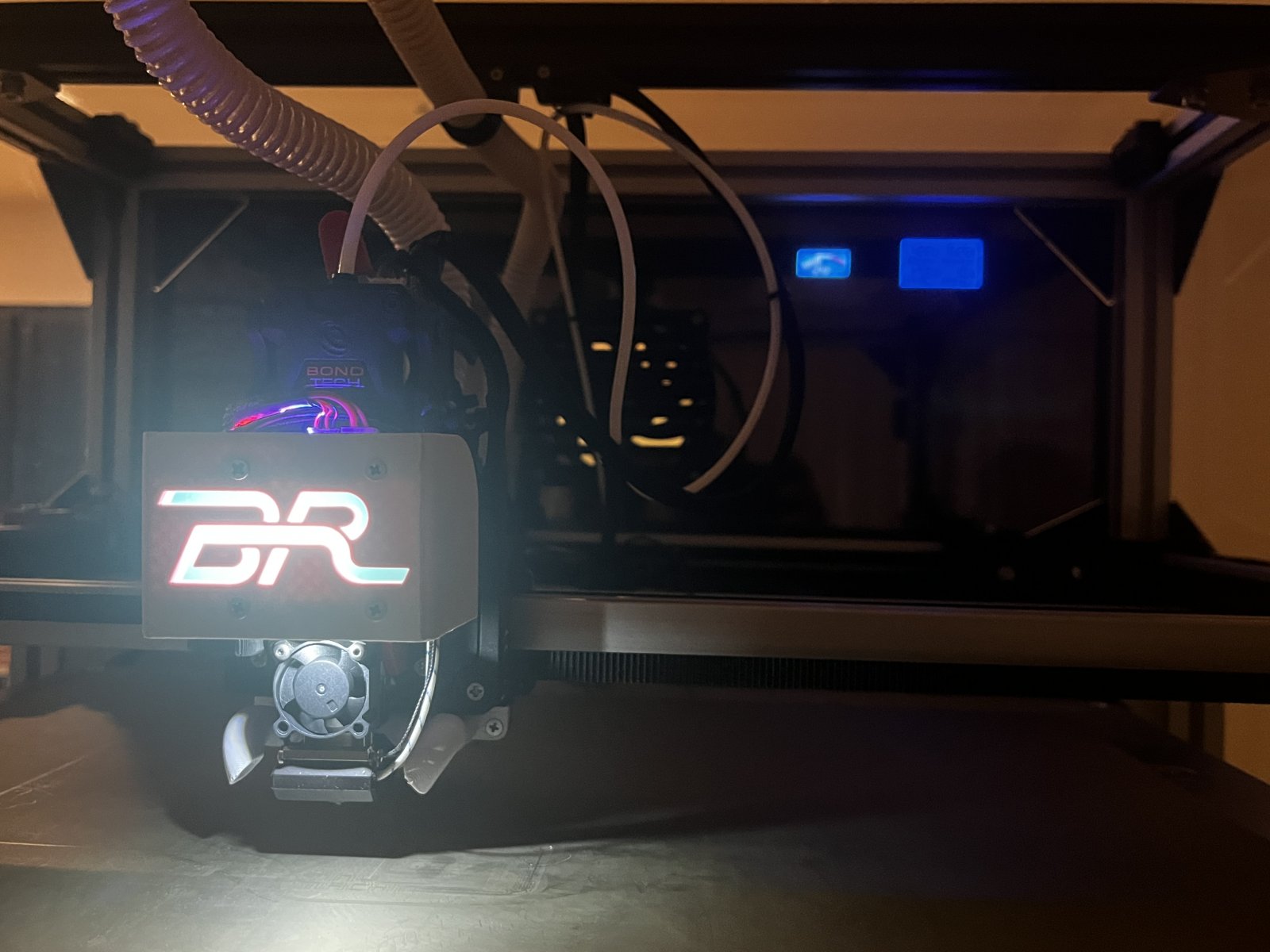

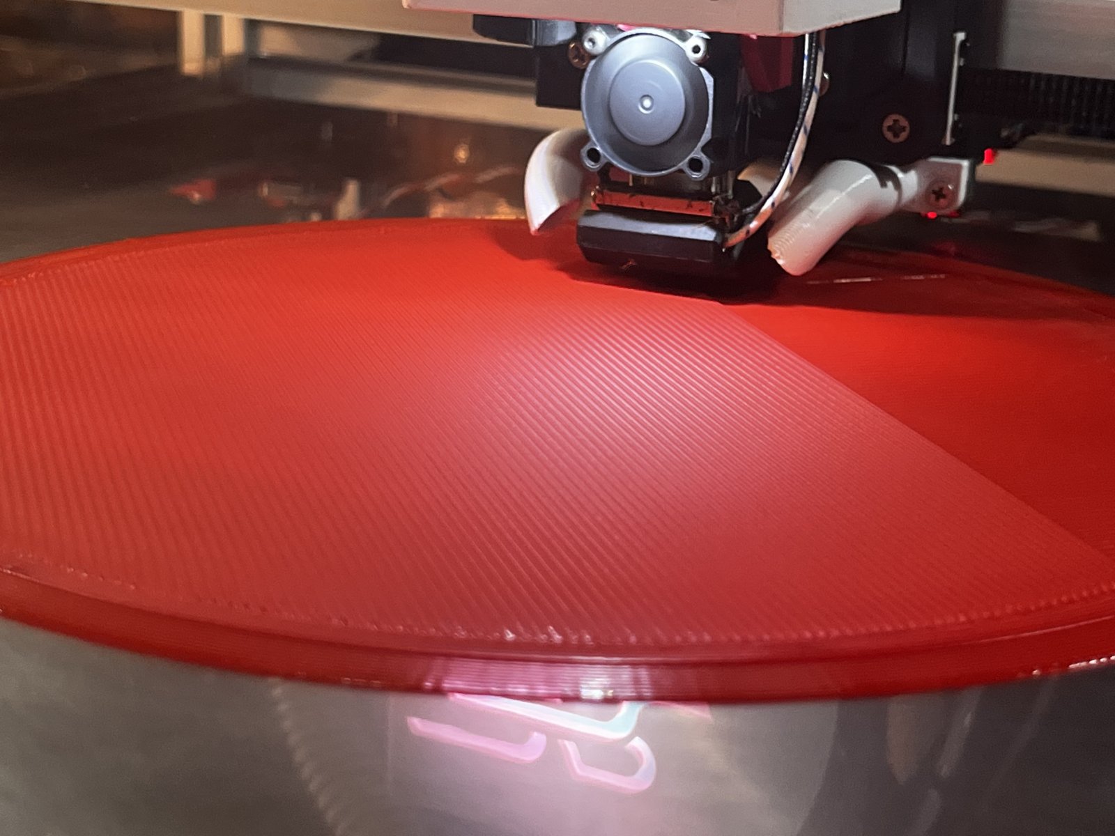

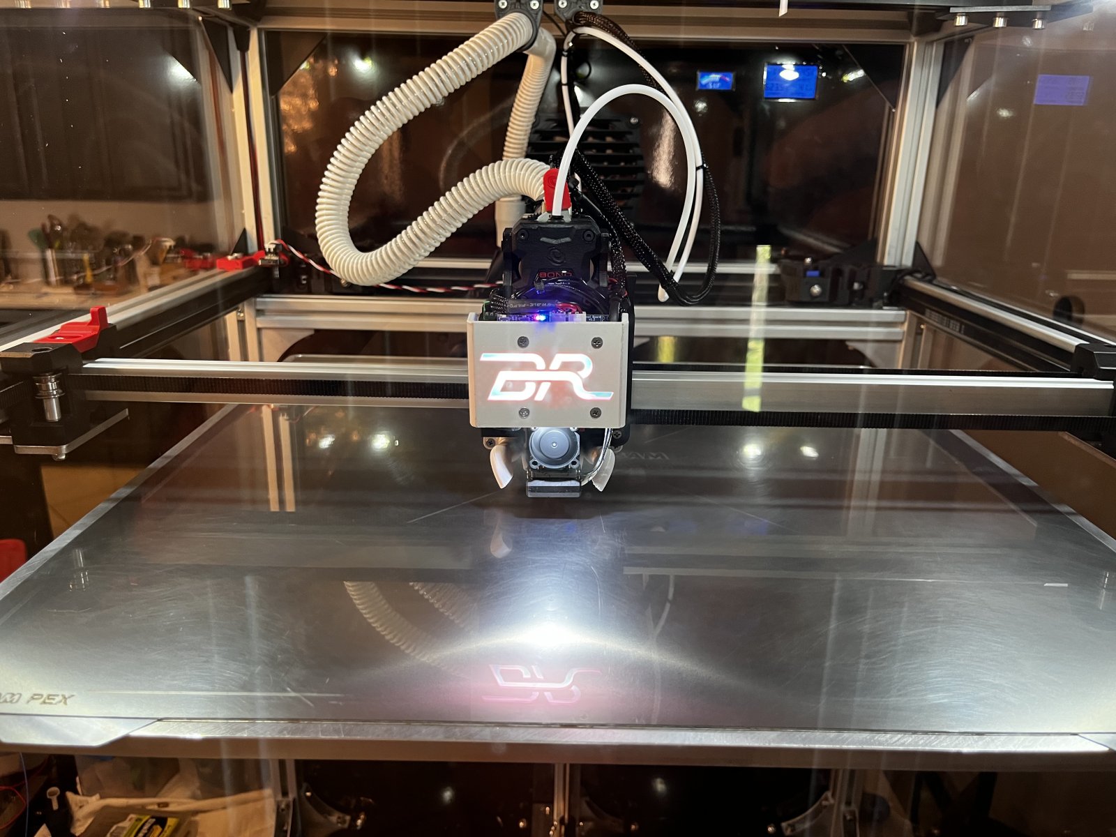

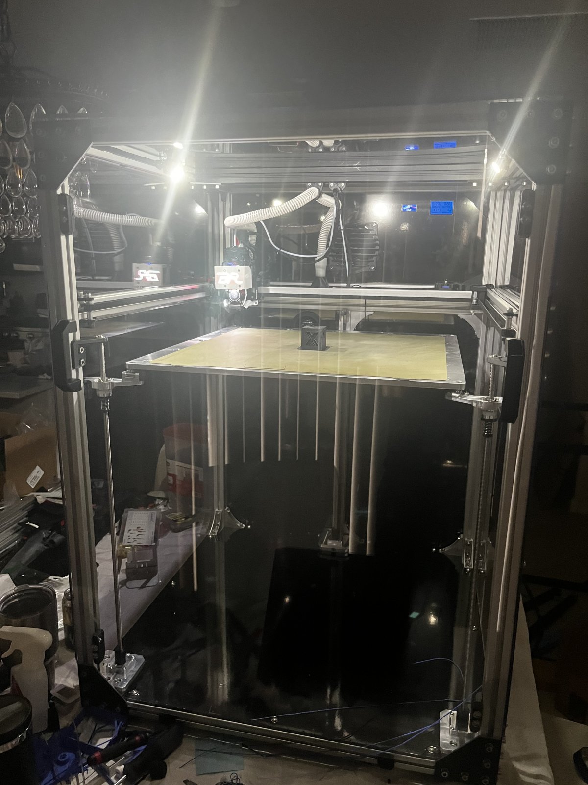

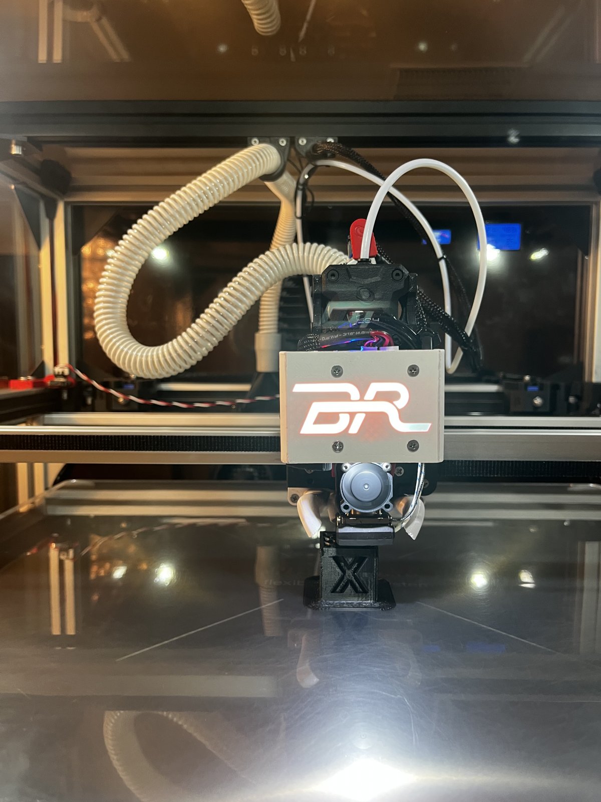

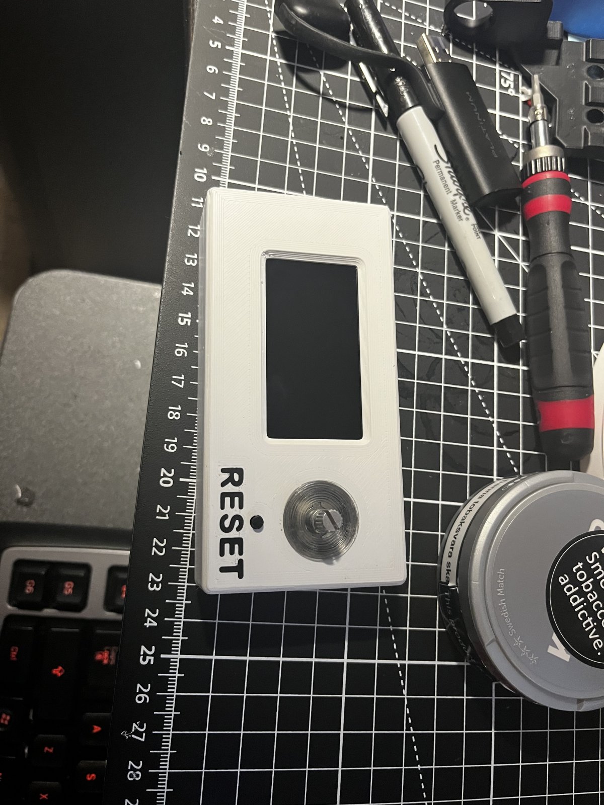

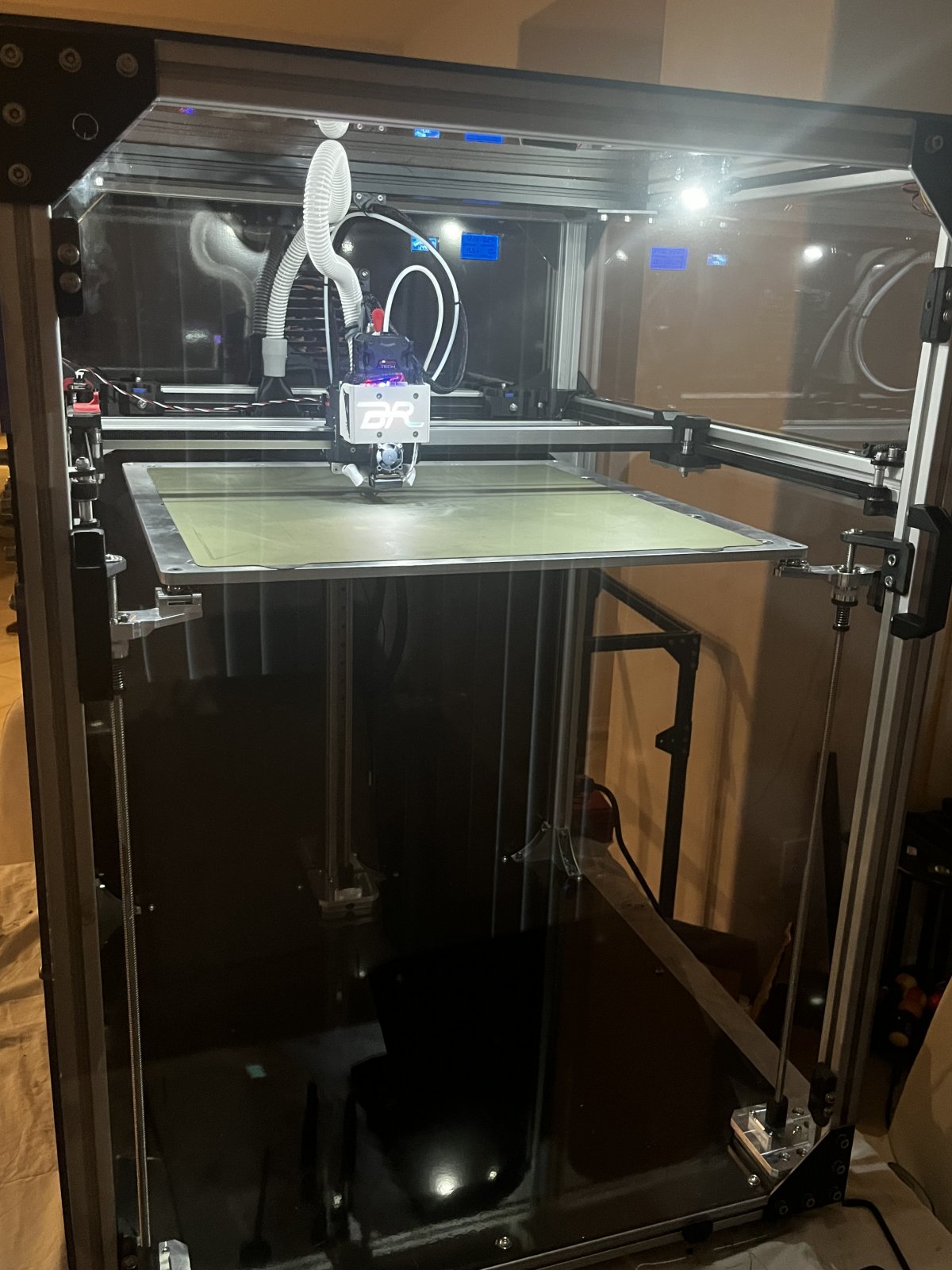

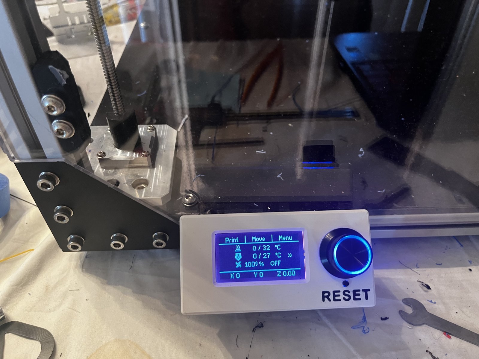

I just finished building/programming my first of 3 500x500mm bed CoreXY printers. These are based on Ratrig original VCore design but I redesigned much of it to improve durability and efficiency. I’m getting +/- .05mm tolerance on .6 nozzle ASA parts. It is printing ASA, PETG, Nylon/NylonCF, PC flawlessly. I personally favor ASA for Goblin parts, due to its UV resistance and strength. I’m running a tool changer setup with custom printheads that I designed, each with their own CAN bus circuitboards, which gives me freedom to design further (with more to come). Amazing technology we have these days!
I still have 2 more identical printers to build, which should be pretty easy, since I’ve already designed all of the parts and written the firmware. I should have all three printers built by the end of summer. By fall, when it cools down, I hope to be back in the garage to finish up my build. Having 3 large 3D printers on demand will make it convenient to quickly print up Goblin part designs during the remainder of the build.

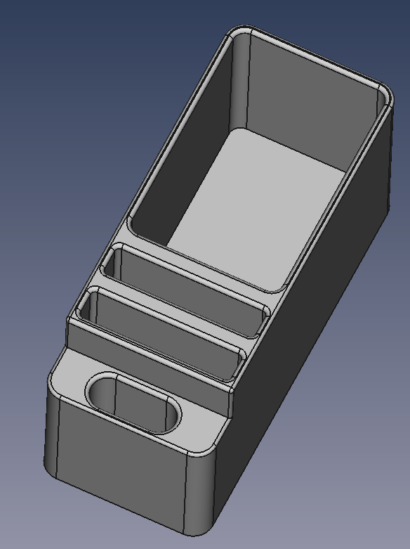

There are a lot of really good designs for printing in this thread. Here is another.

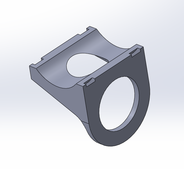

A version of a center console for mounting on the tunnel. This is made for two phones and a key fob with extra room for other stuff.
42601
Here is flat-bottom version of our original design. This works well forward of the shifter on the tunnel cap.
42607

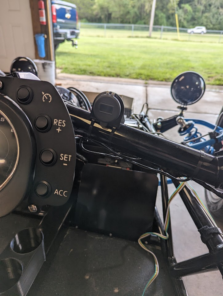

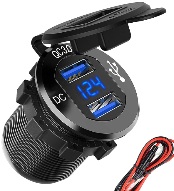

I like your new design. If I were to design one, I might make it to accommodate a USB Power Outlet?
We used one of those and mounted it in the tunnel cap towards the front. It was easier there because I already had the original wiring to the original outlet in there and that was all the farther the wires would reach without having to extend them. Besides, it wasn't something we needed easy and quick access to all the time as we just leave a charge cable plugged into it all the time.
I HIGHLY recommend installing one no matter how you do it. It helps to keep an eye on the battery voltage all the time while sitting to be driven. At least on the circuit we connected to, it's on all the time and anytime I walk by it, I can see the current battery voltage and know if I need to put a trickle charger on it.
