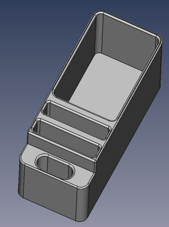

A version of a center console for mounting on the tunnel. This is made for two phones and a key fob with extra room for other stuff.

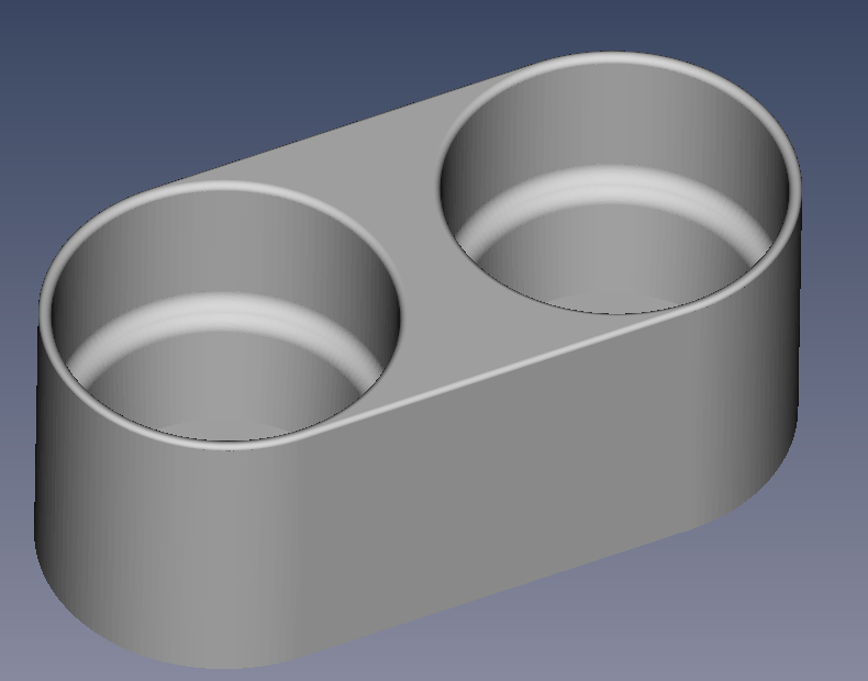

Here is flat-bottom version of our original design. This works well forward of the shifter on the tunnel cap.

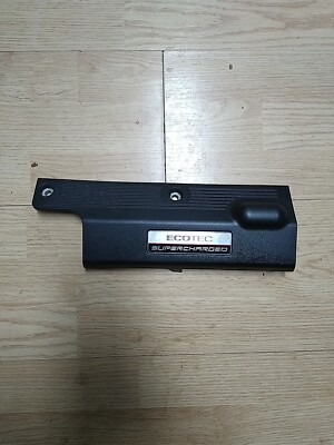

Has anyone a 3d model of the SS fuel rail cover? They are quite expensive. For that money I mill myself one out of aluminum.
I don’t know how well a 3D printed cover will hold up directly mounted to the engine. Maybe printed ABS will work, but I don’t think PETG will work, and definitely wouldn’t trust PLA.
It would also take a printer with a large bed size to fit that part.
Not a fuel rail cover but I have a PC print over my coil packs (mounted directly to the valve cover) and it's held up great for almost 2 years now.

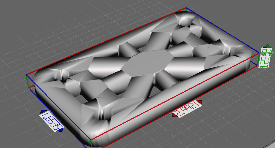

Oh wow! Yea, I can definitely do that instead and it would be much cheaper as well! Do you remember what dimensions of the bar stock you bought and about how long of a piece did you cut?
I used some 1-1/2"x1/4" bar stock I had lying around from a previous project. I think the shortest you can get is 3' from the home improvement stores (Menards/Lowes/Home Depot). I think I cut a piece just short of 3". The printed one is in mm but if you convert it to inches, this is what you get for dimensions from the file:
49034
Even though the bar stock was narrower and slightly thicker, both bolt holes fit within the inch-and-a-half width and at 1/4" thick it still fit in the slot on the back of the pedal. So cut to length, stick it in the pedal to mark the holes, and drill.
Any material would work, I just happened to have steel on hand. Even wood could suffice in a pinch.

I'll post this again here as it might be lost in the build thread where we were talking about it. When printing this extension, you have to pay attention to how you print it as it impacts the structural integrity. The picture indicates you didn't print it with enough walls.
Minimum of 70% infill, 7 walls, 7 top / bottom layers.

I couldn't tell you how it was printed, as I passed the file along and got a part back. I'm not knocking those who use it, but it was cheaper and easier for me to make one out of steel. That picture is the STL file posted in this thread, so if it is insufficient someone with the appropriate skills should update it so it is sufficient for use by others.
