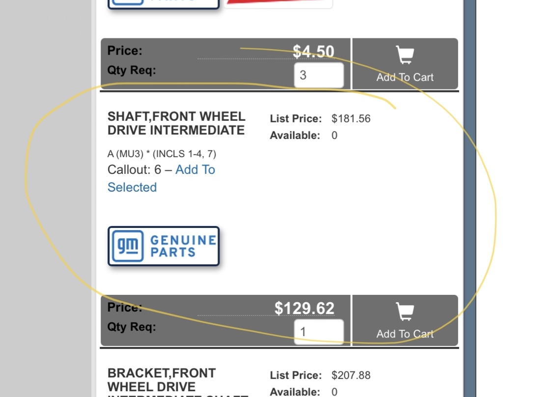

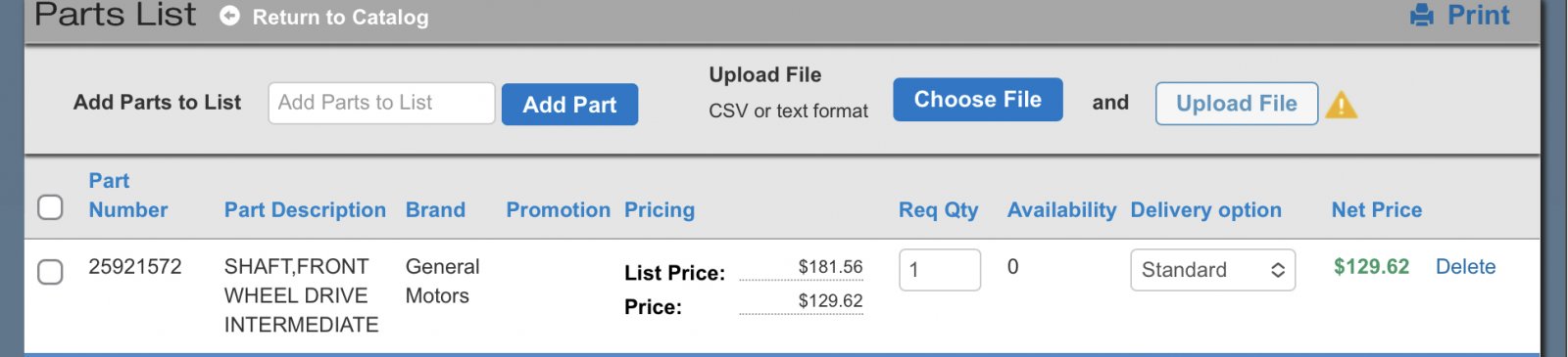

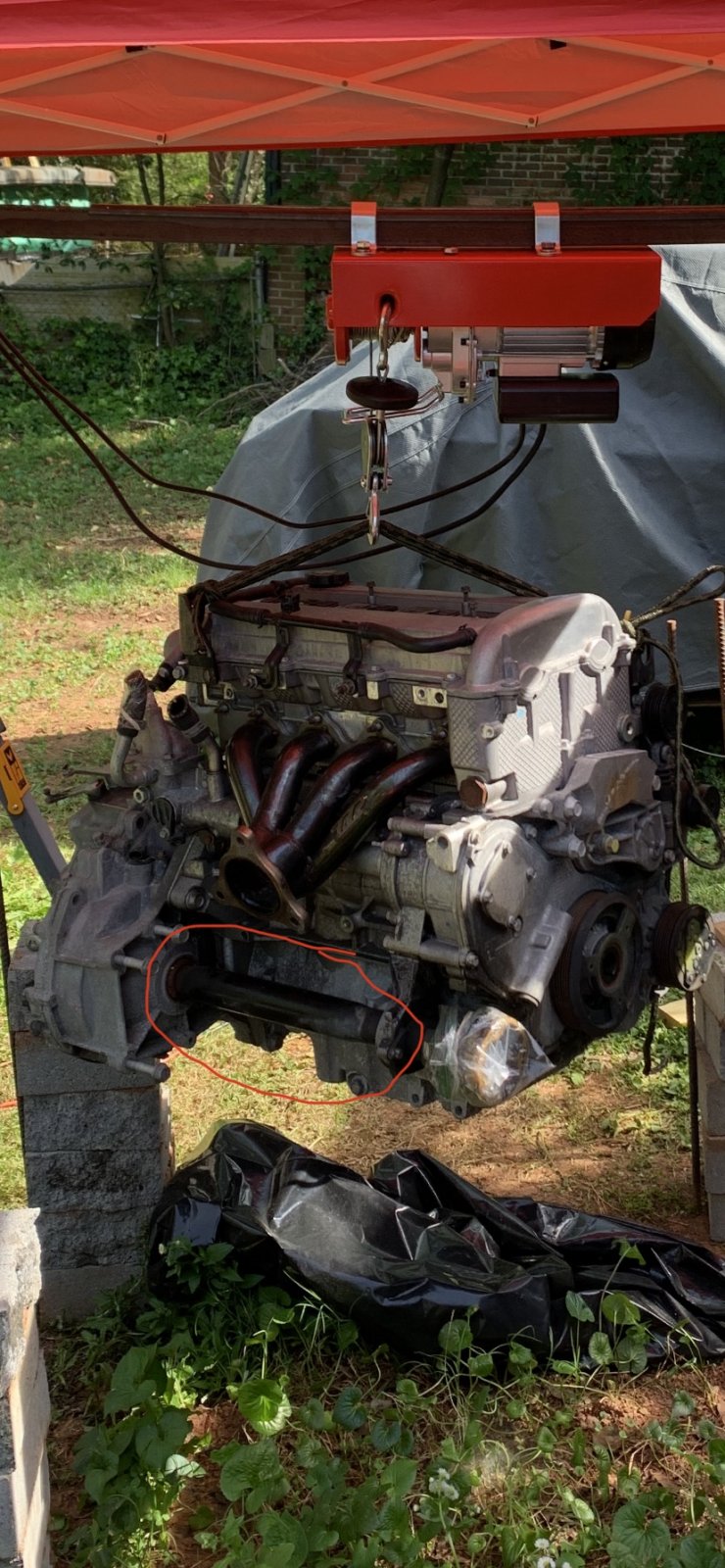

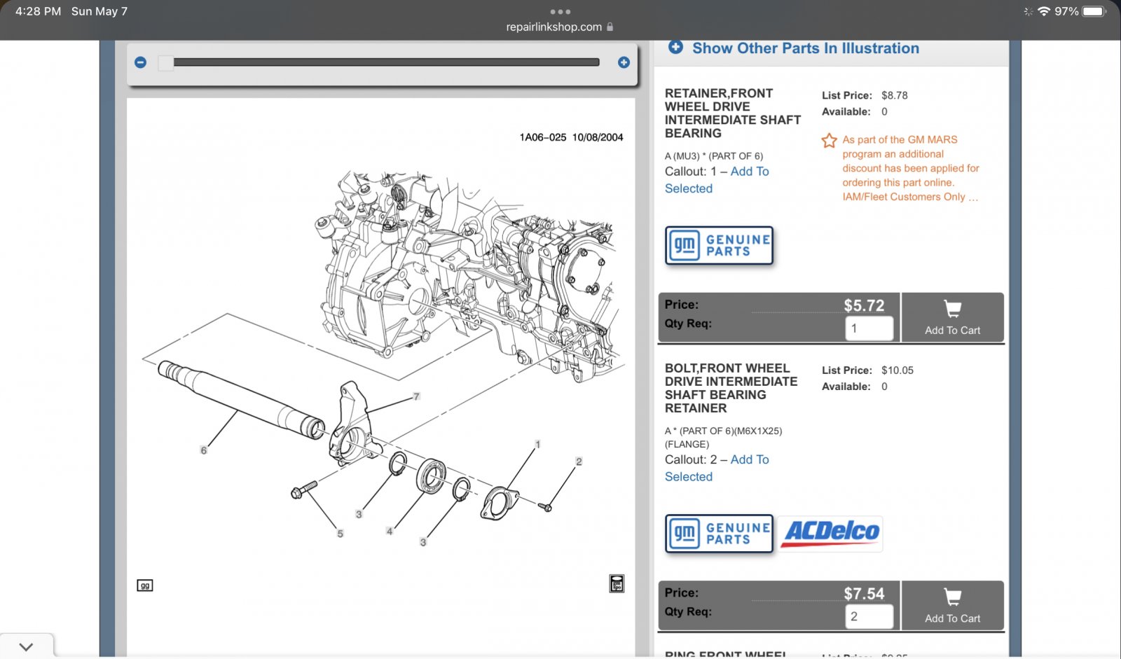

So I purchased some ZZP stage 1 LSJ axles to replace the stock ones from the donor. I could have sworn that I’d seen on some other builds, people mating both drivers side and passengers side axles directly to the transmission. However, the ZZP axles do not appear to be long enough, at least for the passengers side. The drivers side is fine. So my question then is: what is this (circled in red) called? And where to get one? Old one has some pretty deep rusting where the paint got damaged
Trying to find a replacement for it but no luck at any local parts stores
