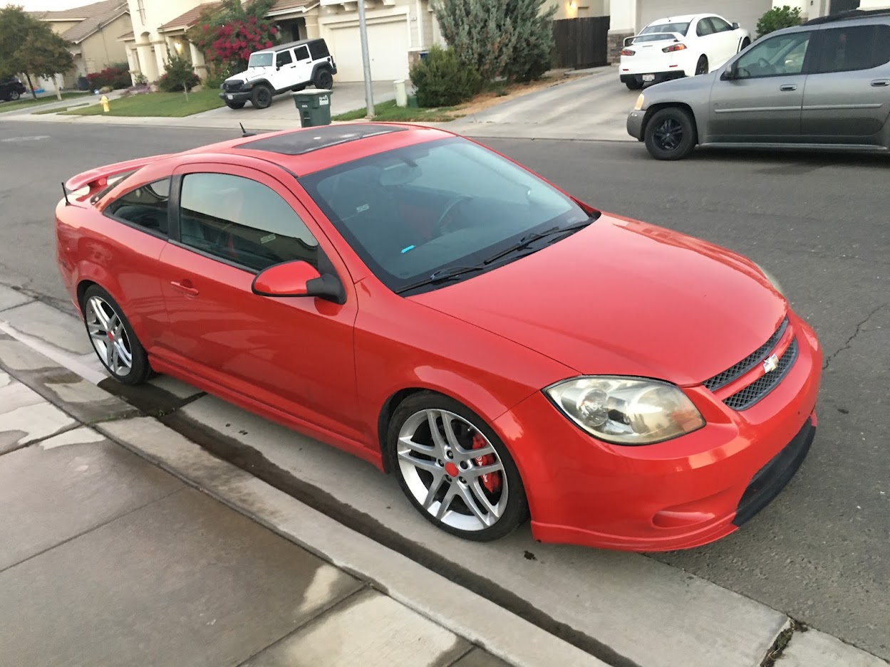

I had known about the DF Goblin for a few years but didn't have the funds to purchase and wasn't sure if that was the kit I wanted to settle on. I had looked at the exocet as well but ultimately wanted a setup like the ariel atom. After seeing the video of Justin Reed doing donuts I was sold.

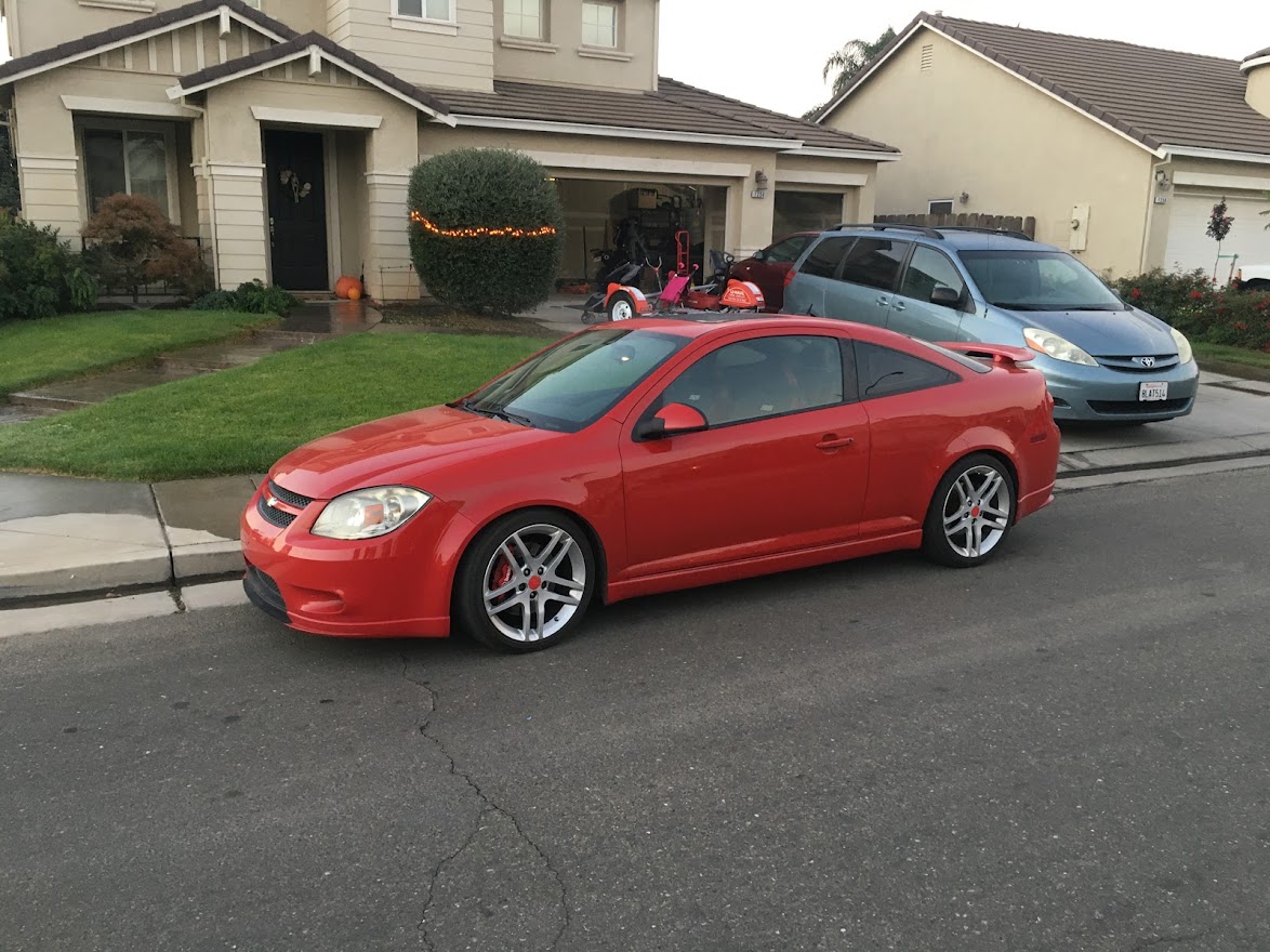

Here is a picture of the donor. Had a crazy time trying to find a TC donor. I had the most success on facebook marketplace. After three months of searching I found this 2008. The car was in good shape on the exterior but the engine had problems and with 176,000 miles on it I was already looking for a crate motor and tranny.

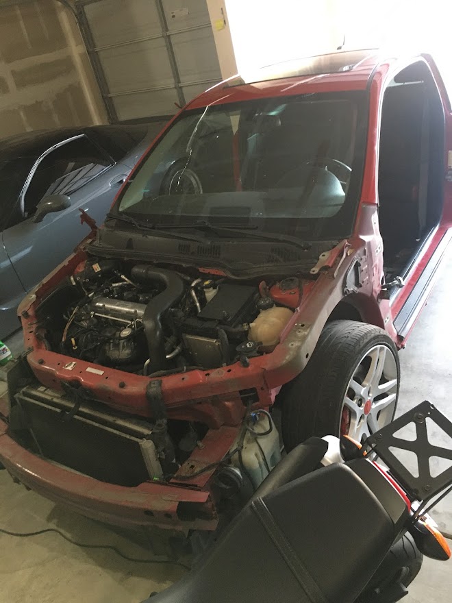

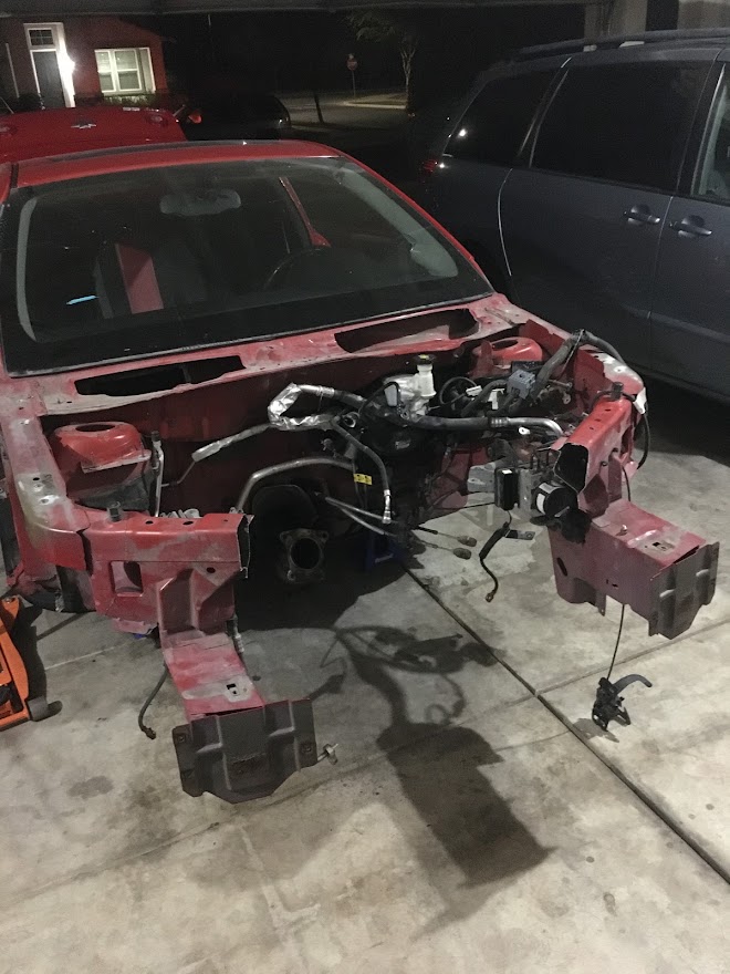

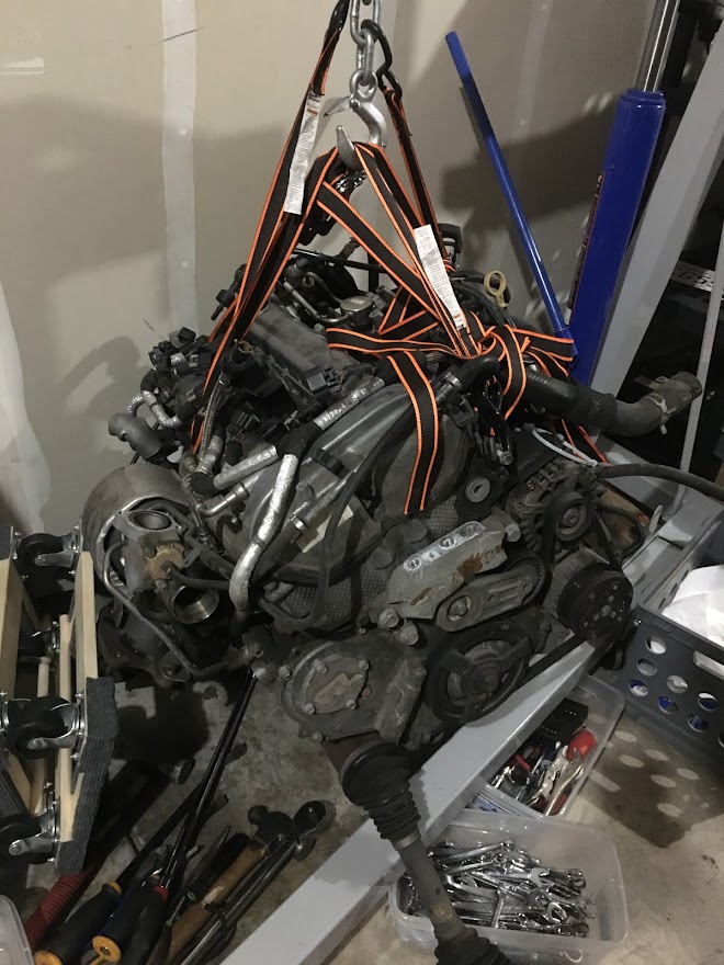

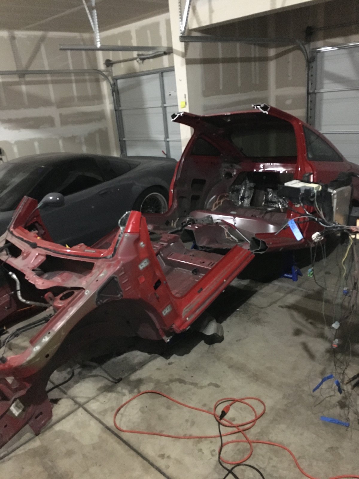

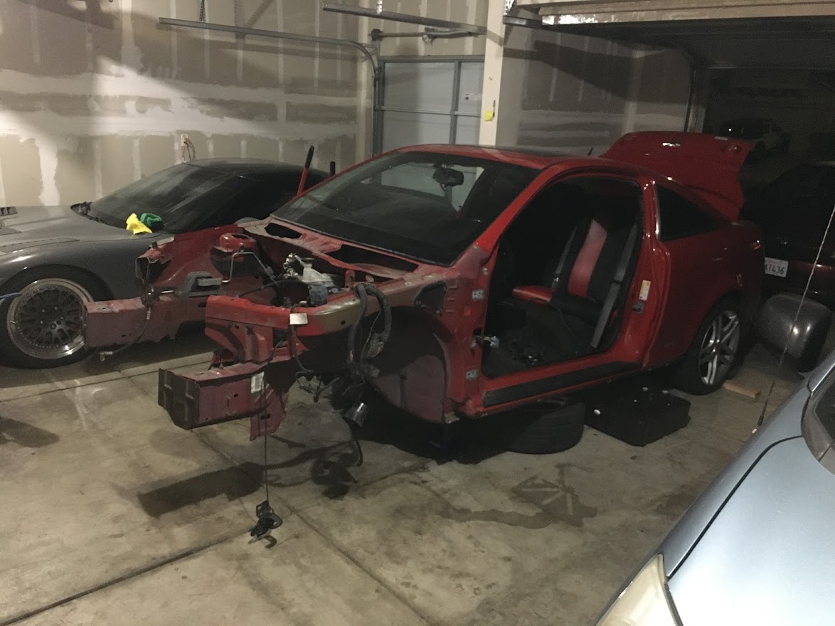

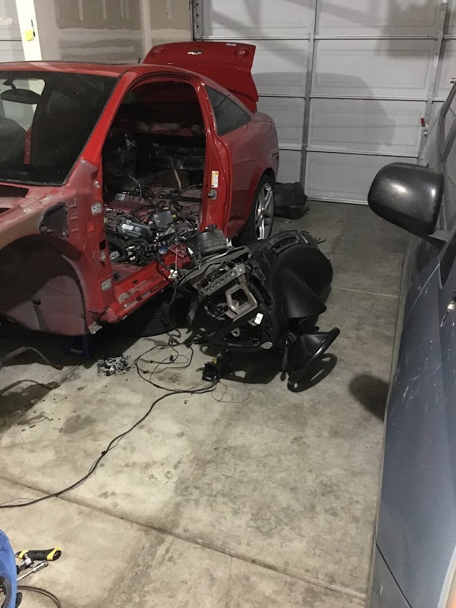

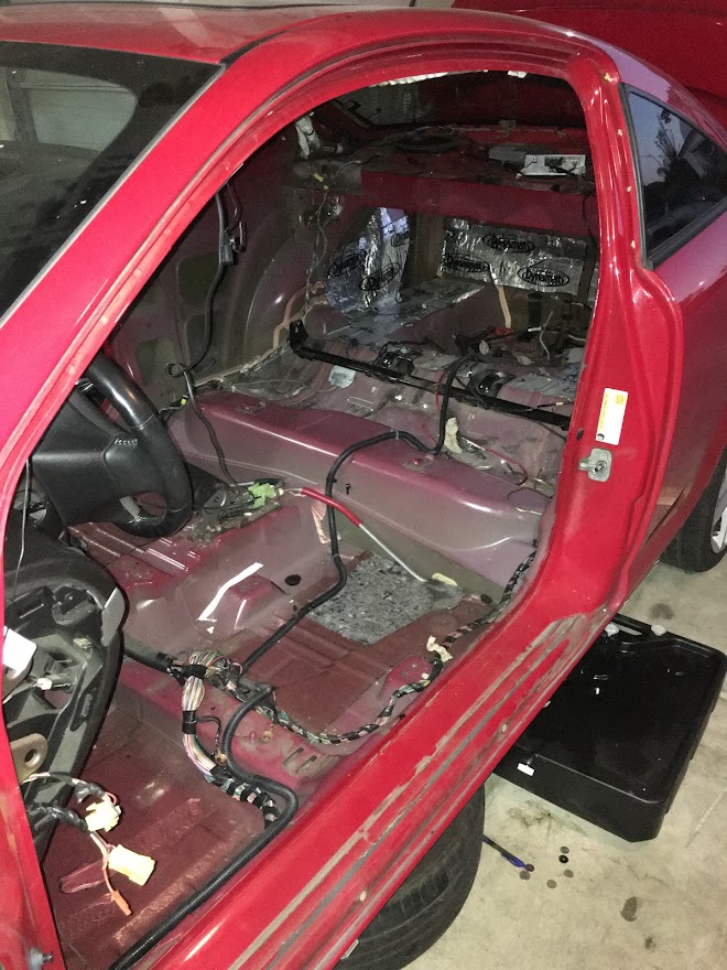

Here are some pictures of the teardown process. As weird as it sounds I had some of the most fun tearing down the car. I was able to sell off many of the parts on facebook marketplace or ebay. I payed about $3000 for the donor which was not the greatest of deals. Got a bit desperate. I was able to get just under $2000 back in selling parts so it ended up working out okay. Taking out the dash was intense. I luckily had my wife to help me. She has become accustomed to me opening the garage door and yelling, "honey, I need your help!". I removed the engine by cutting out the front portion of the frame and giving myself a little more room. This made things a bit easier. I didn't think I would have much luck selling the frame.

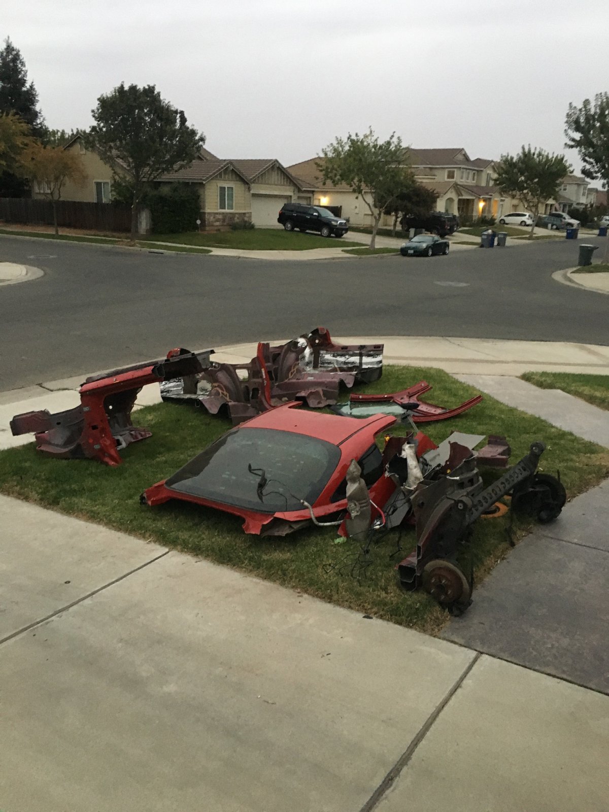

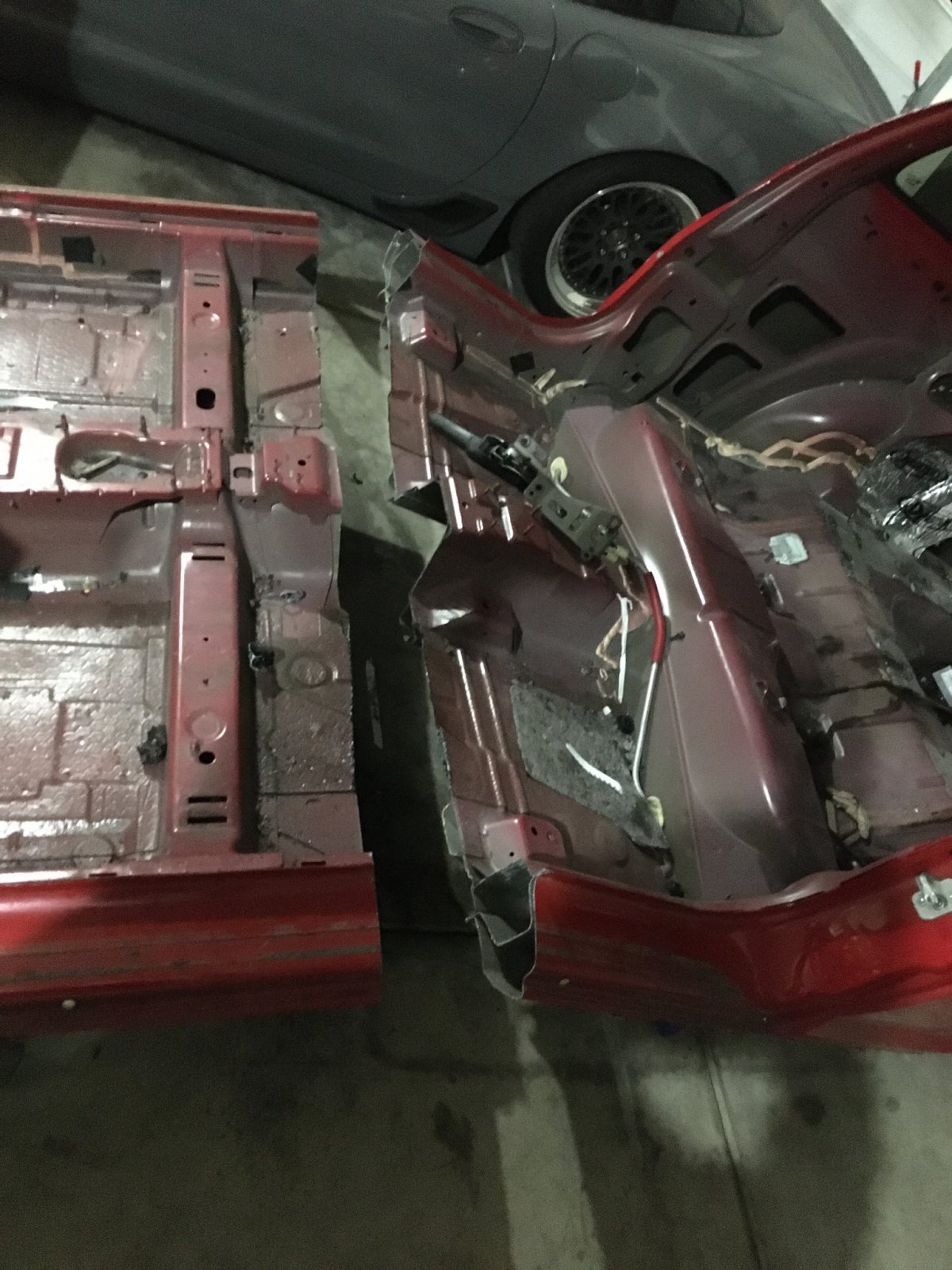

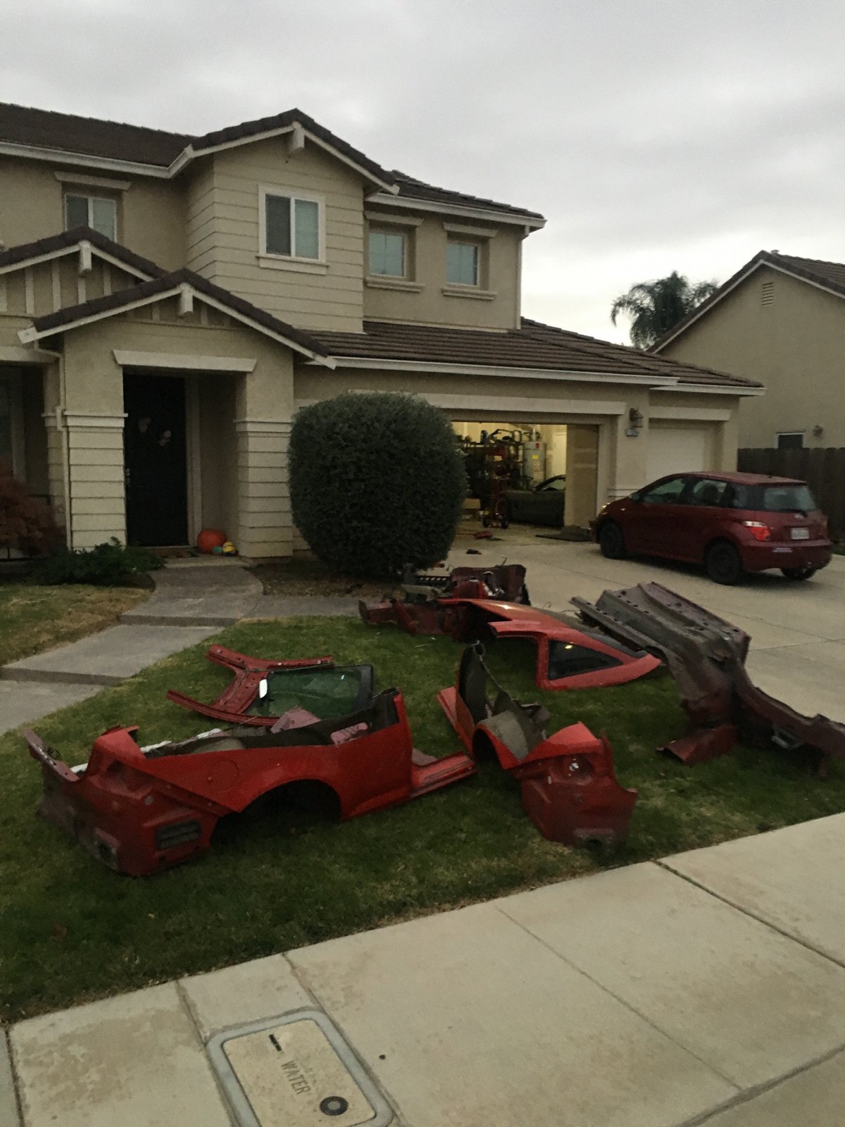

This should give you guys a good laugh. I was told by several junkyards that in the state of California you have to have a junk title for them to accept the frame. I really did not want to give the title up in case it was needed for registering the goblin. Well I read online that if you cut it up in to at least a certain number of pieces that they will accept it and that’s what these other guys found success doing. Well even after taking it to three different junkyards, they all denied me. Turns out there are a lot of people willing to take it off your hands that swear they’ve done it before and they have a “friend” at the junkyard who won’t have any problem with it. Stripped the VIN numbers off and said have at it. My neighbors weren’t too sure about me after this one haha. Had to do a lot of explaining myself.

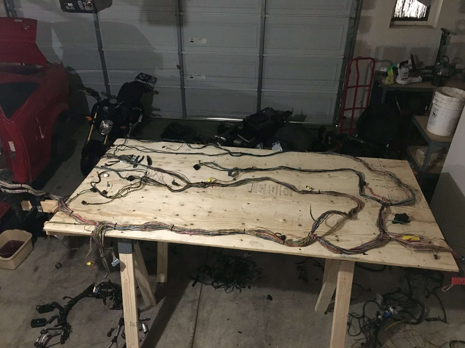

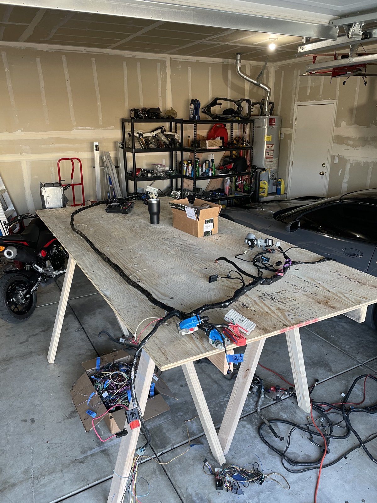

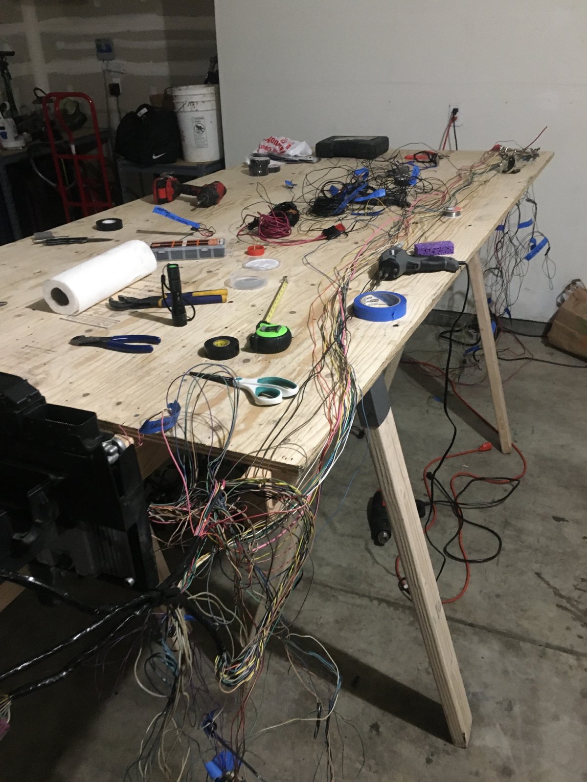

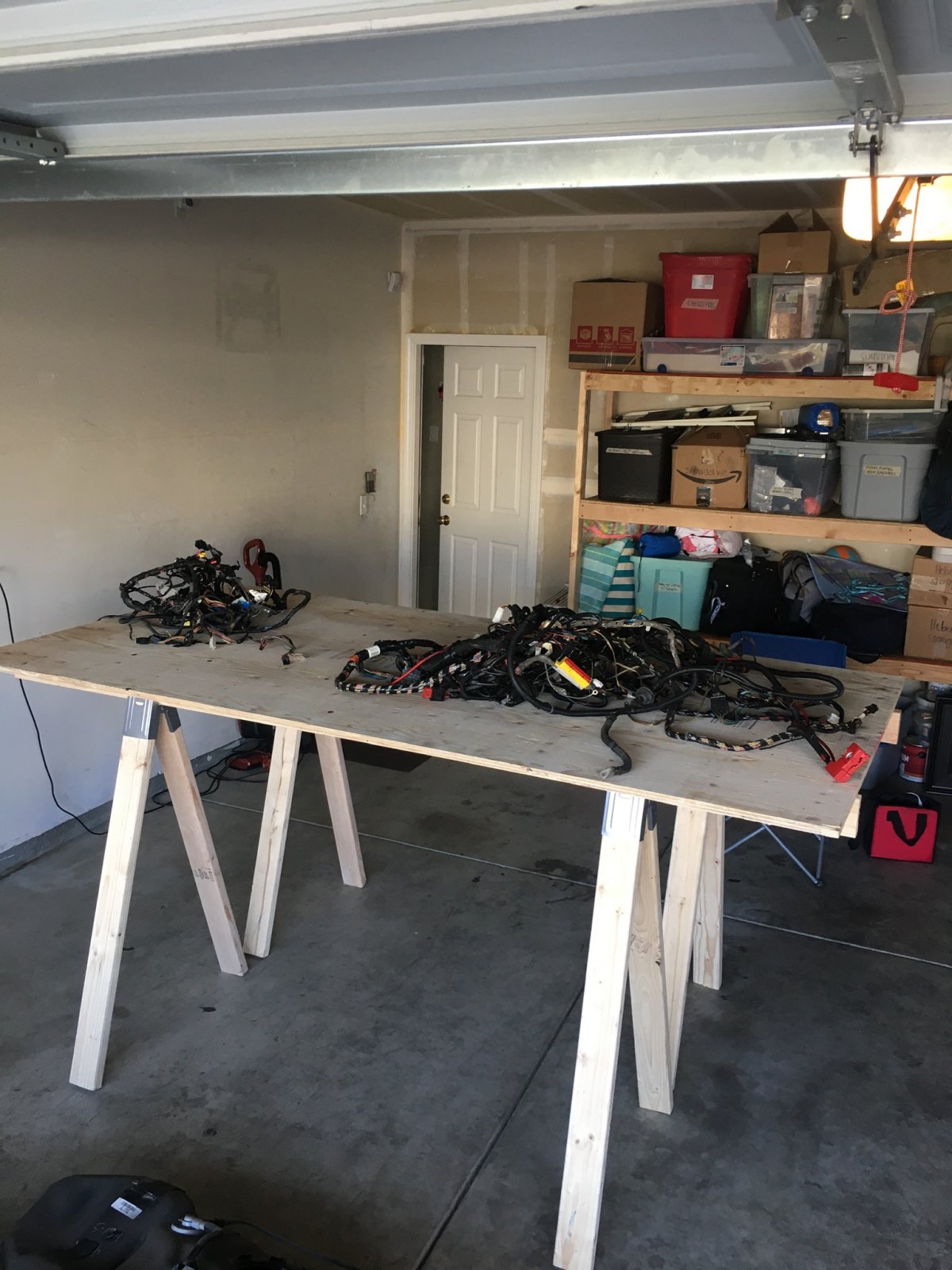

Re-wiring the harness took me about a month. Not hard but tedious. Looking back I would have just paid for the service. Great to be able to say I did it. Had one major issue where when I put it in the goblin and hooked it all up the car would not start. With absolutely no electrical experience I decided to send it in to DF to get it looked at. They found the problem without having to dig too deep. Turned out to be a shorted out data wire. Not sure how I goofed up that one. Ross on the forum was trying to tell me that but I had no clue how to diagnose it so I gave up. Super grateful for everyone on this forum. Can’t even tell you how many times I’ve been stuck and received help from you guys. Got it back and the car fired right up. All gauges working properly. We’ll sort of. I had plugged the speedometer plug into the coolant temp plug and vice versa so my car was throwing a code. Finally figured it out and got them switched back.

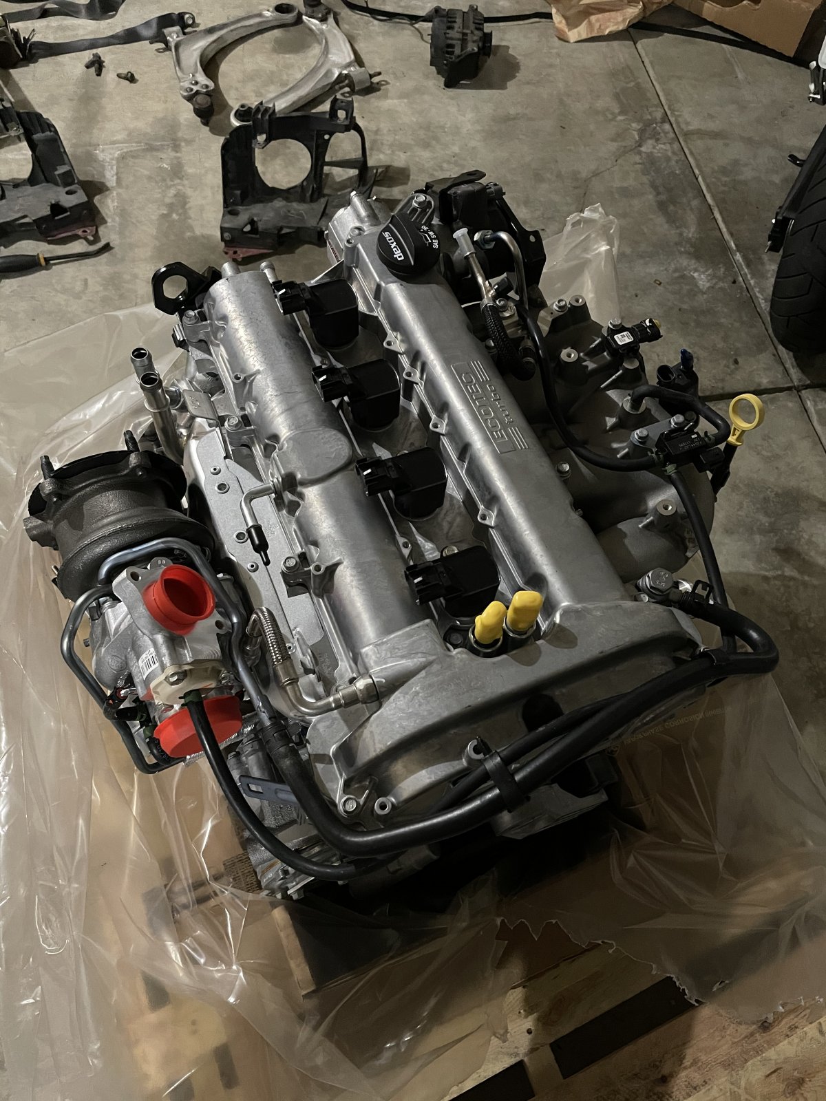

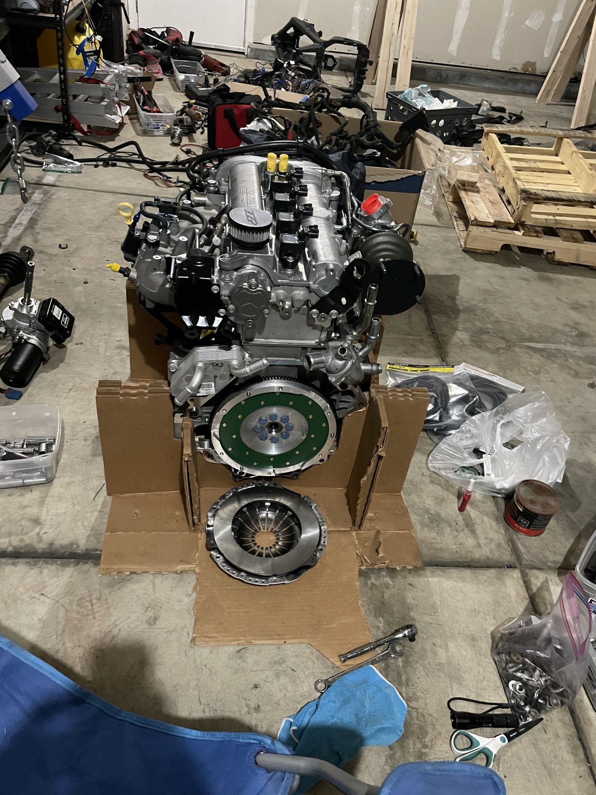

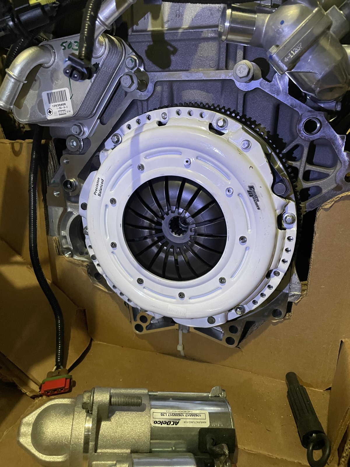

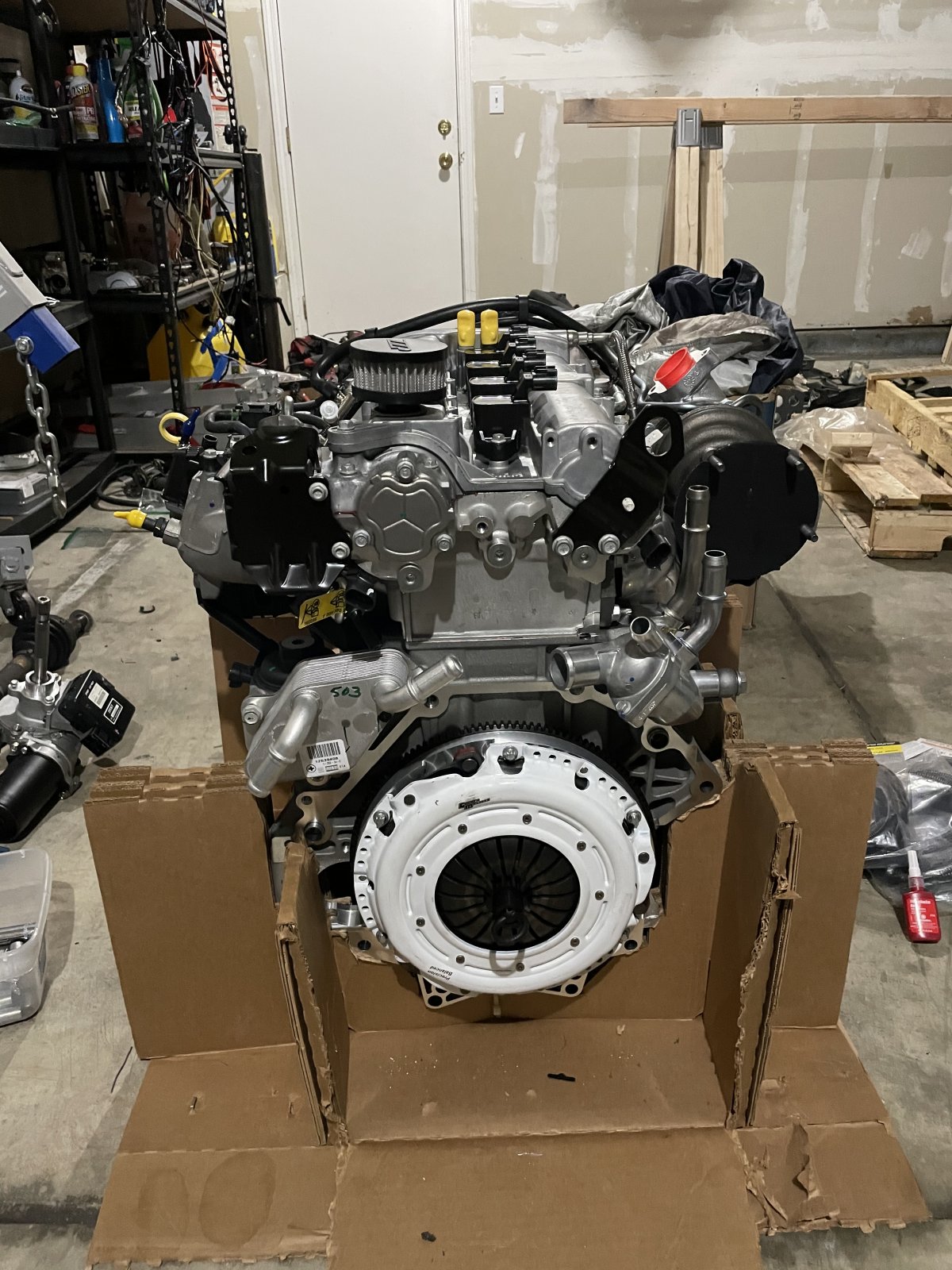

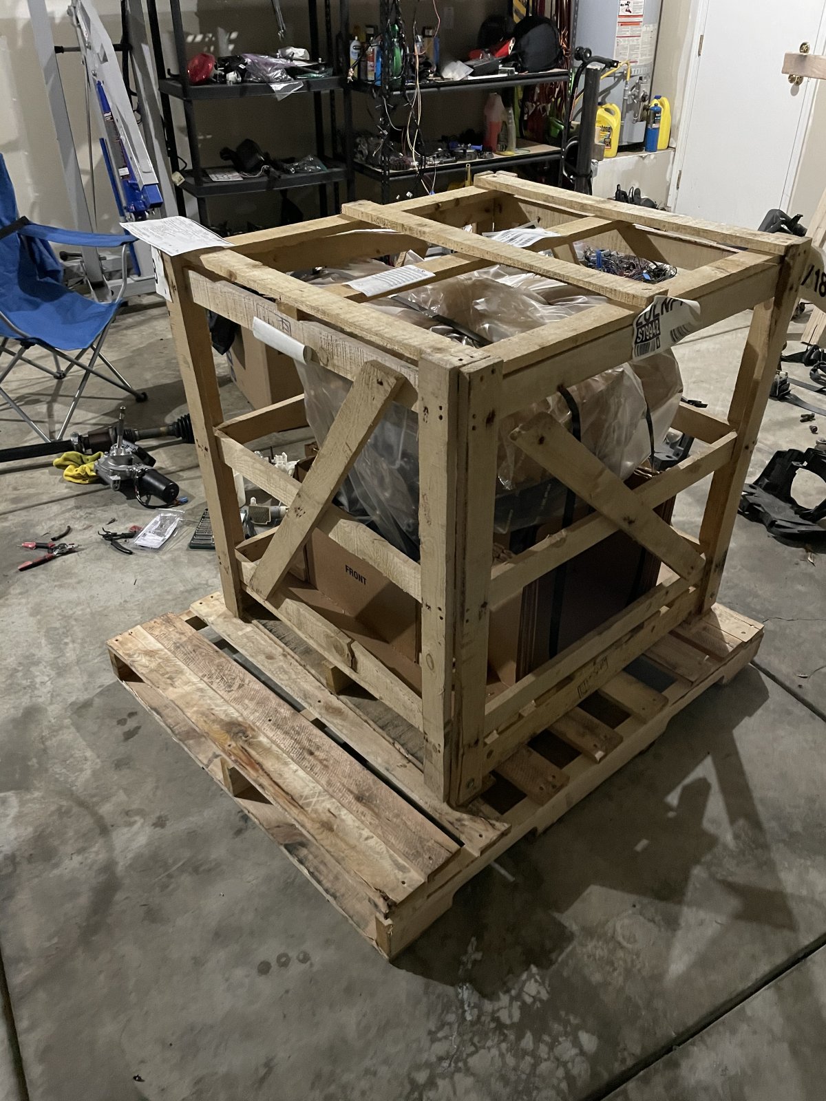

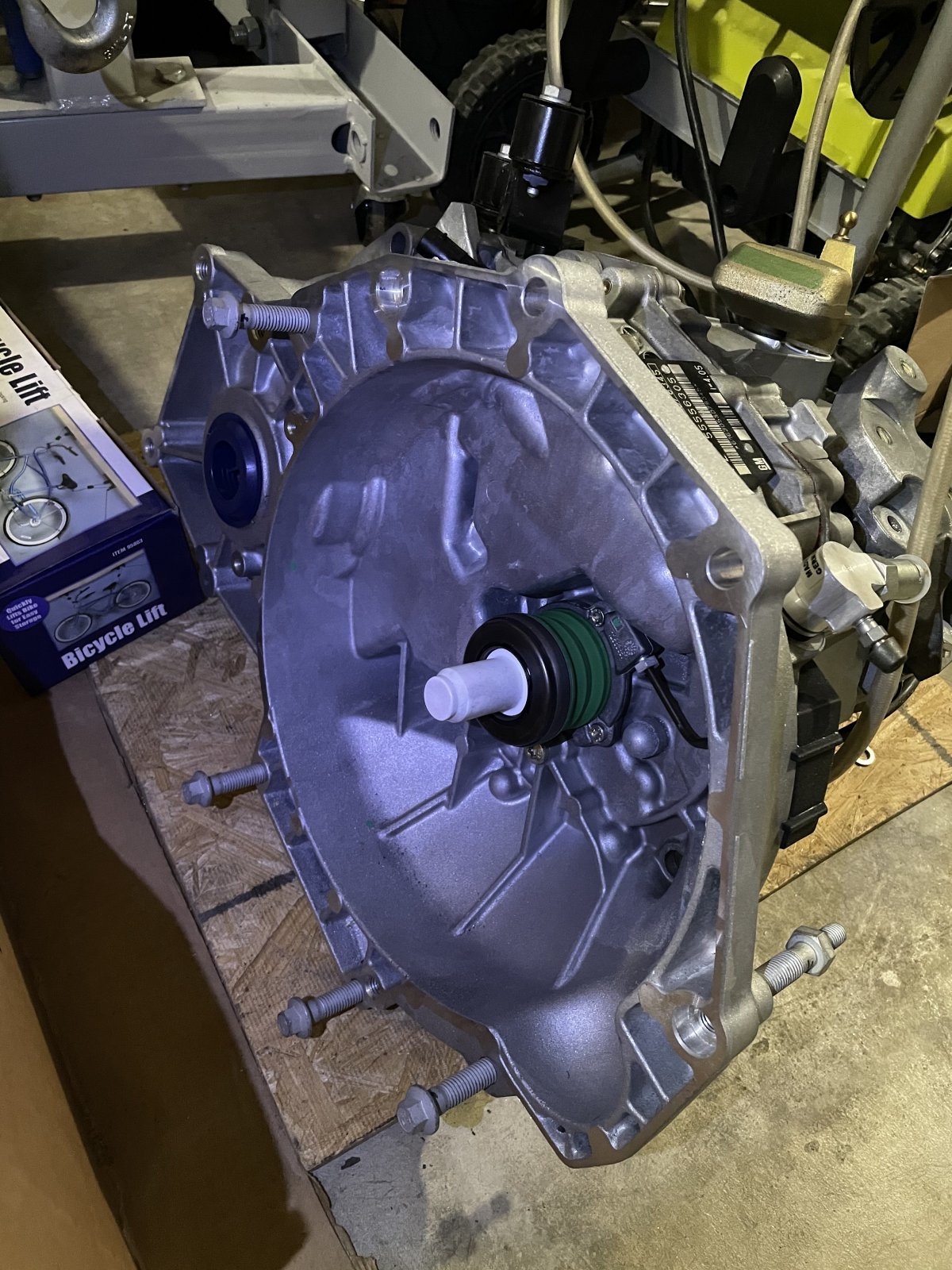

This was where things got pricey. With 176,000 miles on the donor I was not interested in using the engine and tranny. I purchased a crate LNF from ATK performance. I also purchased an F35 with the quaife lsd installed from DF. I went with the Fidanza light weight flywheel and the clutchmasters fx300. Spare no expenses! Haha. My wife hasn’t been too keen on the whole idea. What was once a $20,000 dollar project has quickly become more like a $40,000 dollar project. I haven’t been keeping track but luckily my wife sternly reminds me every month how much I’ve spent so far haha.

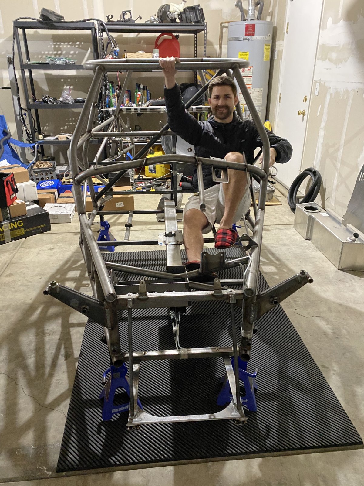

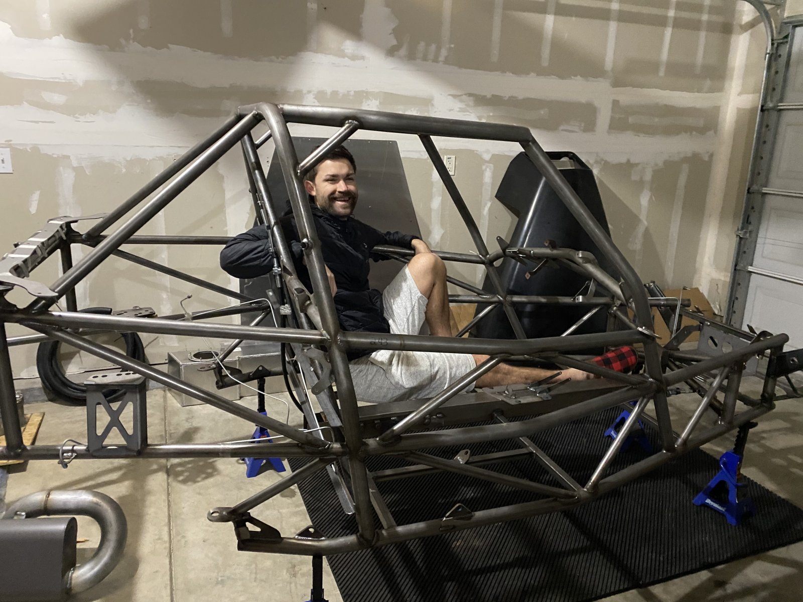

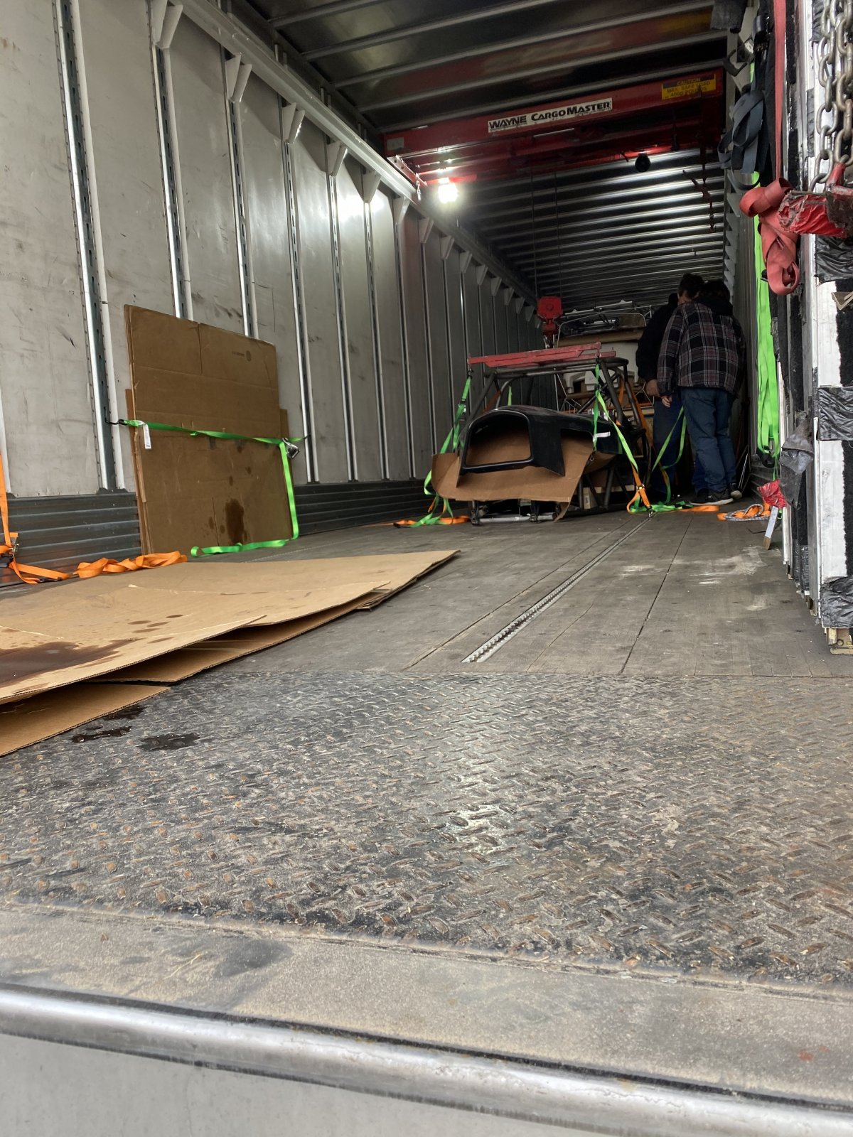

Definitely one of the most exciting days of the whole process. Kind of like Christmas. I was shocked by how small the frame was. I still am actually but I love that about the goblin. Couldn’t help but get inside as soon as I had stripped all the parts out. I was all too eager to get the frame powdercoated and get started on the build. Looking back I think I would have assembled first and gotten things all figured out and then disassembled and powdercoated. I like how some people have done that. I definitely would have kept the powdercoat in better shape.

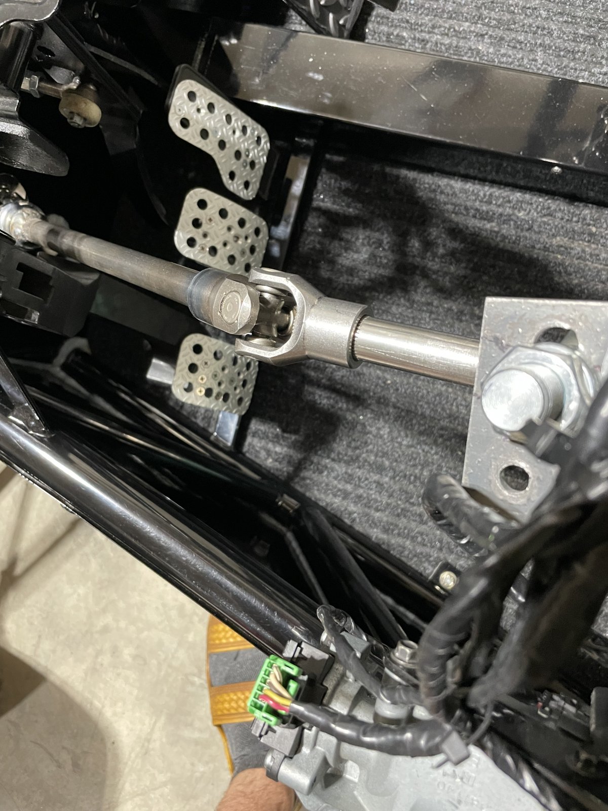

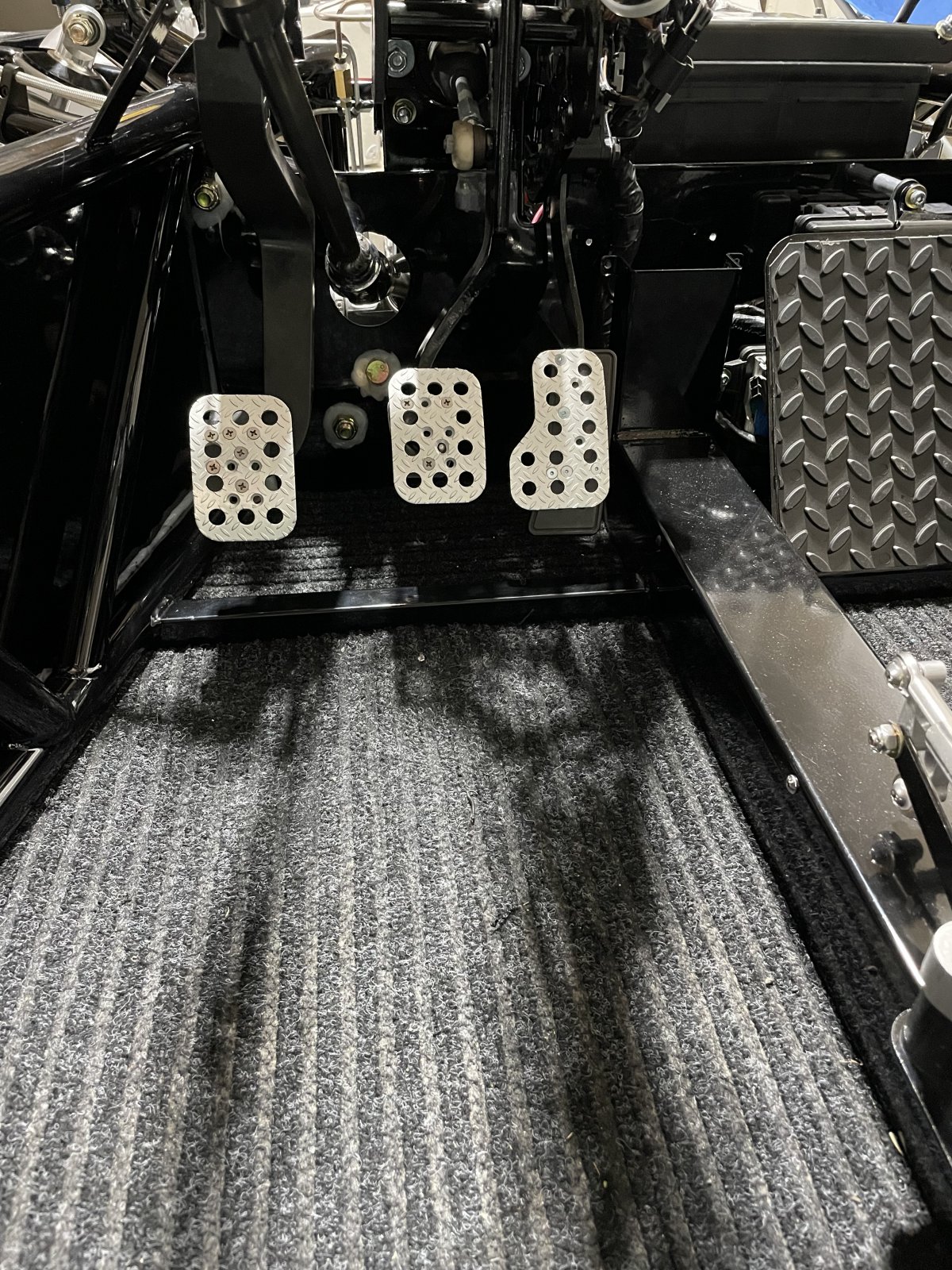

Installed these today. Would like to have a tilton pedal set but for now it sure feels better than the stock setup. Now if I could learn how to heel and toe. Hopefully the gas and brake pedal aren’t too close. With the manual brake setup they come up even with each other on med/hard braking. Feels about right but I won’t be able to drive with a regular shoe. I imagine the race shoes are not too wide. We shall see. Not only learning how to work on cars but eventually learning how to race. Only experience I have is with motorcycles as of yet so it will be fun to really get to know this car in the future.
