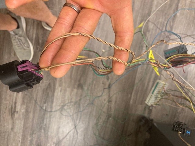

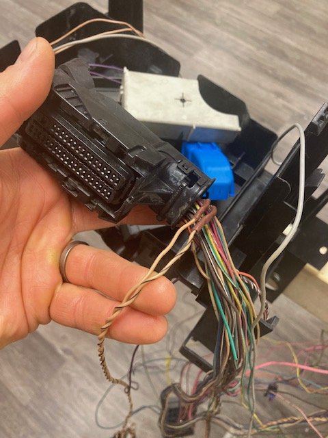

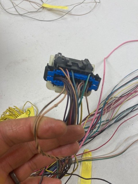

Thanks for getting back to me everyone! Here are the pics in order of the Data wire, thoughts?

This thread might help. It looks like you would link your ECM to the BCM. You can see my mark-up as I have the AT. Granted, I just finished my harness but haven't tested to see if I was right.
twisted pair GLAN wiring
The X101 is the Body/engine connector and the X201 is the Dash to body connector if not mistaken.
