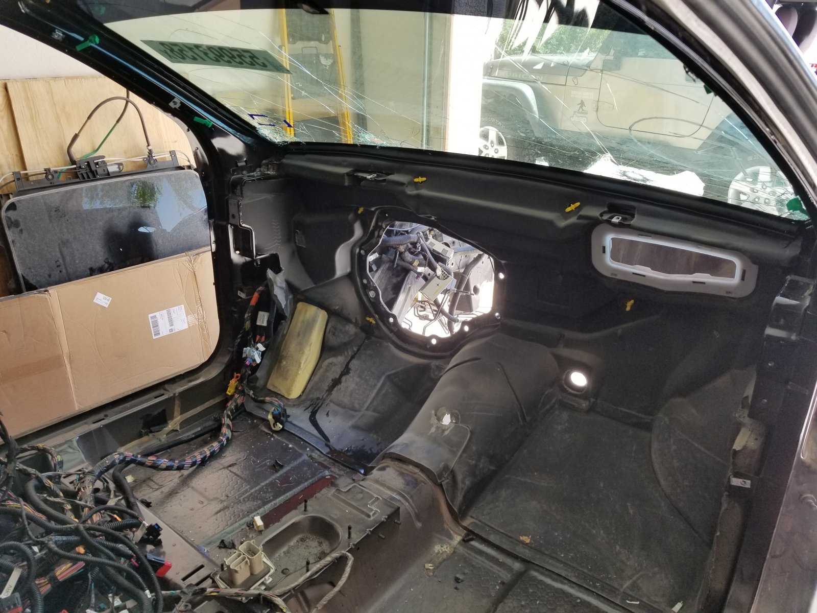

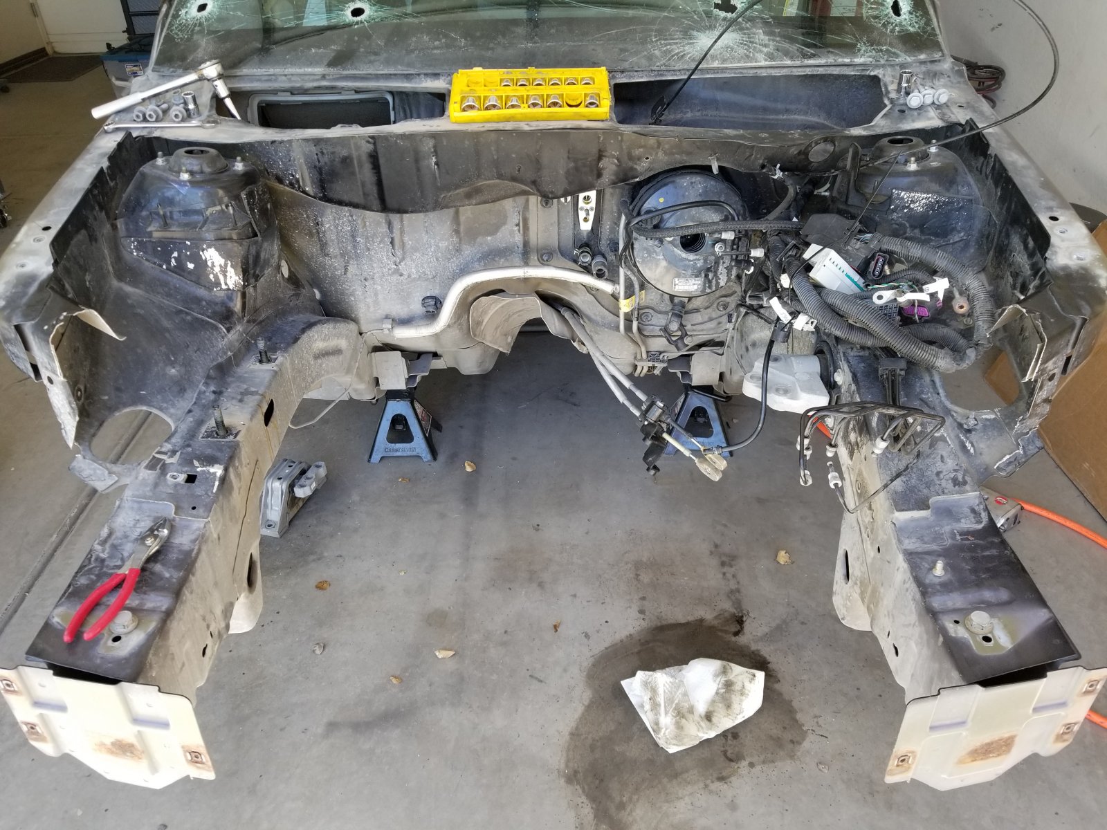

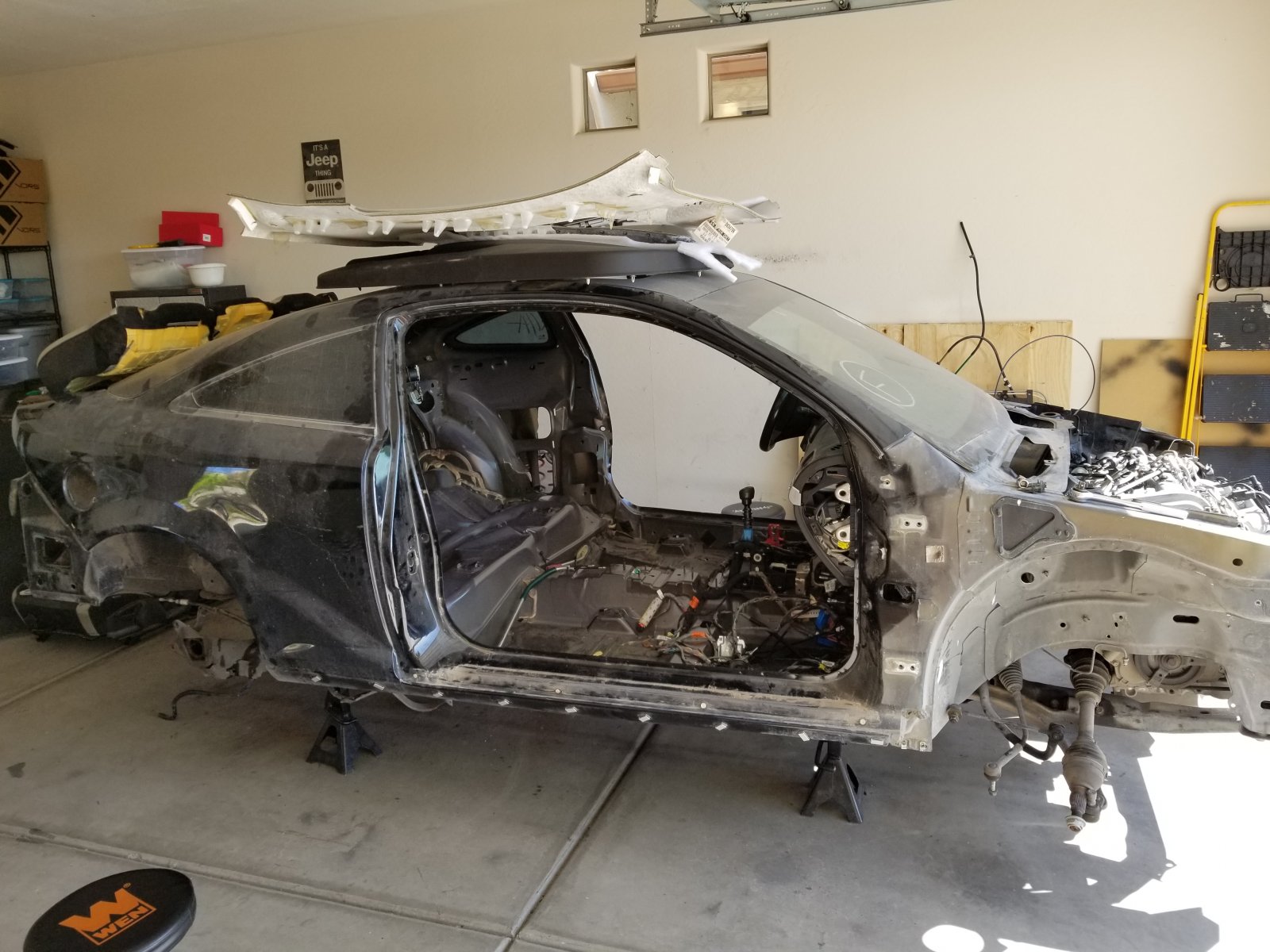

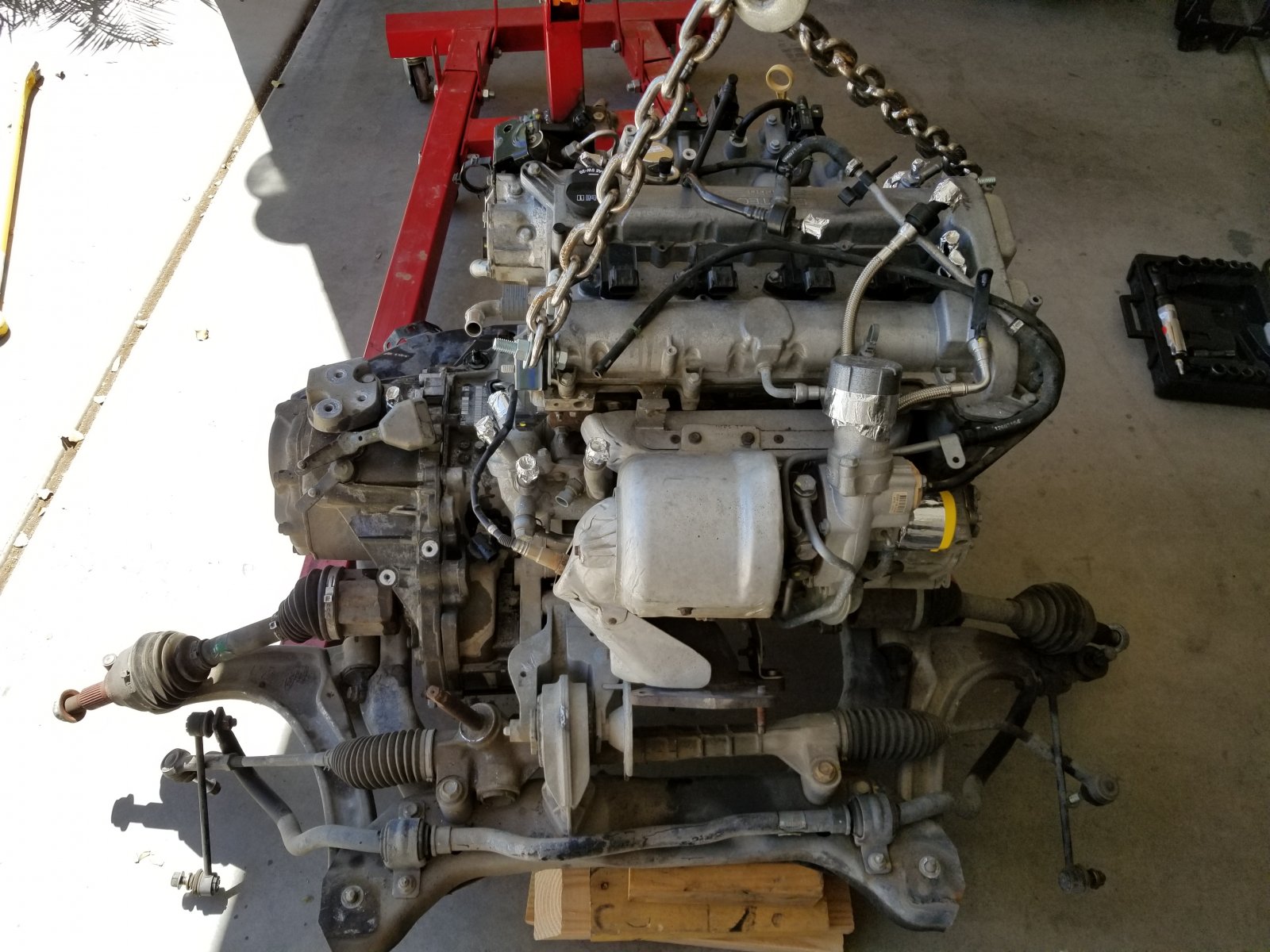

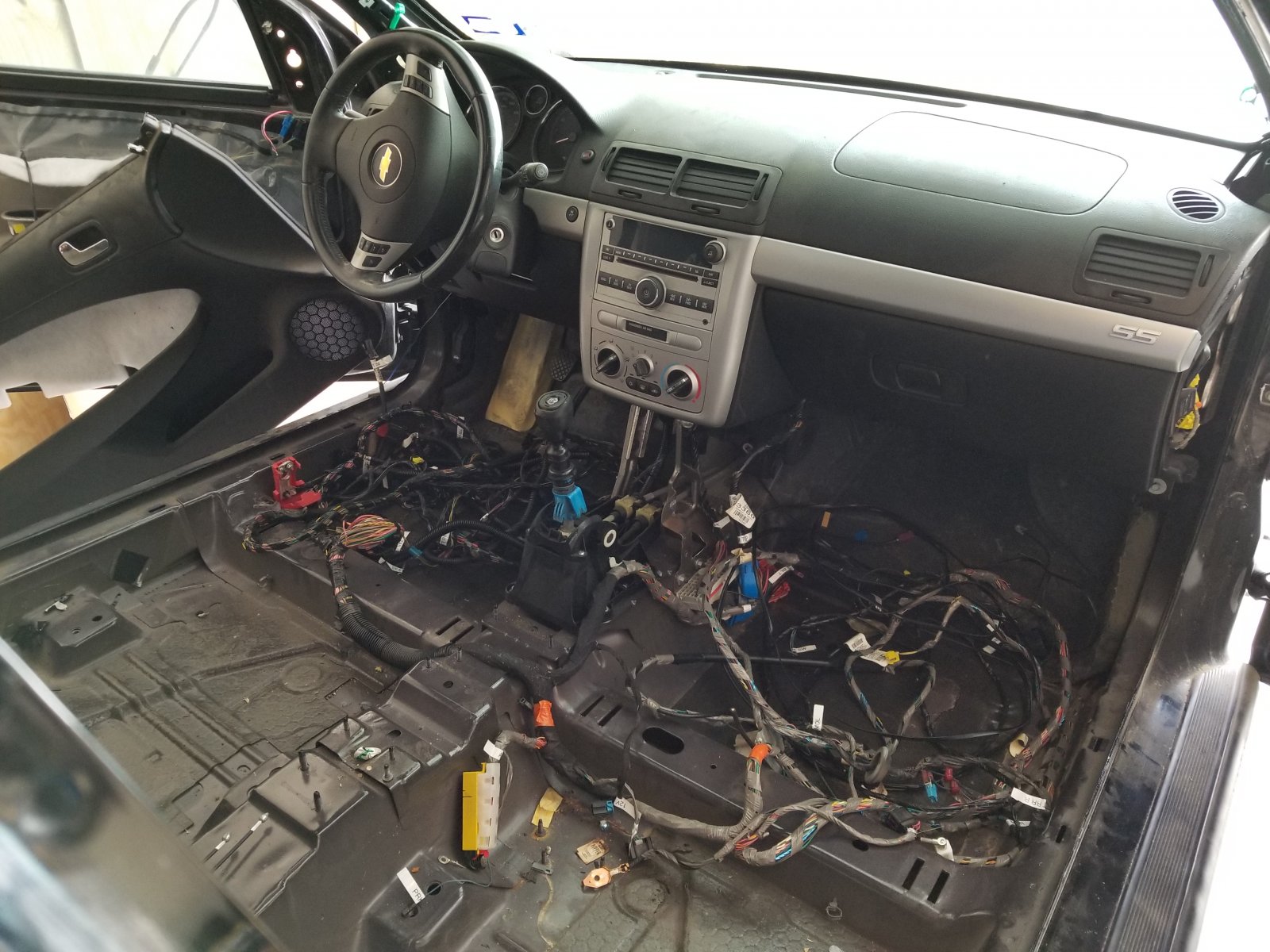

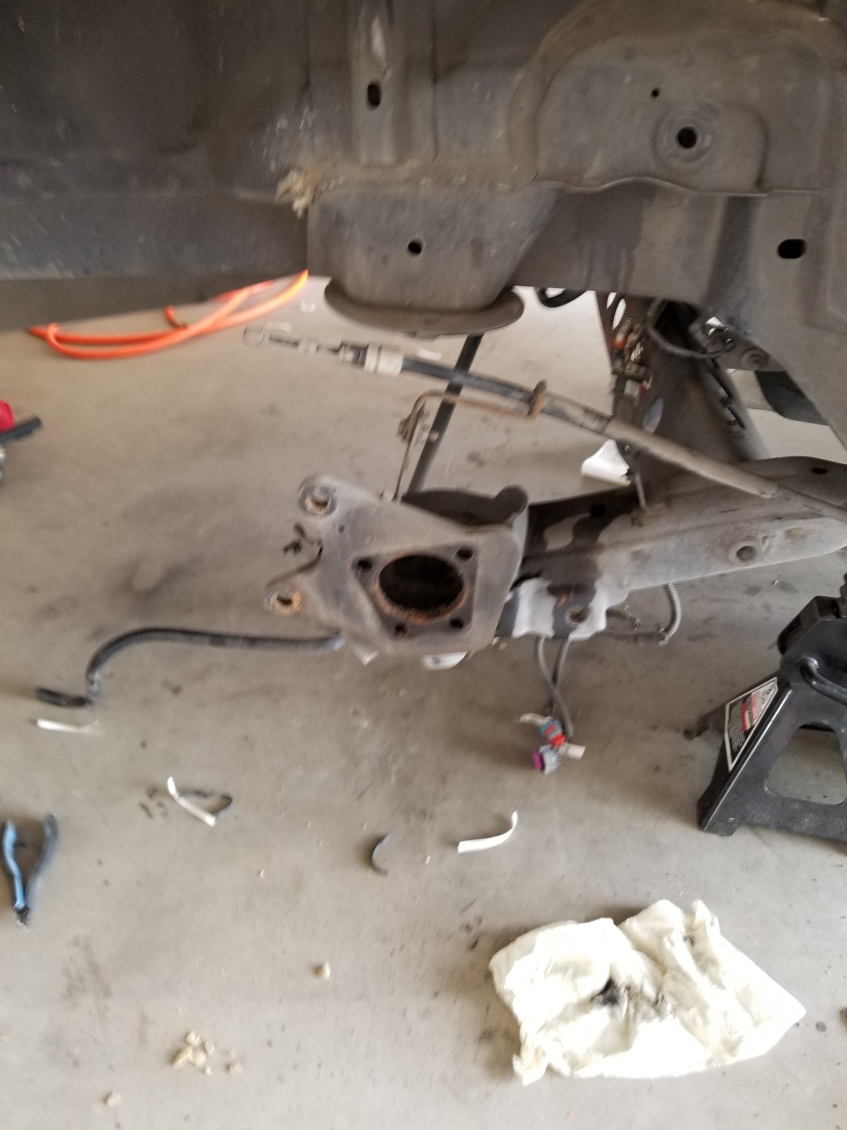

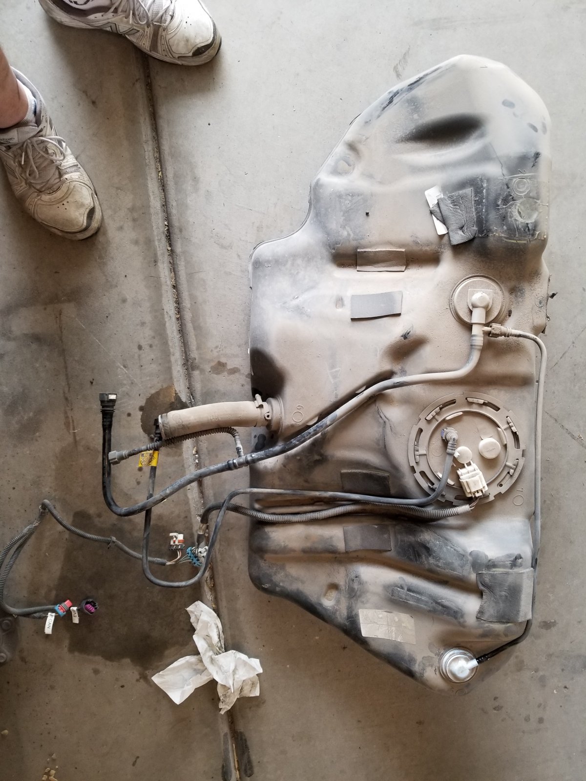

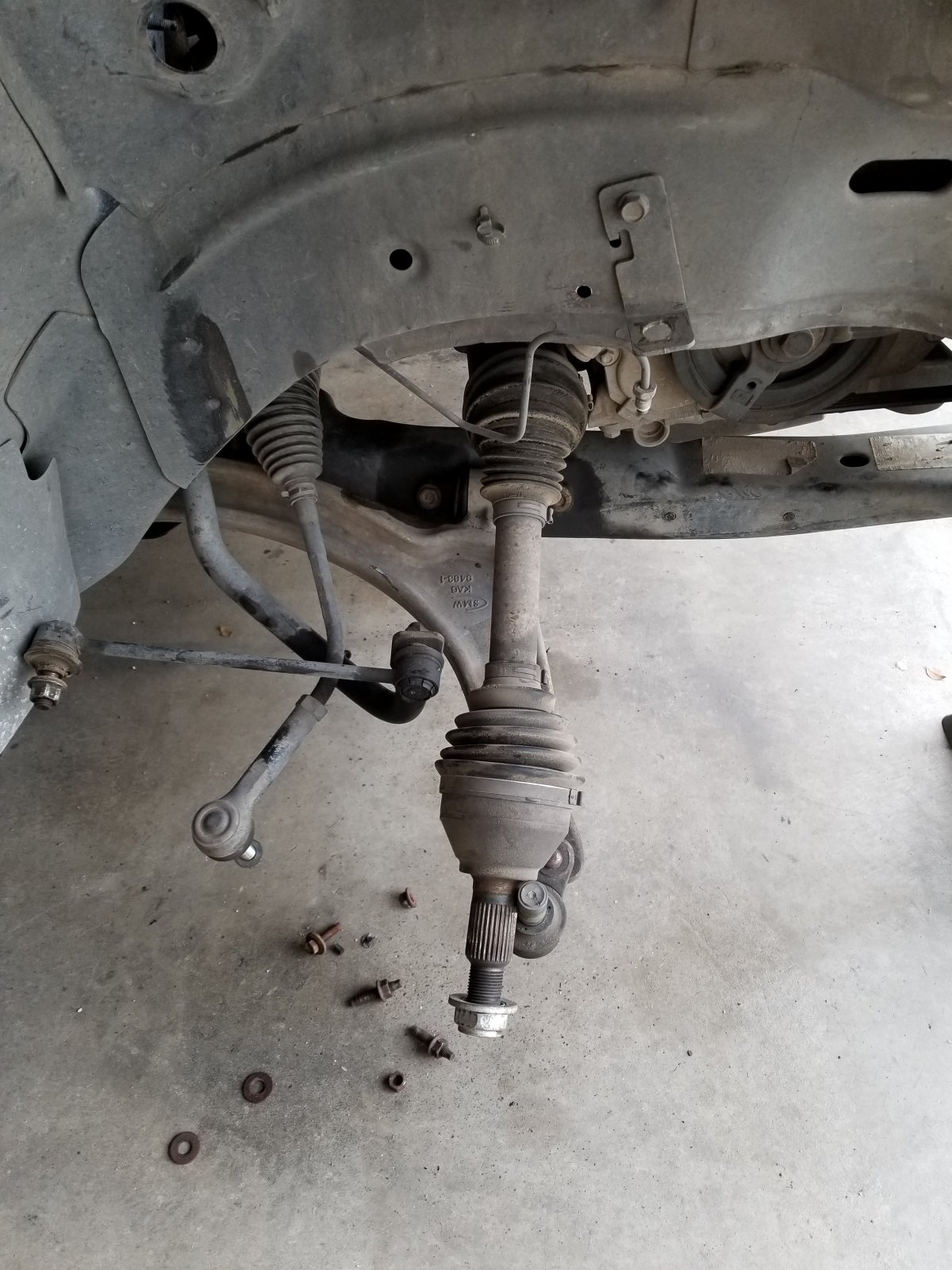

Anyway, got the exhaust and fuel tank removed, the front and rear suspension pieces pulled, the doors removed, and the interior up to the dash all disassembled. Some of this was real challenge with the rearender damage piching, pushing and pulling on my connections and had to cut some more chassis pieces off to get to some things. The next step is to get the engine/trans dropped out - have everything . Should be able to get this done tomorrow.

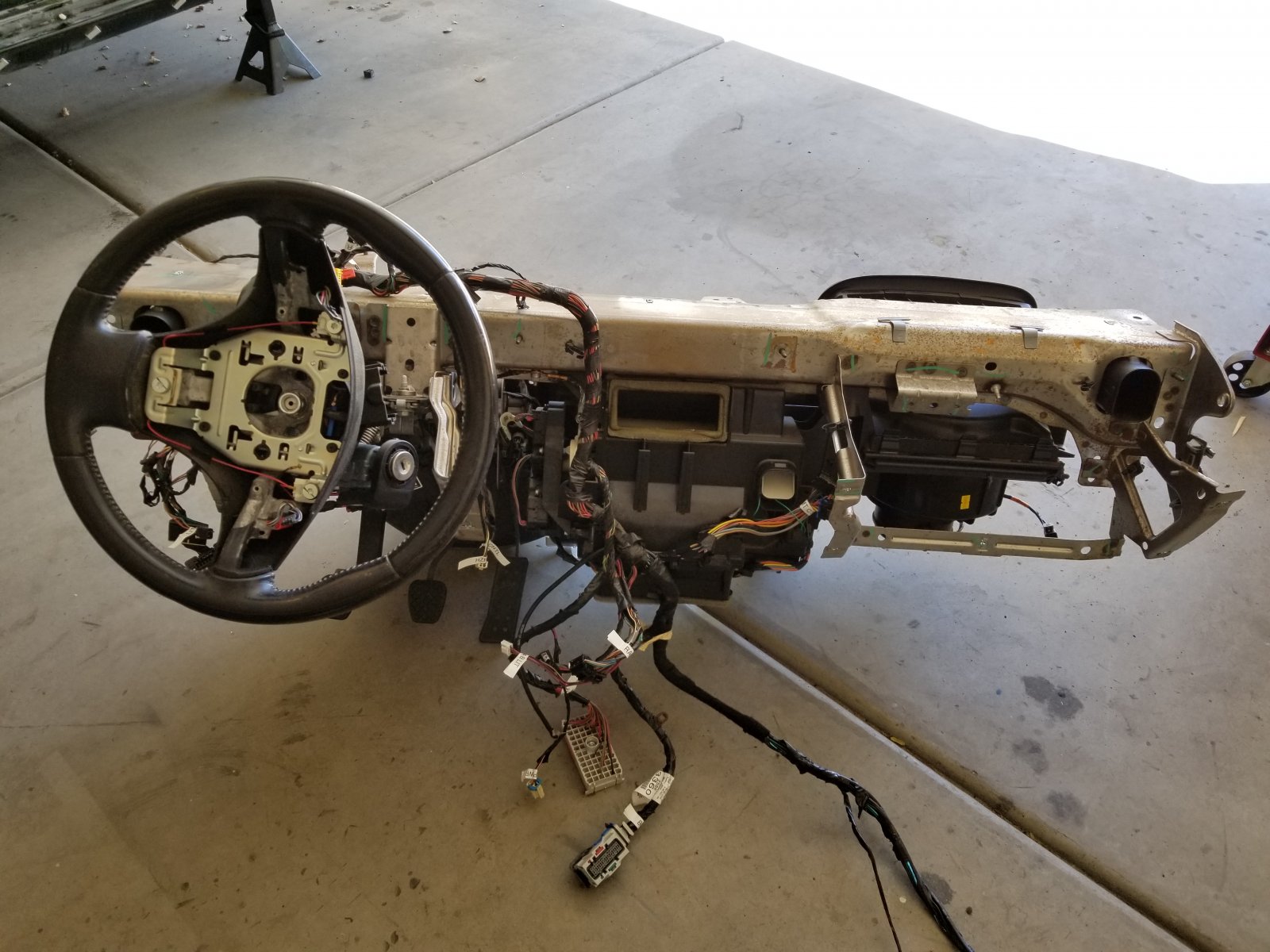

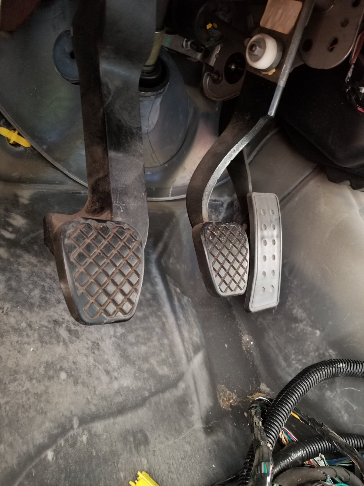

Started to remove some stuff from the dash while I am waiting. Noticed how badly aligned the clutch, brake and gas pedals are out of alignment, didn't realized how far off this is as reported already. Heel and toe driving will be more difficult, as described by several others on the forum who have their cars on the road. I will have to chase down what everyone else has done to maybe correct this?

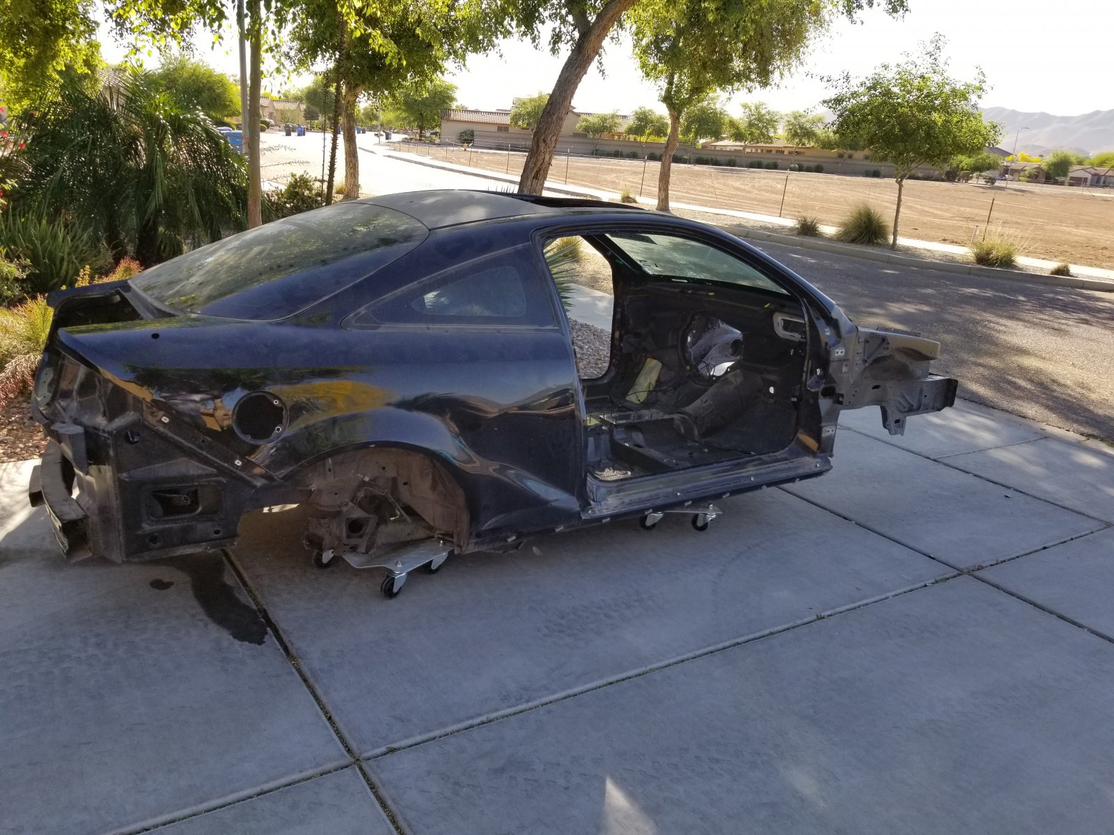

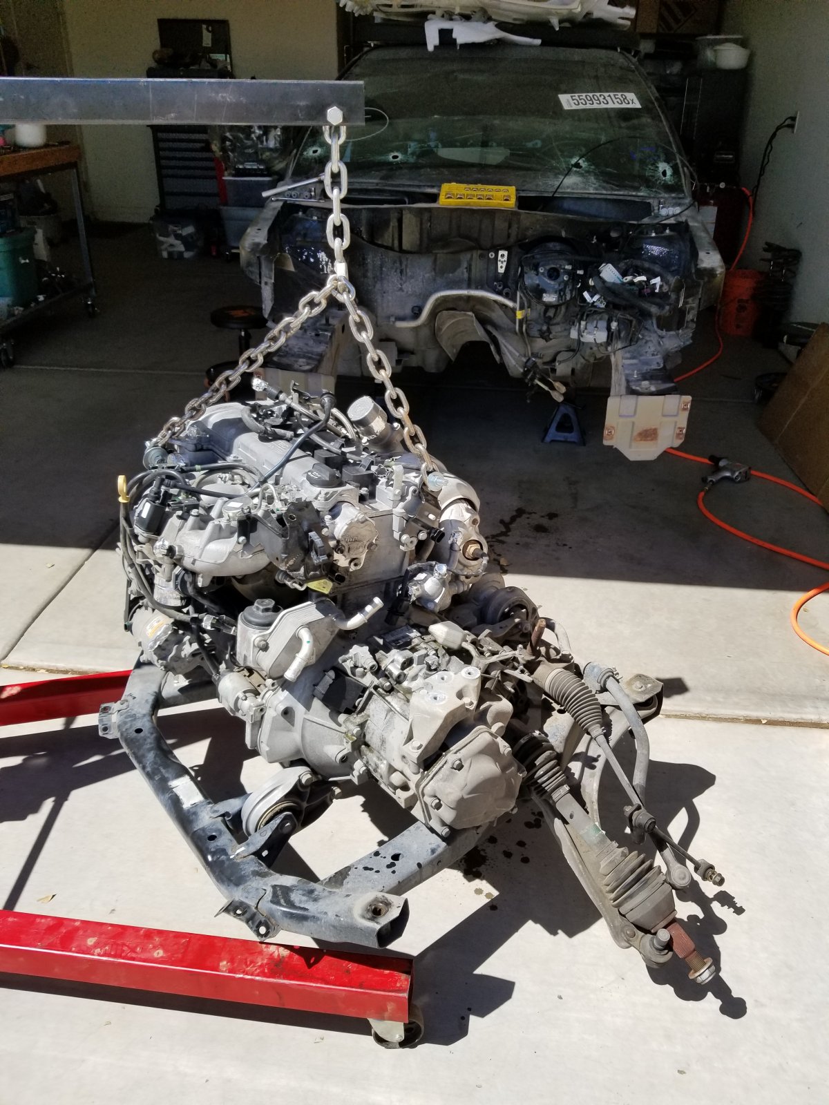

Engine is out. Started tearing down the dash this morning while waiting on the cherry picker and have it pretty well stripped clean. Just have to get the steering and pedal box out now.
Well you’ve already been talking about converting to manual brakes. The side effect of that is easy brake pedal position adjustment.
My gas and brake are lined up well now, clutch is not but the only way I see to change that would be to reposition the welded mounts or a whole aftermarket clutch pedal somehow. Clutch being out of line doesn’t bother me because it’s right next to the frame tube that makes a nice foot rest
Justin, what did you do to line up the gas pedal with the brake pedal? Did you just put a spacer on/under the gas pedal pad?

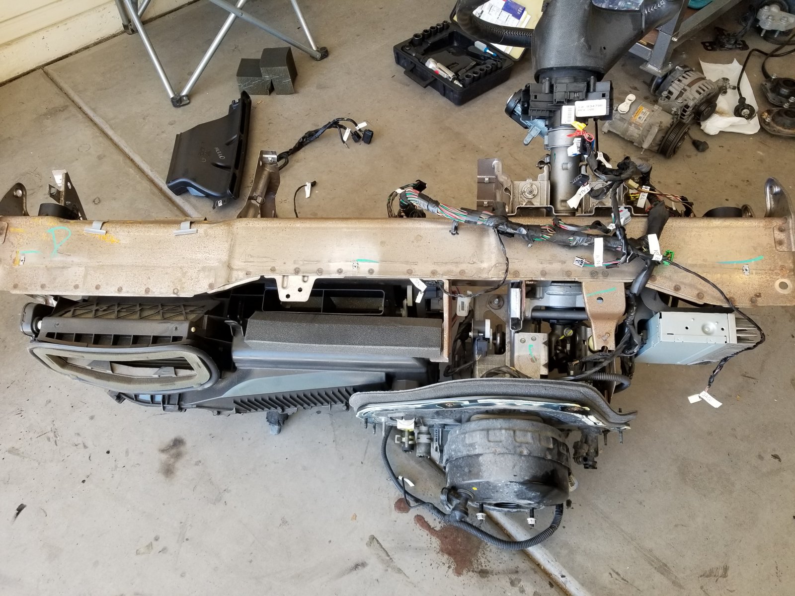

My donor is completely stripped down and I got the dash pulled and the rest of the harnesses out of the car today. My teardown from first wrench turned until today was a full 2 weeks of skinned knuckles, cuts and enough dirt to fill a bucket. I removed everything from the car and it is literally an empty shell now - will be glad to get it out of my garage. I now need to organize everything I will be keeping and get everything else cleaned up and ready to sell. Once I have some $$$ from parts selling I will have enough to place my kit order - hope the F40 mod is finalized soon.

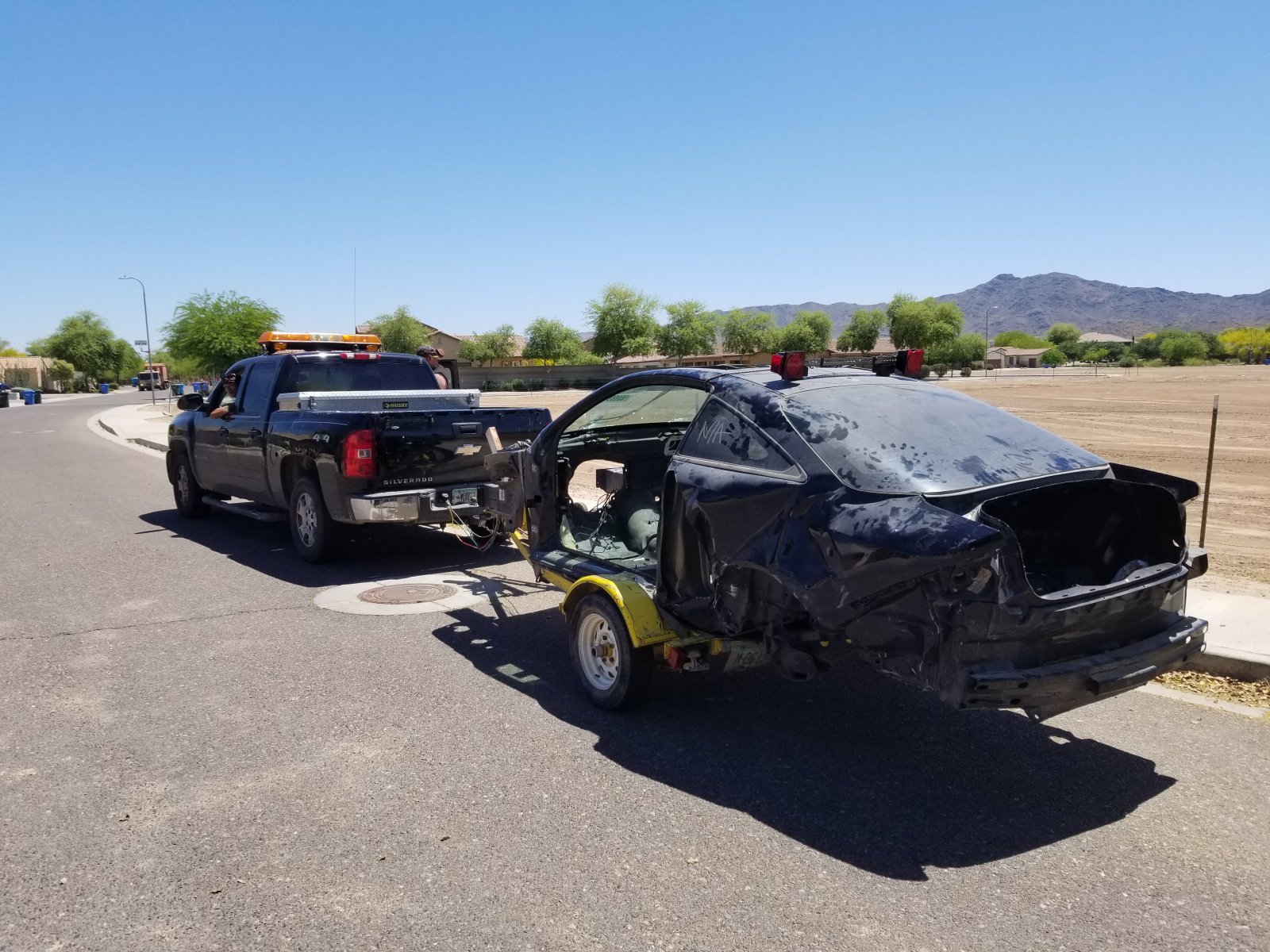

I have all of the parts I need from the donor and it has finally left the garage today, headed to the scrapyard. My wife was happy to see it gone, but that is another story. I now have room to park my Jeep in the garage again.

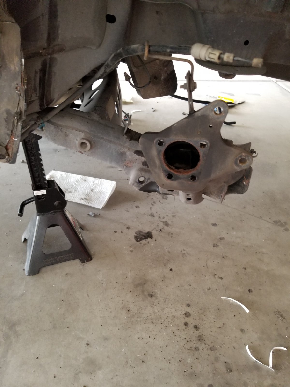

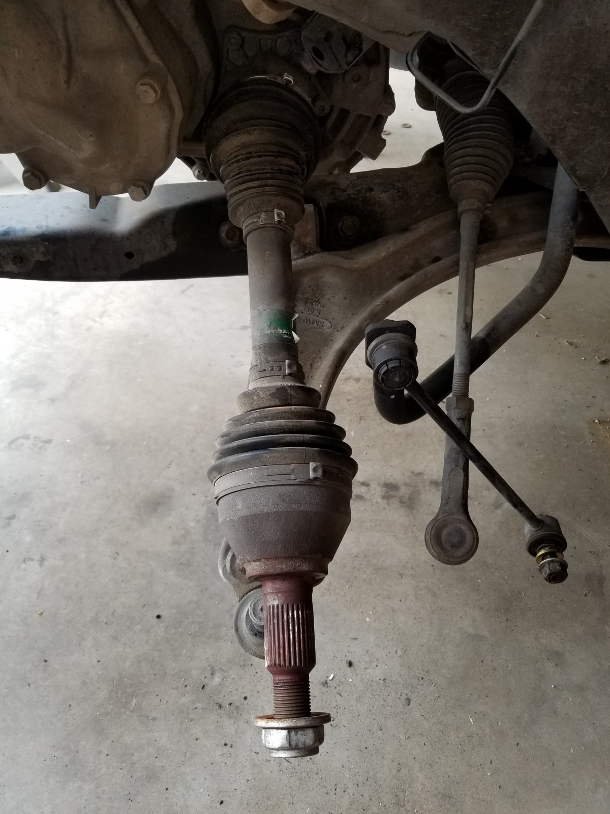

I have been working on the donor parts for the past 3+ weeks - along with the never ending honey-do list - getting the parts cleaned up and checking for wear/damage. Of course I found some and am ordering replacement parts that are hitting the budget. Biggest thing was the rubber bushings in the aluminum control arms. These were torn in more than 1/2 of the circumference and will be getting replaced with poly bushings.

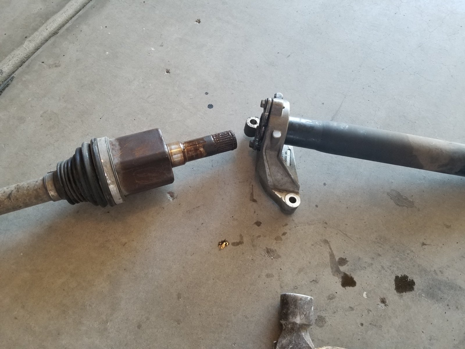

I was having trouble getting the passenger side axle removed from the intermediate shaft and took Lonny's advice to stand it up and put penetrating oil into the interface. After more than 3 weeks of lubing and hammering it finally came apart with almost no damage to the axle or shaft. I am believing that a combination of old grease and rust could be marketed as some kind of locking goop since it sure worked well on these parts.

Those control arm bushings are torn on almost every car. When I would do a state inspection on a cobalt that was one of the first places I would look.
Yep, those bushing weren't worth poop. You might want to consider installing the heim joint type of bushing. Lonny swears by them. They keep the arms from changing the wheel alignment under hard acceleration.

Chad, thanks for the info. I already ordered the Prothane bushing kit, same as Brian 1177 installed. If these do not work out, the jonny-joint/heim joint can be used at a later date. I was also pondering a custom tube a-arm with heims in all locations - front, back and ball joint replacement. I have something already sketched out with dimensions, but this is something for the future, if all else fails.
Read this:
Dang, I'm glad I read this before I installed the new stock bushings. Just ordered new MOOG K201285, guess I will ebay the stock rubber bushings.

I went with the OTTP metal bushing kit which also included the Delrin pivot bushings. I swear by Delrin after how they have performed in my sand rail. There was no reaming required for my control arms.
Looking through some information about suspension set up with McPherson struts, it is desirable to have a slight toe-in on compression of the rear suspension. This will help create minor rear steer of the outside rear tire with body roll on turn in and applies to both tires upon acceleration. No more than a 0.5 degree change in toe in with nominal suspension motion is ideal, which could be set up rather easily on the Goblin with spacers to move the rear toe bar slightly higher (it is 'rear steer' so the rod has to push the rear of the wheel to create toe in). This configuration can be made to compensate for very minor changes to the rear set up caused by suspension bushing compression, such as poly bushings, but typically not for rubber bushings - which are considered garbage in everything I have read. Obviously, having zero compression in the suspension bushings is the ideal situation.
