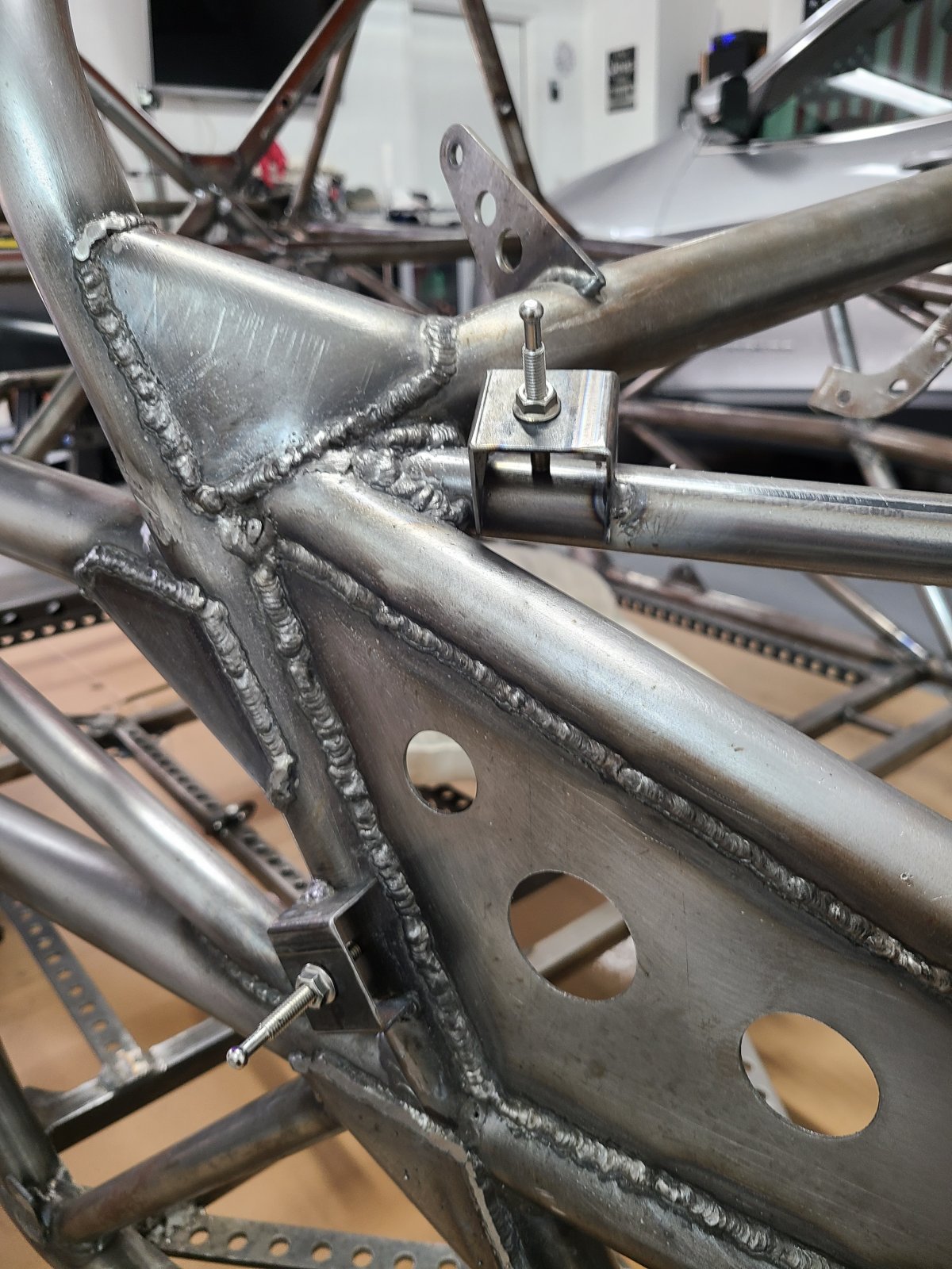

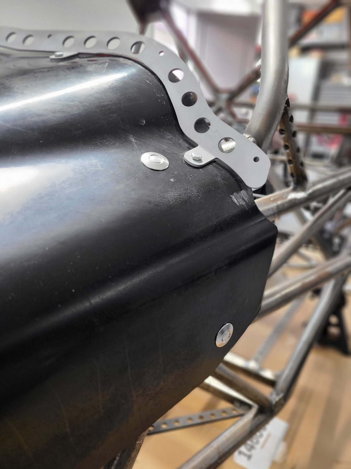

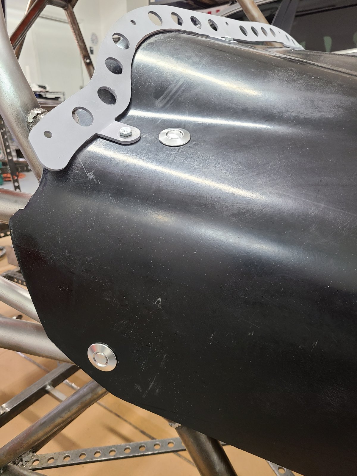

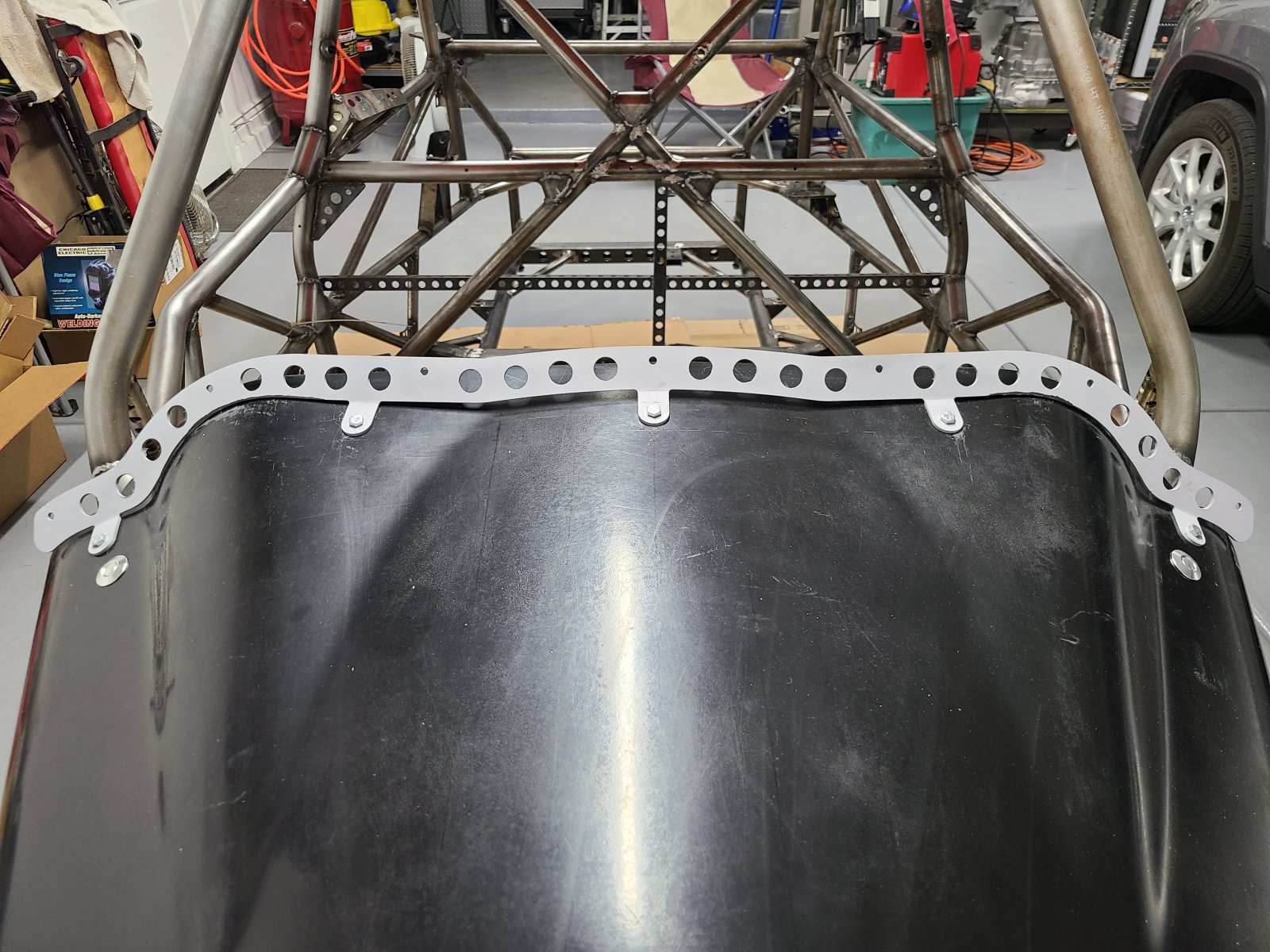

Easy peasy. Draw a line centered on the frame face end to end (I measured the frame width at multiple points to ensure the line is centered). Then measure the width between the small mounting holes for the windshield (not the frame tabs) and divide by 5, since there are 4 holes in each section. This value is the center of each hole spaced out onto the centerline mark. Center punch the marks to help align the drill bit and make some holes. Mine are 1 inch diameter and have a minor chamfer on the lip. Recommend a drill press to make better looking holes. Removes about 11 ounces of weight, but ups the cool factor by a lot.Yes, I have the stock windshield bracket. When you referred it to a frame I was not sure what you were describing.

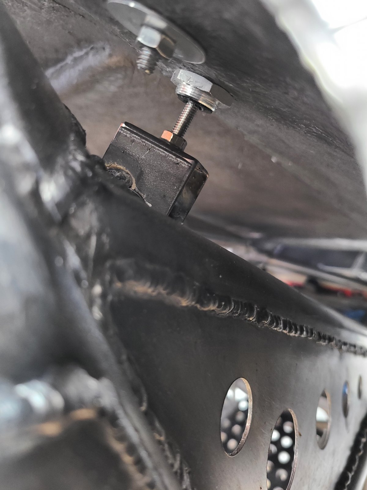

Drilling matching holes in the windshield to align with the frame speedholes is a thought, but you're probably correct about weakening the bottom of the plexi. Besides, I have my cold air plenum in my hood that will dump cooler air into the footwell area, but having some extra air a little higher up might not be a bad thing. I'll have to think about your idea of raising the windshield...Sort of a random post, but on the subject of windshield frames, I found that raising my driver side only windshield about 1/2"-3/4" allowed some very helpful cooler air under the windshield without being annoying. It would probably take a custom frame or welding extensions to the stock frame though. It might be possible to drill matching holes in the windshield, but I don't know if it would weaken it to much.
