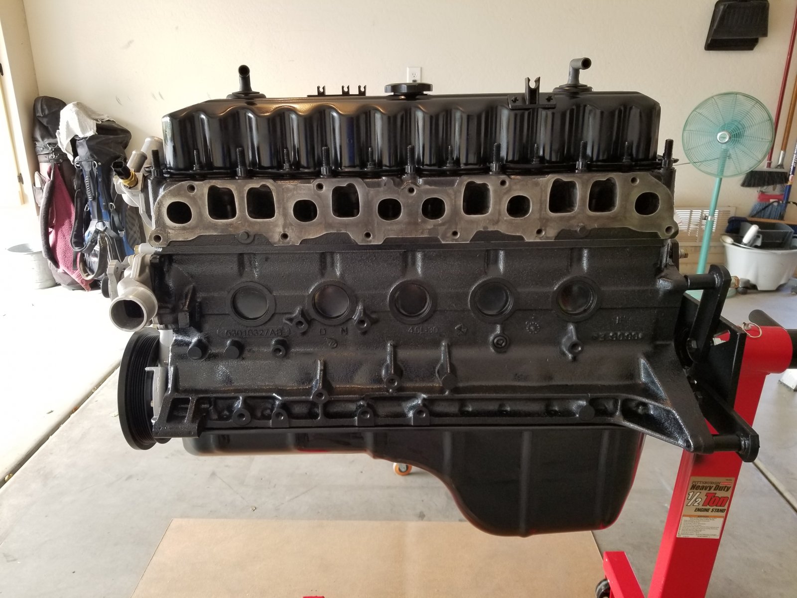

Still have my daily driver to fix. I'm prepping up the motor for the Jeep swap that should start next weekend (Labor day). Cleaned up the ports on the refurbished head and ported the exhaust side slightly - about 10% larger. The Jeep exhaust ports are horribly small, as cast, so it takes some work on the 'floor' side the exhaust port to get a little better flow. Hoping to get about 30 more horsepower from my 4.6 liter stroker I-6 over the 4.0 liter that it is replacing, but should see about 50 ft.lbs extra torque. :cool:

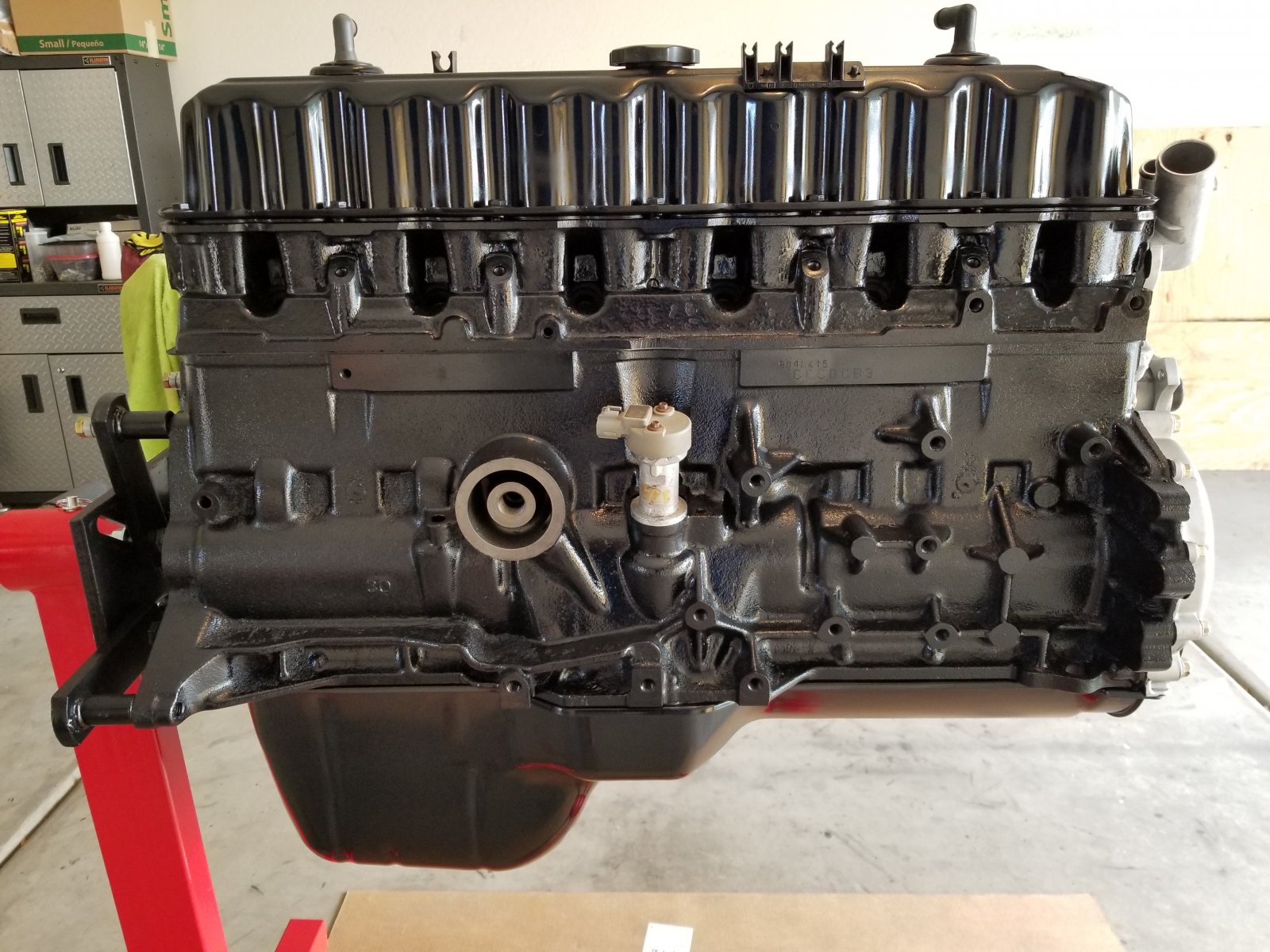

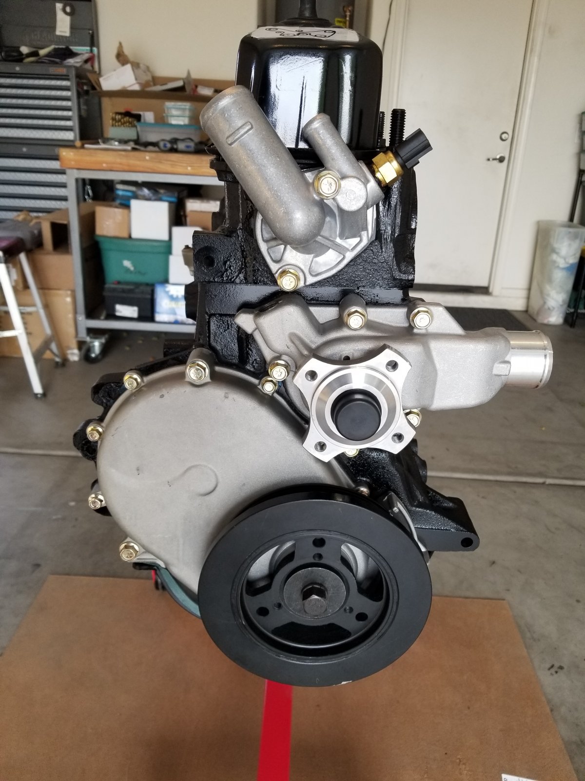

Been making the wife happy :) ; the carpets are gone, the wood floors are in and the walls are a different color, since she decided we needed to paint them because they no longer went with the deacor. :confused: Got started on the Jeep after those 4 days of 'happiness' and got the base engine built. Just need to add the externals - some of which are getting replaced as they were getting tired - that I am waiting on delivery. Guessing another day or two to get the engine completed and ready to install, plus 3-4 days to get the old engine out and new one installed and running correctly. So it will probably be another month - at least - before I can start on the Goblin. :(

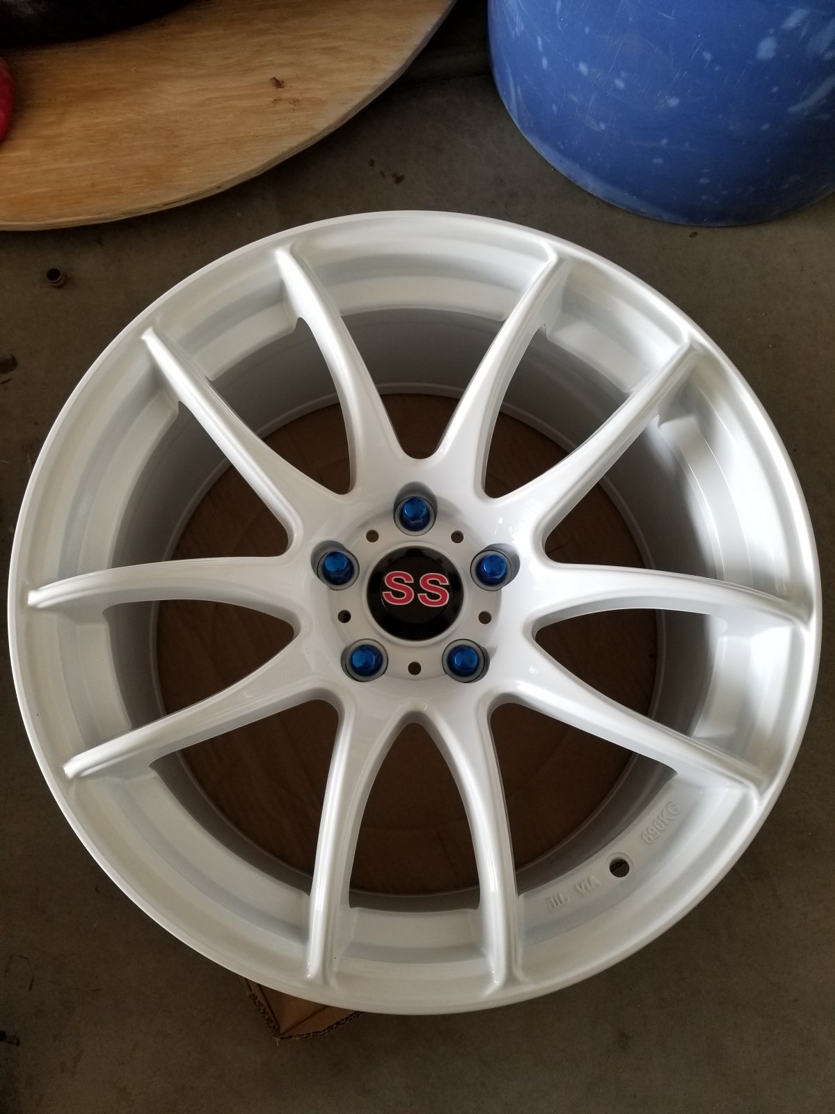

I've been tinkering quite a bit with my Goblin, doing some test fitting of things and taking many measurements to determine if my planned upgrades will actually fit - it will be real tight! :eek: I was trying my wheels and hubs, together, and found the wheels (VORS) have a 'short' center hub cutout depth and the inside face is contacting the end of the bearing hub assembly (rears) before I am making full seating onto the stud flange face. I have a little less than a 3/16 inch gap and it looks like I will need to use a thin spacer to make these work correctly. 5mm is about 3/16 inch, but I will need to have some additional clearance so the hub and wheel do not rub, so it will need to be thicker than 5mm. Anyone with a suggestion for a good spacer, please let me know.
On the brighter side, I did decide to go with a red, white and blue color theme and will keep it as patriotically tasteful as I can.....but it will be unique and noticeable on the street (I don't want to get run over by someone ignoring my tiny little car!). As I previously mentioned, the frame will be white (POR-15), the body will be a red and blue combination (still like the flag wrap, but it will be mostly cut off on the Goblin hood) with many red and blue accents in the interior and engine bay, and white wheels. I added a photo of the wheels and yes, those are 'SS' center caps - my Goblin did evolve from a SS/TC. It will be a pain to keep clean, but what else do I have to do on a Saturday morning? :)

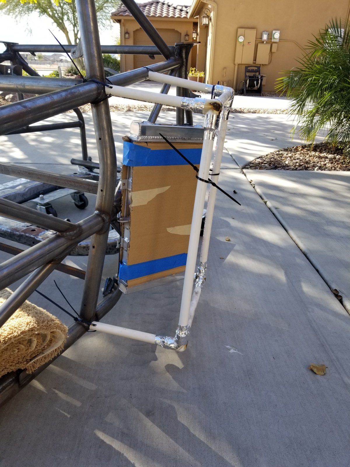

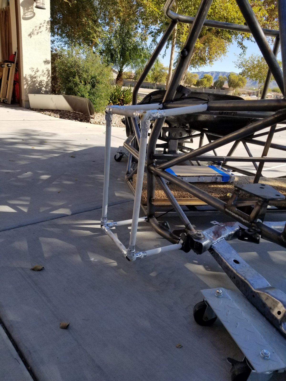

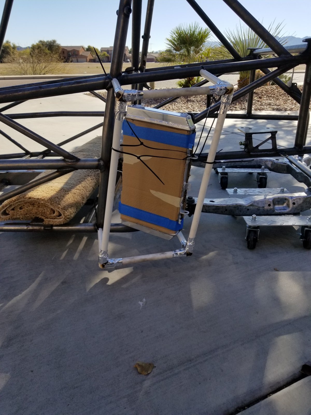

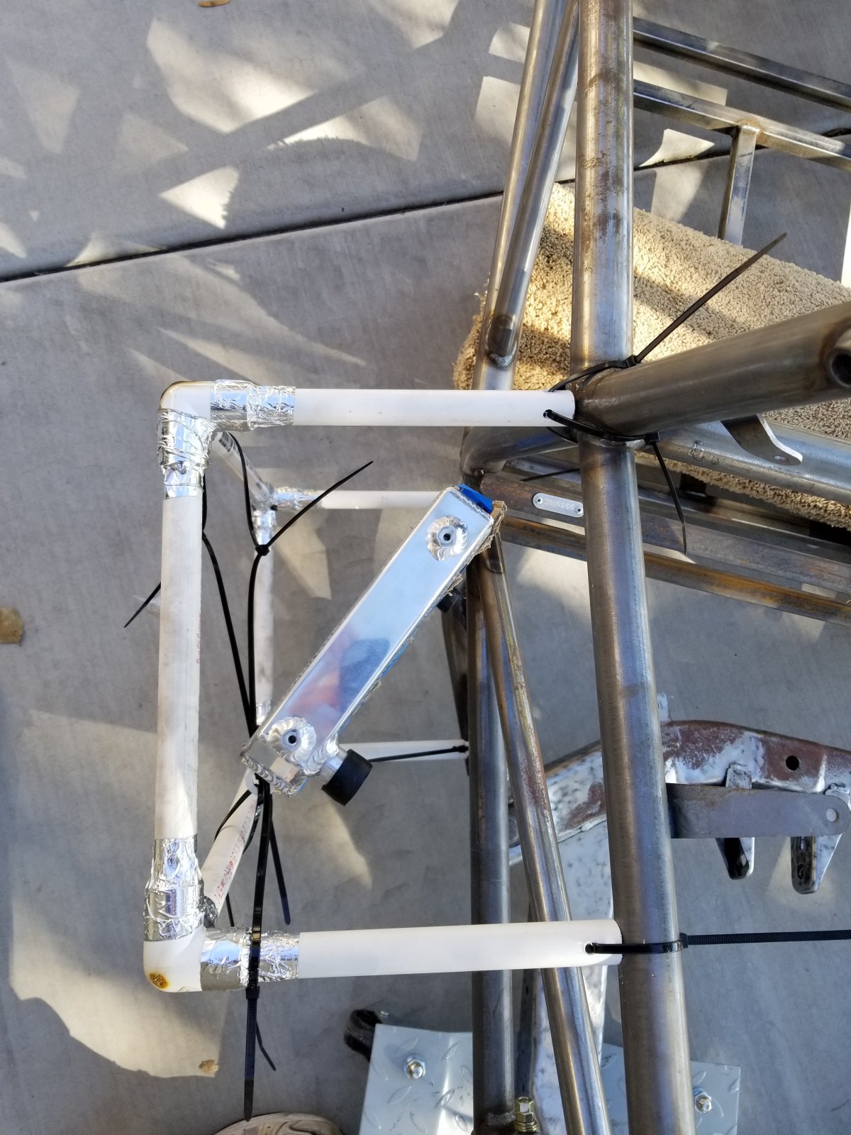

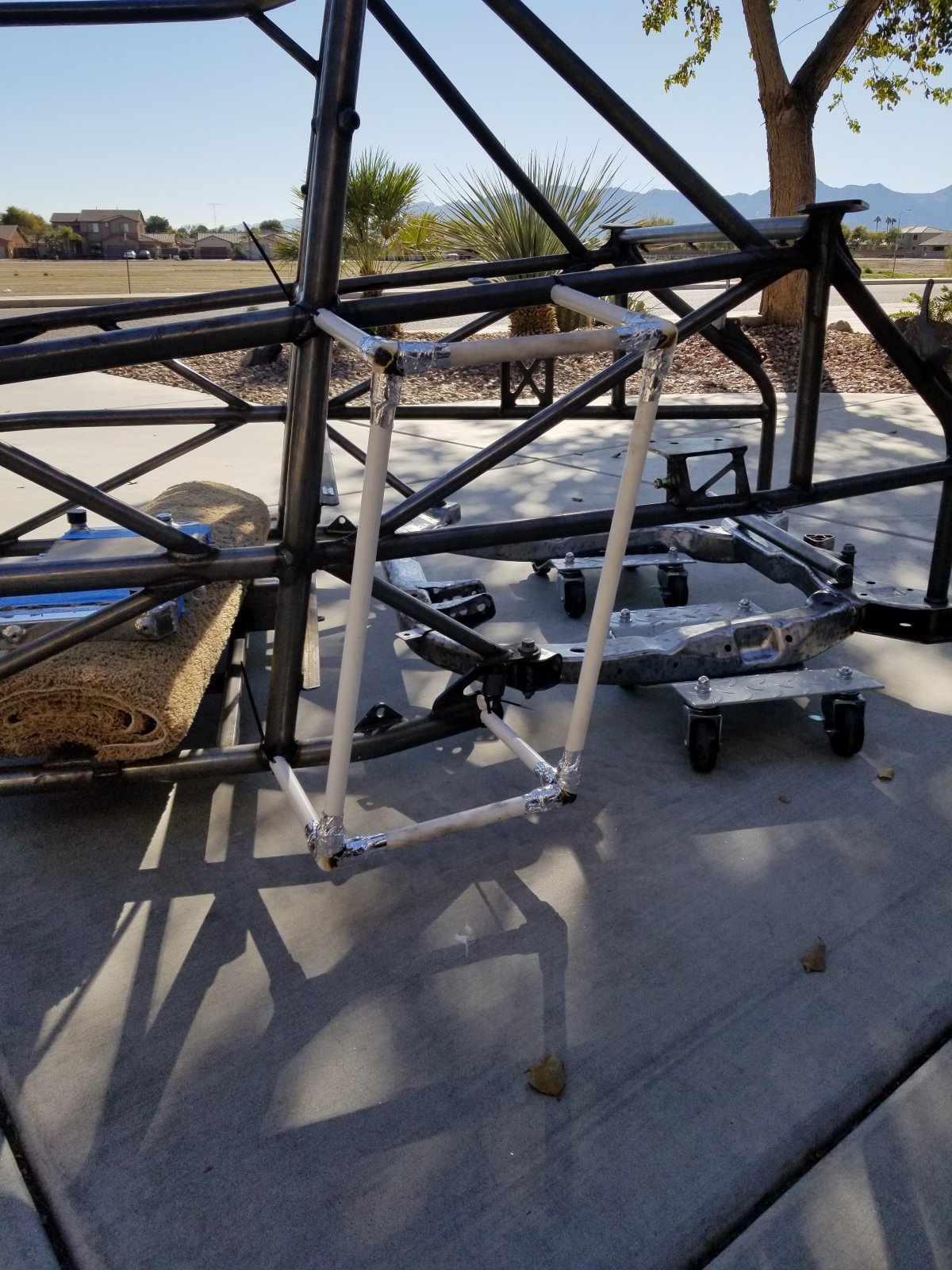

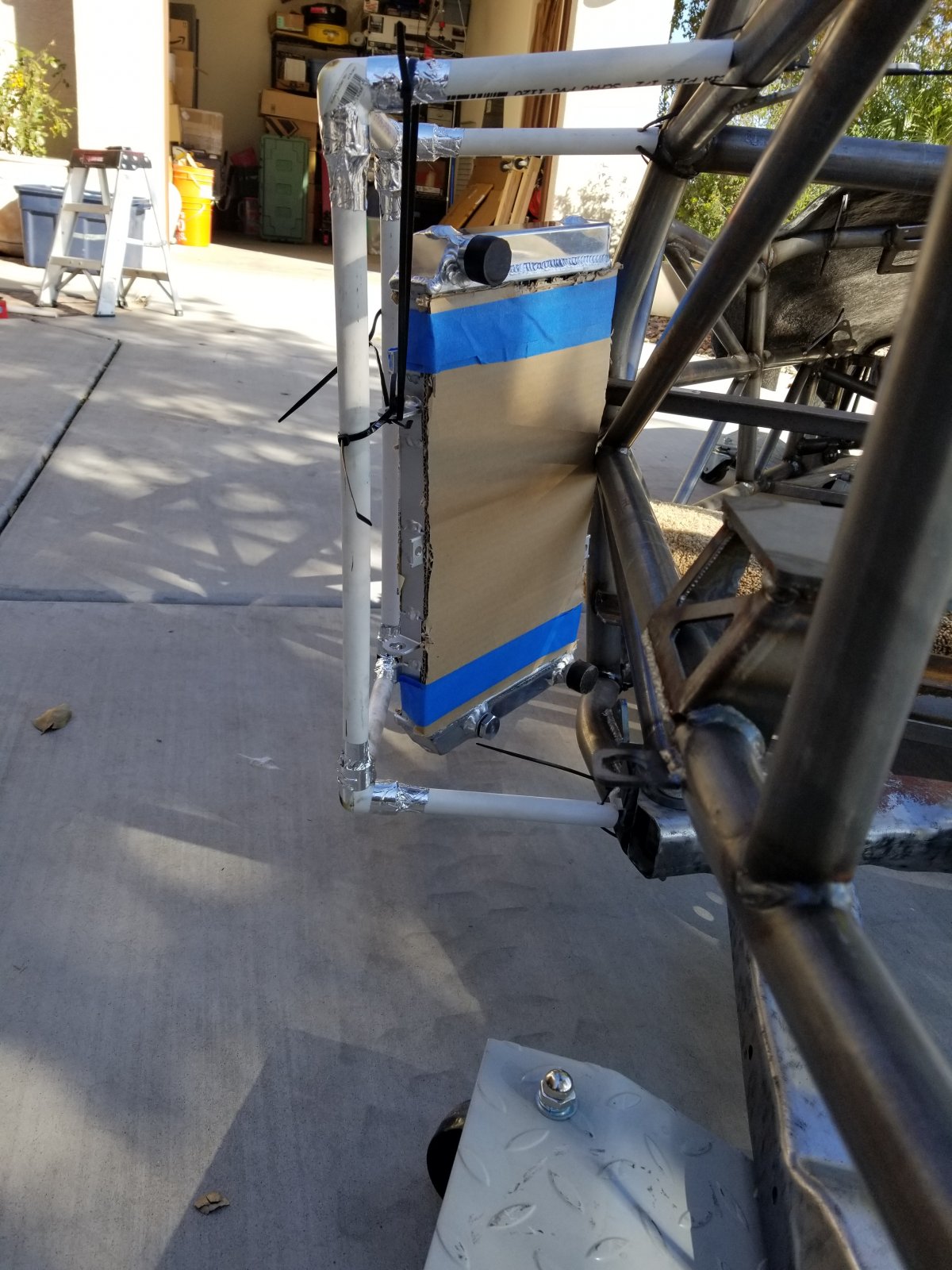

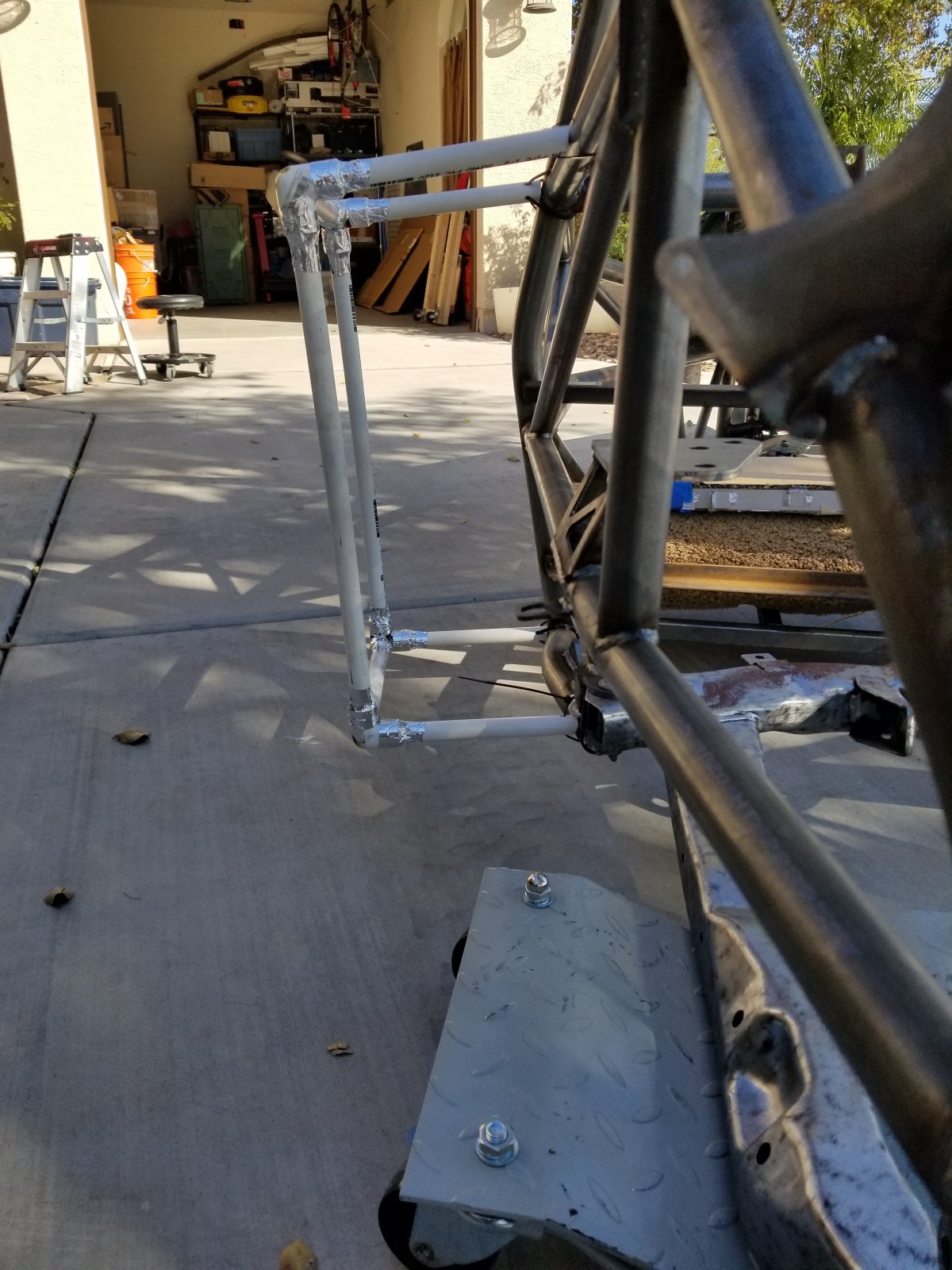

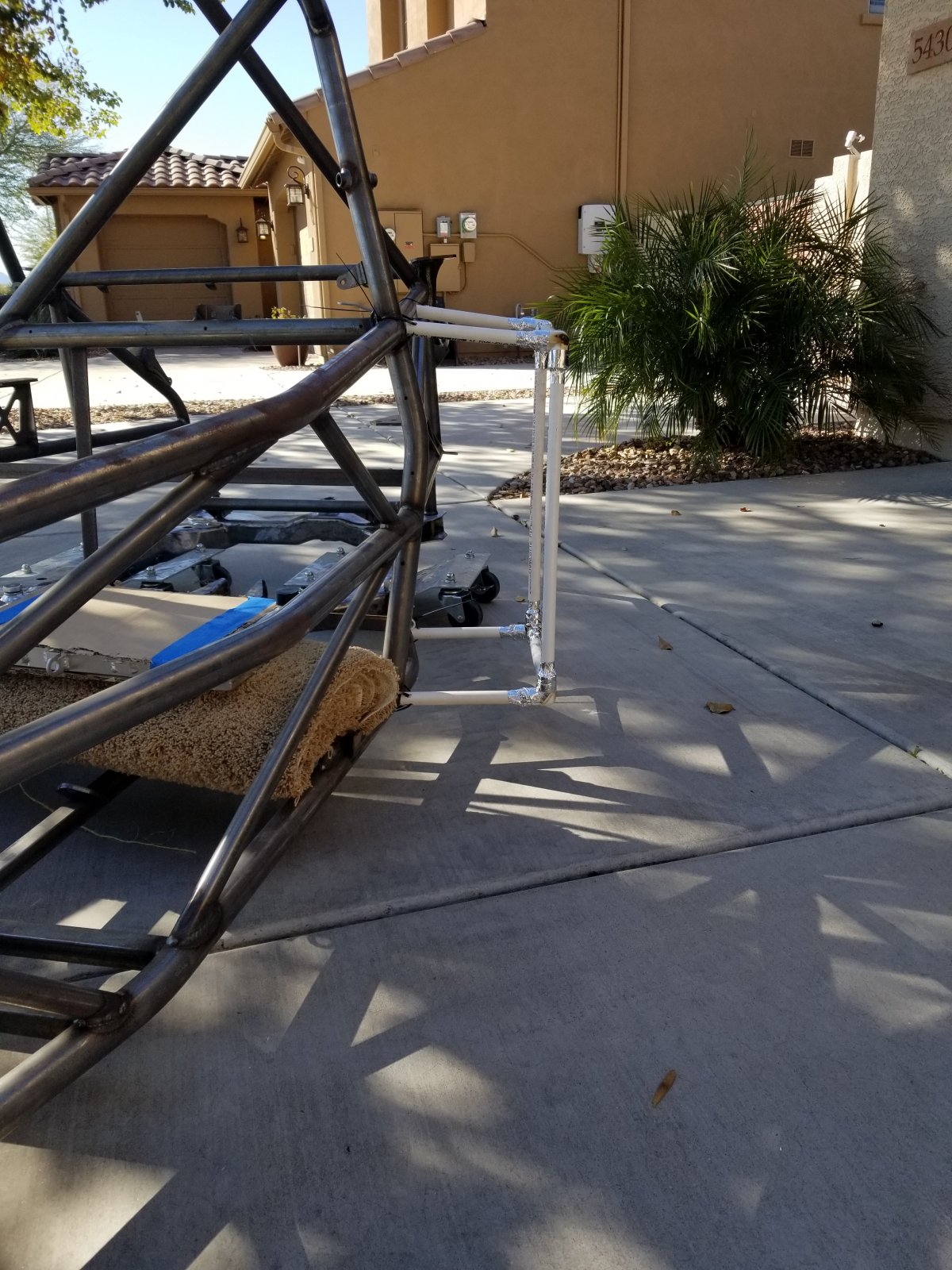

Mock up time! I am beginning to 'dry fit' parts into my Goblin to check fit and see what additional welding or fabricating I need to do before I finish the chassis. I will have dual heat exchangers, so I am mocking up side pods to house the KZ750 radiators and 7 inch cooling fans. Borrowing Tinkles idea to use PVC pipe, I put together what I think will work for my application - a trapezoid shape with a rearward cant and the heat exchanger will be angled sideways inside the housing so it minimizes side overhang. This frame will be fabricated in 1 inch tube and covered with a fiberglass shell. The heat exchanger will be baffled to ensure airflow through the radiator rather than around it. I also plan to use the space above the exchangers for a fresh air duct into the engine bay. I hope that by providing some colder and pressurized air to this area will help reduce the backflow of hot air coming forward into the cockpit - sounds like a good idea at this point, but I will have to see if this actually works or not.

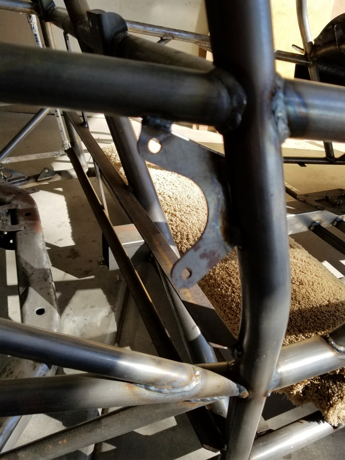

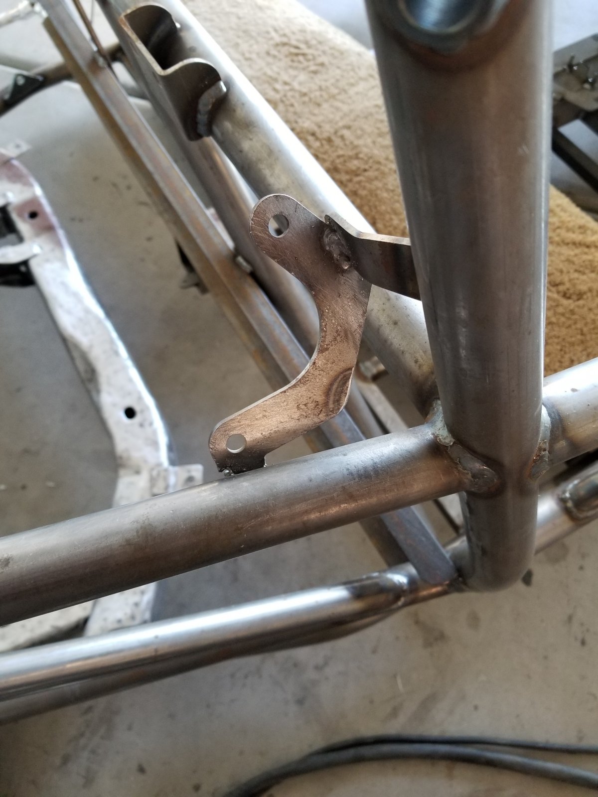

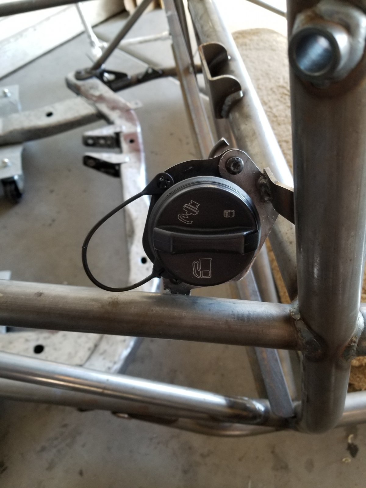

First frame mod; the location of the fuel filler bracket on the passenger side, since it would be inaccessible when the heat exchanger side pod gets added. I moved it up from its original location, using the same bracket, and utilizing the engine cover bracket as the second support location to allow it to tilt into the engine bay for a better alignment with the fuel tank inlet.

I intend to make very similar side pods for motorcycle radiators. If you get carful dimensions I can possibly bend the tube and weld it out for you when I do mune
Justin, I can get dimensions and get them to you for the mock up I put together and from the KZ750 radiators I am using for heat exchangers. I may take you up on your offer of bending and welding up some pods for me, since I do not have a tube bender available for my use. Give me a couple days to get the exact dimensions sketched out so it makes sense, I will post them here, since others may benefit from them. Question, how tight of a radius can be made from 1.000X0.095 or 1.000X0.120 tube? I seem to recall something like 2 1/2 or 3 inches? Thanks, Tim.
Edit: BTW there is 1.000X0.120X72 inches tube on eBay for a reasonable price with free shipping (listing 324016888096)
JSATX
I prefer 3” radius and there’s really no reason to go more than .065 wall, it’s plenty strong. I have already bought about 40 feet of it.
