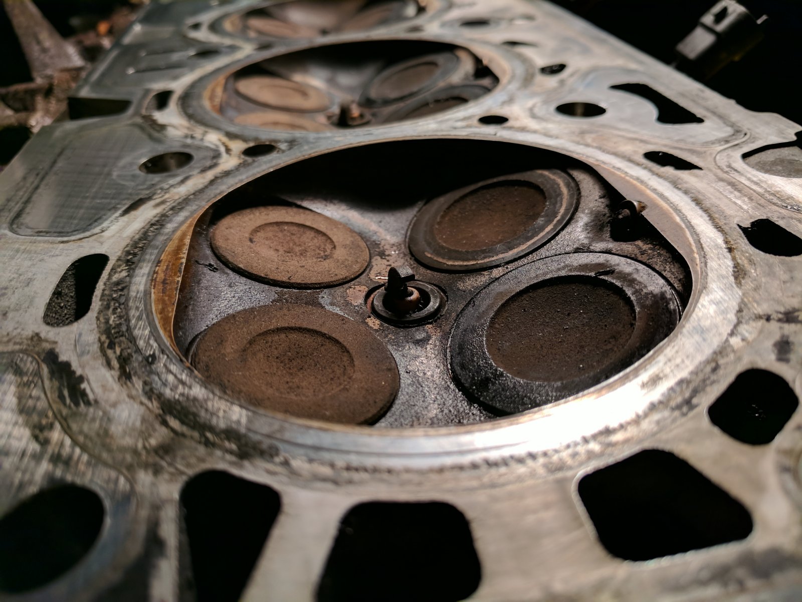

I'd do a compression test. If something seems off, take off the exhaust and intake manifolds and check for any bent valves. Any bent valves are easily replaced for only 10 bucks a valve at ZZP. If you need to remove the head I would forget the TTY bolts holding the head on and use head studs.

Alright, I finally got going and got the head off the motor. I do need some assistance though, from what I can see...the valves look good. But I am no mechanic. What should I look for to verify if they are bent? I dont really even see any kissing marks on the pistons. I'll post some pictures below...
Here is the full pictures of all the valves. https://www.amazon.com/photos/share/7hVZwKDVH3IX7HRQzQvRNNZAL3THLLBqLsmivltCNAI
They appear to be fine. The buildup appears to be mostly uniform and undisturbed and you said there werent any marks on the pistons.
If I were in your shoes, I'd clean them off and call it good. Don't use a wire brush if you do though. Toothbrush or walnut shell media blast.
