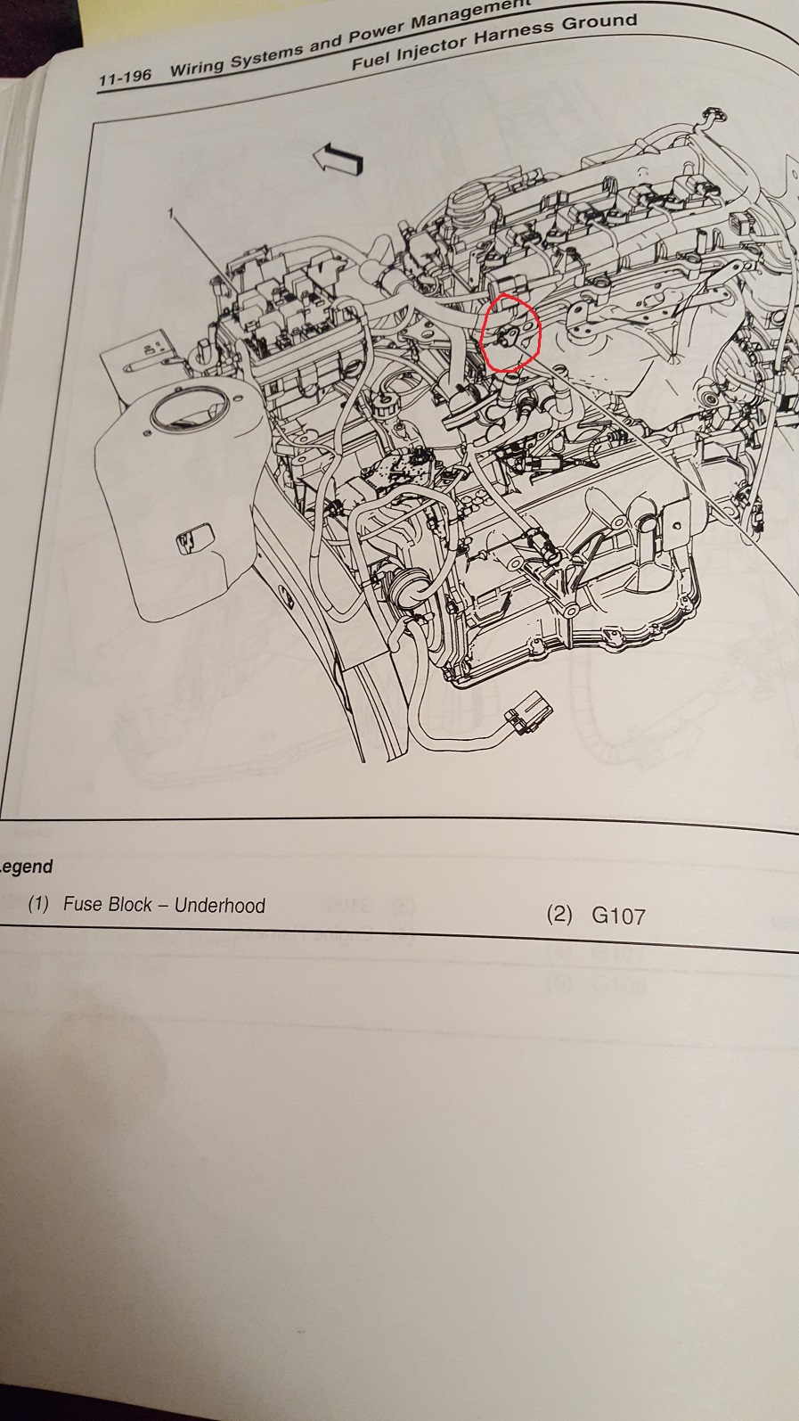

Is this the one you're talking about? Can you post a pic? I don't remember coming across this wire when I took my harness off so I'm wondering if I forgot something too.
Karter2026
I noticed that too after looking in the service manual. I couldn't find that ground wire on mine so I'm wondering if I forgot something too.
Can you post a pic?

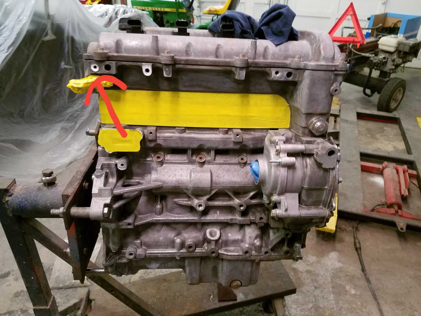

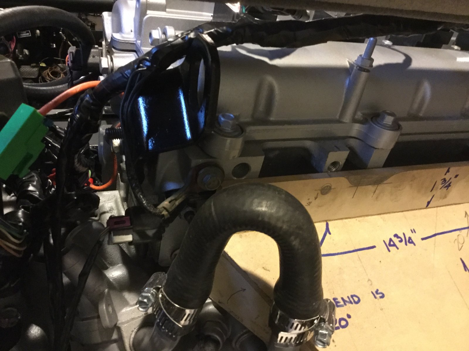

The red arrow is where it attached. I think it was a copper eye terminal. I wont getva picture of it on the motor till Saturday.
I guess the LNFs might be different. I only found three single wire engine block grounds. One behind the alternator, one on a transmission/engine stud, and the pictured one.
I probably just bolted it in the wrong hole. Hopefully it won't matter. A ground should be a ground.

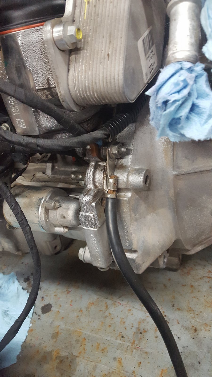

That's awesome. Nice find. That wire is definitely a ground that's supposed to connect to the stud on the transmission housing. It's the same stud that your big engine wire ground connects to. I think it's to the right of the starter.
BaltimoreHokie
An
That's awesome. Nice find. That wire is definitely a ground that's supposed to connect to the stud on the transmission housing. It's the same stud that your big engine wire ground connects to. It's off to the side of the starter
Man thanks so much for your ongoing help. You've made this process so much easier Anyone have a picture of that ground?

Not that it really matters, but my ground was on the other stud in the picture just to the left with a nut on it. Both ground for the battery and the multiple ground wire connection.
