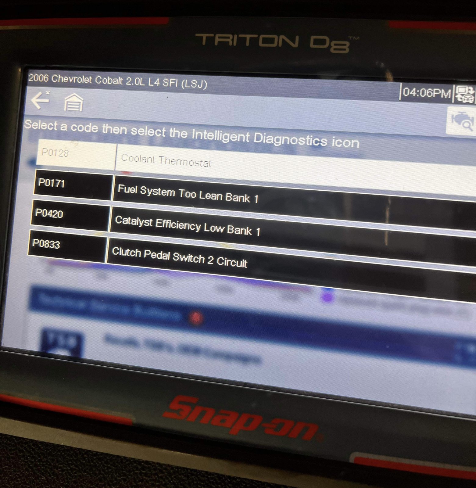

Any major concern with these codes?
P0128 didn’t find any definitive answers, bad sensor?
P0420 caused by a bad O2 sensor.
P0833 could be a bad switch or wiring concerns

I would try to check what your STFT and LTFT are when the code comes up for P171. That looks to be the only engine harmful one. You can also see if the O2 sensor is cycling around Stoic to confirm the engine has enough fuel to run. If you do not have a cat, then you will throw the P0420 code. The others are wiring or sensors.
Traé
It’s on a car I’m looking to buy. The guy was a little quick to take my offer and sent me the codes. I share the same concern about the P0171. The car is 7 hours from me and may not drive out there if I’m going to get it home to find issues

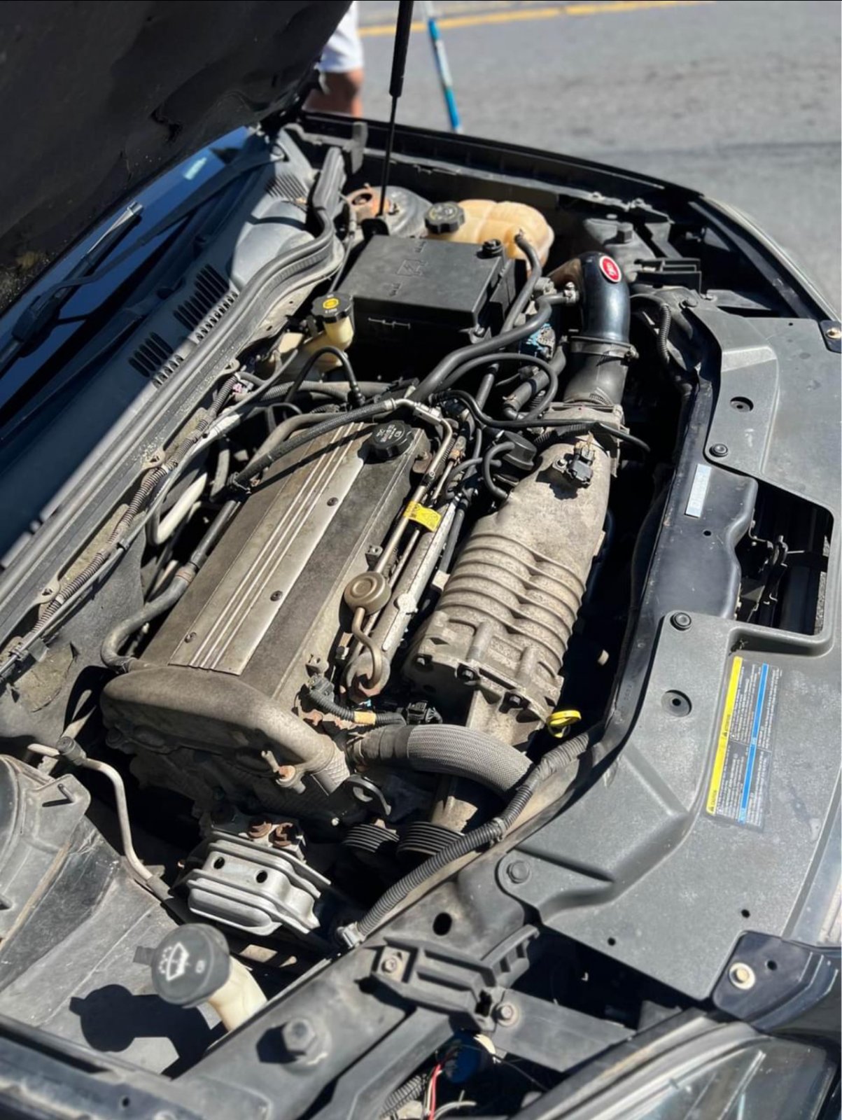

Could be a few things on the p0171. If all stock, look for vacuum leaks and such. With the intake runner zigzagging down into the finder, there could be a loose connection sucking in air.
if it’s modified, it could be a programming issue. People like to add cold air intakes, smaller supercharger pulleys and such, but not program to compensate for the mods. Do you have any picture of the engine compartment ?
the other 2 codes don’t matter, but you can use the cat code to drop the price
Joebob
I personally would pass on the donor. Here is someone who is FAR away selling something for probably very cheap. they show you the error codes on an expensive Snap-on tool. they probably say that the fixes are easy but if he has such a tool, he can fix the issues and has decided not to....why....because they are not simple fixes. the motor doesn't look bad but not loved by any means. My bet is a flip of something they thought they got a good deal on and are passing the buck.
