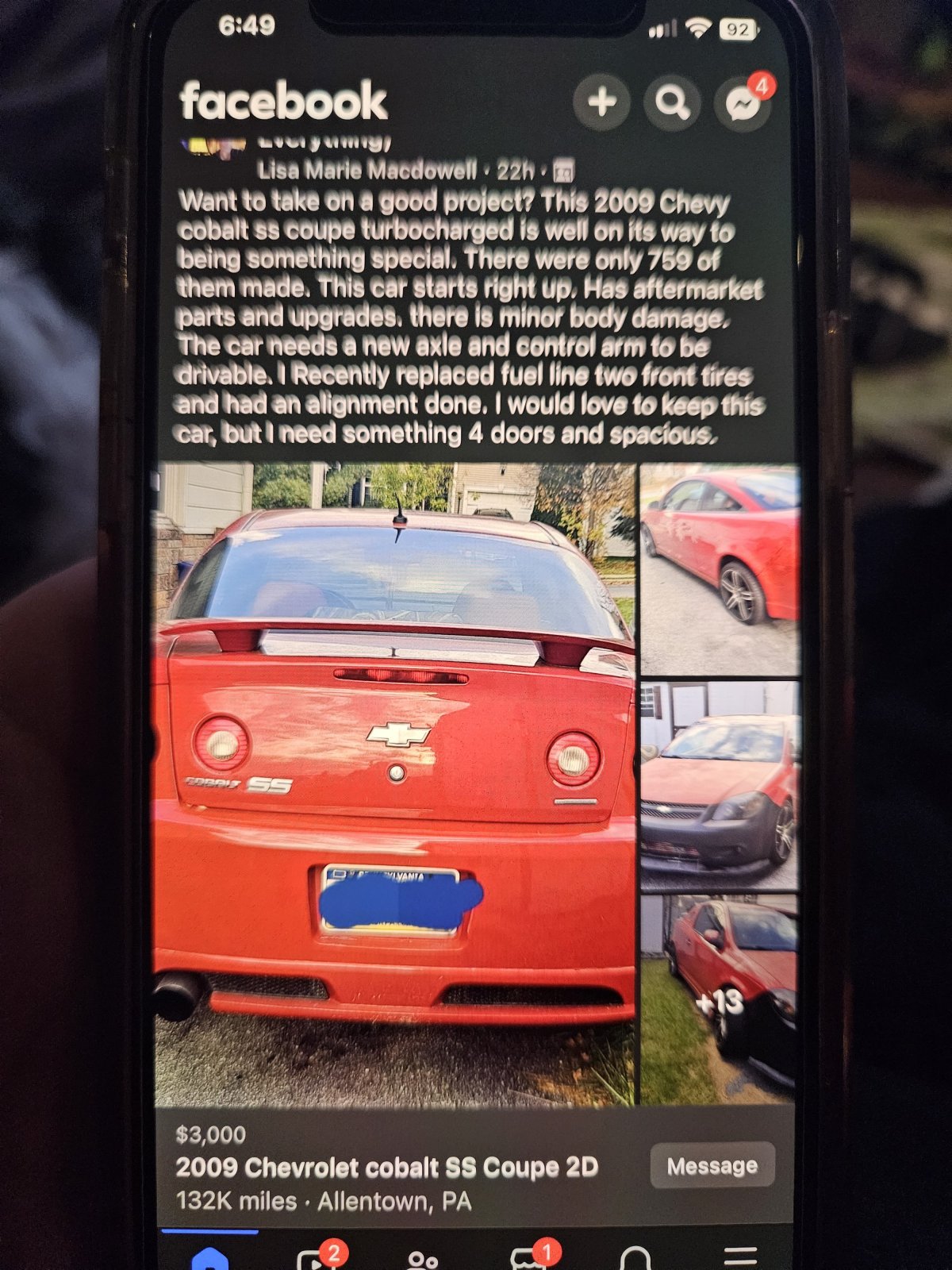

This popped up in Allentown on my wife's feed. I don't do FB.
comegetjoe
$2400 you could get him down to. Body damage alllll over that thing, bumper paint, body panels are different colors of red, fenders pealed back into the side skirt and side skirt hanging off, busted out passenger rear window etc. Talk him down on stuff that doesnt matter on the goblin.
If it had original wheels Id be looking at it this weekend. It IS an RPD car which is a cool option in 09.

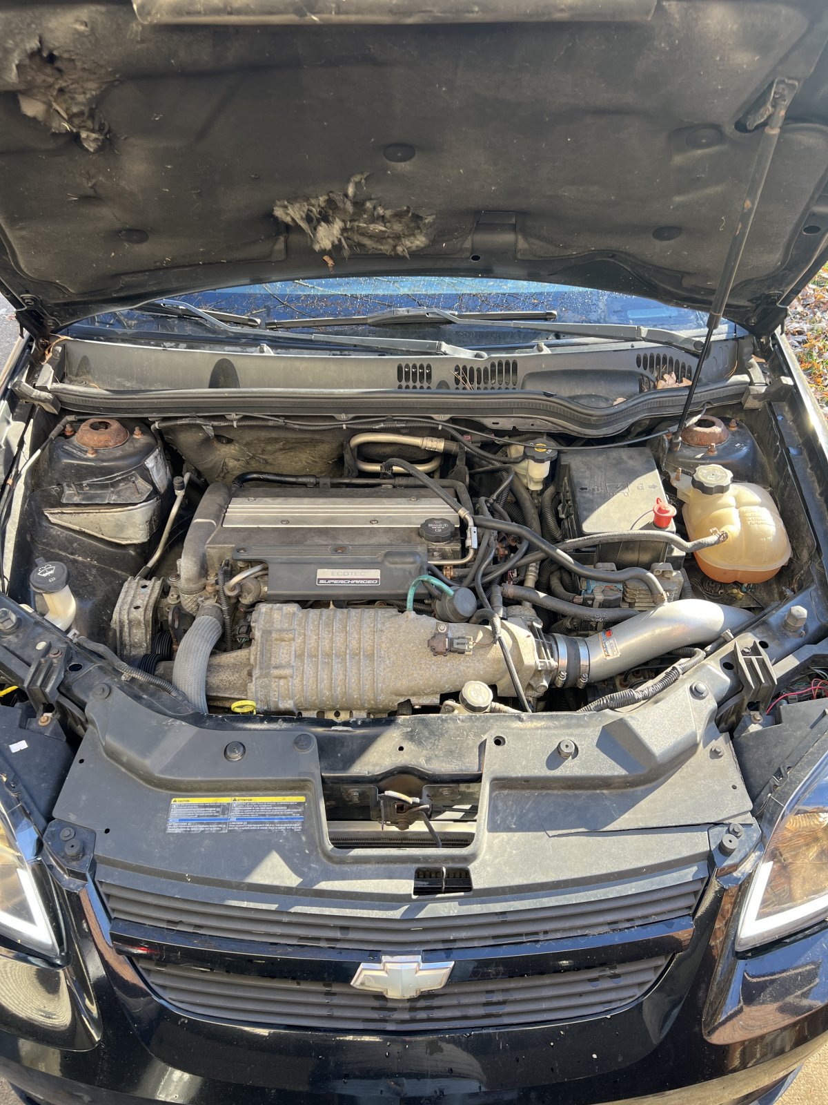

I’ll look into that. Not sure about a tune but I planned on getting it tuned anyways to make sure everything is kosher since it has some aftermarket parts and I was told “not tuned correctly”. Has a 2.8” pulley installed and missing a screw :/
Pic of the engine bay, there’s a green hose that is loose and looks out of place. Not sure what the thing is it’s hooking up to but I plan to research the name of all components.
