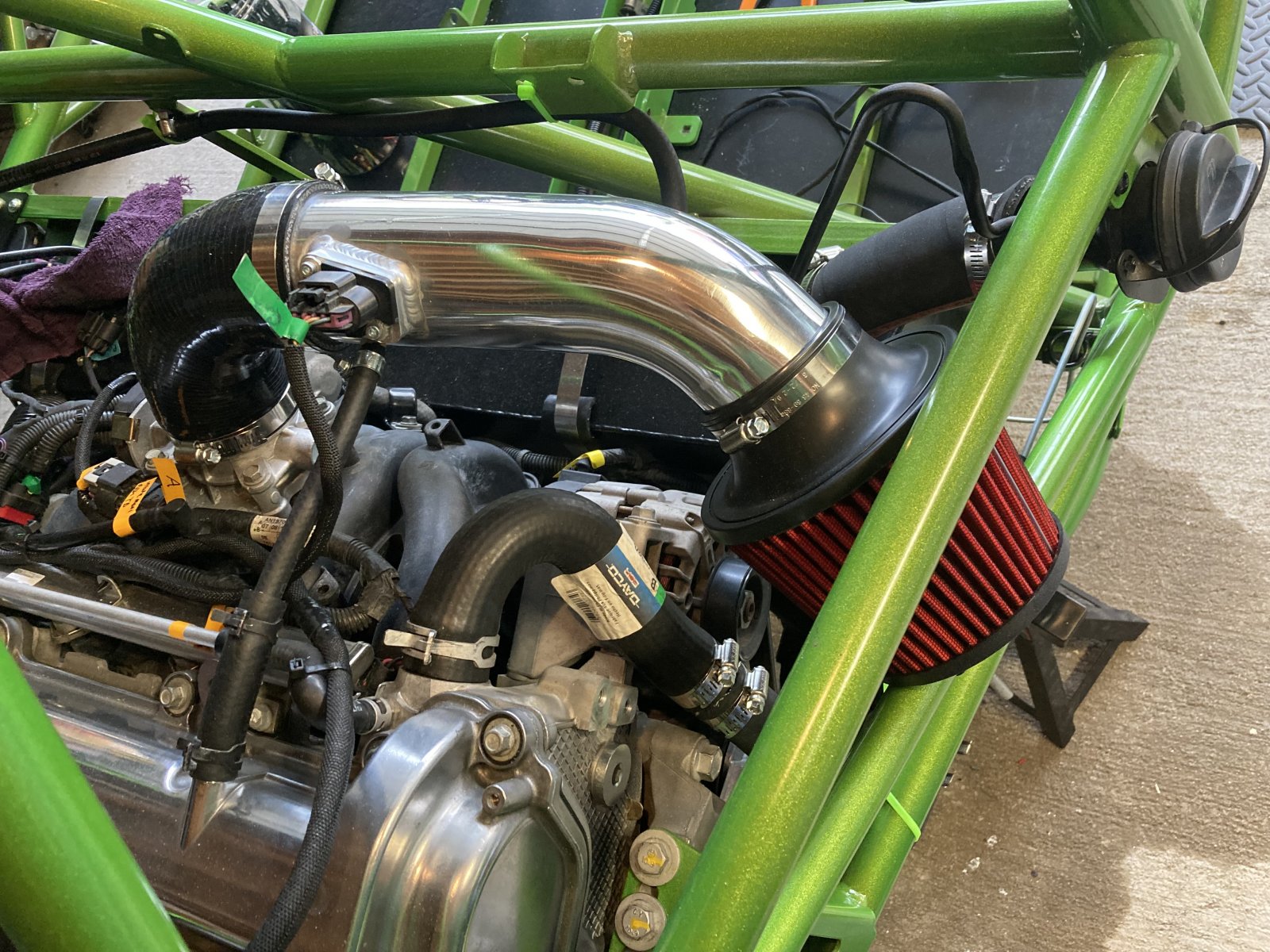

The engine prep videos show that you pull the MAF wiring out of the bundle to allow you to route it as needed. I plumbed up my intake as shown and in this position, I think the stock wiring would have been enough, but I did not need an extension.
