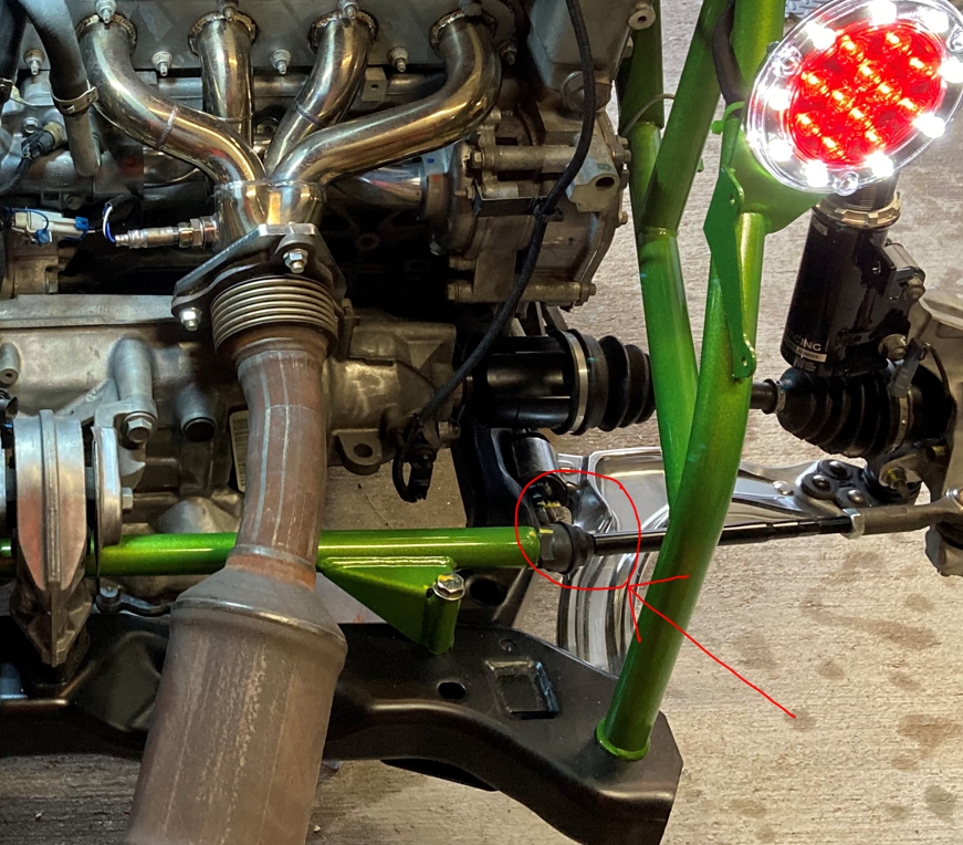

This knob seems like it is just begging for someone to twist on me when I’m not looking?
Found these grey covers today at Ace Hardware. Yellow ones may have fit right over the threads but I think the yellow would clash with the frame color.
It was too lose just placed over the theads.
so I removed the Black cover that came with the Shocks, placed the gray cover over the thread, and then squeezed Black cover over the Gray cover.
I like it.
I like it.
I think the black plastic cap is for the inner tie rods that attach to the steering spacer behind the engine.

Great, that’s what happens when you don’t pay attention to what came with what. They just seamed to be perfect fit for that top nut.
Wonder if I could purchase some extra ones some where?
Brett
Toe Link Boots are in the DF store. ;)
I kind of want to order a set for this application.

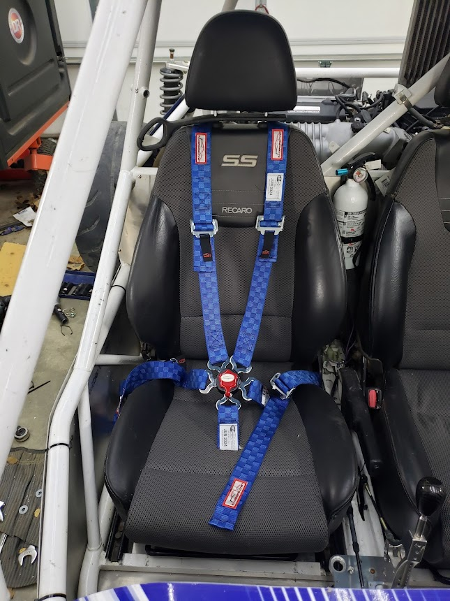

Always thoght I might initially use the stock seat belts instead of dealing with a 4 point harness every time I get in and out, but after seeing how ugly they look I’m off to order a set of 4 point harnesses.
What are your thoughts on the following?
I just installed a harness, and had to learn about them.
29199
The lap belts are easier to adjust if you have pull up belts. Those are pull down, which works well if you have someone outside the car bucking you up. Pull up lap belts just mean you grab the red strap, and pull towards the center latch. The black loop is for releasing the tension. Shoulder straps are always pull down. Also the 4 point belts tend to lift the lap belt, as the shoulder straps pull them up. 5 point systems should have a hole in the seat, but help lower the lap belt.
Jareth
Once you have them adjusted to your self is it just a mater of cliking your self in for the near future or are you always pulling the straps Ever time you get in?
You probably will leave the driver's straps the same. The passenger side will probably get adjusted more, if you have different passengers. I sometimes put stuff behind the drivers seat (Like milk, and water jugs), and have to slide my seat forward when I do.
I am going to try to leave the Cobalt belts on the drivers side, as daily driving I don't want the hassle of the racing harness. The SCCA instructor I met at Houston autocross said that some cars have both harnesses on one seat. So that is what I am going to try to do.
