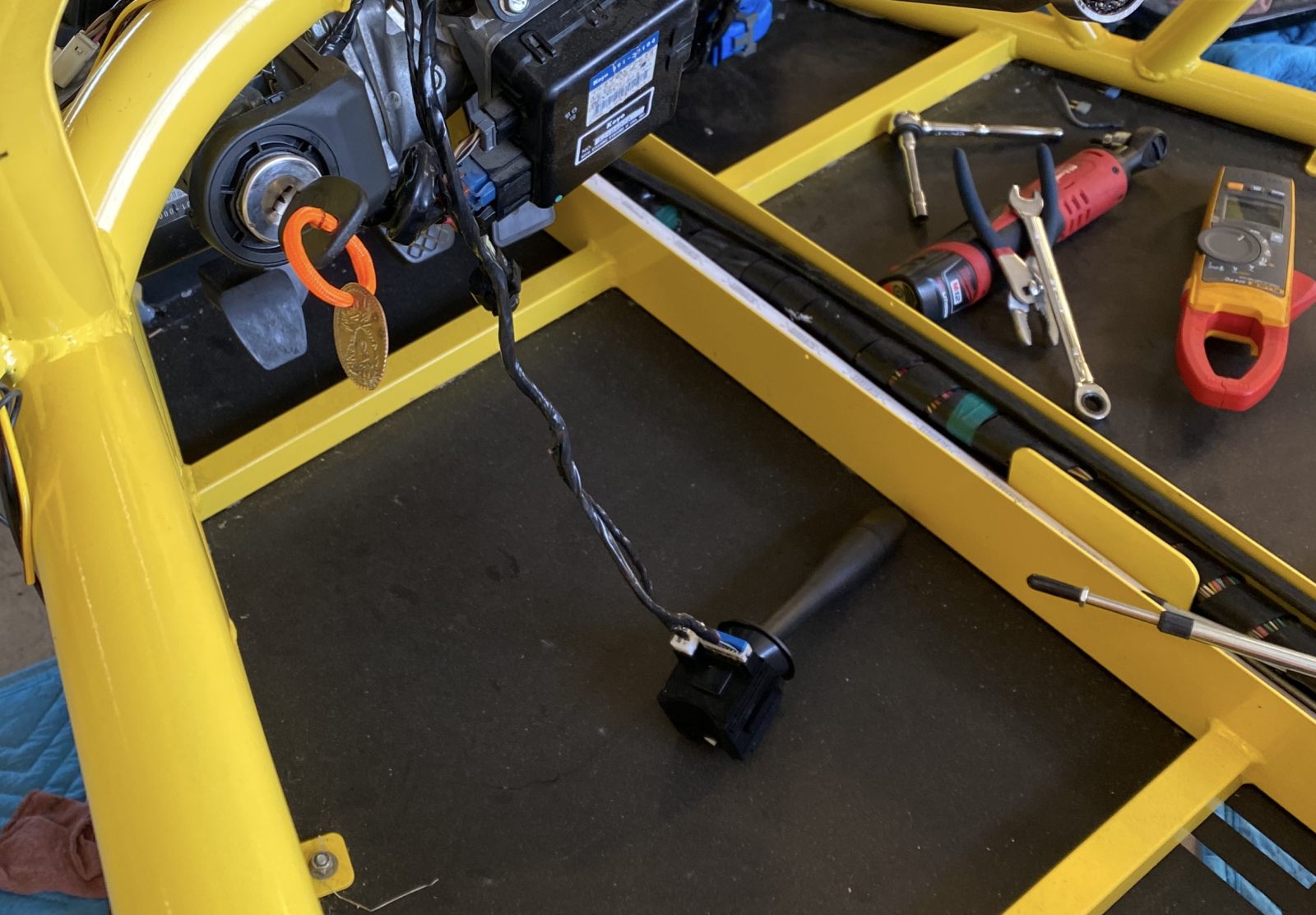

Here’s a pic of inside the tower. Cooling lines on one side and electrical on the other
