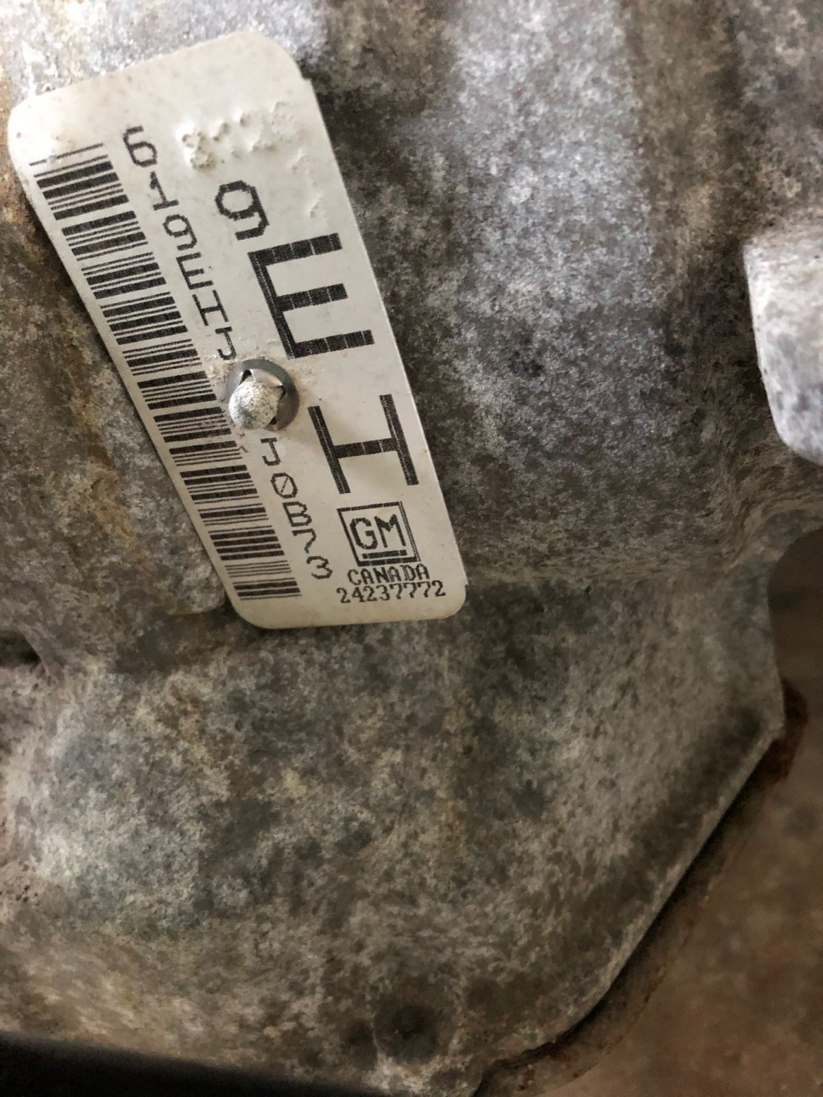

Since I am new to this I have a 2 part question.
1. How do I determine what engine I have?(2.0 or 2.2) I know that it's from a 2010 base cobalt, and can a supercharger be added to it?
2.How can I find out what transmission I have ? f23 or f35? It is an automatic. Pic below is the only tag on transmission.
Thanks!
Brian

comegetjoe
What is the automatic thats used in the 2010 HHR SS? They had automatics that, i assume, would be plenty stout to take a supercharger and 2.2 setup.
jirwin
Same trans. I think it'd be fine too. Without going under a 3.1 pulley you should be pretty alright. I too recommend finishing the build first, but man is it night and day with the supercharger. Much higher smiles per gallon

If anyone ever wants to break down what the numbers mean on GM transmissions, it goes like this:
4- 4 gears
T- transverse (front wheel drive)
45- 45 series (the higher the number, the stronger it is)
E- Electric shift/controlled

Since it’s the same trans as the HHR SS I’d say you’ll be fine. it also looks like there’s goodies like a shift kit and such available, which means if you overpower it, there’s a solution. From what you are describing on how you want to drive the goblin, chances are, you’ll be fine.
