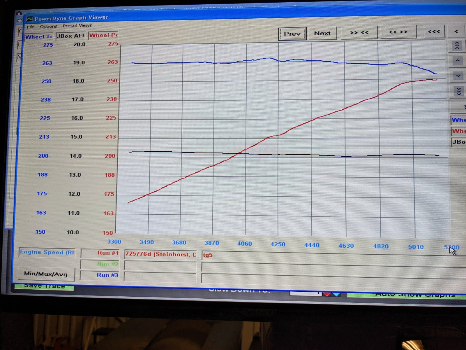

There's at least 4 of us who have supercharged our 2.2 motors codenamed the LAP. When you get to that point, shoot me a message and I can give some details. I'm at 250 WHP with a smaller pulley.

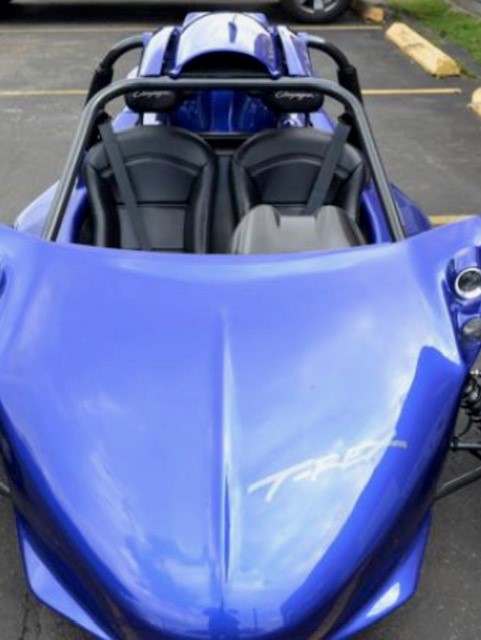

Thanks I'll keep this in mind when I get to the point of adding it on. Right now I am doing more cosmetic things to it, Adding a front removable roll bar, getting it powder coated, then off to the fiberglass shop for a custom engine cover with a small air scoop, then seats recovered with a marine type material for better protection. Then engine work.

I have a good fiberglass man here and I was thinking of a cover that will go from the roll bar that has the cpu over the top to the other side with a small Indy car type of air intake that will stop at the rear roll bar behind the driver and passenger head. I have a pic that looks close to it, by some modification need to be done. It won't go all the way to the front roll bar it will stop at the rear roll bar.
Send out a pic when you get the engine cover finished
