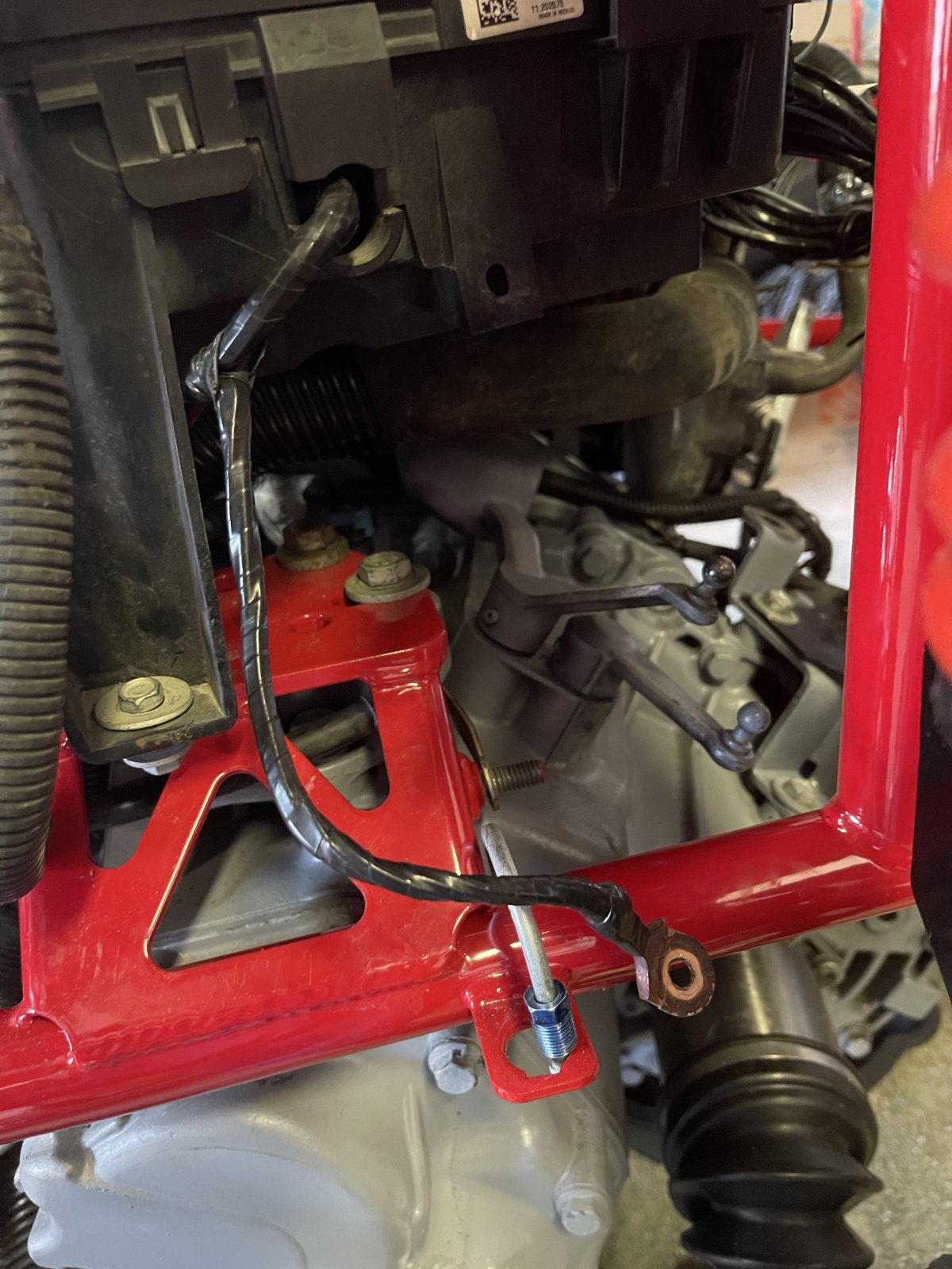

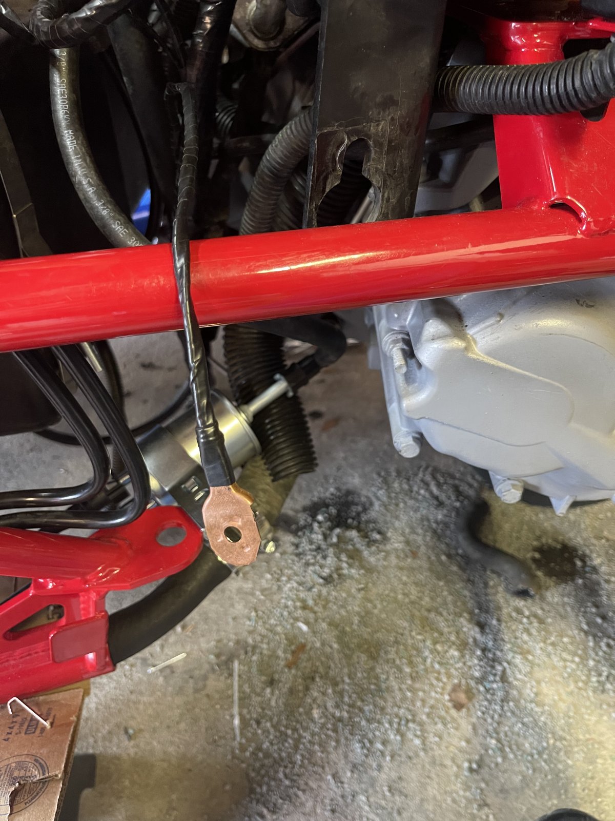

I have a DF completed harness and they did a fantastic job well worth the money in my opinion.
Issue is I have two extra grounds from the harness in the engine side that do not fit on the rear body ground or the ground studs on the battery box…. I am not sure where they go….
I do not have any grounds in the middle of the chassis I was assuming this was because it was a new type of design? Are these grounds meant for the middle?

Use a step drill bit and enlarge the hole in the ground lug, then attach it to the stud in the frame below the fuse box.
