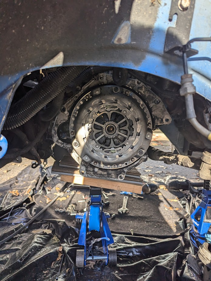

new clutch kit installed. i made a big mistake and thankfully caught myself. i forgot to tighten down the 3 slave cylinder bolts and iv already got the trans almost completely wiggled on but not bolted. woops.

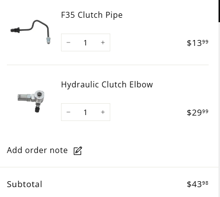

looking over what they have it looks like a good deal so ill go ahead and order the fitting which is called a hydraulic clutch elbow and a f35 clutch pipe. it wont arrive for a few days so itll be good to take a break. whats more fun then dropping a transmission once? doing it twice! maybe even a third time?! with the engine at 175k miles this all may even be pointless! no idea how long the engine will last, it could crap out a day or two after fixing everything haha
