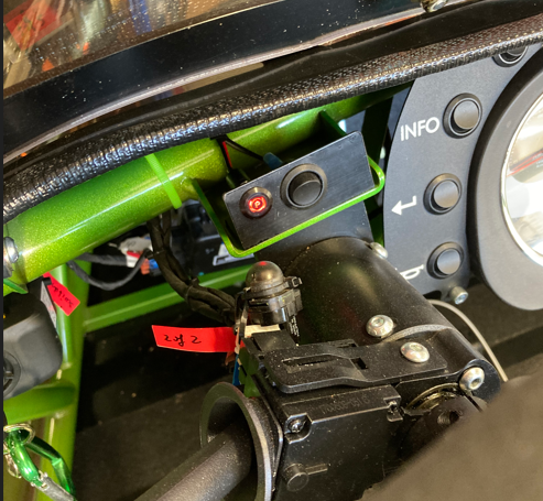

Other news, I think the car believes that the parking brake is still on, or something, because I cant shift into gear and the BRAKE light on the dash stays on. I have been pulling on the locking solenoid inside the shifter to shift. The key still does not want to be free without also pulling on the solenoid which I have 'fixed' by zip tieing it open

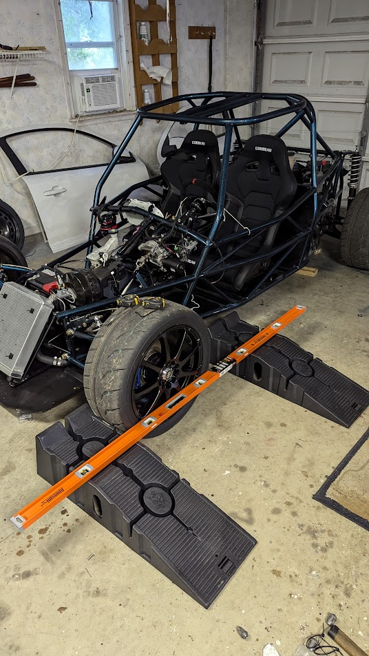

Also worked on front toe to be equal so its ready for an alignment

I think the BRAKE indicator is going to stay on because we pulled out all the ABS stuff.
The shift solenoid should actuate with key on and brake pedal pressed. Mine actually stopped working the other day and I'm going to troubleshoot it while I'm replacing my floor pan. I noticed a bare wire at the shifter which is probably my problem.

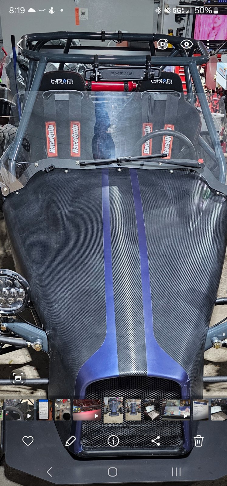

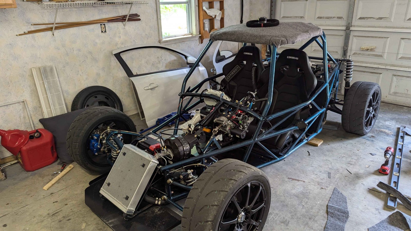

Function over form, a cloth top to keep the sun off, had no plans on actually doing this but its giving me ideas to make one that is legit using prototyping foam, invoice should be coming in soon from what im told, will be having the rest of what i need crated in, hood, fenders, ect

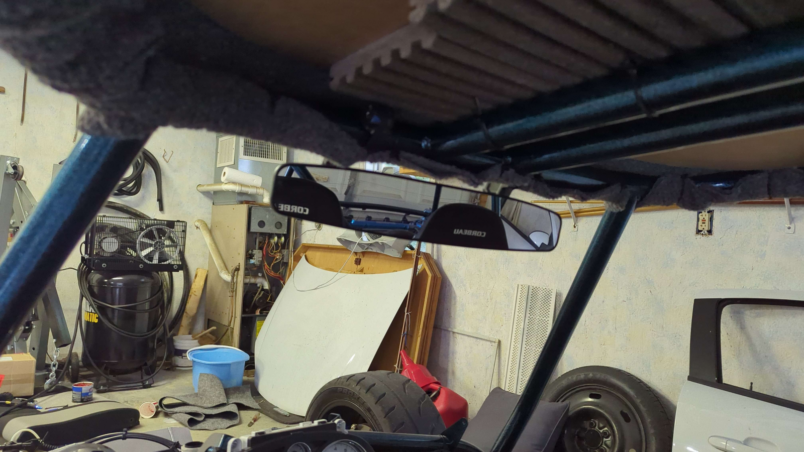

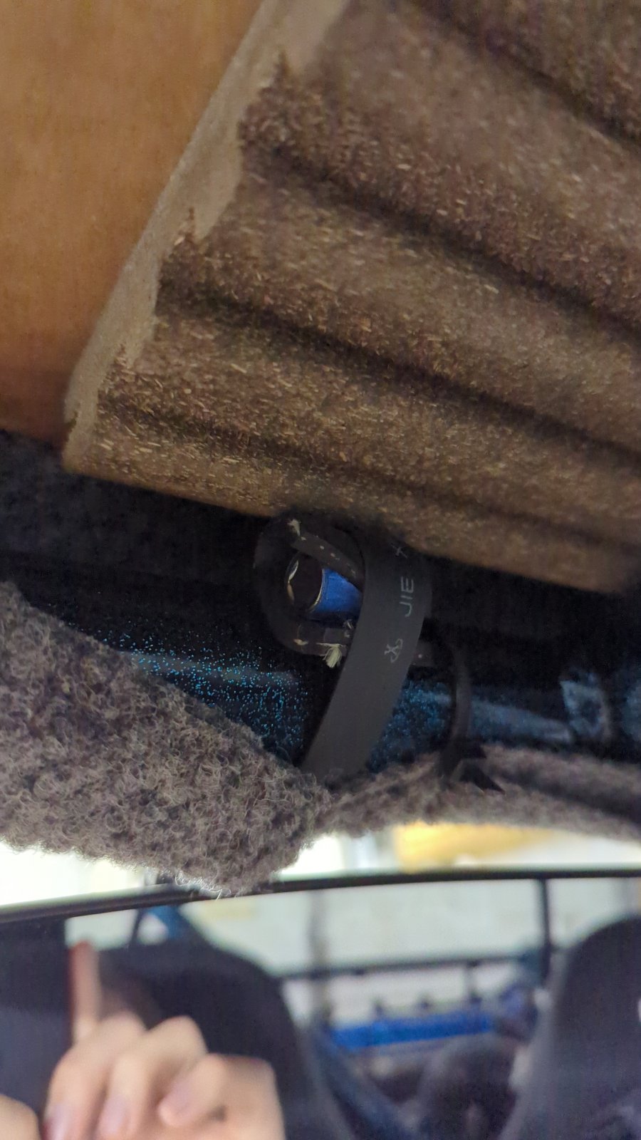

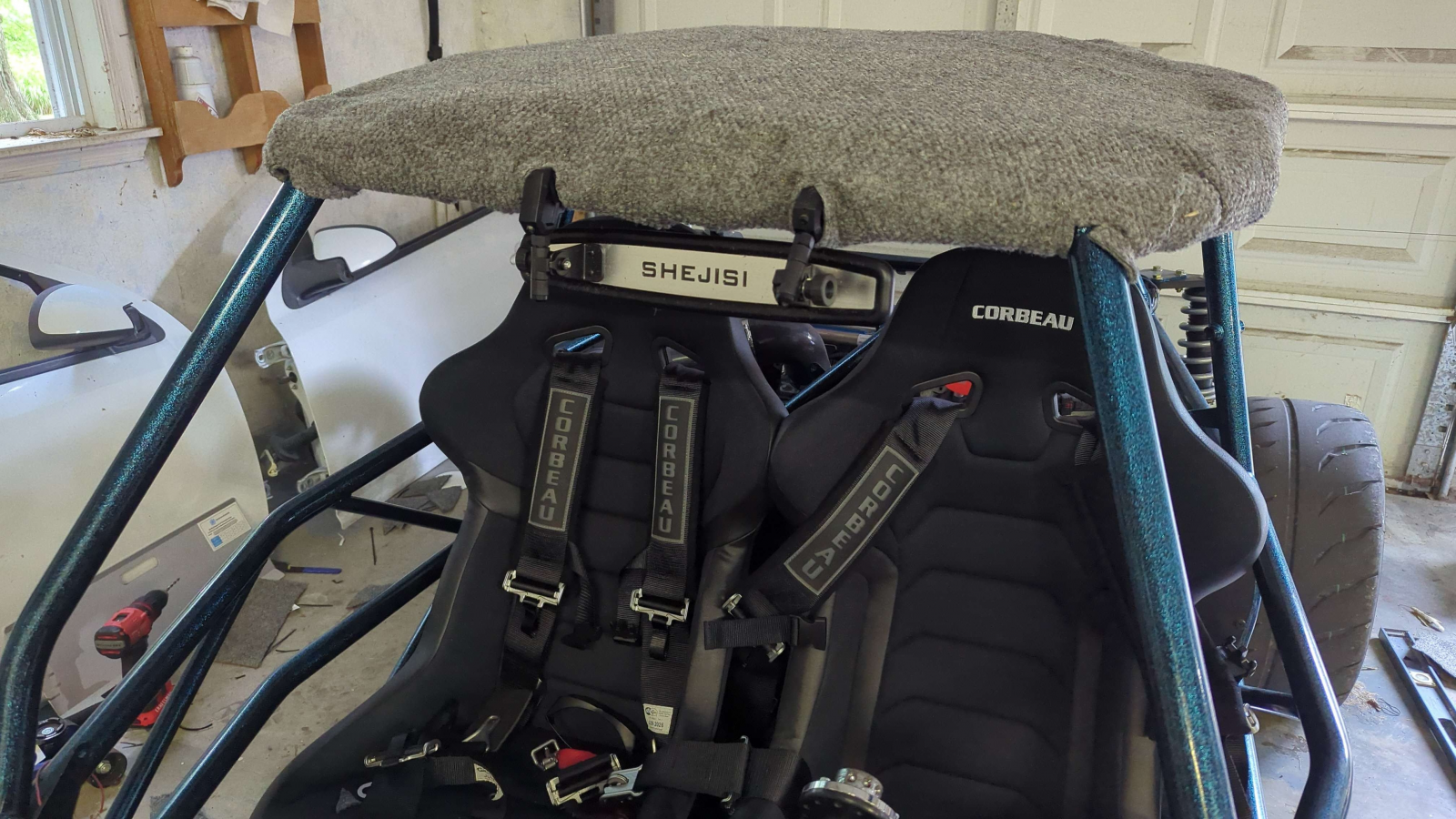

received the invoice wensday and missed it in the mess of my email box, mentioned some needed changes and will receive the amended version soon. ordered a rear view mirror and installed it, i can now see everythingggggg. I am going to change the 'shejisi' company logo on the front with something else, stickers perhaps or my frame number viewable from your rear view mirror (mirrored unless seen by a mirror). A sticker with my frame number would probably be best. Seen in this picture I am using a combo of cardboard and particle wood to make the cloth top taught, everything is secured with zipties, of course.

I have the same mirror and had the same complaint about the brand name on it. A quick shot with a rattle can makes it way less noticeable but the frame number like you were saying would be cool too. It's been a good mirror hasn't vibrated loose on me yet.

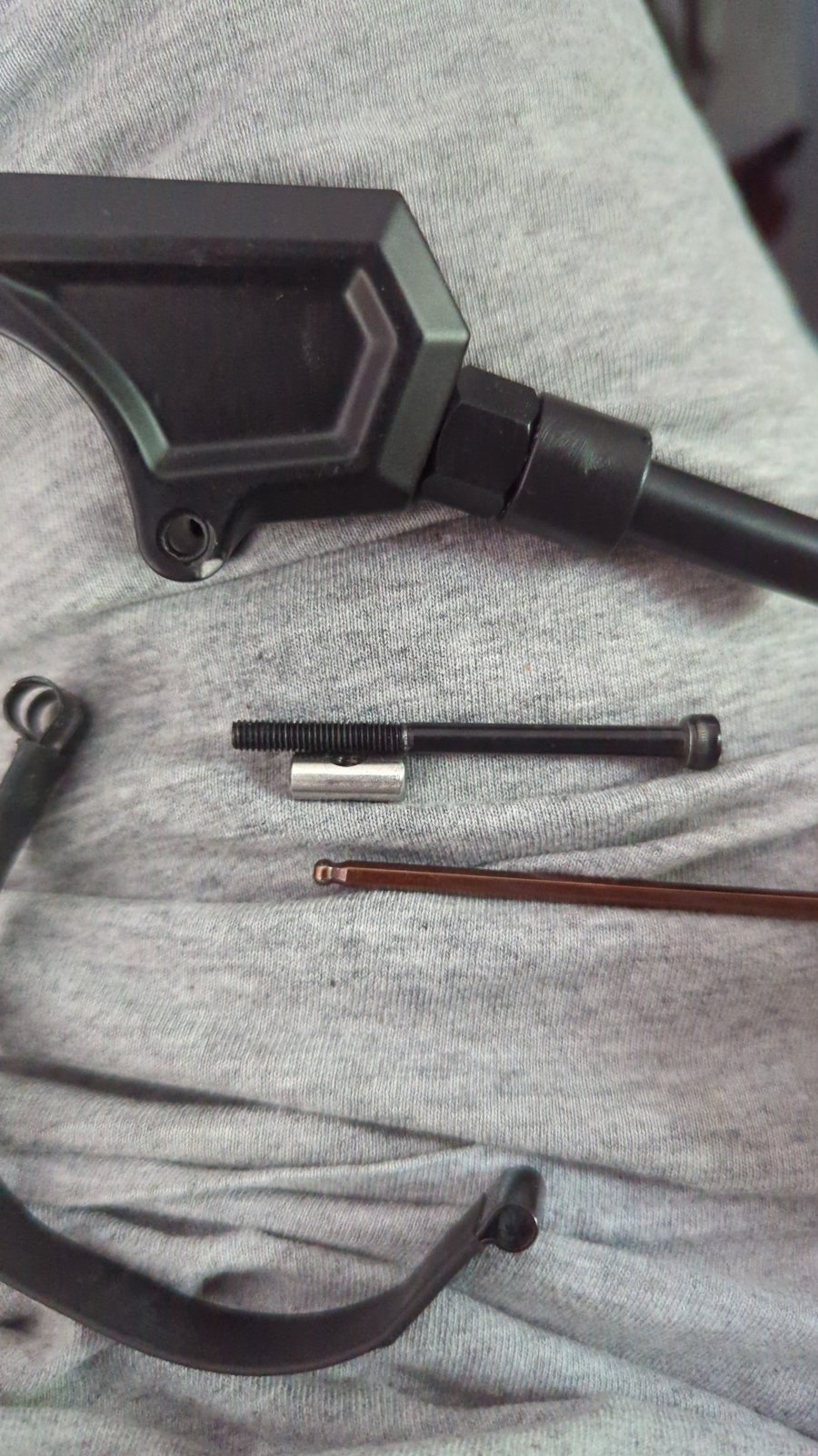

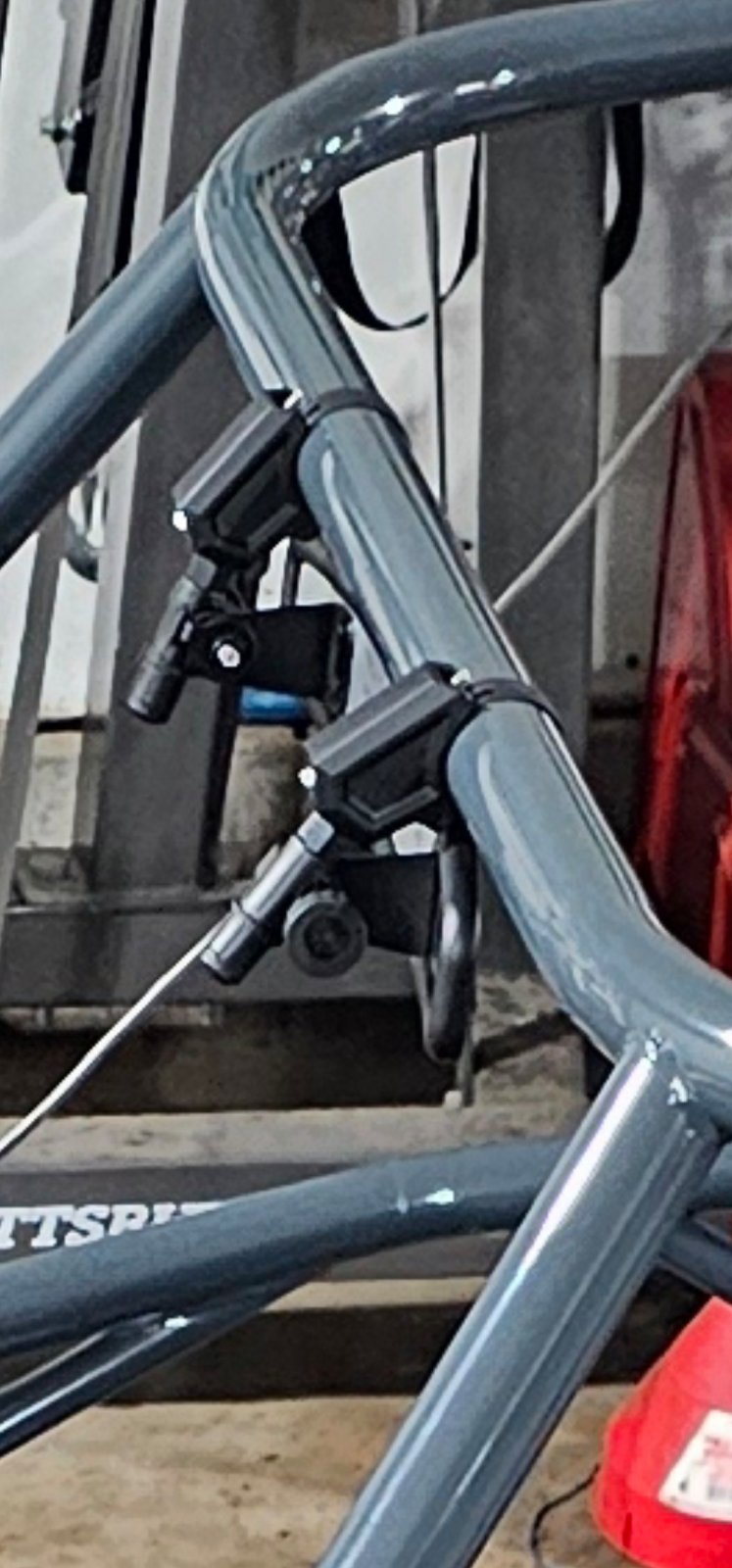

what do you end up using to get the mounts to fit? i had to make shims using rubber and sockets
Mahkoi
Huh, weird I'll go double check. The screw bottoms out, did I receive the wrong screws or am I missing something View attachment 48200
edit: i believe i did receive different screws, to the hardware store i go then
I'm a couple of hours away from my goblin right now so I can't get a good pic but it looks like we may have different hardware, my screws were stainless or uncoated and may have more threads to them.
