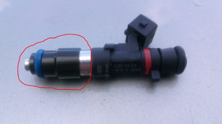

I found that these guys have a bunch of injectors for our engines, with the split injector pattern.
The article mentioned "You have to use an adapter on the nozzle to make it work, but many injector shops have this adapter"
I really wish he mentions which adapter, as all I can find online is electrical adapters to match the wiring harness.
Electrical adapters are not "on the nozzle".
Do you understand what the needed adapter is?
JeffsGoblin
Yes, it is this adapter to make sure the injector fits snug into the fuel injector insulator. The injector can fit on many different cars, so different adapters allow for differ size injector openings. I found out these are called height adapters.
