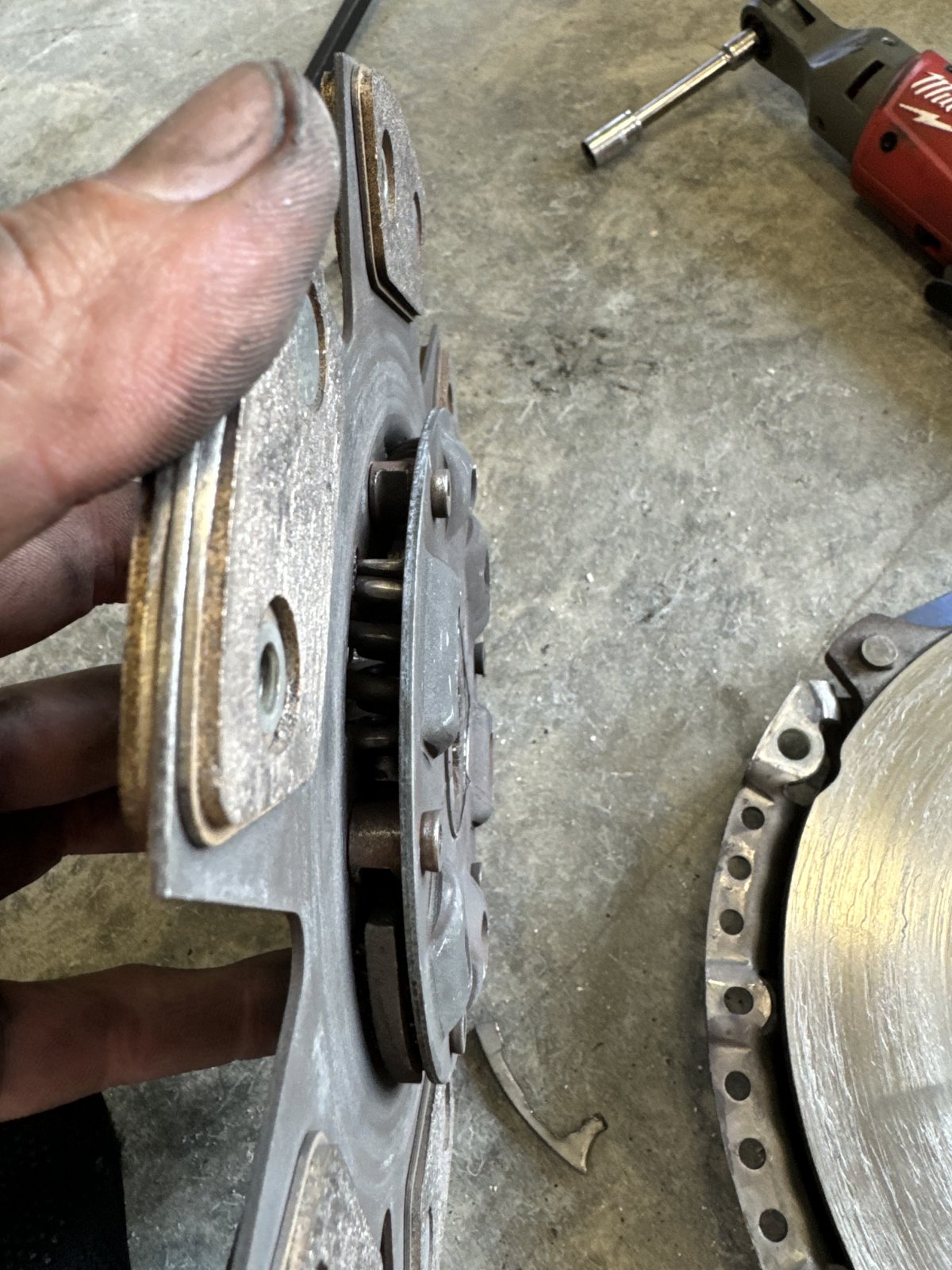

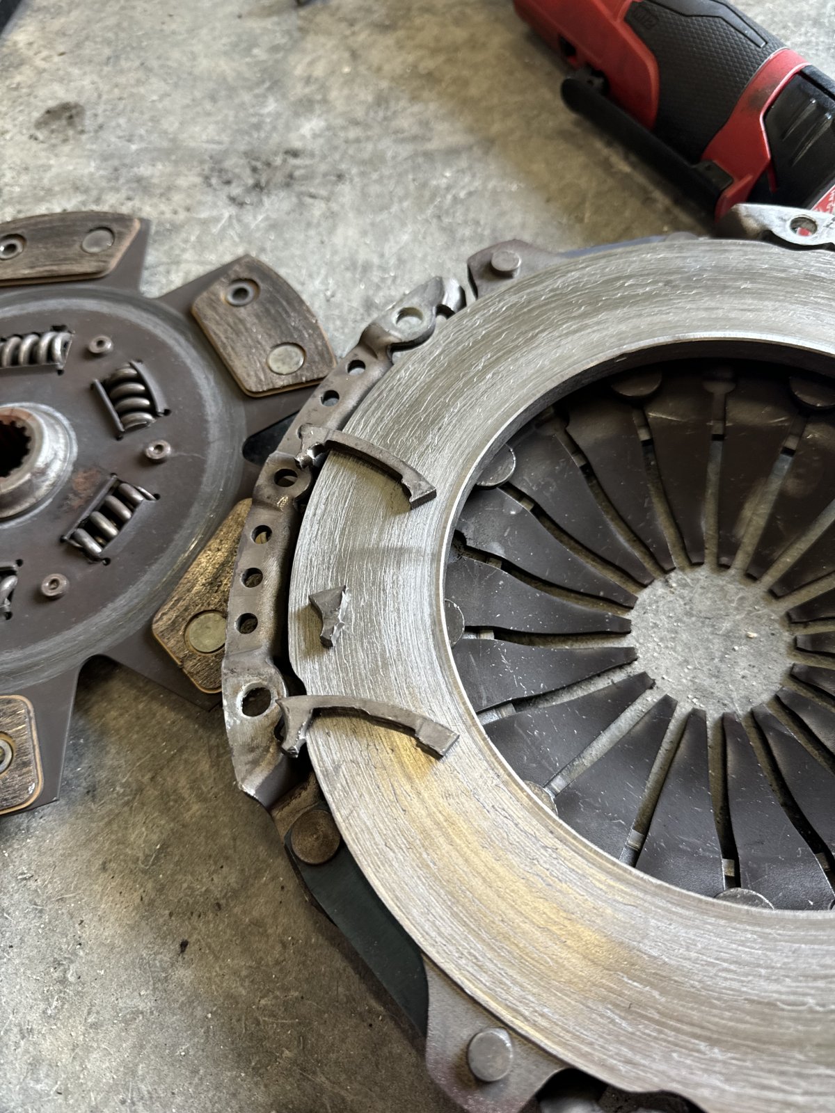

First of all this isn’t me bashing clutch masters. I race the car and drive it a fair amount. I’ve had this setup for about a year. Had issues with clutch drag and could hear it catch rolling in gear with the clutch pedal in (engine off). Decided to pull the trans and some metal came out with the pressure plate. They are the arms in the side of the friction material that help hold the dampening springs.
I might look into a southbend stage 4 or an fx500 to try something without springs. I was also recommended trying a twin disk, and although it’s overkill, it could have less rotational mass. Just posting to get everyone’s thoughts on this.
