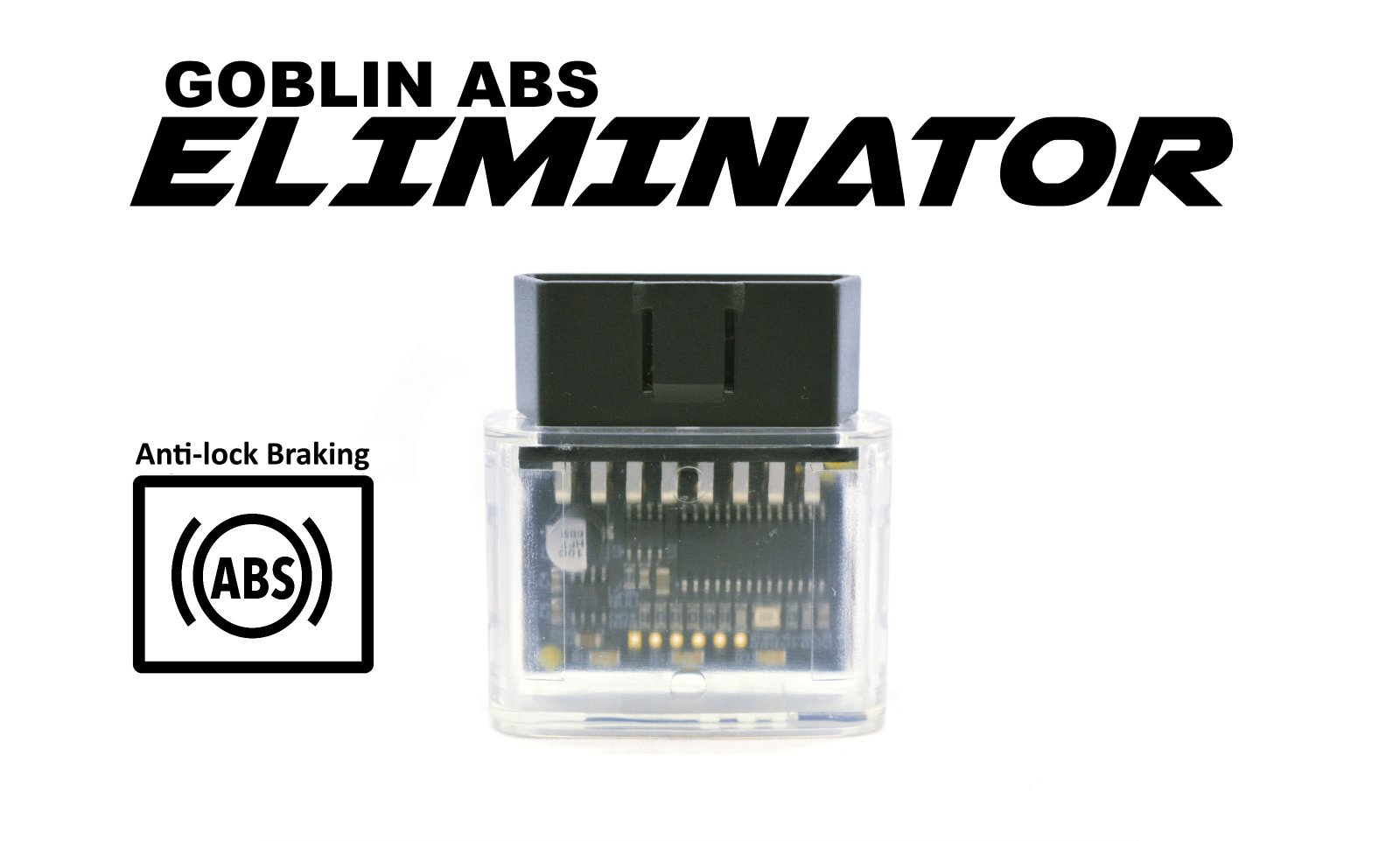

you plug it in and use it once. Can't be used again. So now it just sits on my desk at work.
The previous "ABS Emulator" design needed to stay plugged in to the diagnostic port long term to emulate the missing ABS module. NEW DESIGN - enter the "ABS Eliminator".
This new version, though programming, will turn off Anti-Lock Braking, Traction Control and Vehicle Dynamic systems in the BCM. As a result, the ABS and Traction control lights will no longer illuminate and you will no longer receive the "SERVICE TRACTION", "SERVICE ESC" and "ESC OFF" messages from the digital information center.
Simply plug the eliminator in long enough for it to make the programming changes and then remove - takes less than 20 seconds. These will be locked to the first BCM that they are plugged into and will not work on another BCM once locked.

HPTuner only talks with the PCM, but the ABS system is talking with the BCM. So HPT won't ever be able to do anything about the ABS light.
If you're running the Carbon 7, I assume you're using the 22 Channel CAN Sensor Module (30-2212)? If so, that should be feeding all the data from the engine to the Carbon, meaning the Carbon isn't talking to the BCM. Therefore, ABS light/warning will never show up on the Carbon.
