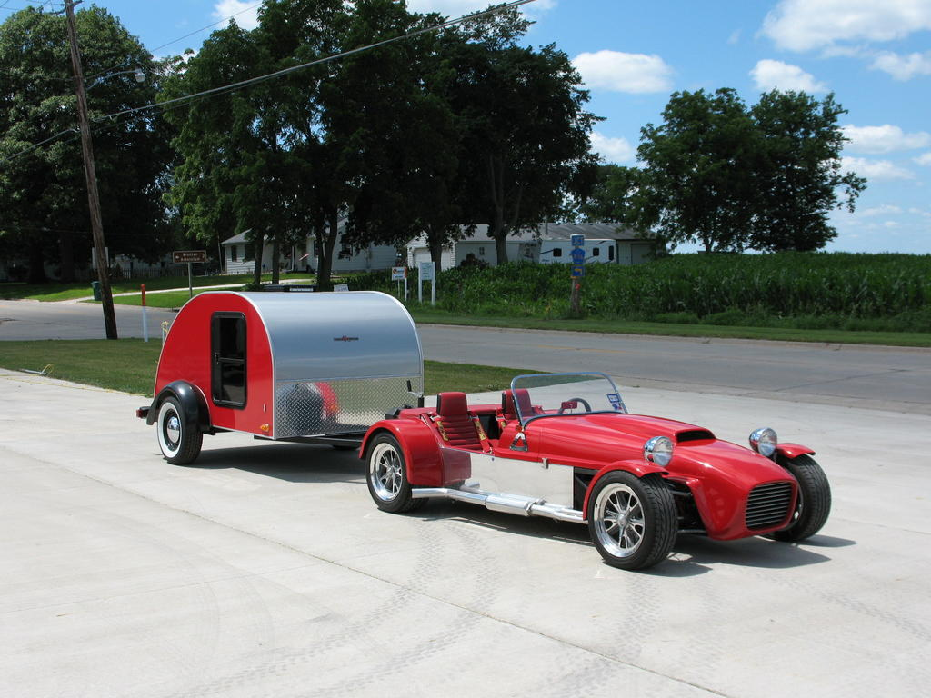

What’s the guys name on here that made a trailer out of thr back half of his donor? I would like to see how much weight he was towing during race week?
Dale E
@ Jason d, The red Lotus with tear drop trailer is a Stalker V6 with a 2.8 V6 and Chevy S 10 drive train. So, it has no problem with the trailer. My Birkin with a Ford Zetec will pull one, but strain a bit more than the Stalker. The Lotus Seven replicas with motorcycle engines would pull it, but you put a bit of a strain on that drive train.
The red Stalker V6 you pictured was built by a fellow in Houston, Texas and I delivered it to Des Moines, Iowa to Sugargrove Cars, where this picture was originally taken. Long ago history!!
Jason d
Yeah I didn’t know what’s in the lotus but I guess you just answered your own question
