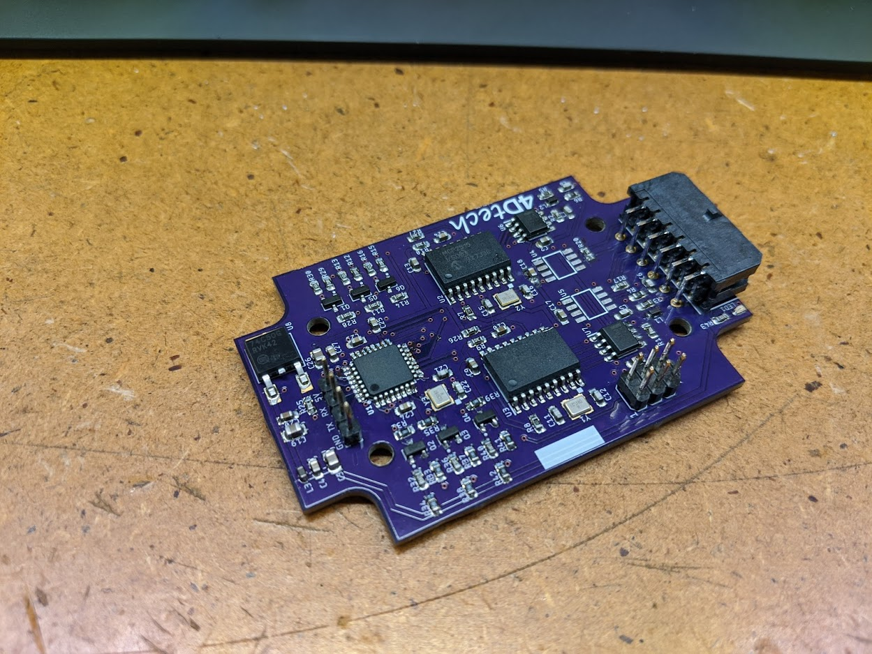

I know this has been a slow moving project. I decided I wanted to change the amount of I/O and form factor of the circuit board. Raw circuit boards are in, I just need to get them populated and tested. It will likely be a few more weeks before I have time and know if they work.

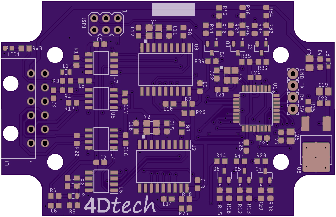

Sorry to confuse - There is nothing new. I was simply posting pictures of a new circuit board design (see post 45 above) for the same project I have been working on.

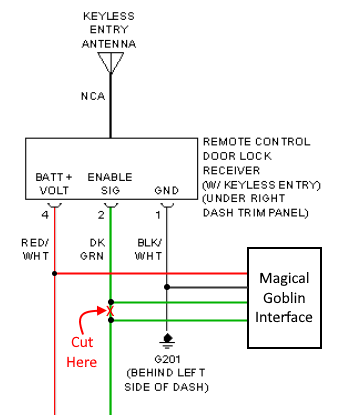

What kind of wiring connections would we be looking at here? My harness isn't finalized yet (as in, wrapped fully) so I won't do it yet if I'm going to be cutting it open anyway.
For the module to work properly, it needs to be inline with the TMPS (RCDLR) box. There would be 4 wire connections to be made:
  1. 12v (Tap into Red/White)
  2. 0v (Tap into Black/White)
  3. Low Speed GMLAN (Cut wire, join with vehicle side)
  4. Low Speed GMLAN (Cut wire, join with TPMS side)
13054
If the vehicle in question does not have TPMS, you would only need the first three connections and they could be made anywhere in the vehicle. The remaining wires are I/O for future features (ie. seat belt reminder option).
