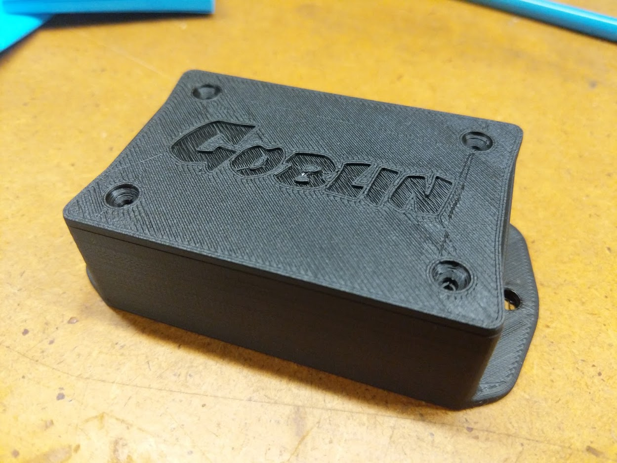

New 3D printed enclosures - testing adding a logo to the lids.

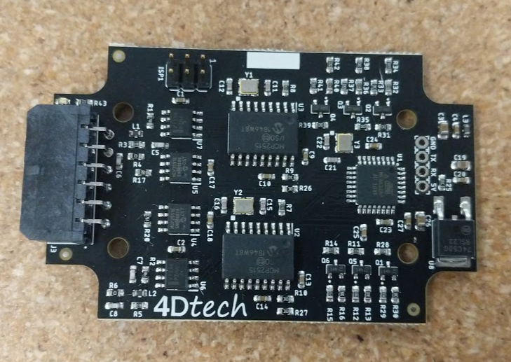

*** THIS IS NOT YET FOR SALE. LOOKING FOR BETA TESTER(s) - SEE BELOW ***
To firm up and fill in some info you all have been waiting for, I have populated a bunch of info below. All accurate as of --->July 28th 2020<---

  • Airbag Bypass: Option to disable airbag light (also disables airbag warning messages in the information center)
  • TPMS Emulation: Option to disable low tire pressure light (also disables low tire pressure warning messages in the information center)
  • TPMS Enhancement: Option to adjust the tire pressure warning threshold to any value between 0 and 40 PSI in one PSI increments
  • Door Switch Output: Option to pulse driver door trigger at ignition off to avoid BCM from staying powered up for 20 minutes.
  • Startup Message: Option to enable a pre-defined (not yet decided) "welcome message" when the vehicle is started in the information center.
  • On screen user menu to enable/disable/adjust features above. Demo HERE.
Unsupported features:
  • PK3+Bypass: Option for key cloning (clone the chip in your key allowing you to use keys without chips or deleting the TDM ring around the key cyl).
Unimplemented feature ideas:
  • Welcome Selection: Ability to select one of a few pre-defined welcome messages.
  • Belt Minder: Some form of a seat belt reminder, possibly with the ability to wire in the stock seat belts.
  • TPMS Learn: Menu option to initiate the TPMS learning procedure without having a stock remote control.
What is included:
  • Digital vehicle interface
  • 3D printed enclosure
  • Vehicle integration harness (24" long, blunt cut ends)
Required Wiring:
  • Power [RED]
  • Ground [Black]
  • GMLAN (Car Side) [Lt. Green]
Optional Wiring:
  • GMLAN (TPMS Side - OPTIONAL) [Lt. Blue]
  • Output 1 (Door Pin - OPTIONAL) [Orange]
