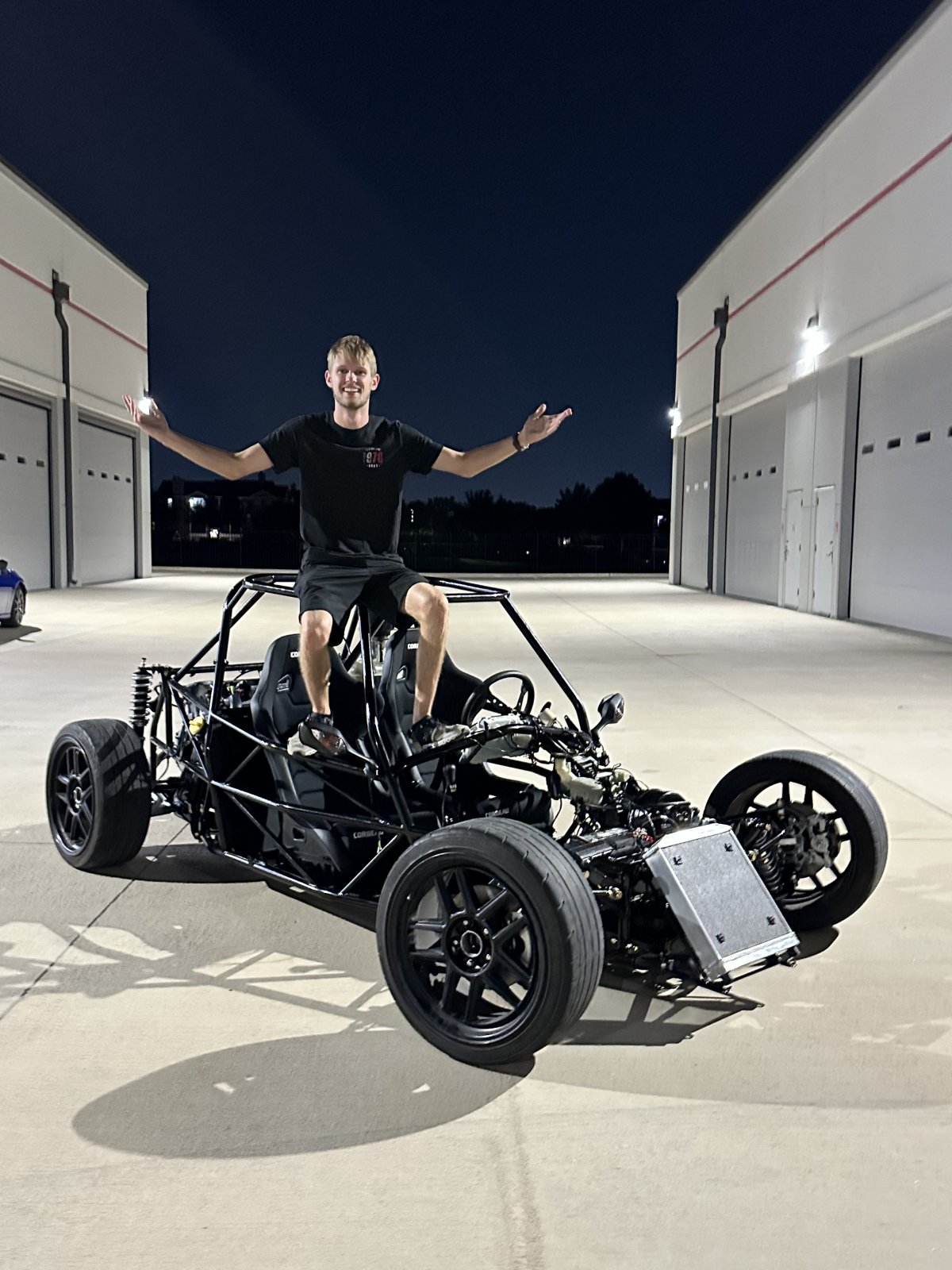

Also, Major update on my build!
We have it on its wheels and its running super well!
