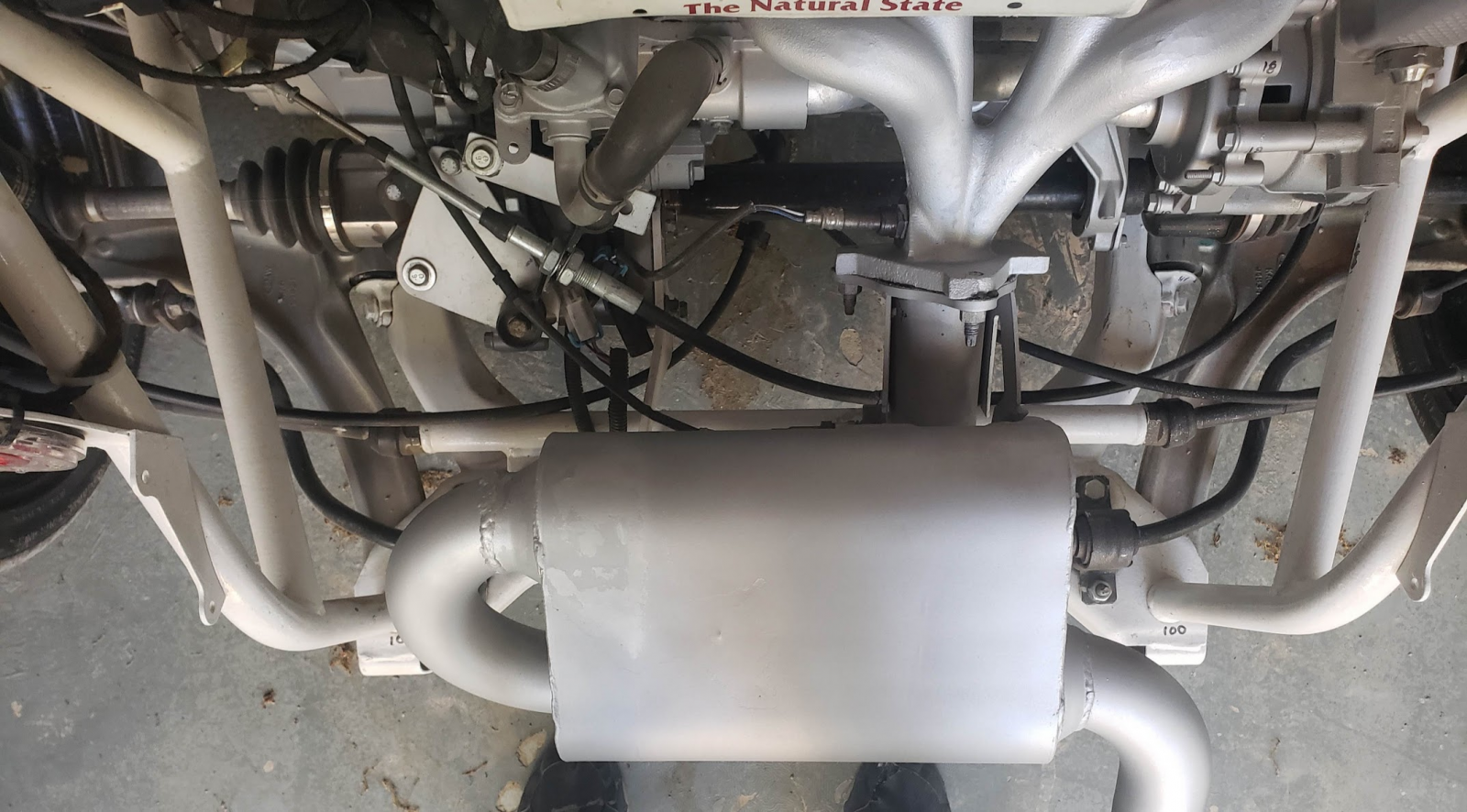

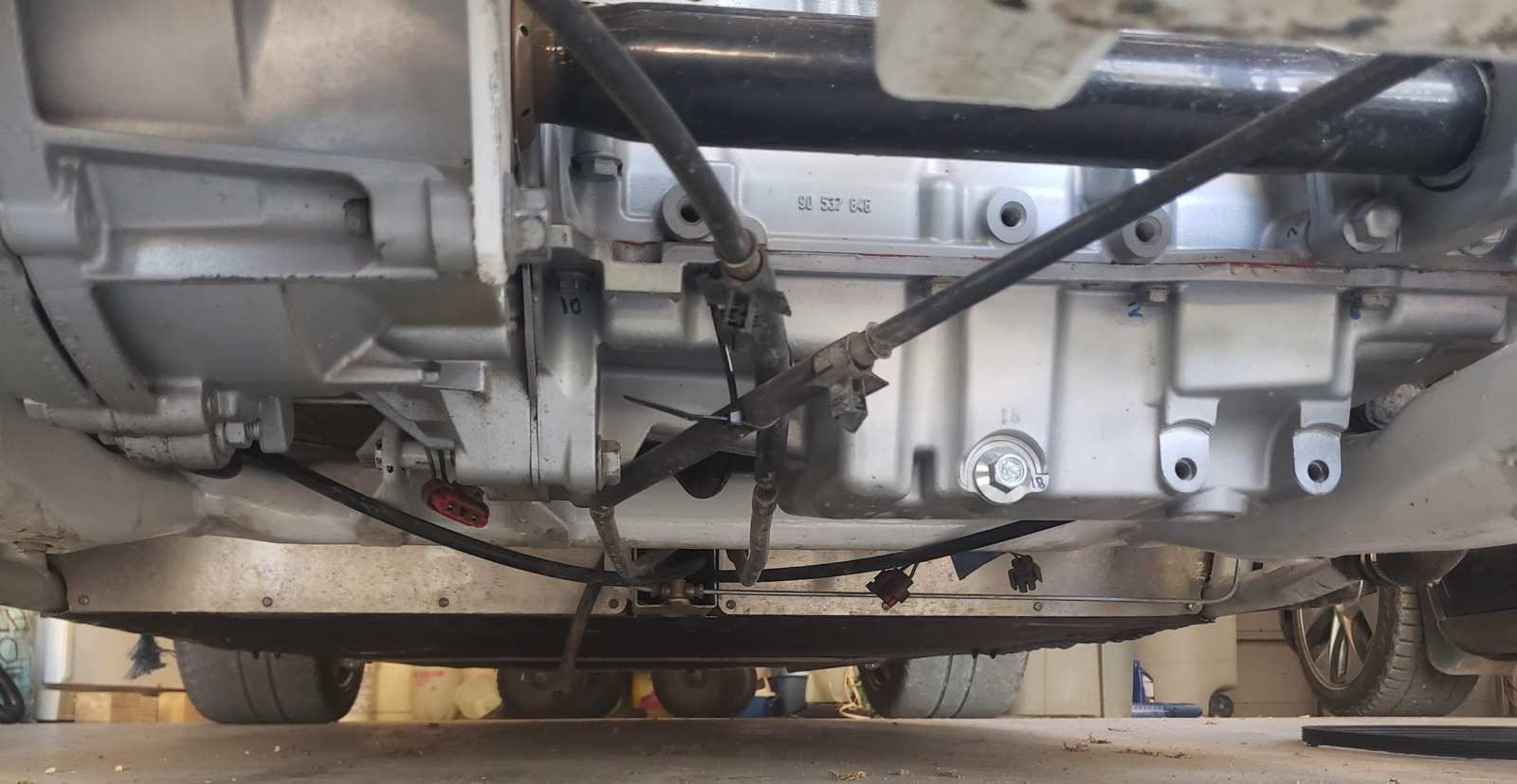

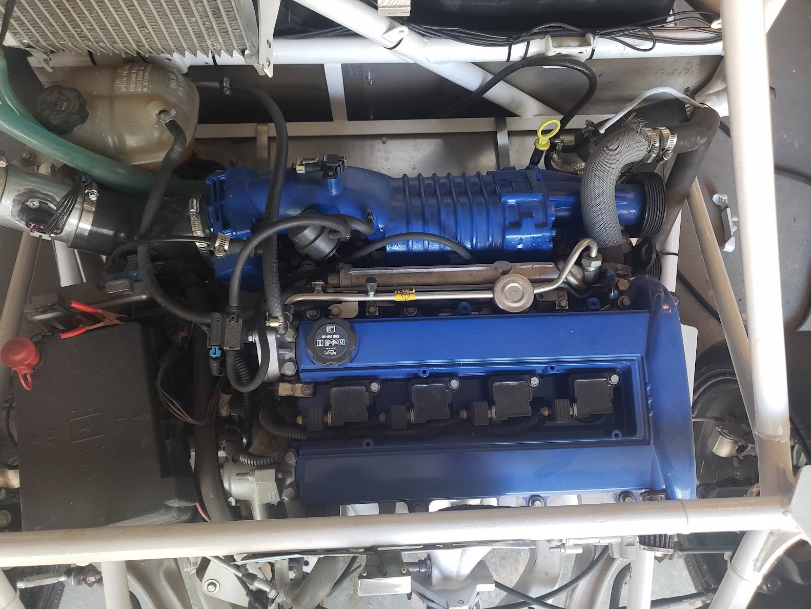

Hey yall, Ive started wiring up my SC motor and I am having trouble finding where to route the wires and the other lines like coolant and such. If anyone has a supercharged engine can you post a few photos of your motor so I can see how to route things? Thanks!
Here are some generic engine pics.
46910
46911
46912
I ran my parking brake cables thru the middle of the LSJ oil pan.
