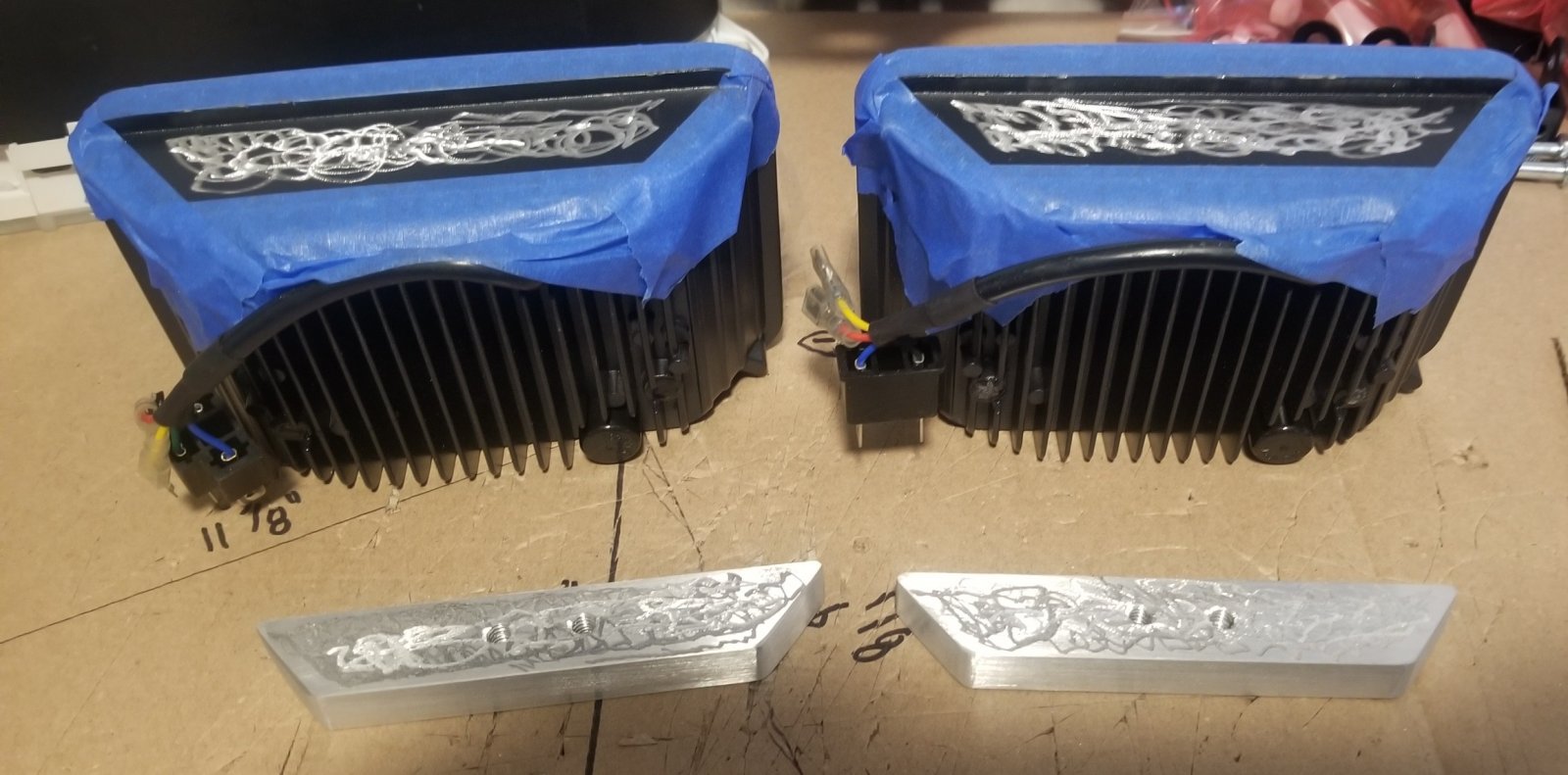

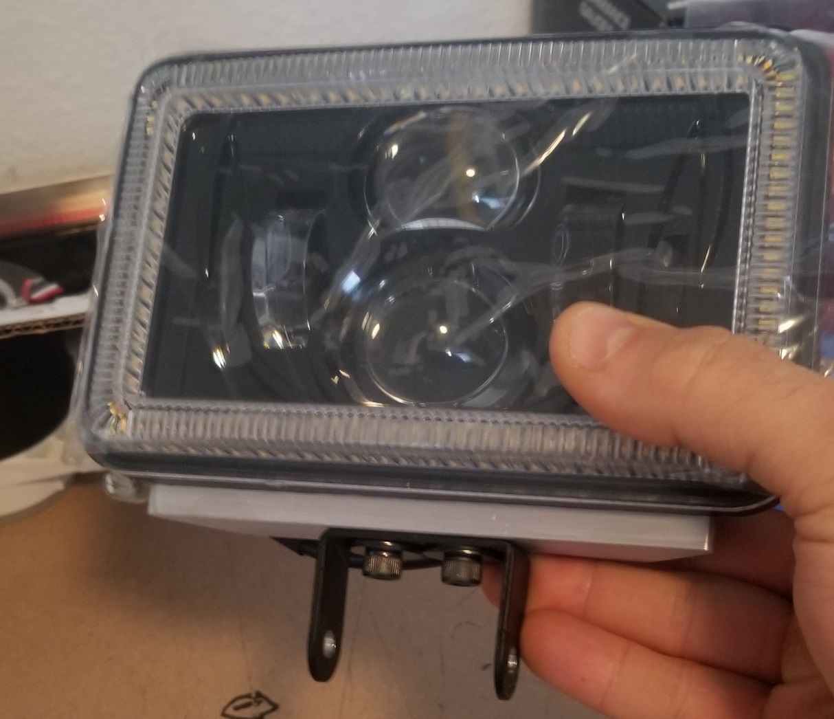

I guess the version of the LUMEN brand I got doesn't have threaded holes. I think its time to design custom aluminum headlight brackets.
28838
ColoradoCryptoTrader

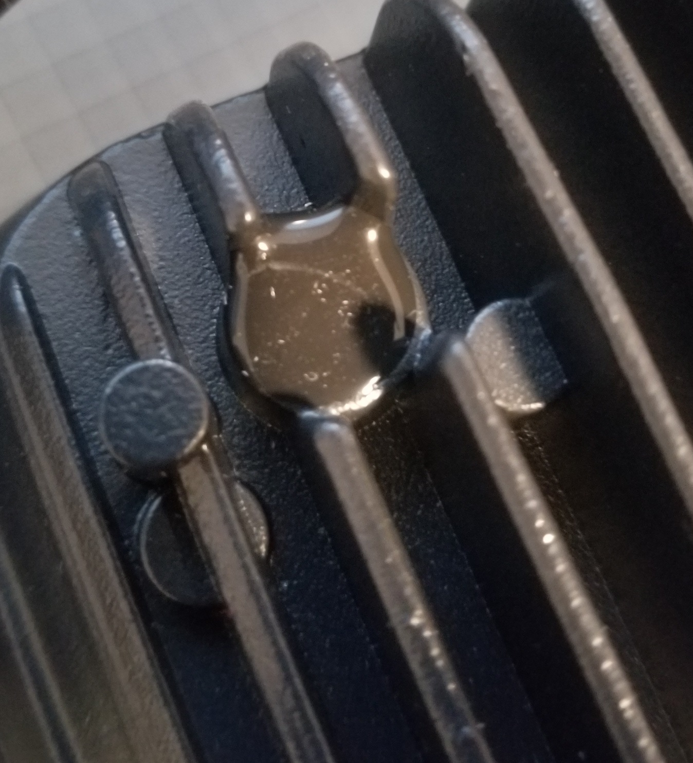

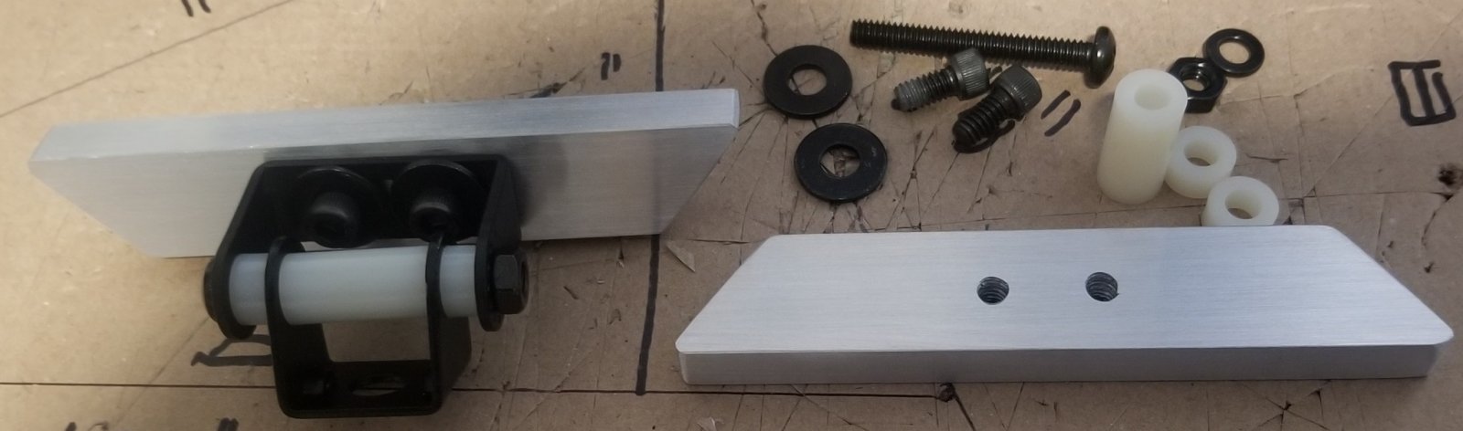

I made these headlight mounts using 0.50" laser cut Aluminum with misc spacers and headlight mount parts I combined together and attached to headlights using JB Weld. Brushed the aluminum with 220 grit sand paper. I think I might brush all of the raw aluminum parts on the car.
