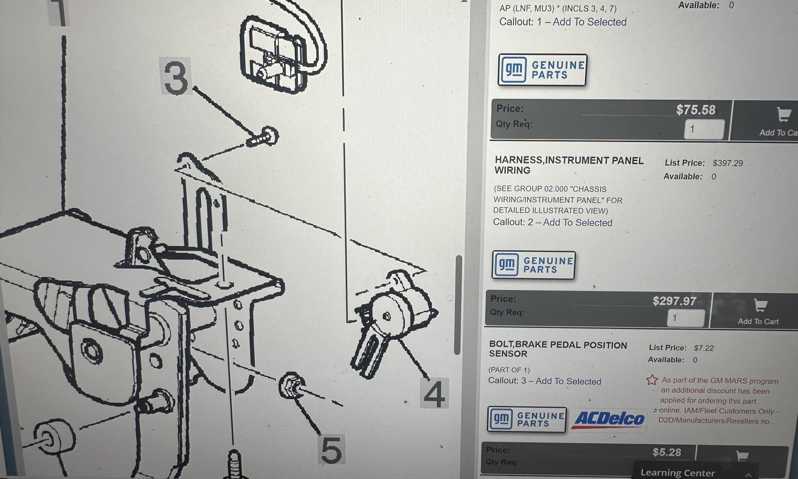

Thank you appreciate it. If it’s not available I may just drill out the threads and run a nut and bolt though it. Should still work fine that way. Cheaper then buying a new one if I don’t need it.I can look it up tomorrow, but I doubt it’s available.

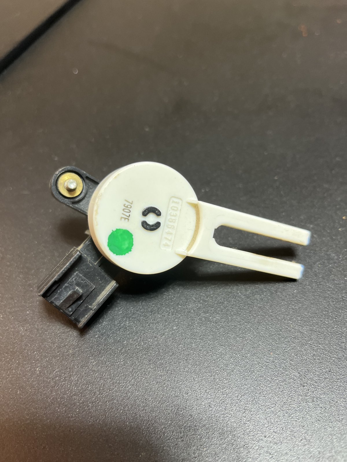

Yeah I didn’t realize how tight they were and I was letting my kid remove it: I hadn’t taught him about how to not snap bolts yet. So learning lesson for him.Those little bolts were always painful to remove. Don’t be surprised if you need a small amount of heat to help loosen up the thread locker applied at the factory
Dorman # 20717Gotcha, really appreciate the help.

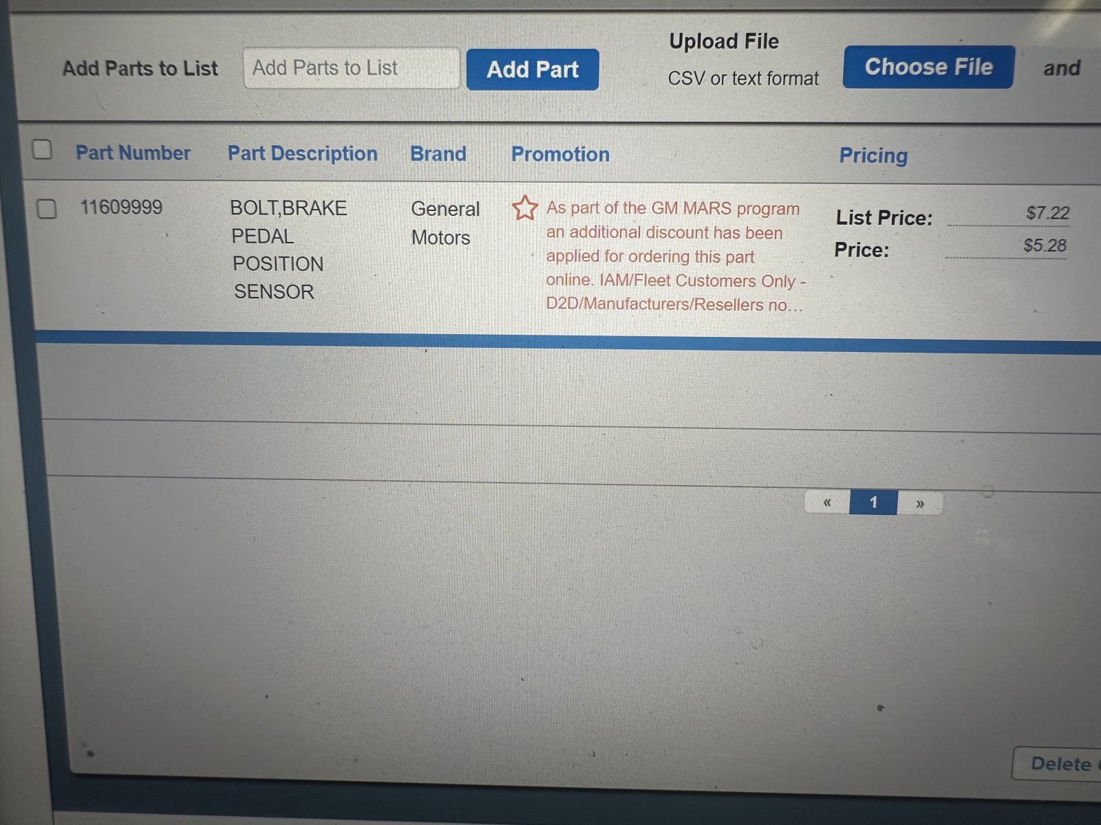

All good I went with the doorman part number posted above. I appreciate the help. Couldn’t for the life of me find it doing an online search. I ordered the screw off amazon. Also ended up ordering a new switch. I can’t get the busted screw out and ended up breaking the one trying to.Shoot me the vin so I can look it up properly. Doubtful it’ll be available though. Dorman is the way to go on that stuff.
Yuck, but not like I had a choice. Thanks for the heads up. How do I known if I need to program it?Ok. Cool.
You will probably have to program that brake switch. FYI
