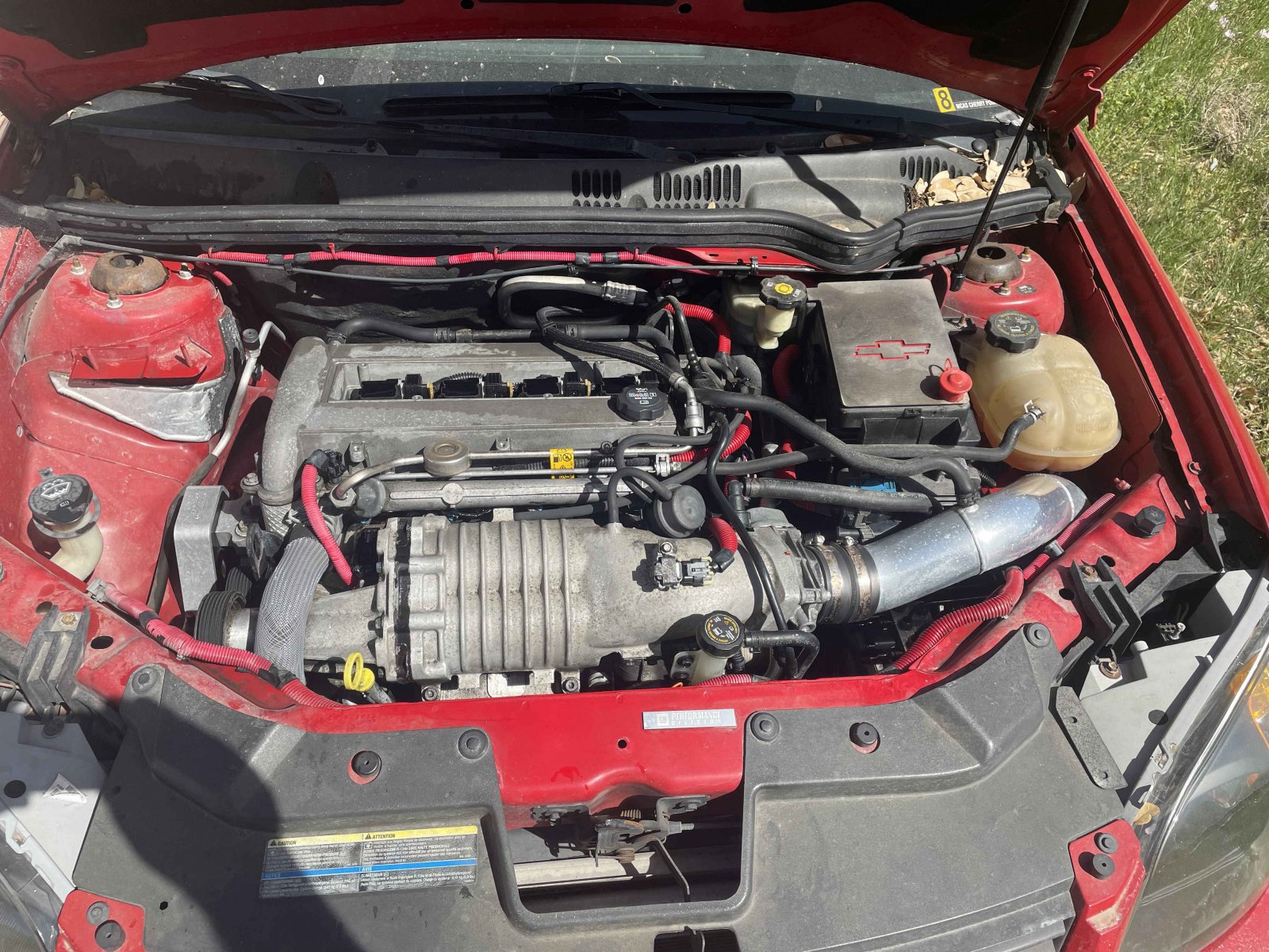

On Friday I prepped the car for teardown, I'm basically following the DF Kit Car videos as closely as possible (my donor has some differences, like a cold air intake) so none of this should be a surprise.
I power washed the engine.

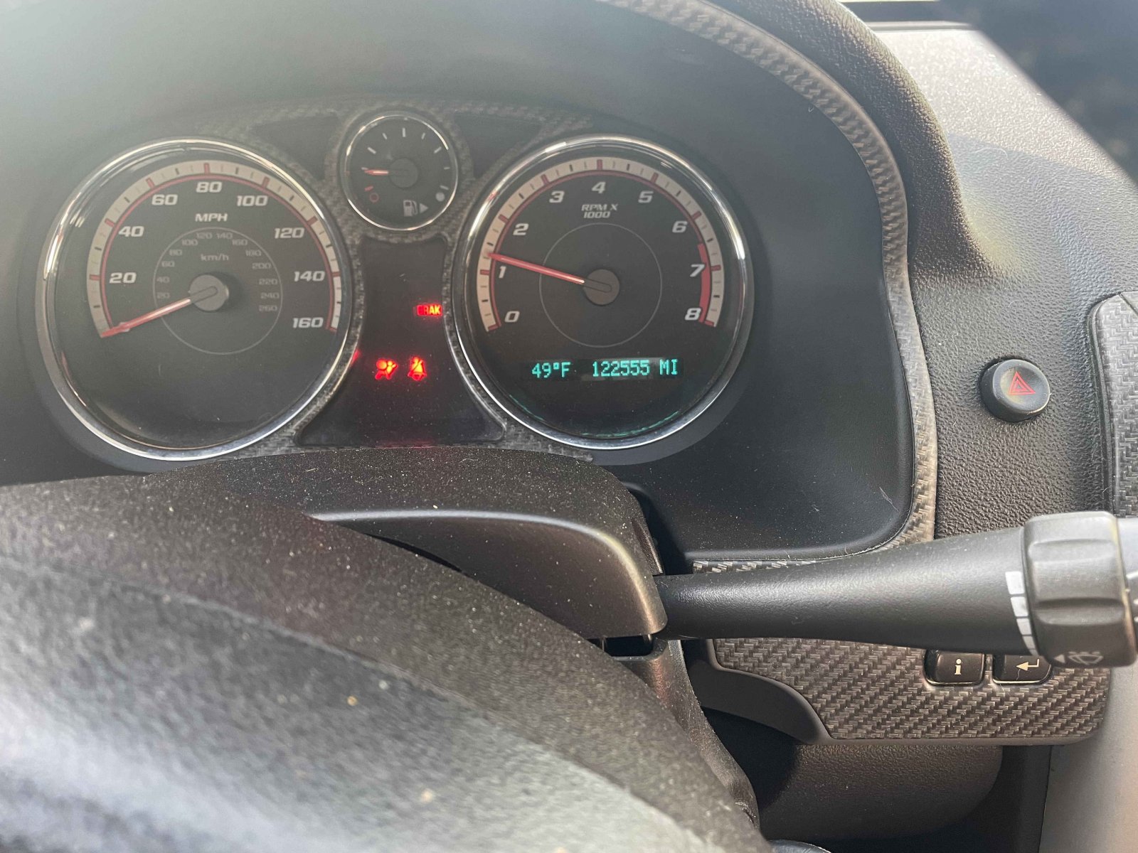

Took a note of the final milage before teardown 122,555:

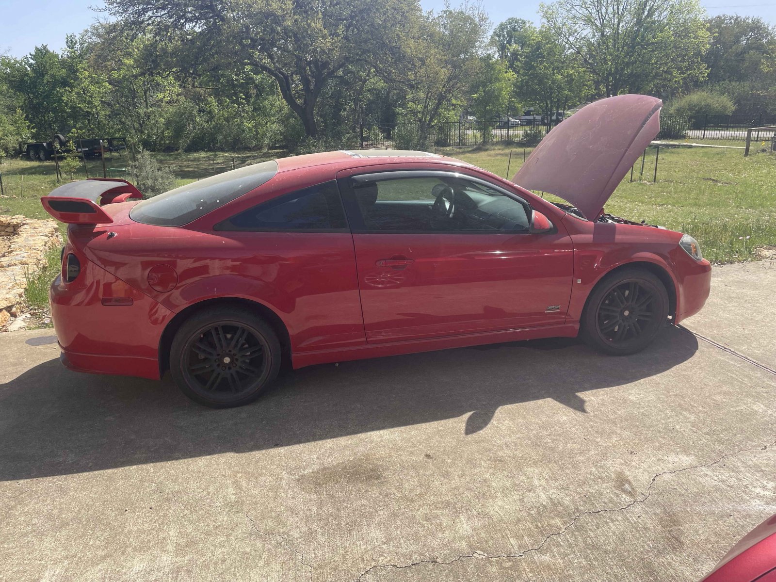

And one last photo before destruction:

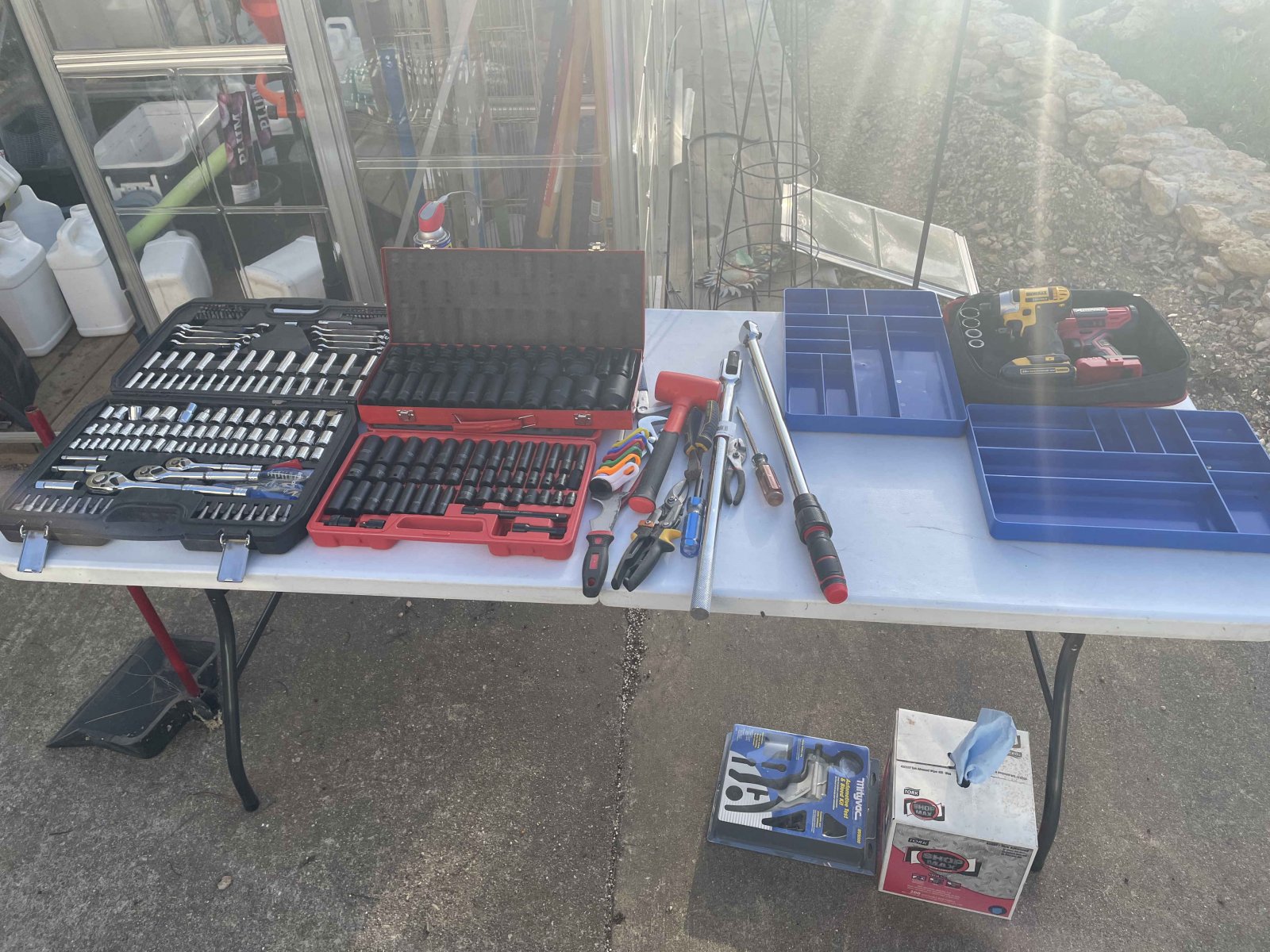

Today I started the real teardown, starting getting all of my tools ready to go. I was going to do the teardown in my workshop but there's a space issue and it's just easier to take care of this off to the side in my driveway.

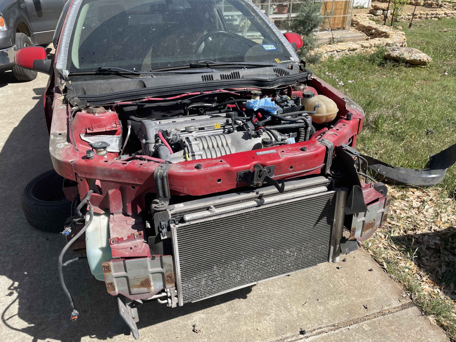

However, with the help of my friend Brit, we managed to get the the front body panels off

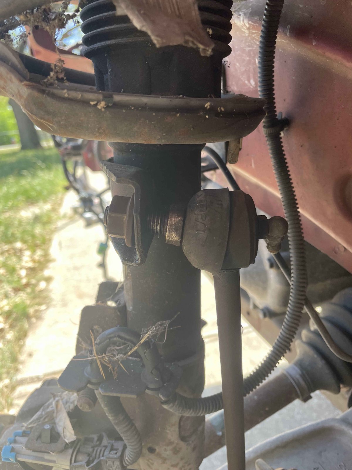

But we got stuck on the driver's side swaybar. I didn't have the proper sized metric wrench and the nut/bolt is very rusted. It just refuses to budge from this position.
I soaked the bolt with penetrating WD-40 and made a trip to the store for the proper tools. However, it became too hot and sunny for my pale complexion so we stopped there.

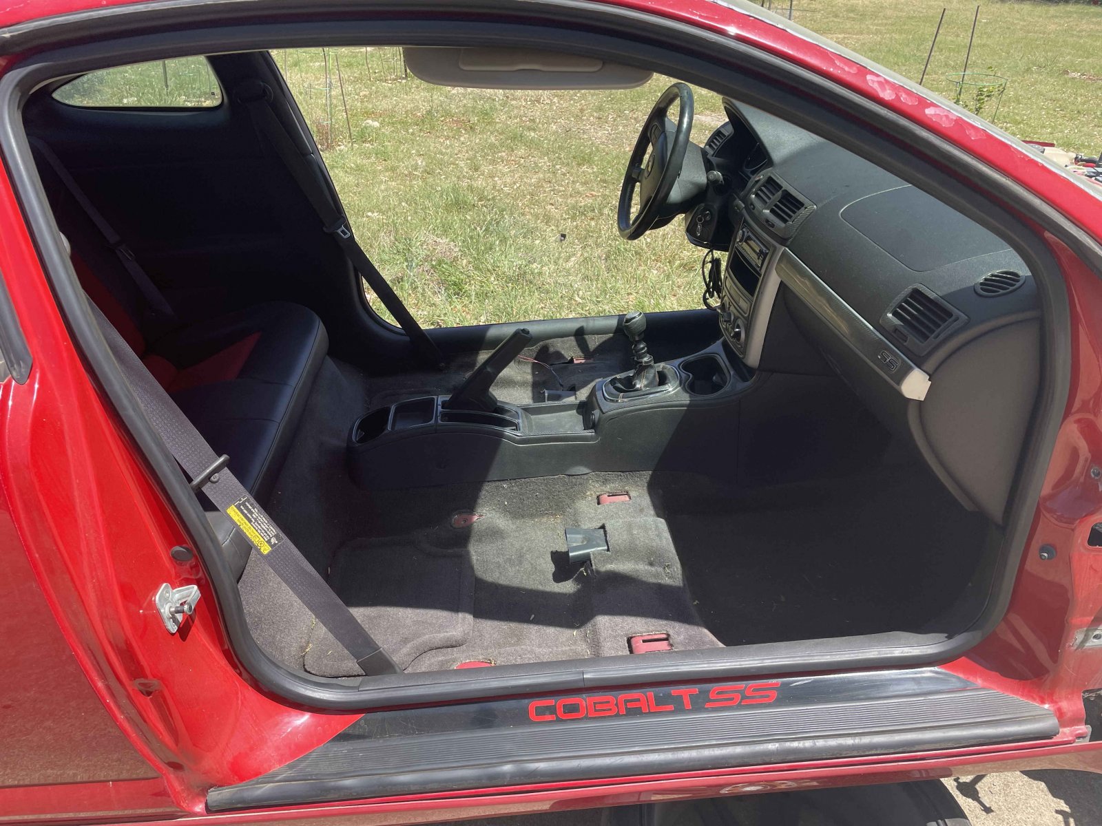

If you are upgrading the struts, then cut the sway bar link at the strut. Street driving you don’t need the sway bar. Track, you nay want to add it back, but it’ll be the base model “smooth ride” one, not the ss.

First things first, I attacked the strut/sway bar problem. I gave it another shot using some metric wrenches (I didn't have metric at that size yesterday) but the nut was stripped at this point and the bolt was still very rusty so I took Rttoy's suggestion and just cut it free.

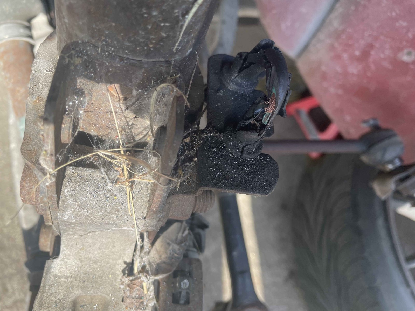

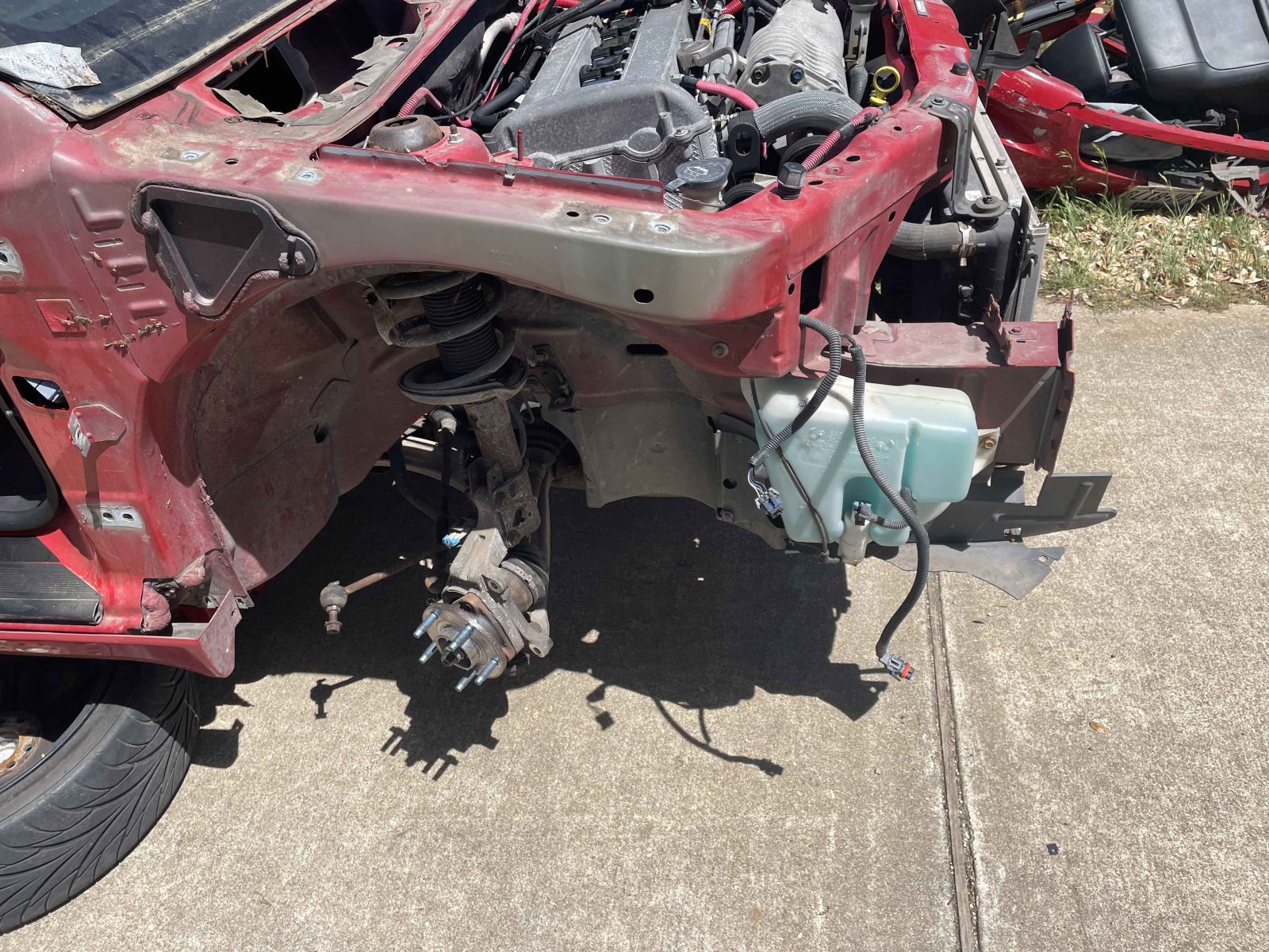

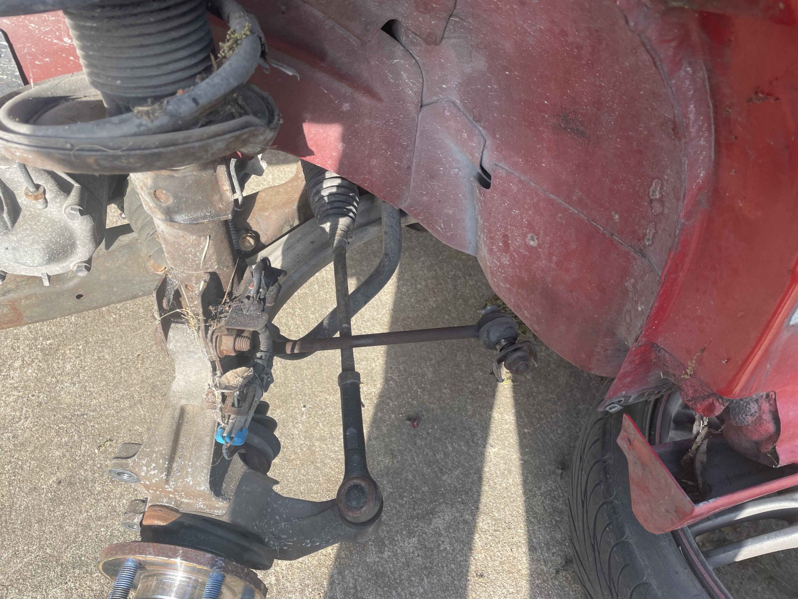

Unfortunately, I accidently cut one of the wires nearby.

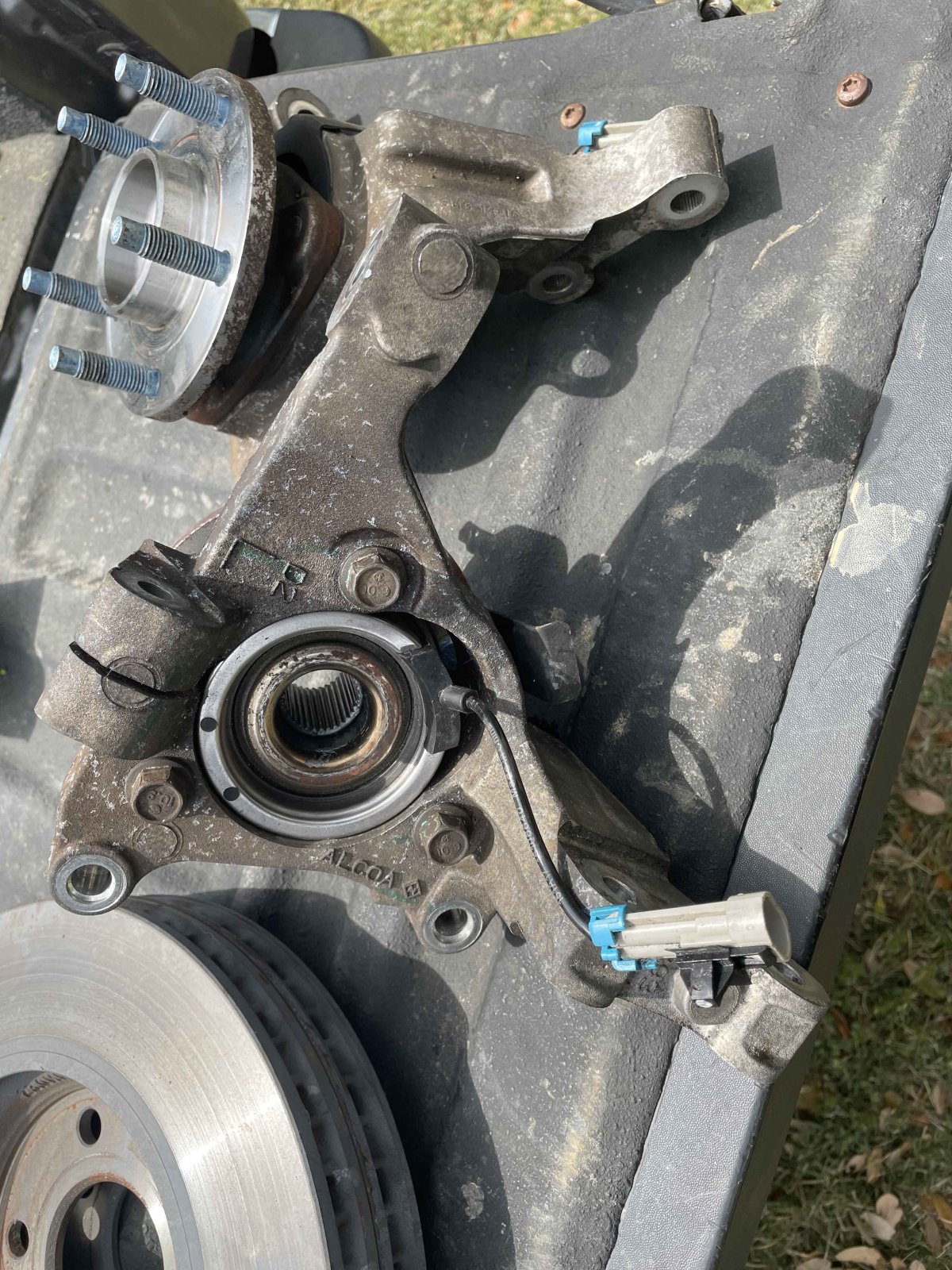

I don't know what that's for but it connects to the steering knuckle.
My only thought is either it's part of the antilock brake system or traction control.

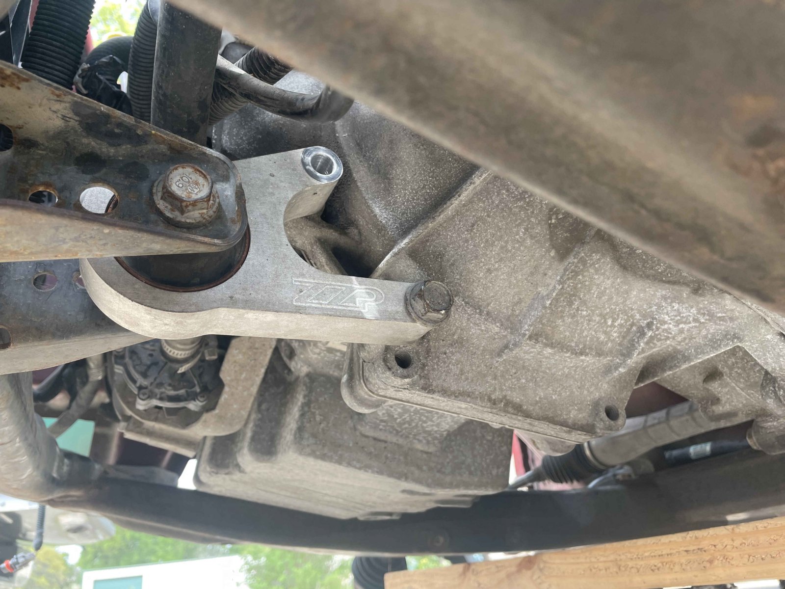

The previous owners obviously did some modifications to the car. I already dealt with the cold air intake yesterday, but the modifications continued today. They replaced all engine mounts with ZZP mounts. I had already removed one bolt in this photo.

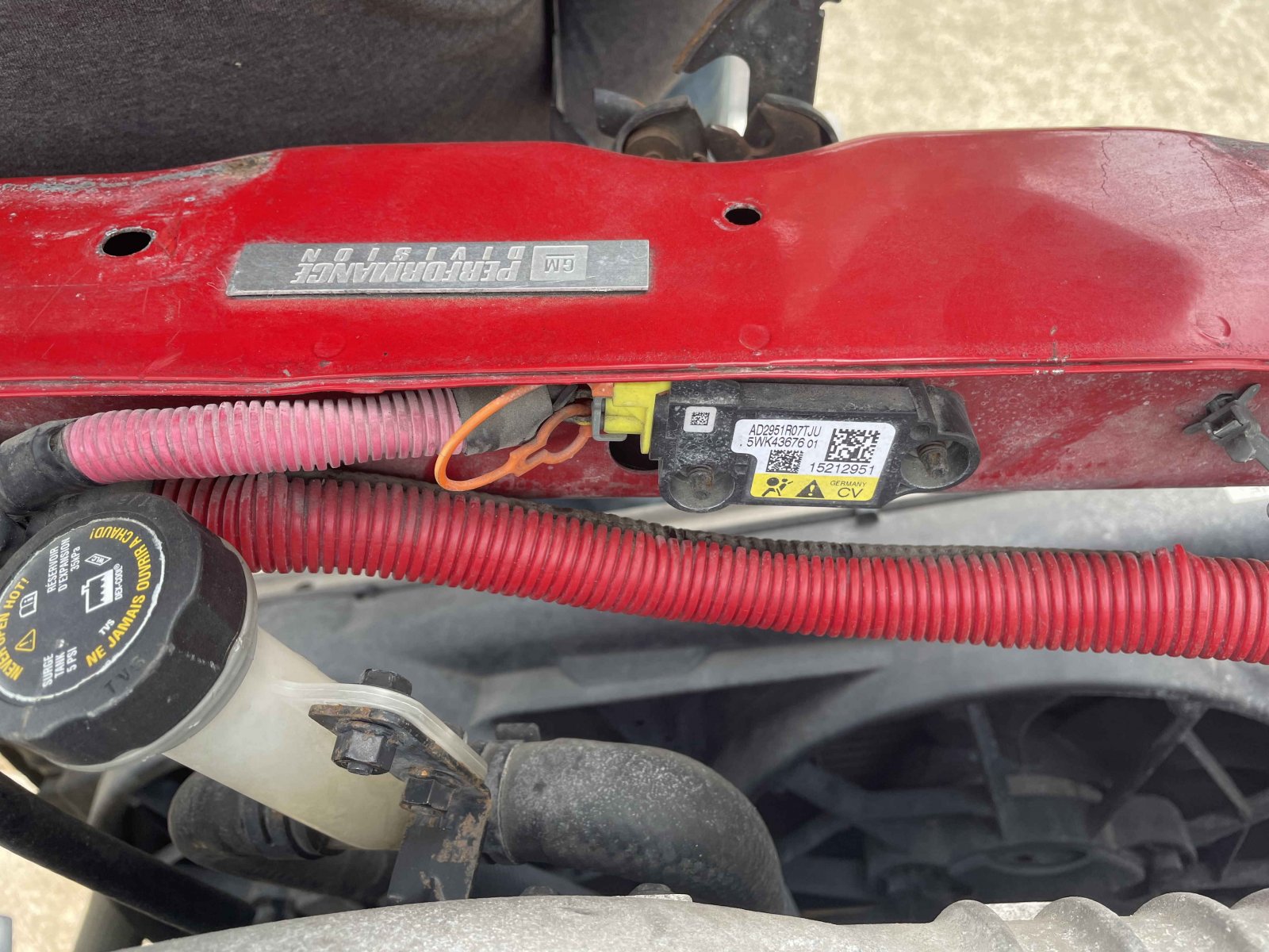

After that, I started in on the wiring. The previous owner loved red and pink because a lot of the wiring is wrapped in red/pink cable sleeves. The weird part is they didn't remove the black sleeves, they just put the red sleeves over the black ones. You can see the black sleeve under the red one in this photo of the airbag sensor.

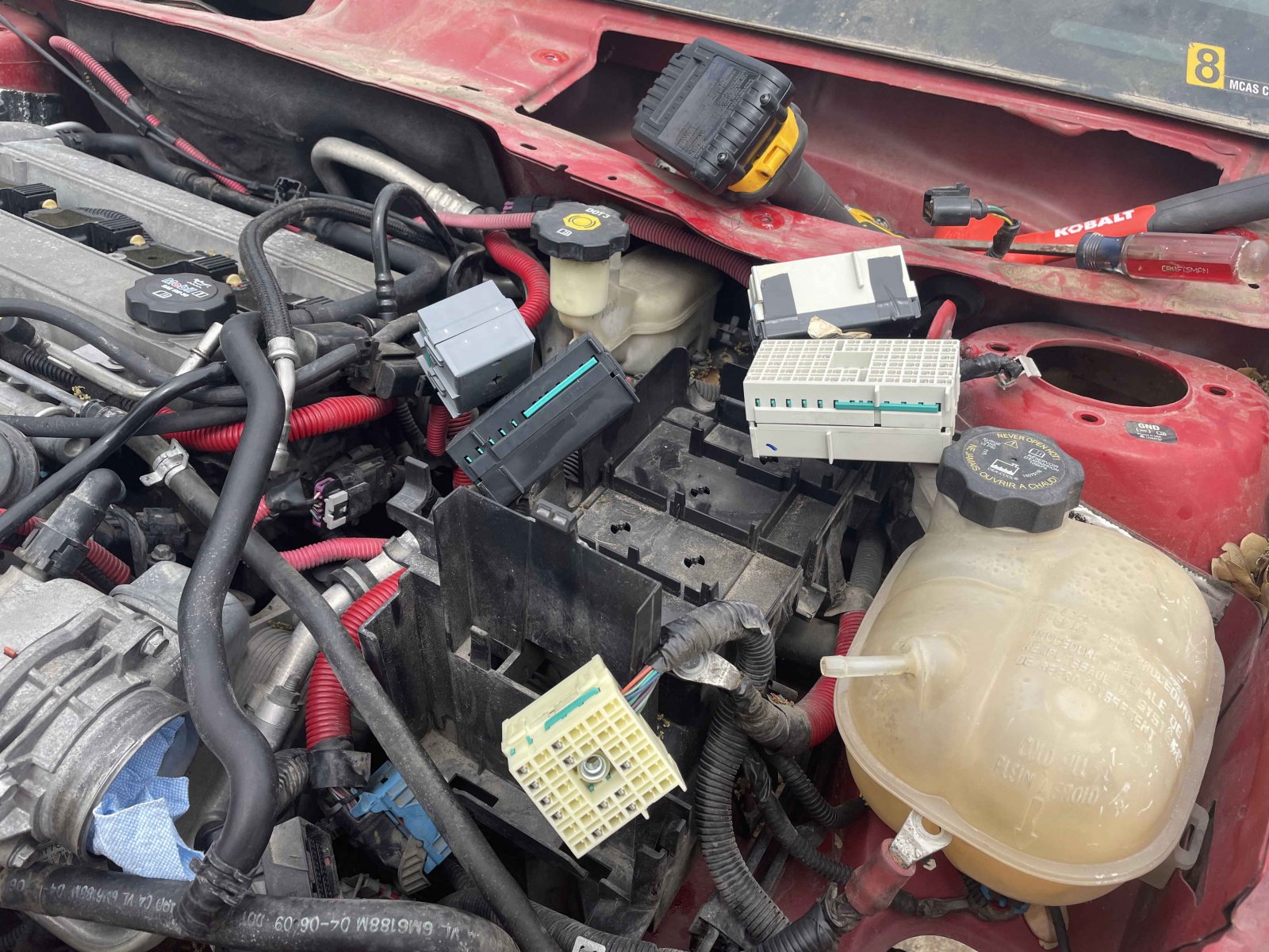

I also tore apart the fusebox.

Don't worry about the cut wire. It is not used. You are right - ABS and traction control.

Get that Performance Division plate off of the frame. It adds +5 HP if you install it on your Goblin..... ;)

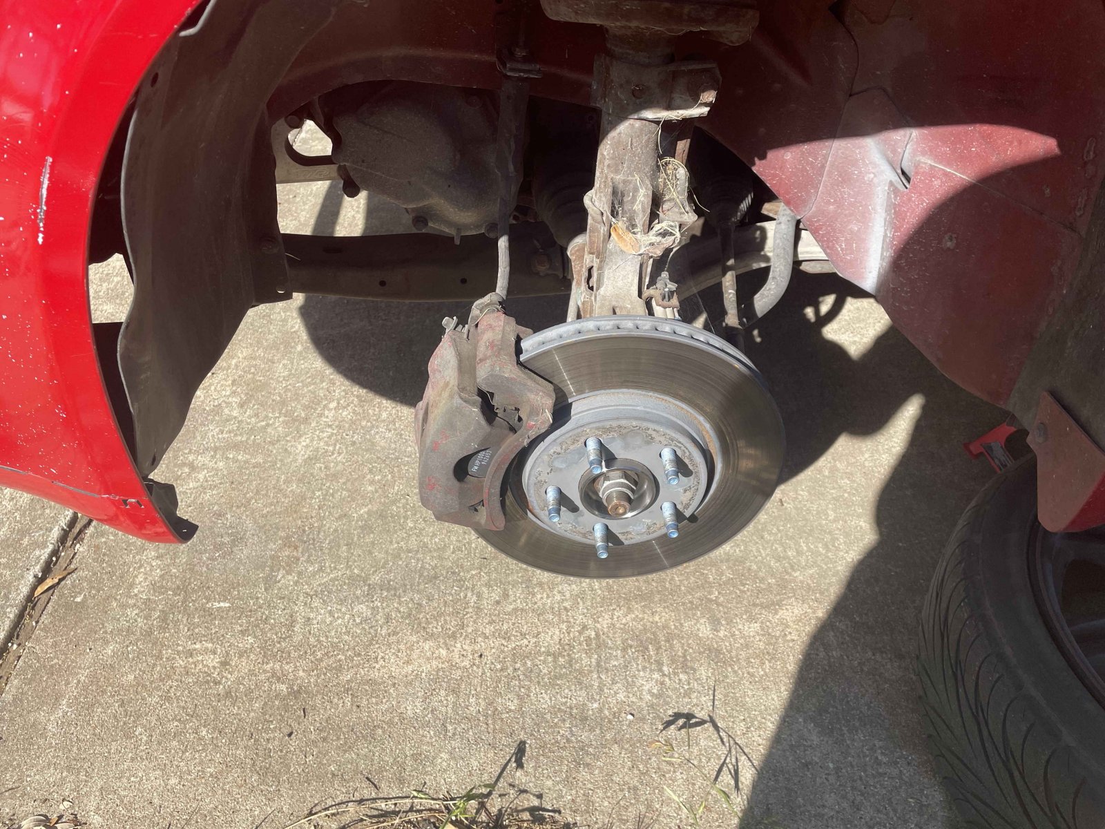

Buy a new upright for the side you cut the sway bar link. Check the other side too. That one looks cracked beyond repair and use. Or maybe my computer is playing tricks with my eyes.
Dale
Might be casting or a crack. Looks like casting, but it’s hard to tell from the pic. Just be sure to check it.
and as stated before, the wire you cut was for the abs. Not needed. Label it though so you know to remove it when the time comes.
