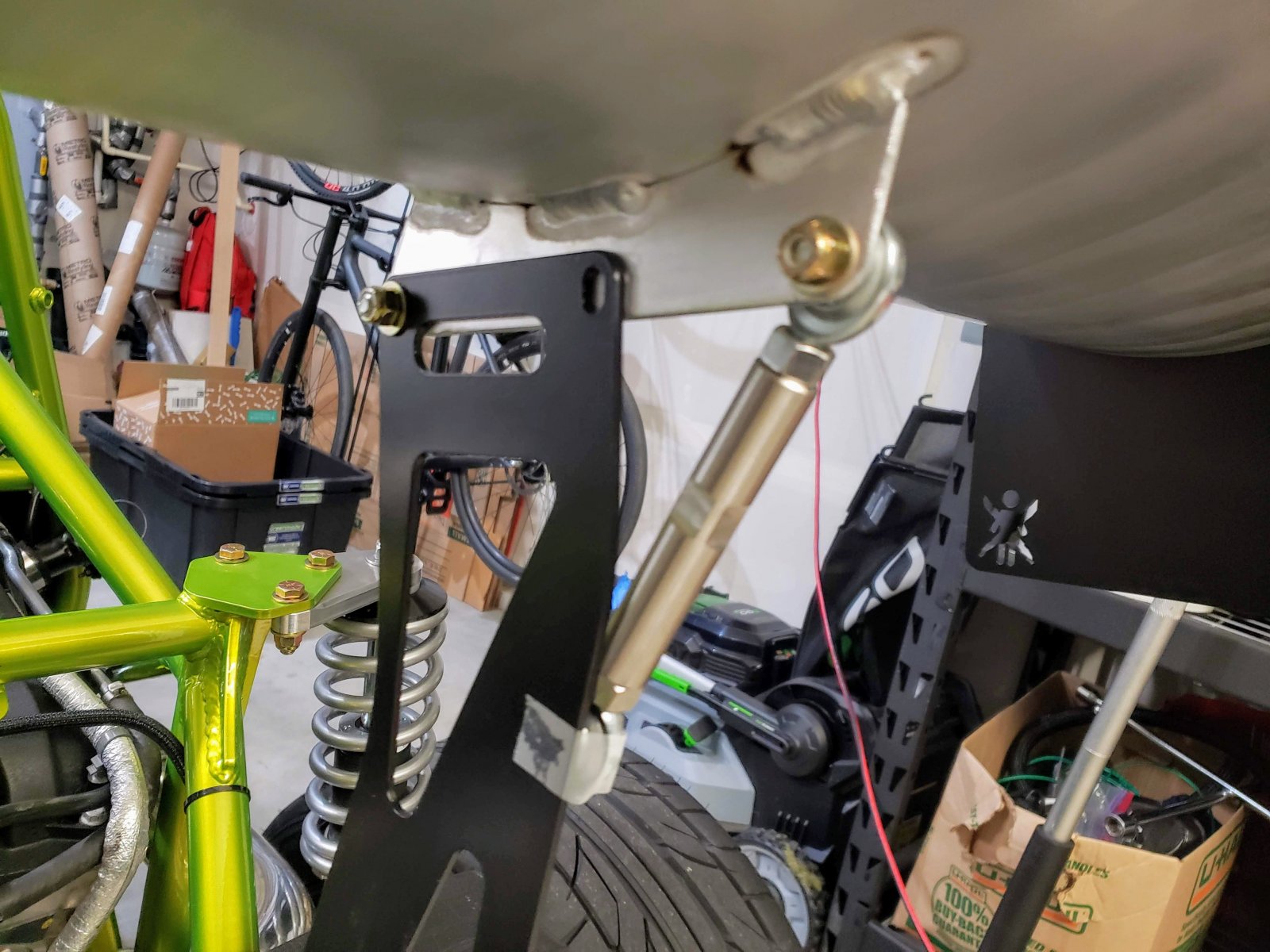

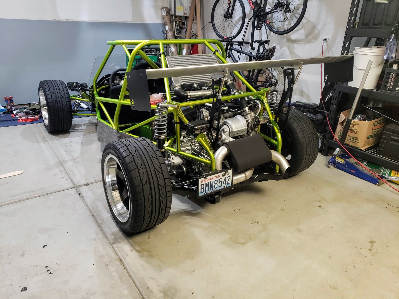

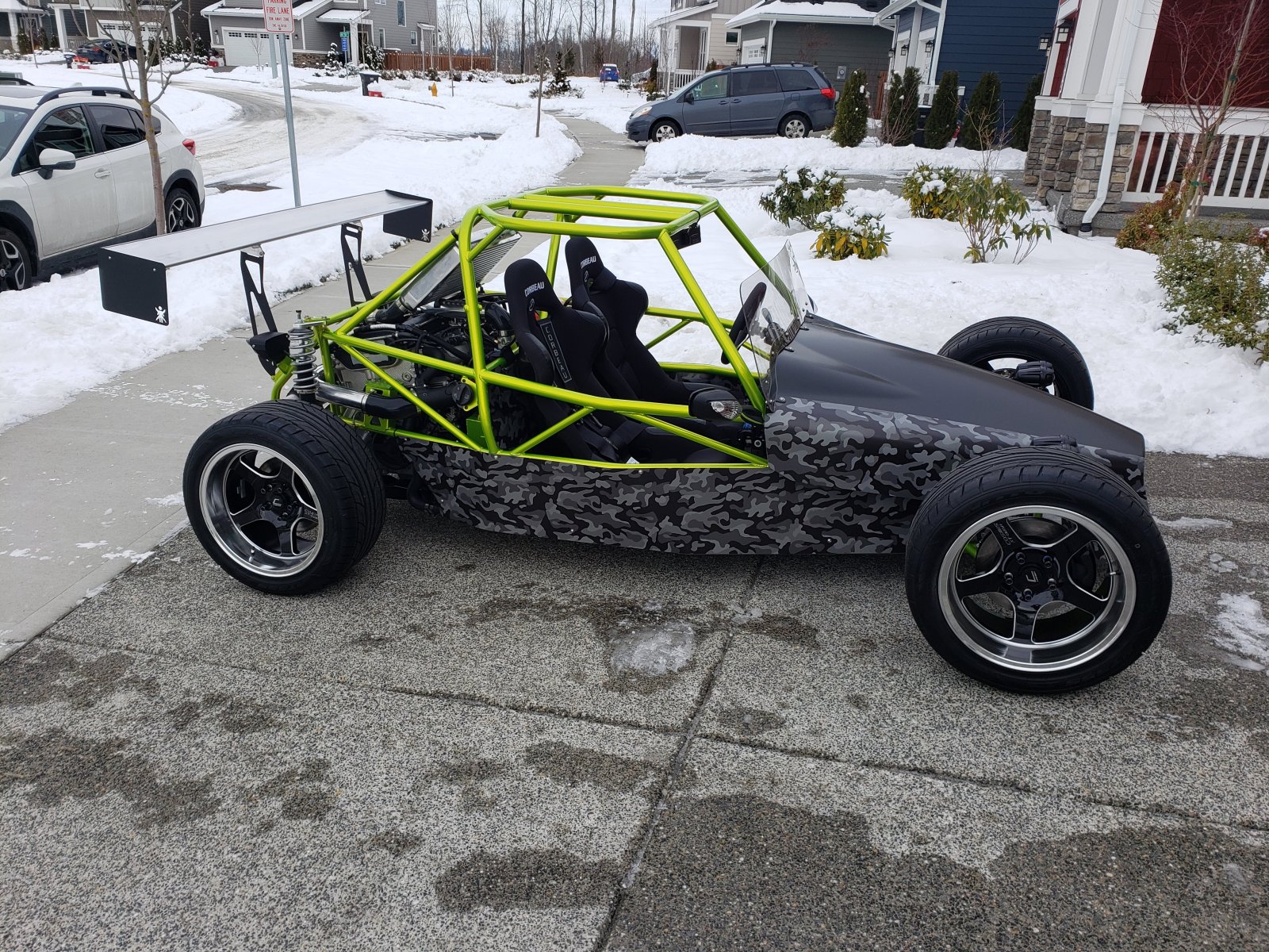

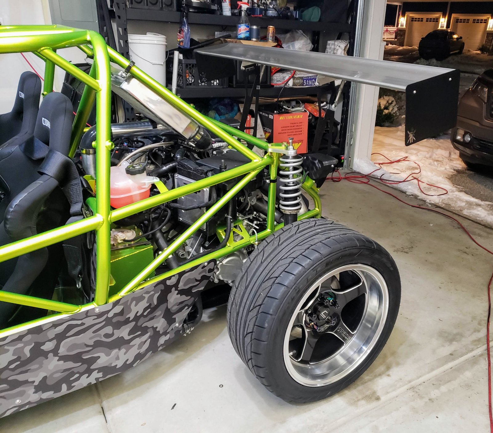

So this took 2 months to get, a bit of Black Friday/Holiday delay but thats ok. $671 Shipped

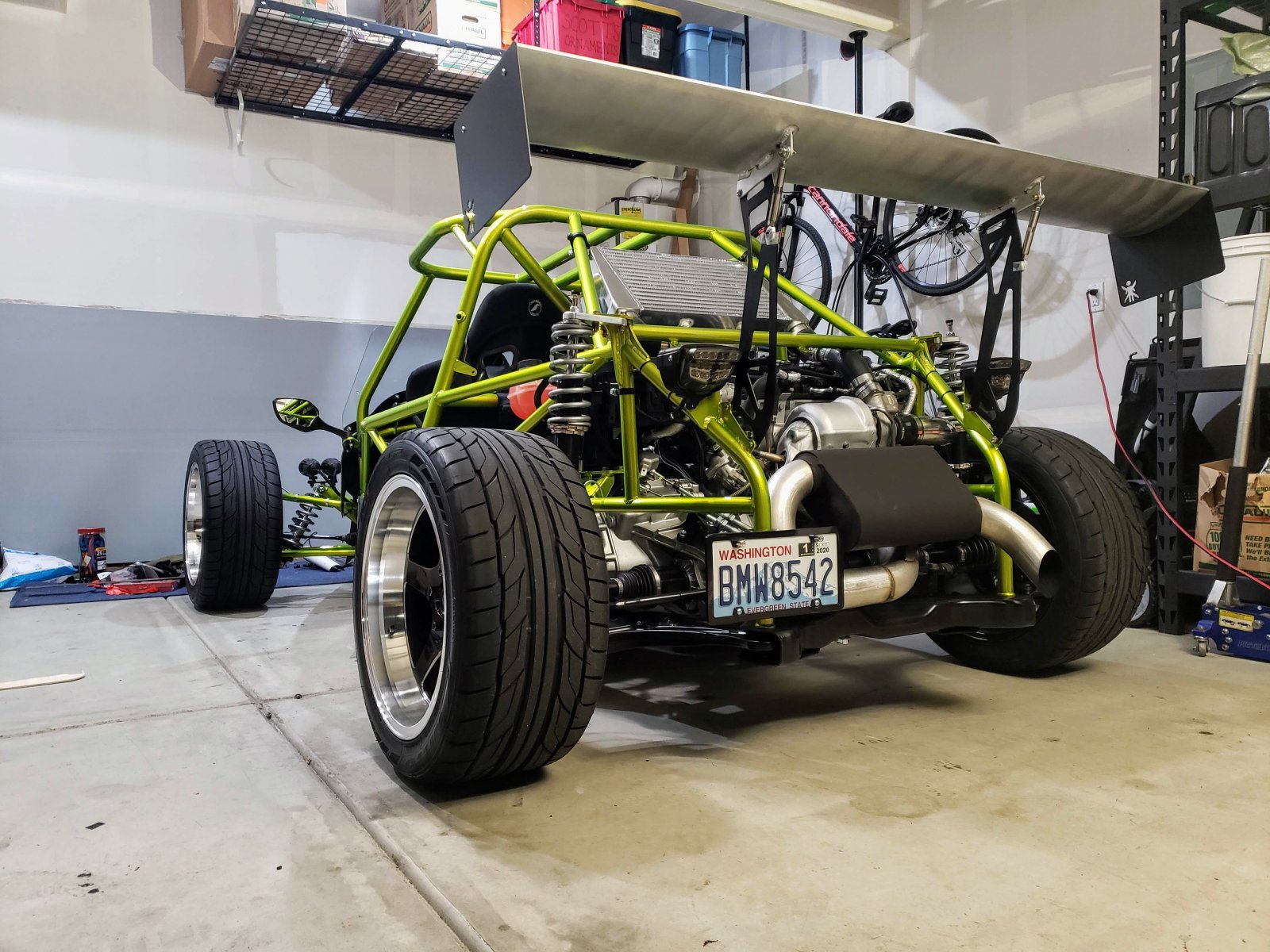

Quick review, amazing construction, perfect fit for what I am working with and have uprights for. I purchased the adjustment rods separately and as you can tell the bottom is taped for fitment tests. I will need to expand the holes on the uprights to allow for larger bolts. The rear hole on the DF bracket can be used as id does have a slotted design for up and down movement. I will probably trim the upright down similar to what Alex did. Once it is all in place I am going to be using 1/16 cables to hold it all in place instead of the cross bar.

Looks great! Is this a custom wing, or did you order one of the kits from the NLR website. Wondering about the fit with the brackets.
IDRVSLO
I used the Exocet brackets and had them welded at a specific width. Johnny(owner) will help you out.
This is 68" wide. Most will be more narrow but my offset and tires are pretty wide.

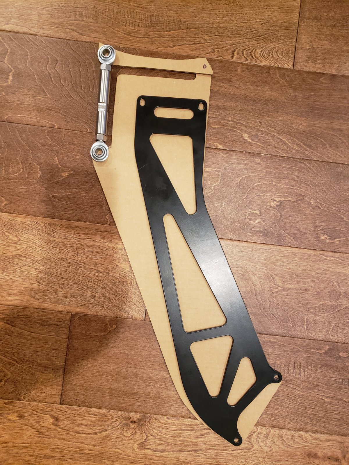

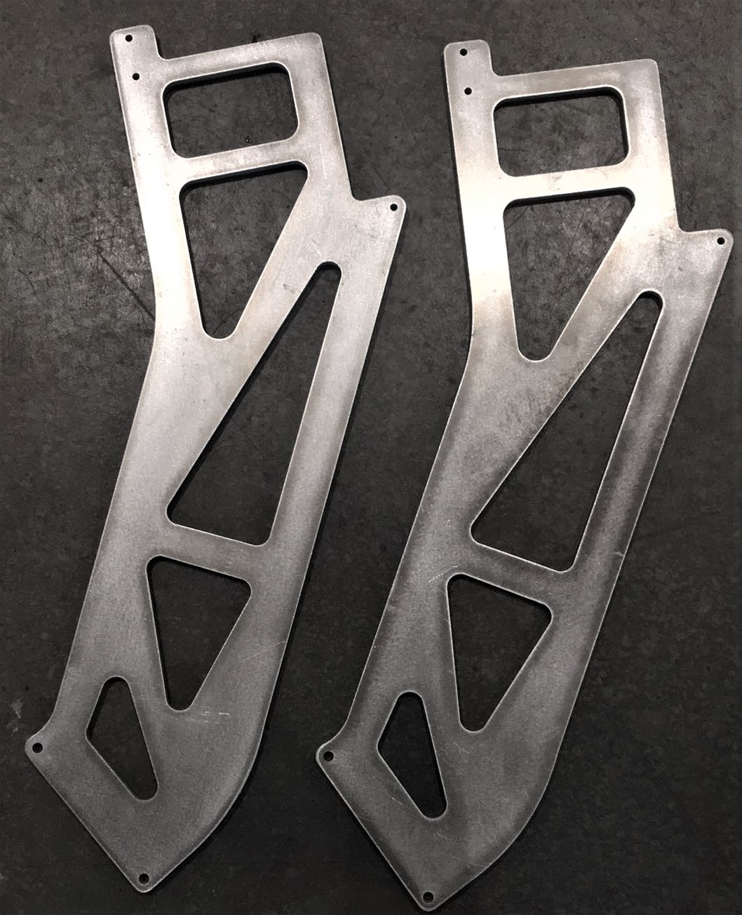

Thanks! The new brackets I am having built will be cnc, 1/4"
Here is my design. It will have multiple slots cut too.

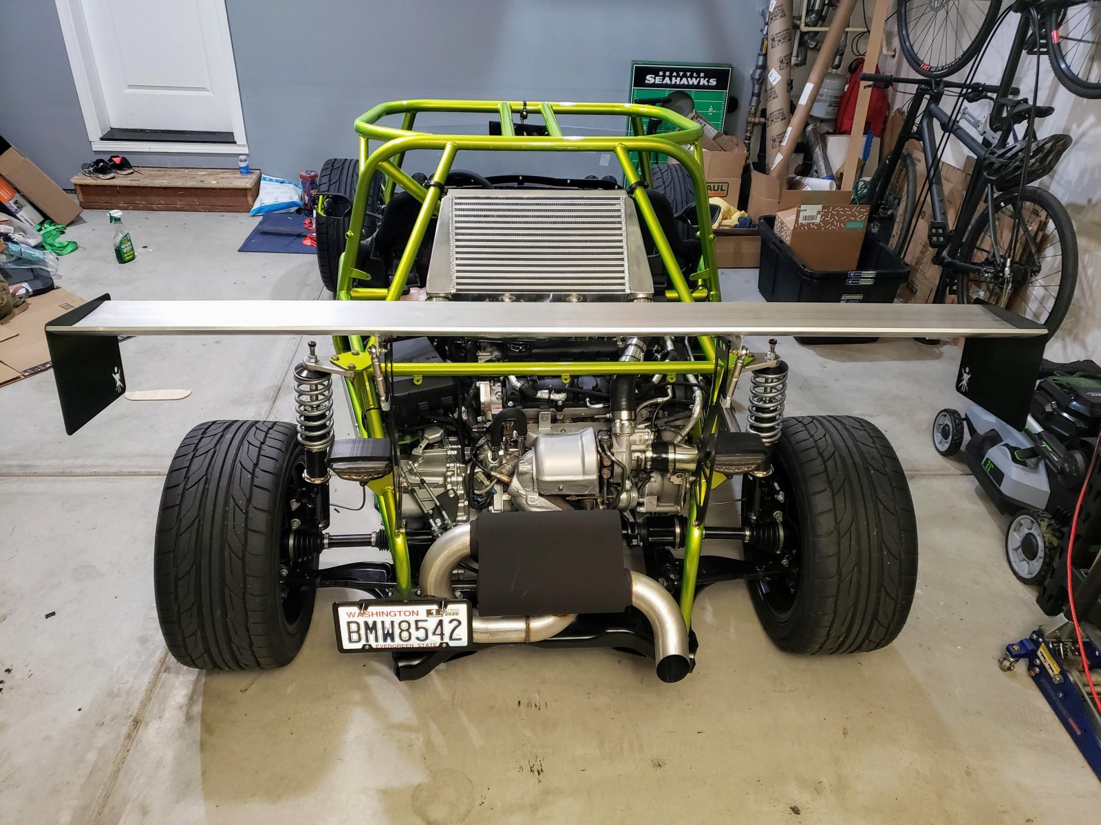

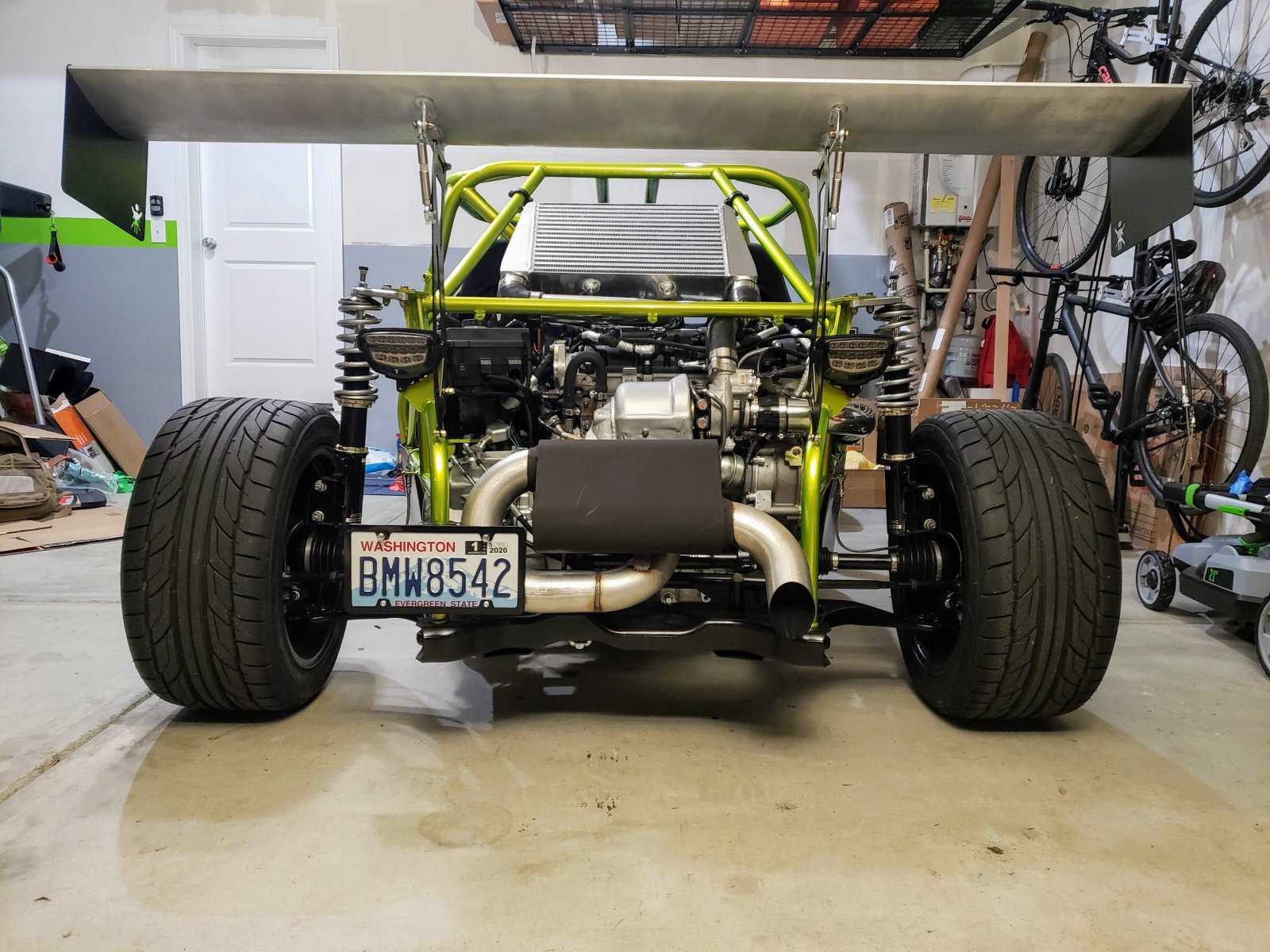

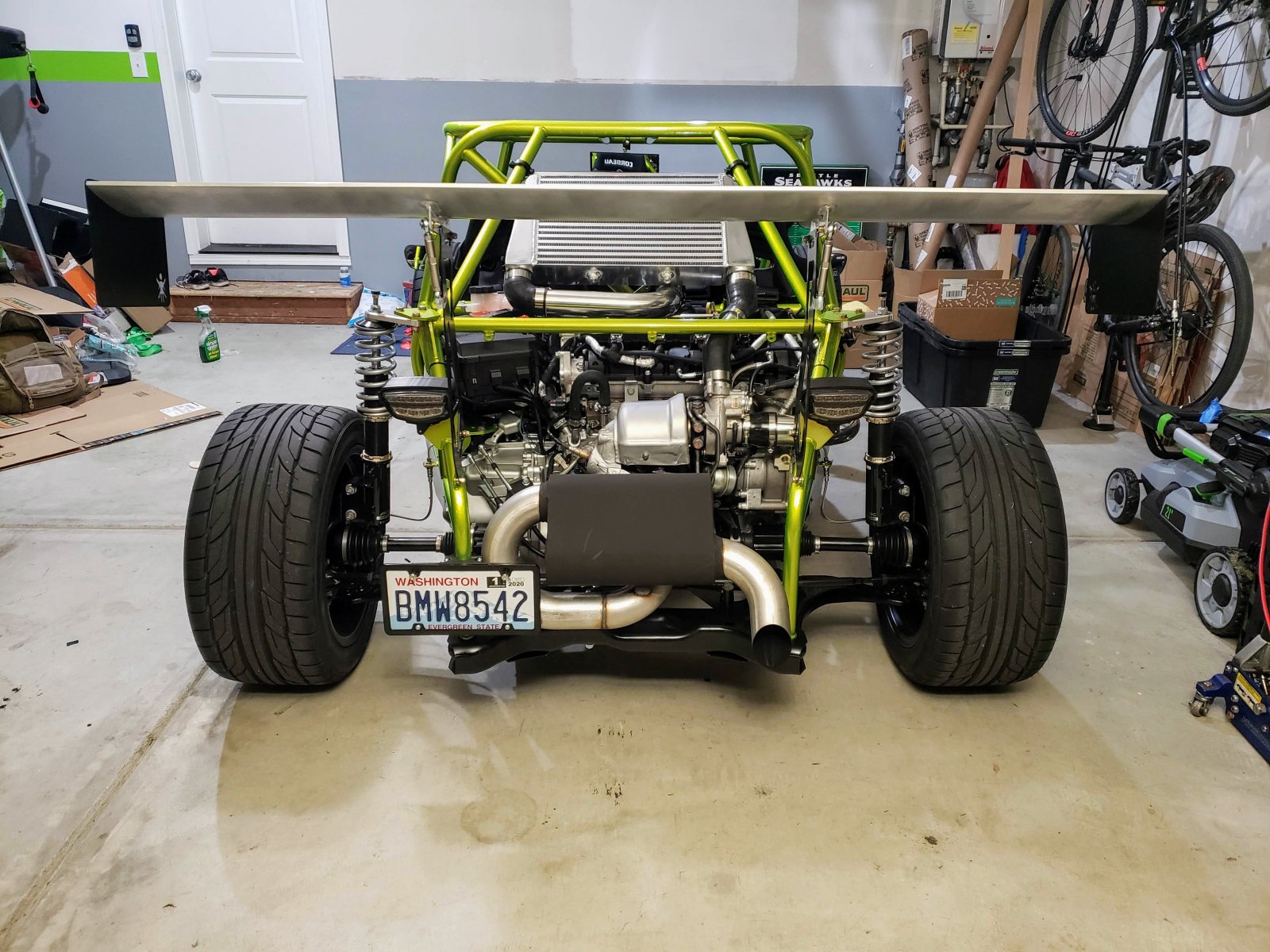

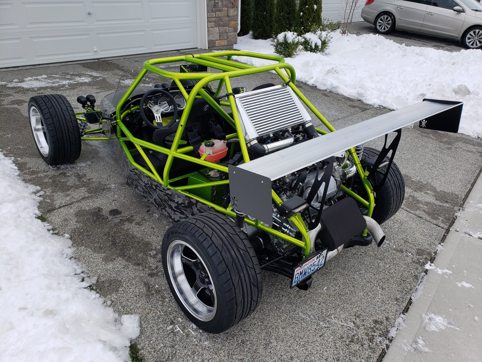

I really like your intercooler set up, I was thinking of mounting it behind the motor but this looks like it is in a better position for cooling.
Would you mind sharing the parts that you used for it as well as the air intake?
(like this
The funny thing is we used an almost identical intercooler I think. It’s just mounted in a different position.

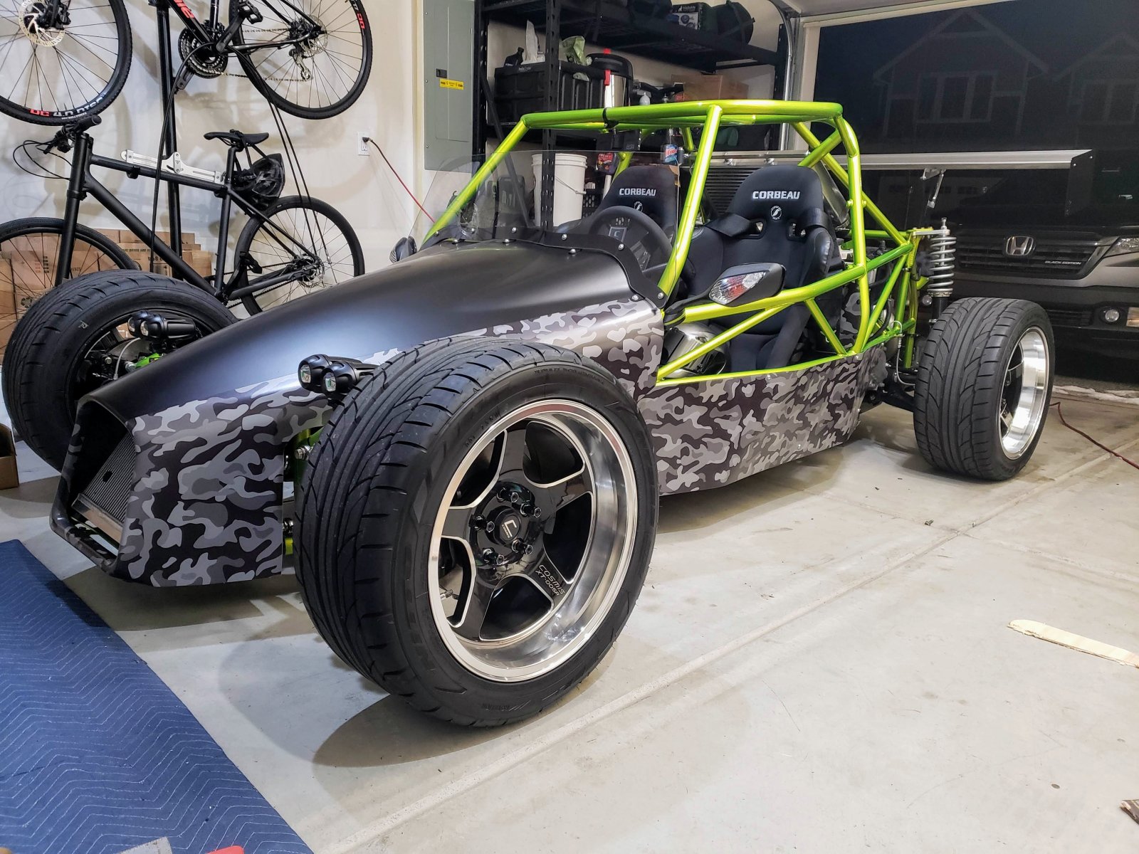

Wow lol that's some true will power to drive in that
I almost died......ok a bit dramatic but it was painful. It was 55 that day and the first Monday after I got it registered so I was a bit anxious to take it out.
