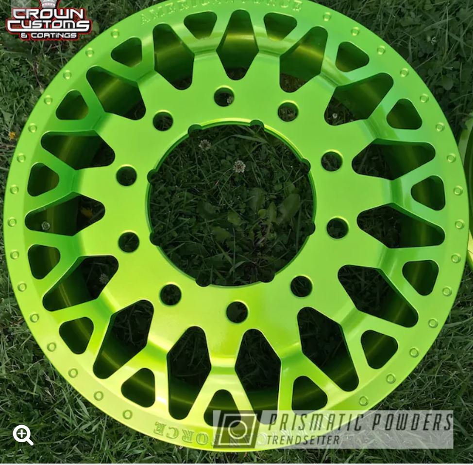

Not quite, the one you posted is a candy Shocker Yellow over Super Chrome. The one I am doing is a base of Illusion Shocker with clear over.
https://www.prismaticpowders.com/ga...n-illusion-shocker-with-clear-vision-top-coat

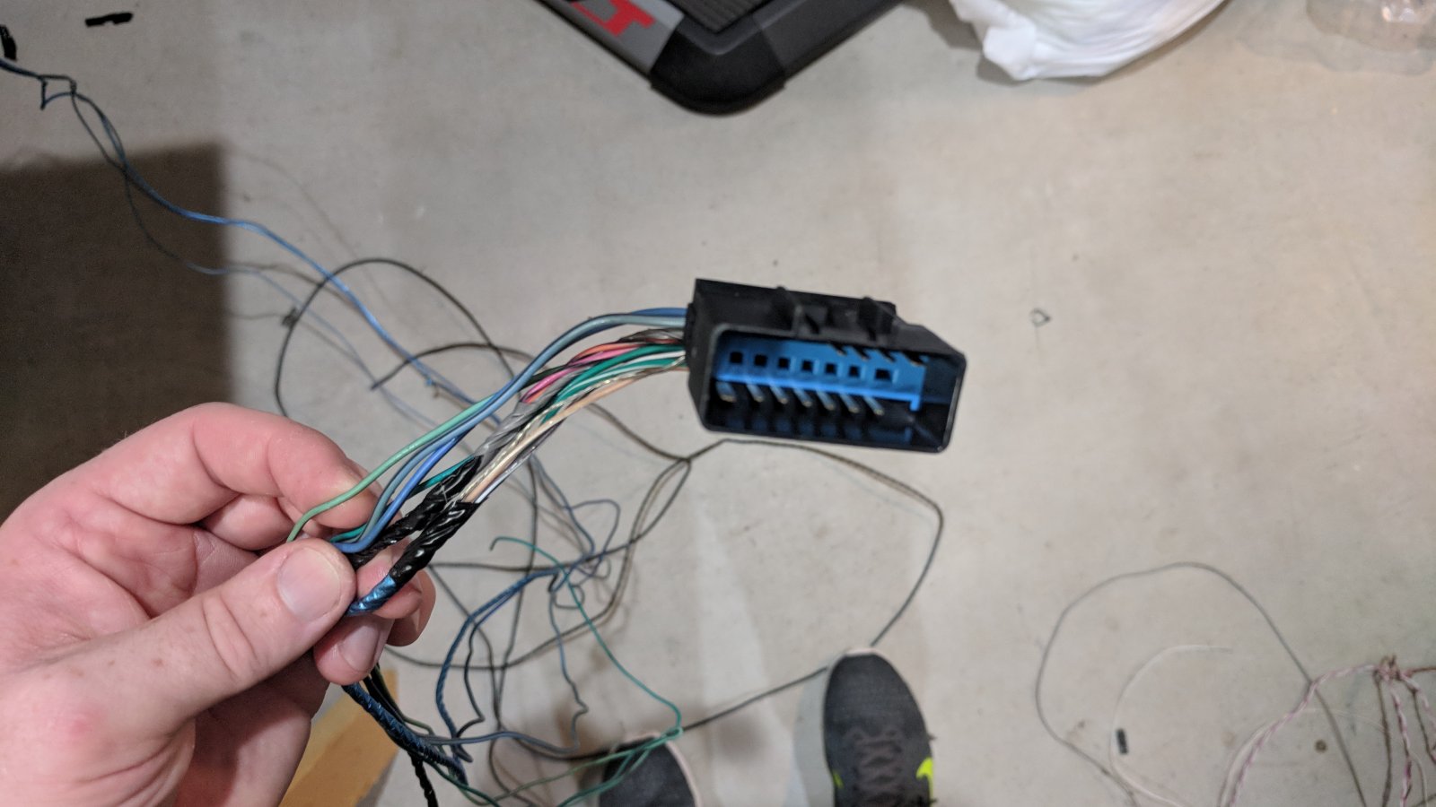

IDRVSLO

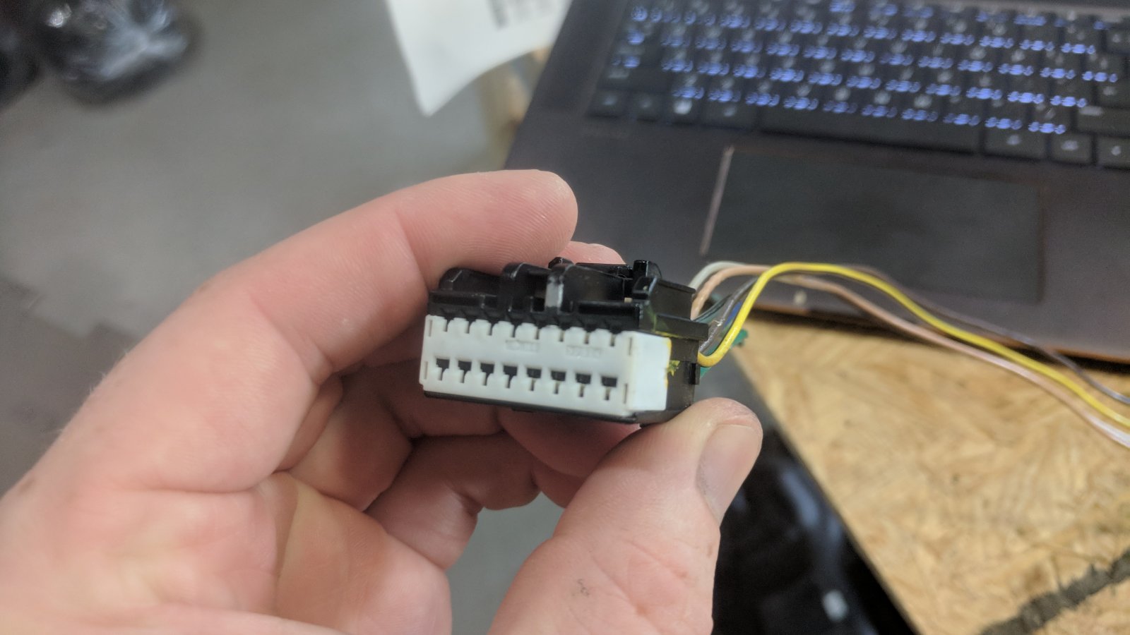

Is this the amp plug? The 4 wires cut were attached to the plug with the blue foil from the beginning of the dash harness video.

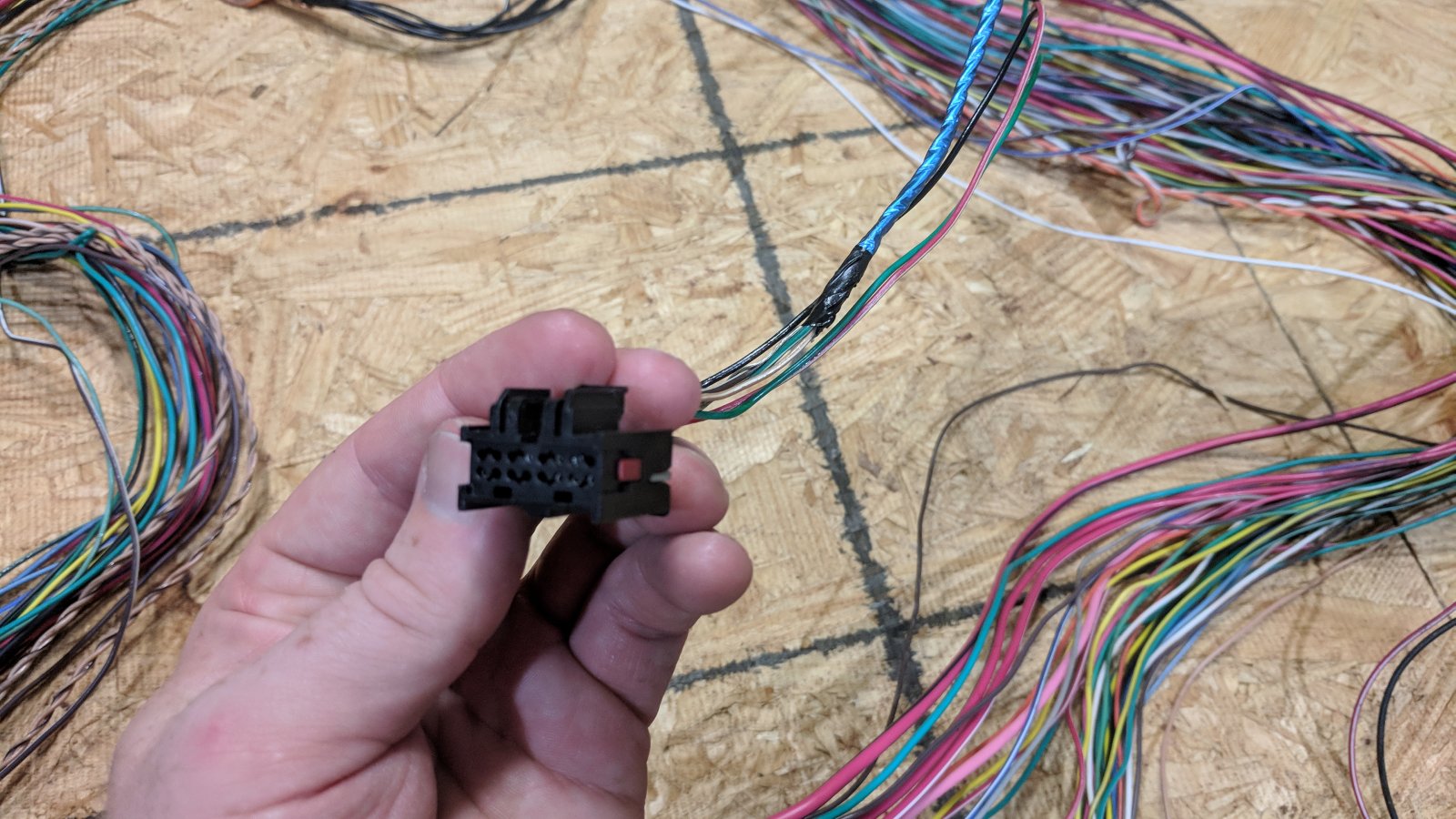

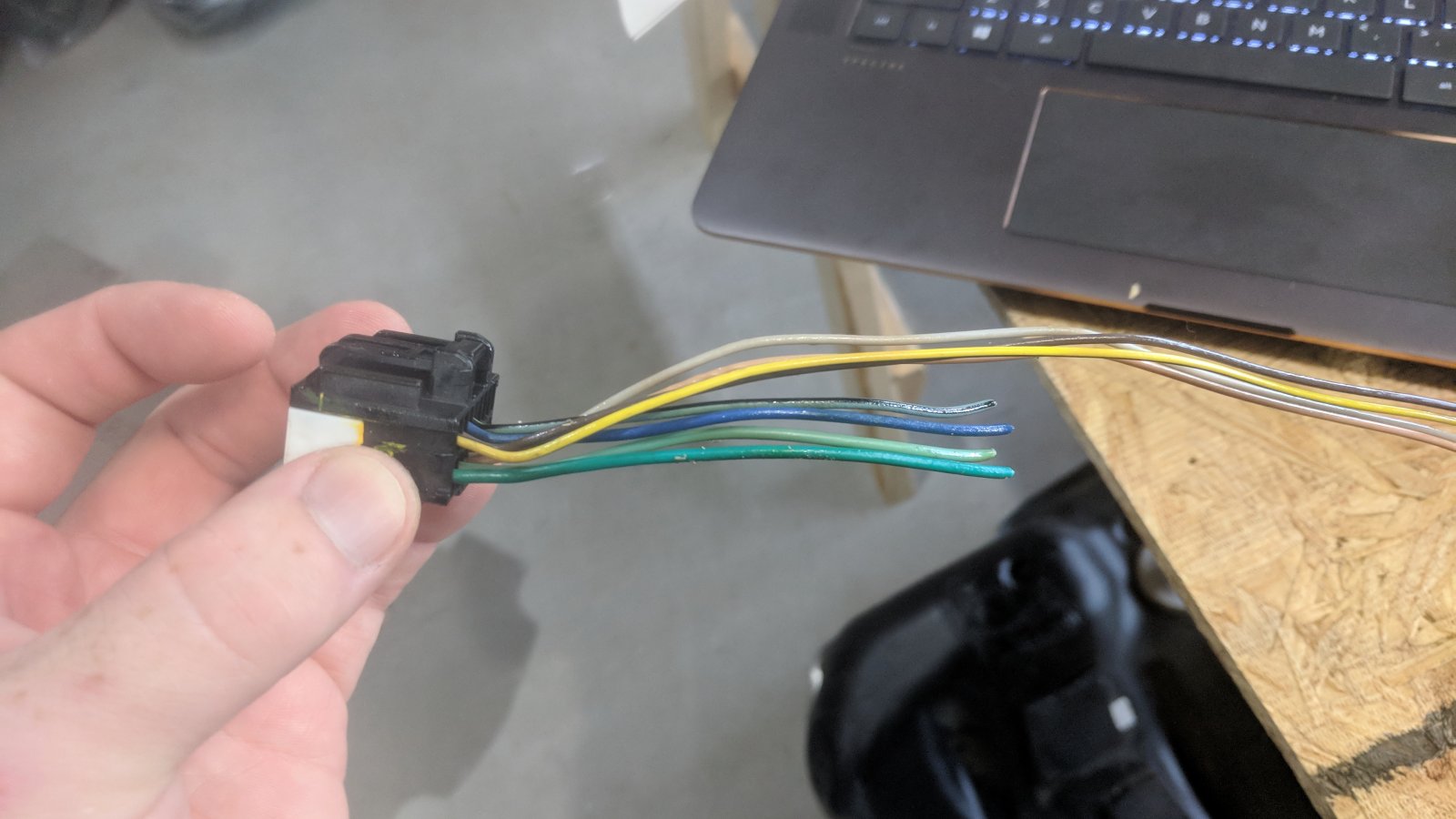

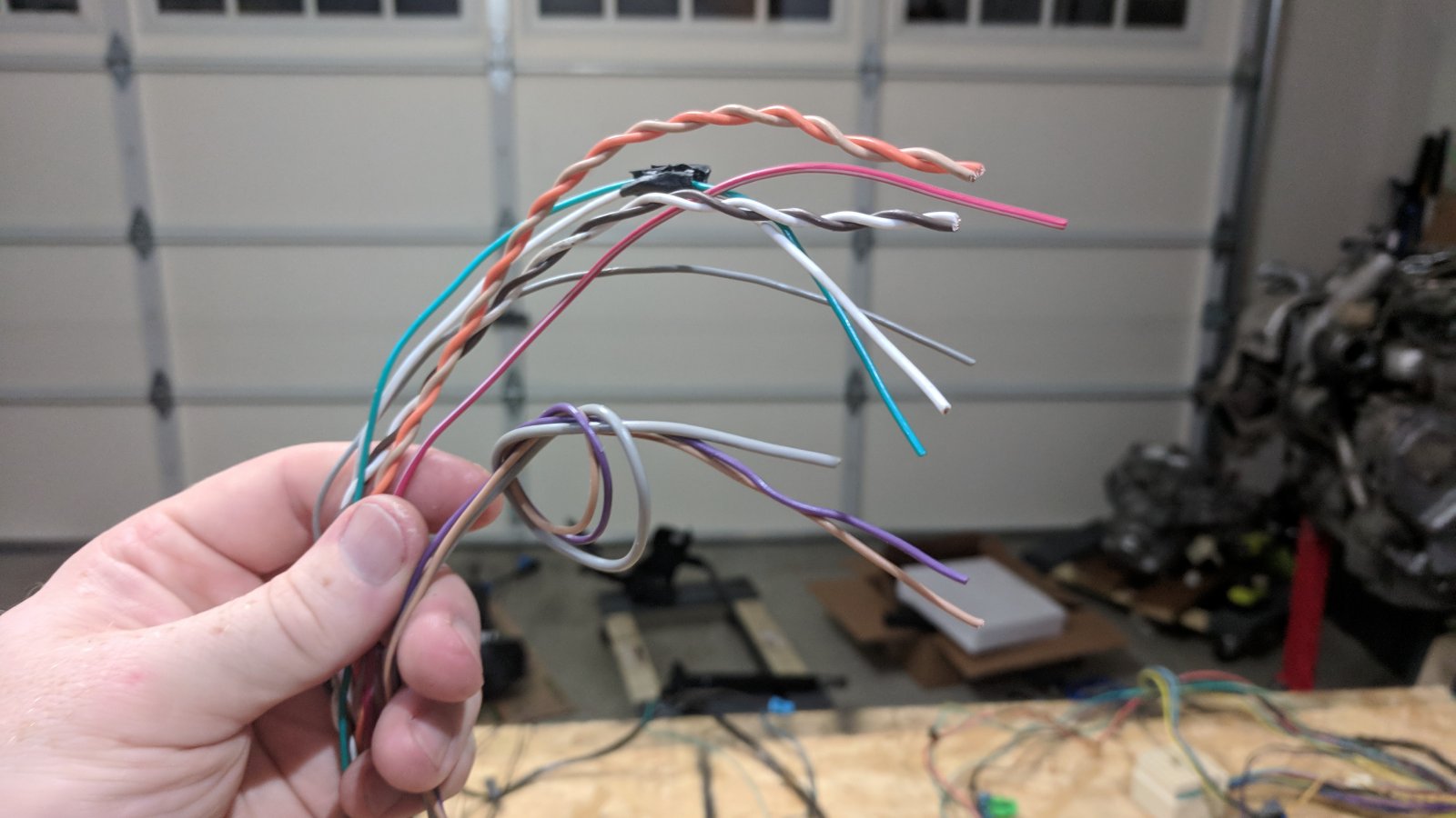

IDRVSLO

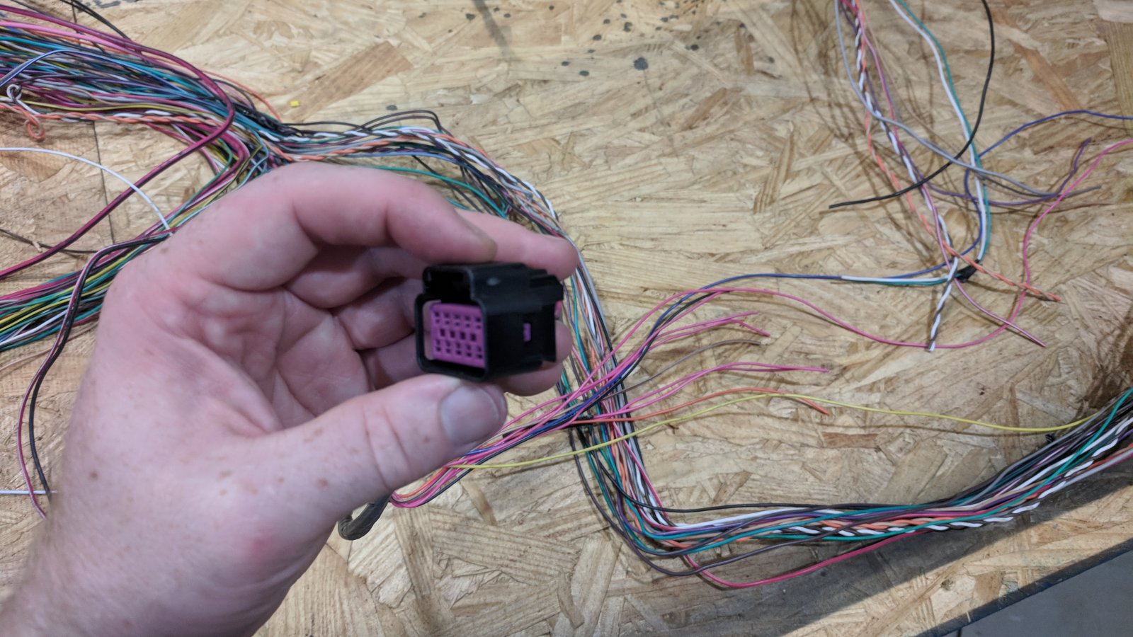

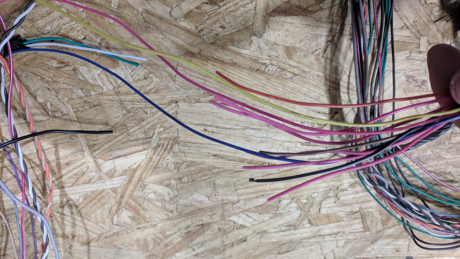

Ok so I have some plug questions.....yay, haha.
Pic 1/2) Passenger seat wires, mine has an extra blue/pink/yellow wire....cut and remove? In the video it was all red and came right out.
Pic 3/4) Is this the black dash connector from the passenger side wires?
Pic 5)Black XM connector?
Pic 6)Correct fuel wires?
Pic 1&2- cut plug loose keep plug and remove wires.
Pic 3&4- yes it is, cut and remove wires.
Pic 5- remove all wires
Pic 6- keep the knotted wires and remove all of the others.
