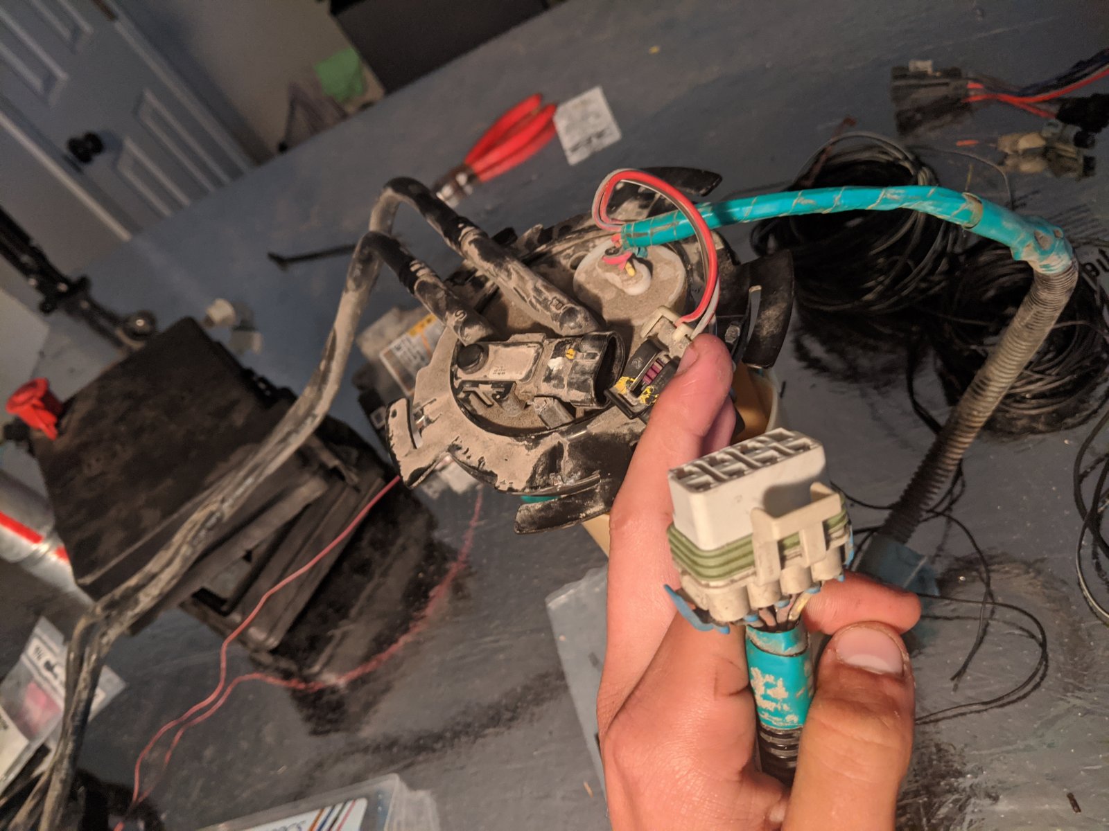

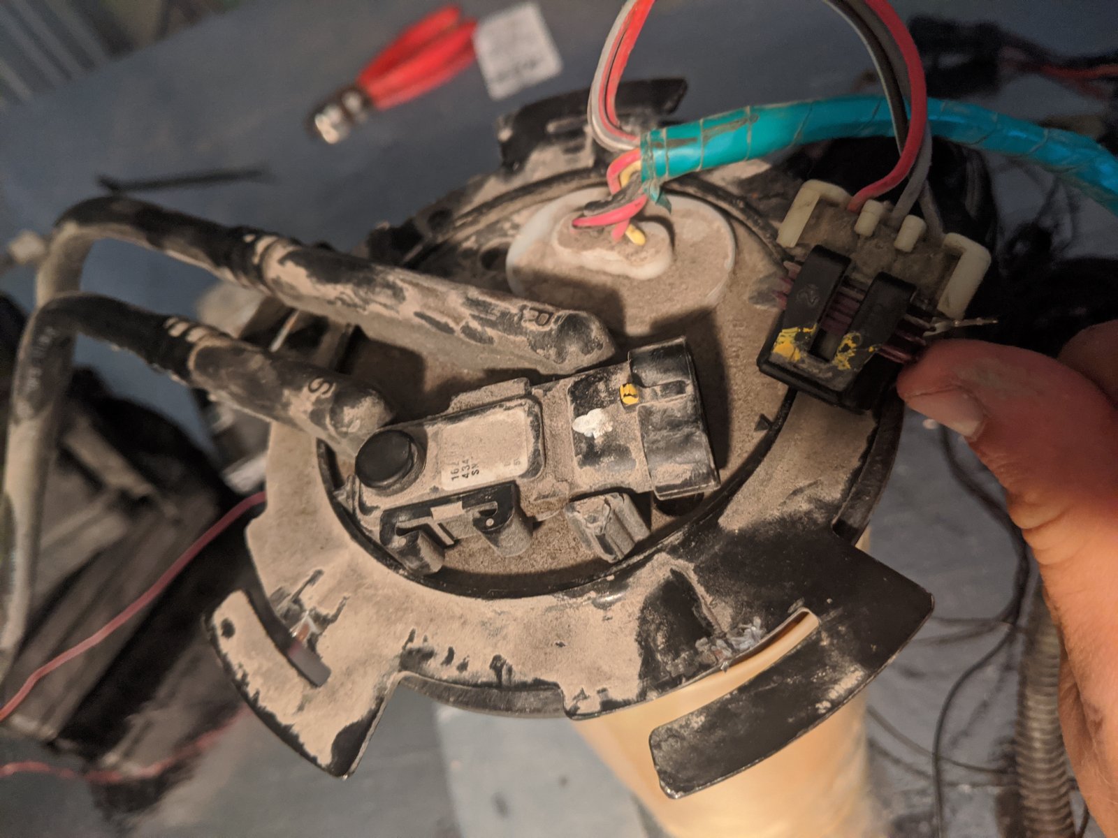

My fuel pump harness is different. Am I missing a small harness? I believe this is my full fuel pump harness.
Should I cut the wires by my thumb in the second picture and extend the wires to the connector and use that? I noticed the wire colors differ from the video.

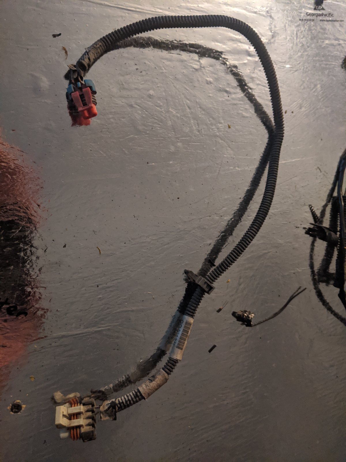

I think the separate small harness in the last picture is for the evap system, correct?

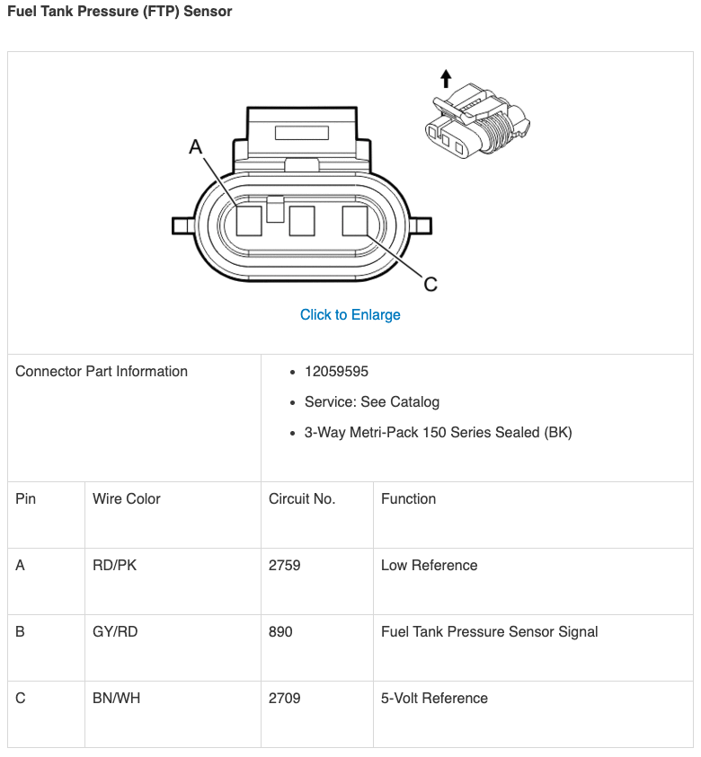

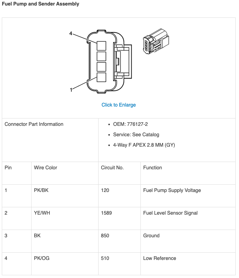

I don't see a full wiring diagram in my stuff but I did find these pinout charts. Although, as Ross mentioned, the fuel pump and sender wiring doesn't actually change aside from the wires being shortened.
