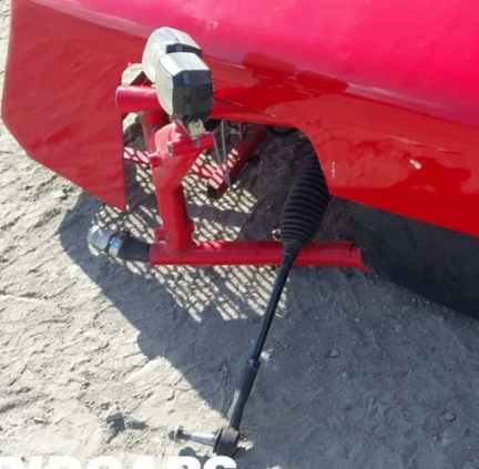

Doing research on a Goblin for sale near me and I found that it was damaged and sold at auction previously. I have not taken the drive to look at it in person yet. My question is can this damage be properly repaired or was this frame damage too catastrophic?
This one picture cannot tell the whole story. Yes, there is some visible damage to the lower frame rail that is severely bent and the upper shock mount and a-arm mount are pushed rearward. But the rest of the frame would need to be cross measured to determine any bending or twisting that this accident may have caused. A frame can be sectioned and replaced, but there is almost always hidden damage from an accident. There will be potential damage to the radiator, the steering rack, the UCA/LCA, the bearing and hub upright, coil over shock, brake rotor and caliper, along with the wheel and tire that was mounted on the corner.
This could turn into a significant amount of work to fix this. You may consider purchasing a built - or not yet built - car/kit. This is an option:

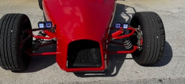

Thanks for the incite Desert Sasquatch. The car was fixed by the current seller. I found the damage doing some digging online. I'll speak with the seller about the repair and if I do decide to move forward, I'll have someone qualified take a very good look at it. Here is a pic from the seller, post repair:
This being the only picture, I would buy it for the price I feel the drivetrain is worth and contact headquarters for a new frame.
Edit. Looks like they got it back together. Curious on how they fixed it.

Nah, that assembled picture is hiding something still. Look at drivers compared to passenger side. Its not assembled correctly. Lights are crooked, suspension looks skewed.
Is this 339?
K
The alignment looks toed out and the driver front tire looks like it's wearing funny. I'd have a lot of questions, especially if it's not being advertised as wrecked and repaired. I personally would only consider buying it as a donor for a fresh frame.
