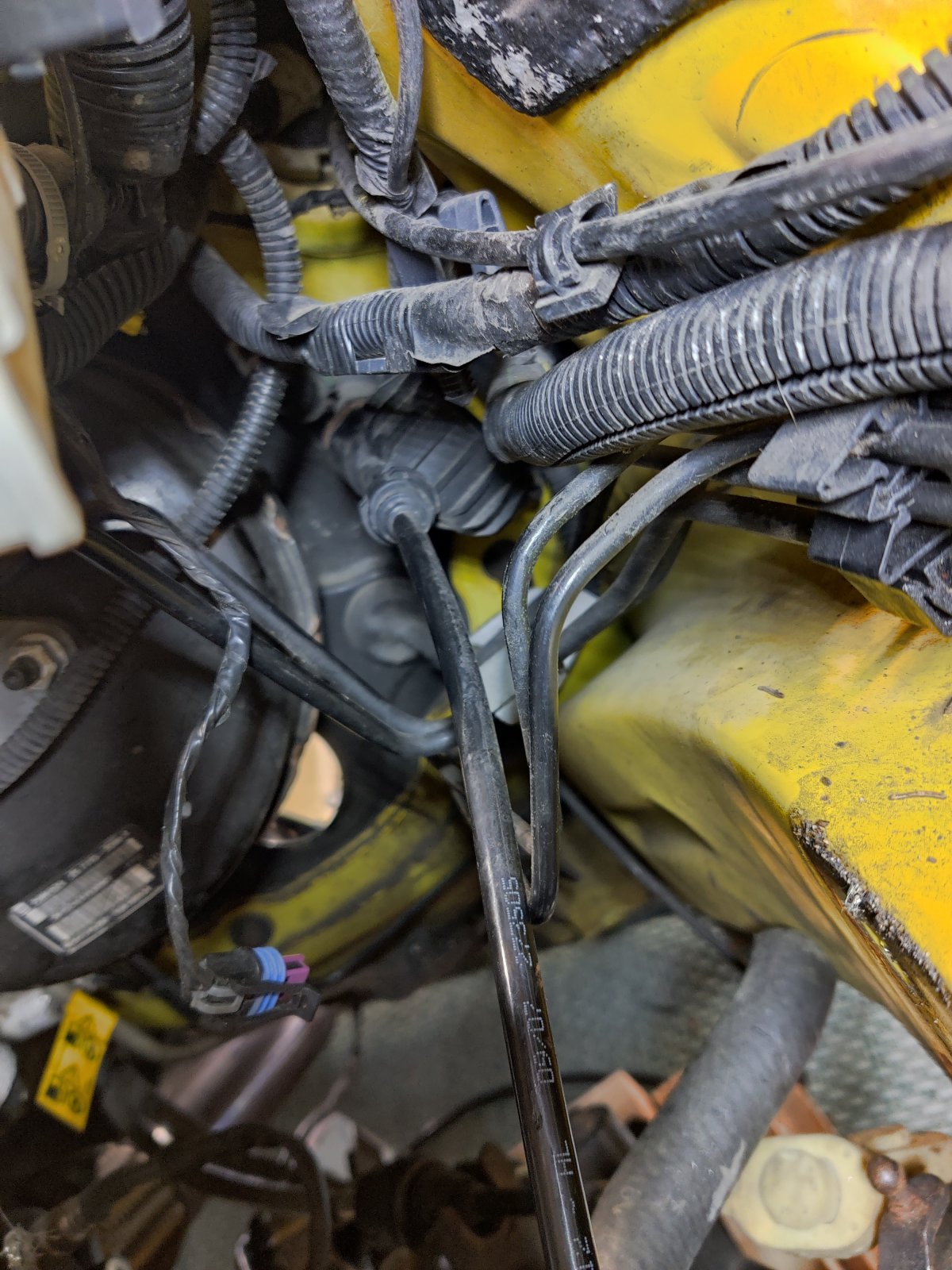

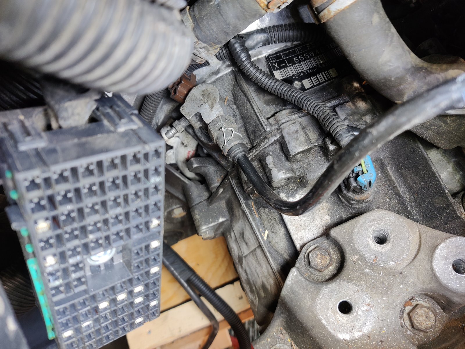

I've dropped the engine but have this one wire from the transmission to the dash it looks like. Do I just pull it out of the transmission? It is the one with the wire wrap on it.
Hydraulic clutch line if I understand which one you are asking about. Some replaced the oem clip with a piece of wire. Remove the wire and it should pull loose. Brake fluid will leak out.
L
There are 2 electrical connectors on the transmission, the speed sensor and the neutral switch, that need to be disconnected and labeled too.

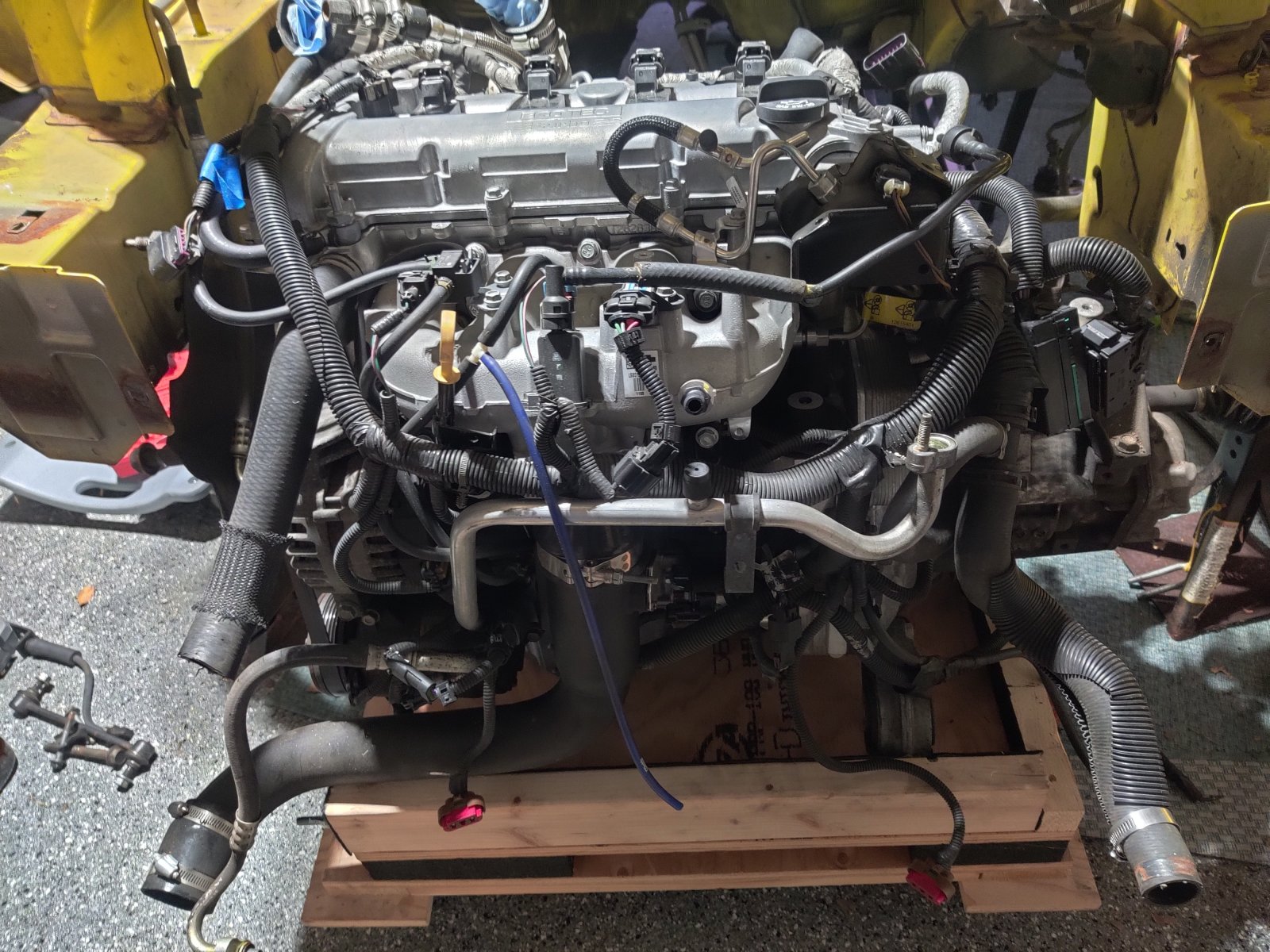

I didn't see any connectors to be disconnected for the engine drop. I did break the evap line even though the video clearly shows it. Derp. Hoping it's not needed since won't be doing emissions.
Used quick jacks to drop the engine onto a dolly then raise the car up. Worked great.

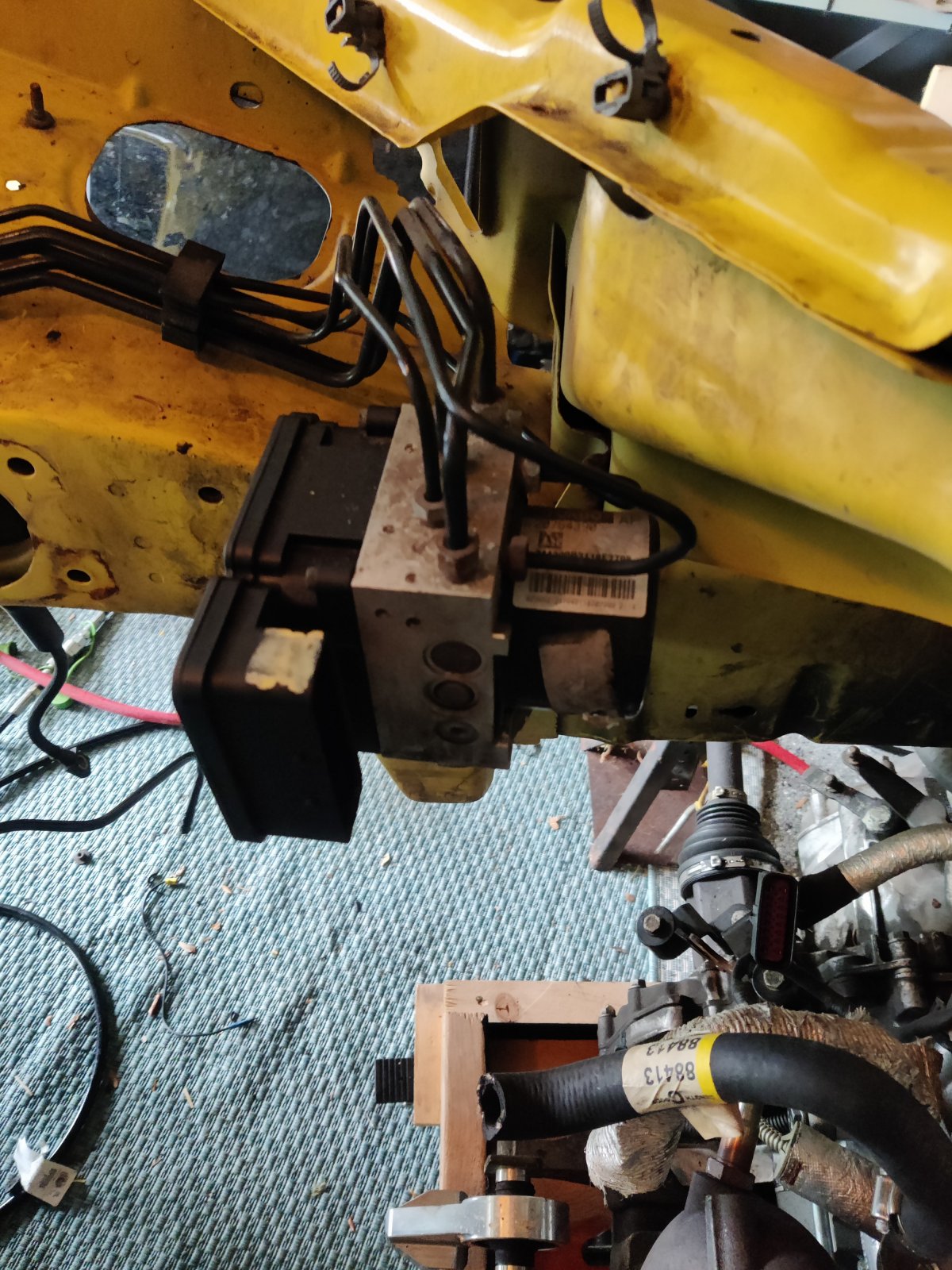

Do I need this black box from the engine bay?
