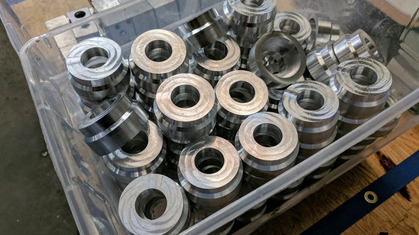

What is this part? Have two but do I need to use if I have coilovers?
