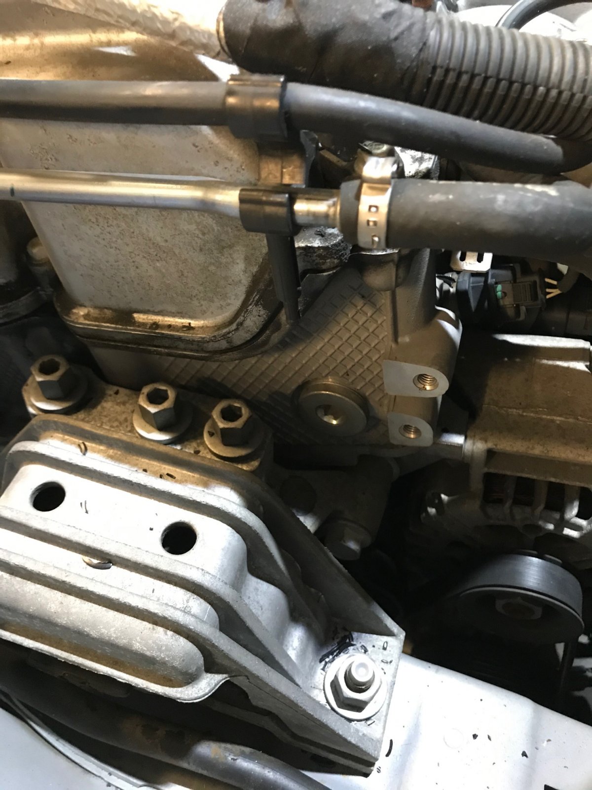

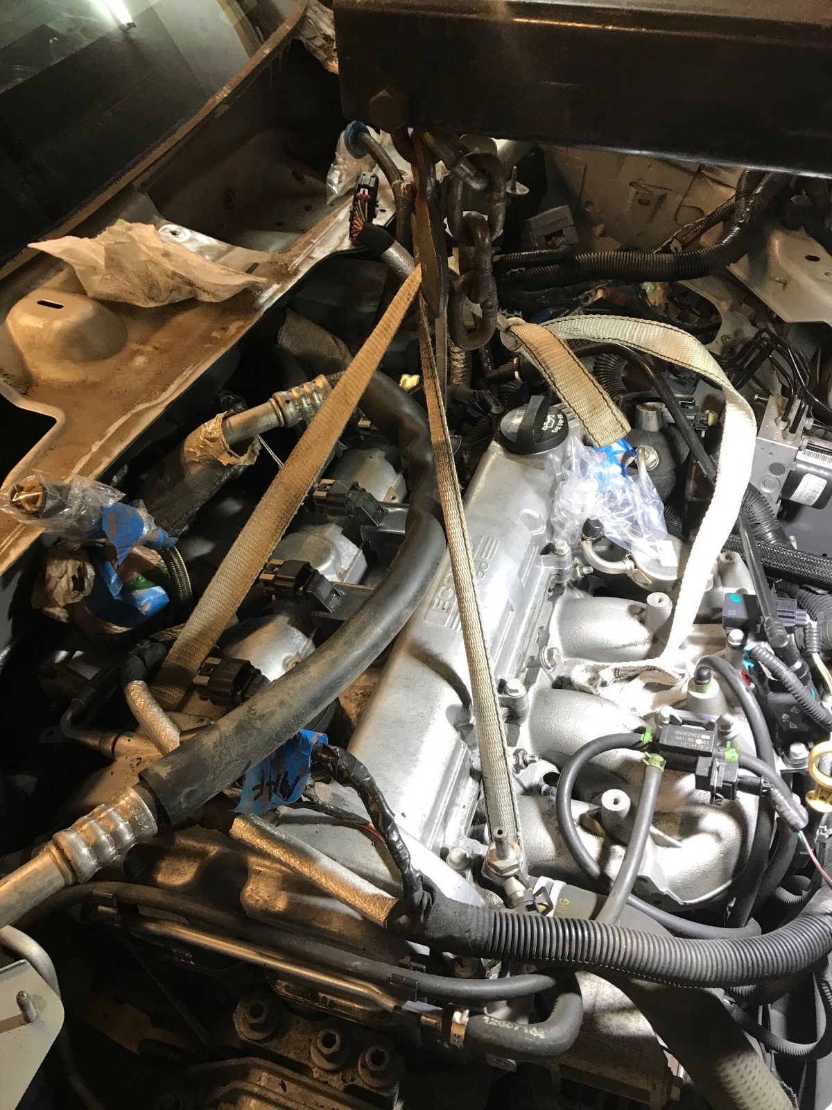

Video Part 4 shows two lift lugs on their base engine. My 2.0 TC does not have them! Crud!!!! I see on the accessory belt end where it could bolt on. But the other end of the engine is a mystery to me. Help, please. Where did everyone else get their lifting lugs?
OptimizePrime
I feel your pain on this. I went through the exact same thing. I posted up on the cobalt ss facebook groups looking for both of the lift points and what I found was that the lift lugs differed depending on your model (so you're not missing anything on your engine). Long story short, I got bent over and purchased these for $25 from ebay and they work great.
View attachment 11427View attachment 11428
Here's a method that I've seen used; i.e., a bolt through a link in your lifting chain. Also, methinks there are universal lifting brackets available on amazon/ebay.

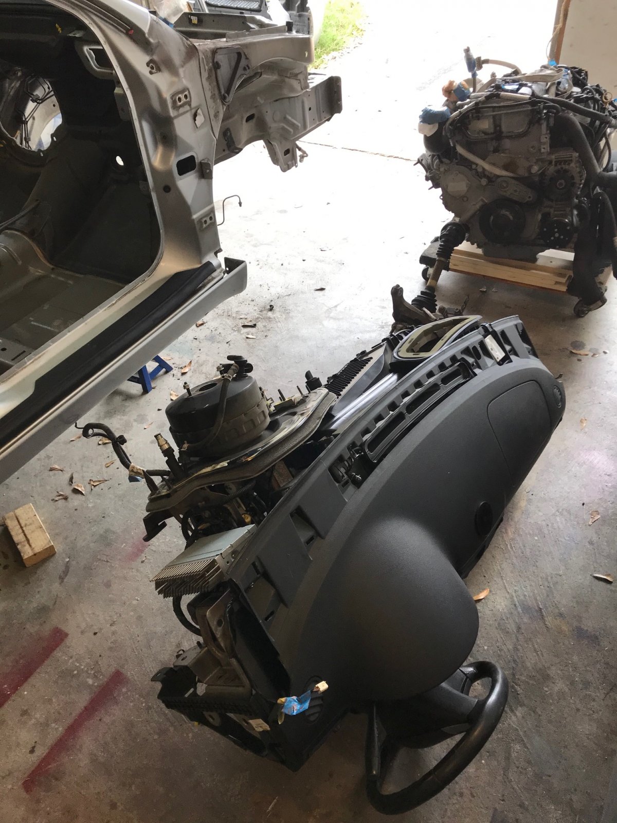

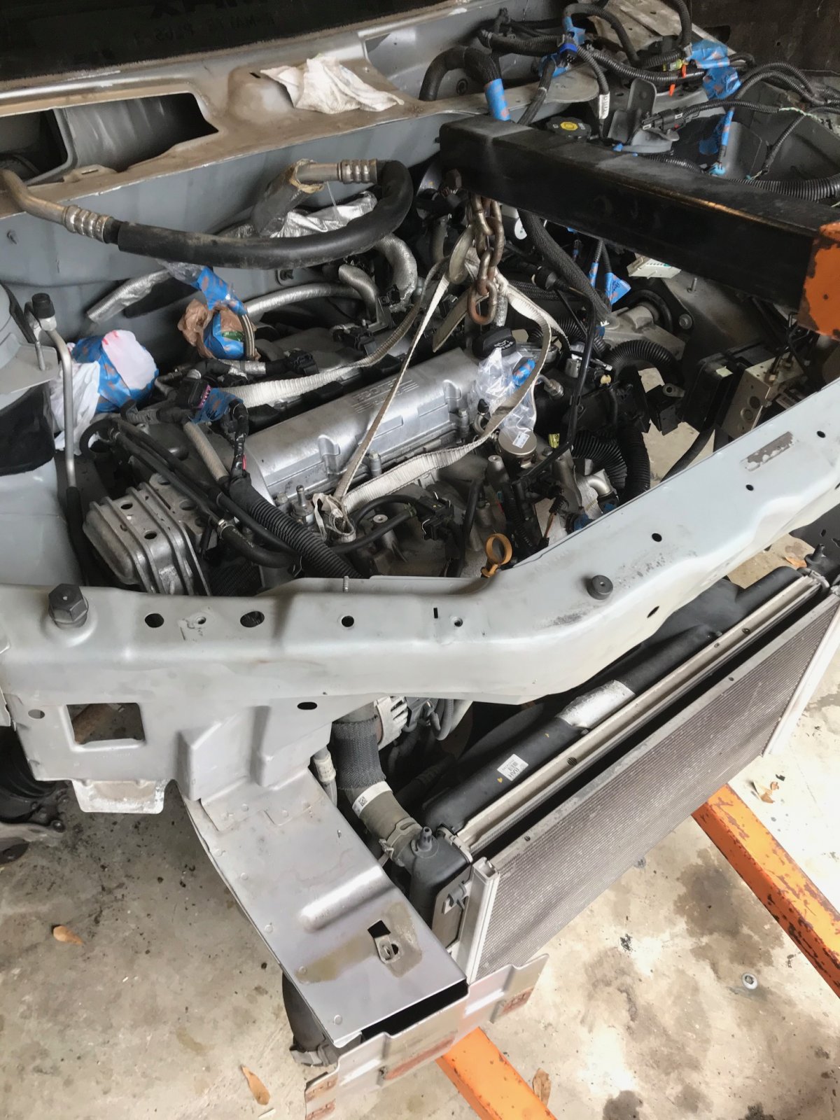

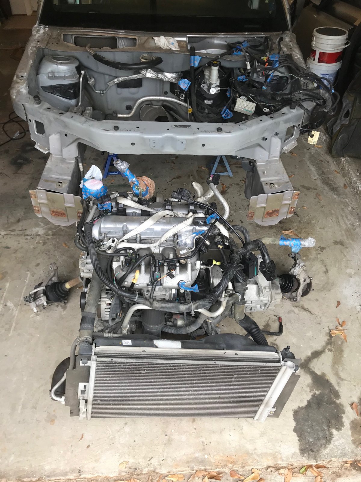

Hit another milestone today. Engine dropped and on the dolly. Wooohooo! No problems or issues. Wife stood by just watching incredulously at what the heck is getting accomplished in our garage. I am going to start another thread regarding the conversation above about lift lugs and dropping the engine. Hopefully it will help some others.

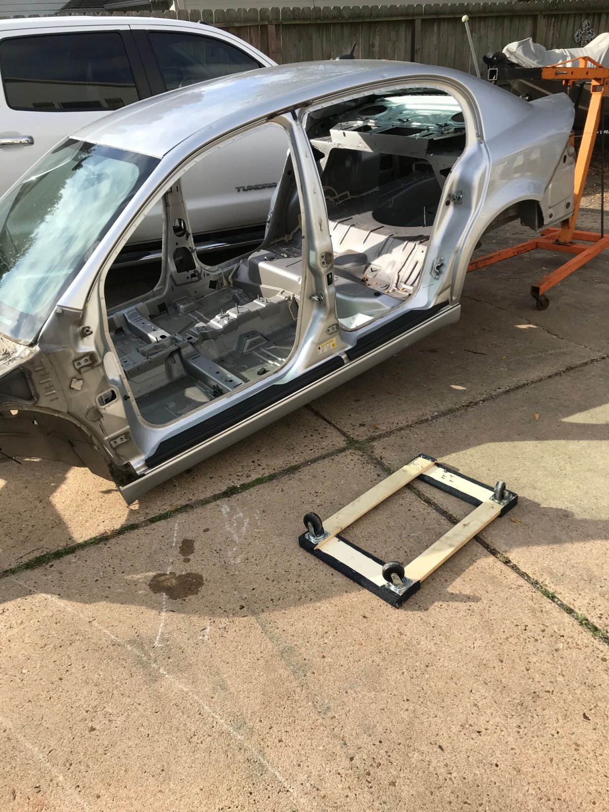

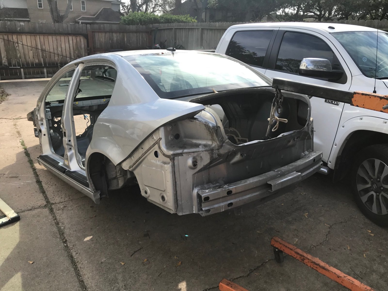

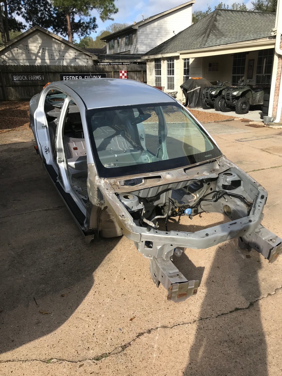

Moved the shell out today. Of course expansion joints and caster wheels on dolls really do not mix very well. Thank goodness Harbor Freight is just ten minutes away.
gonna have to get creative to get the shell up on a trailer. Cheapest thing may be a six pack for six neighbors to help out........

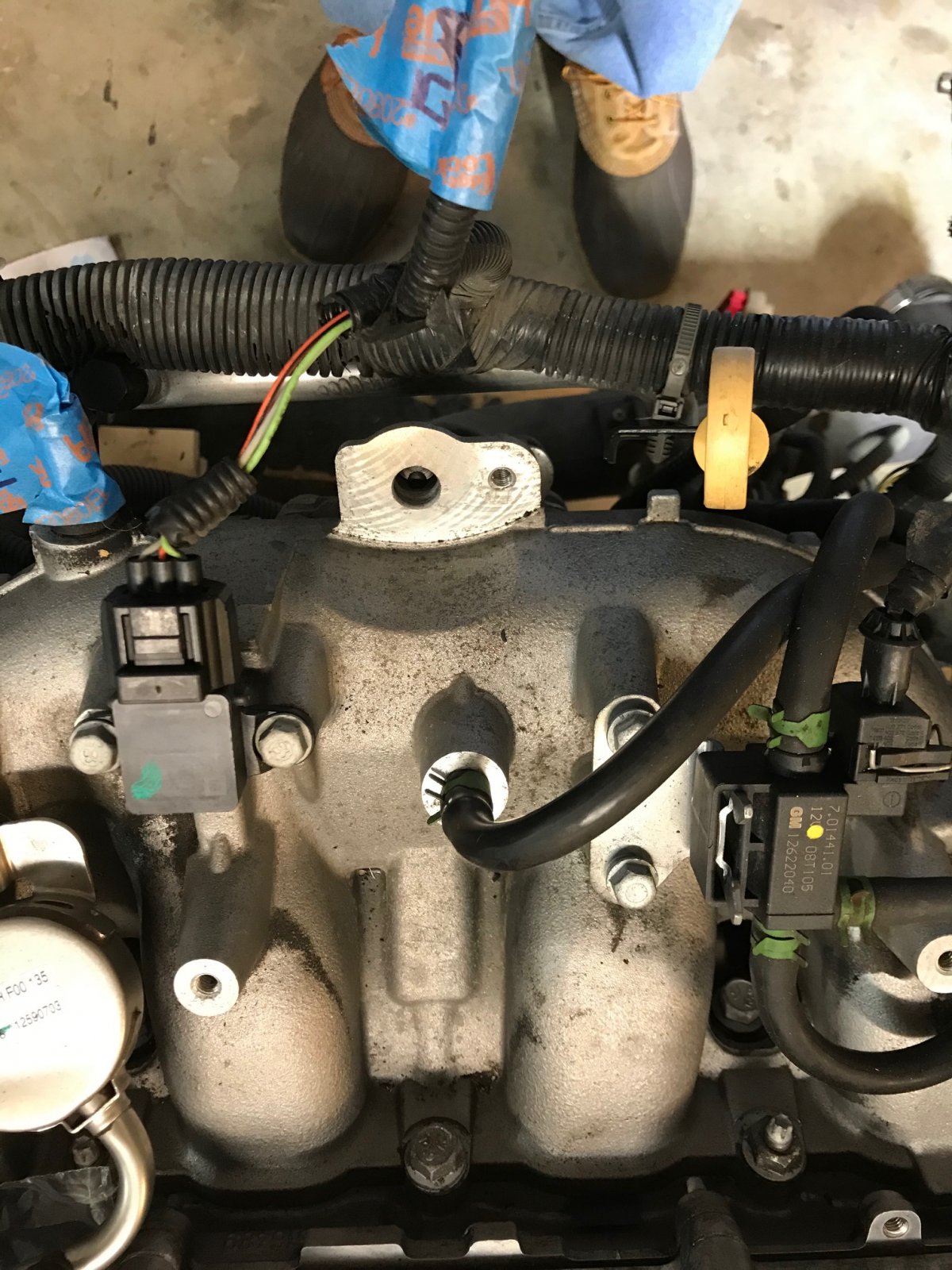

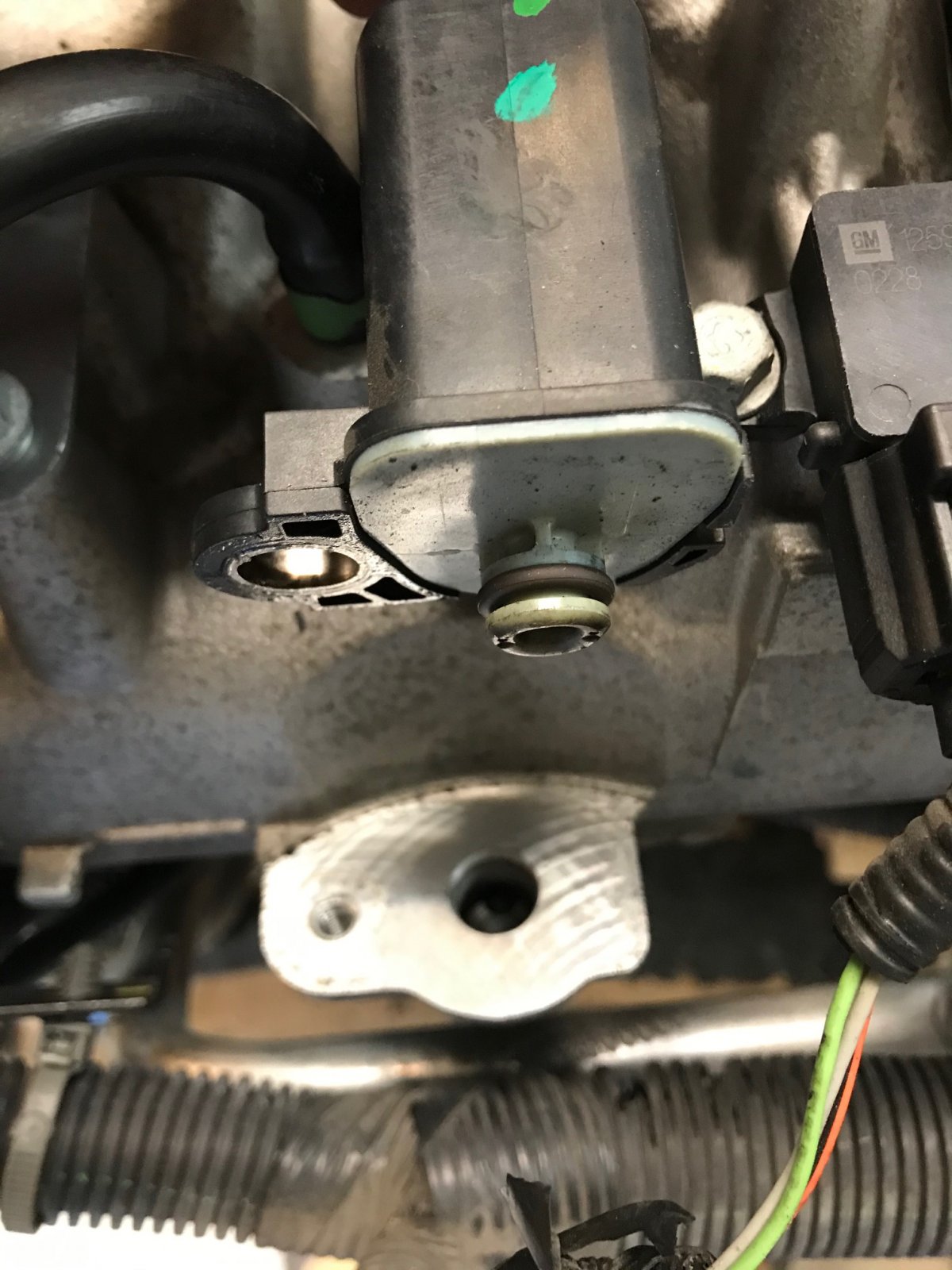

Evap module on intake port gets removed. What kind of plate did you bolt on to cover up the port? There is only one bolt holding it in place. I assume a small aluminum plate with some sealant?
