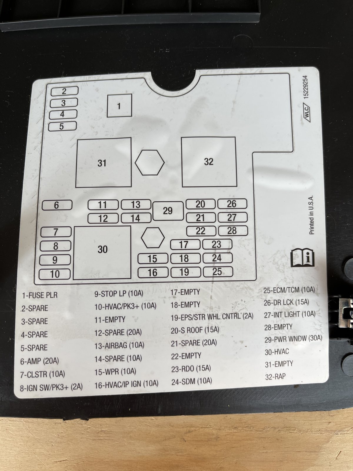

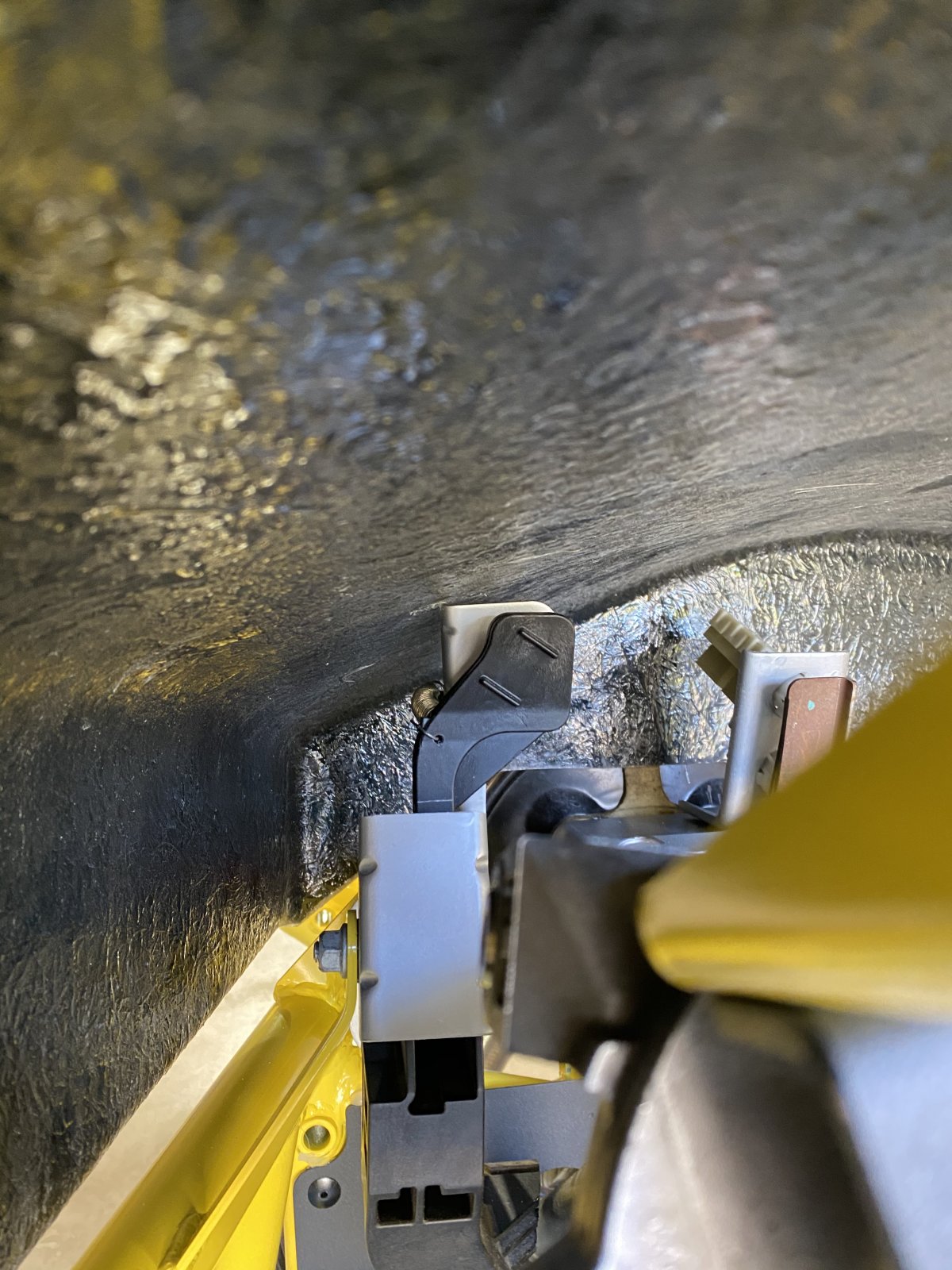

Here’s how I shaved mine down to clear the hood thingy.

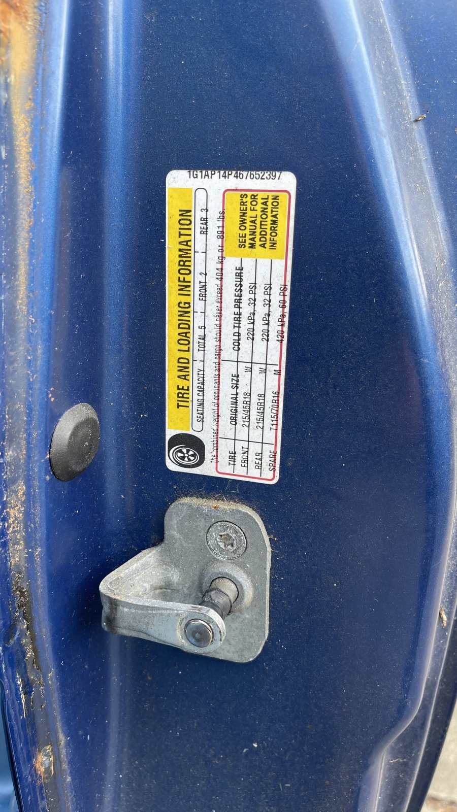

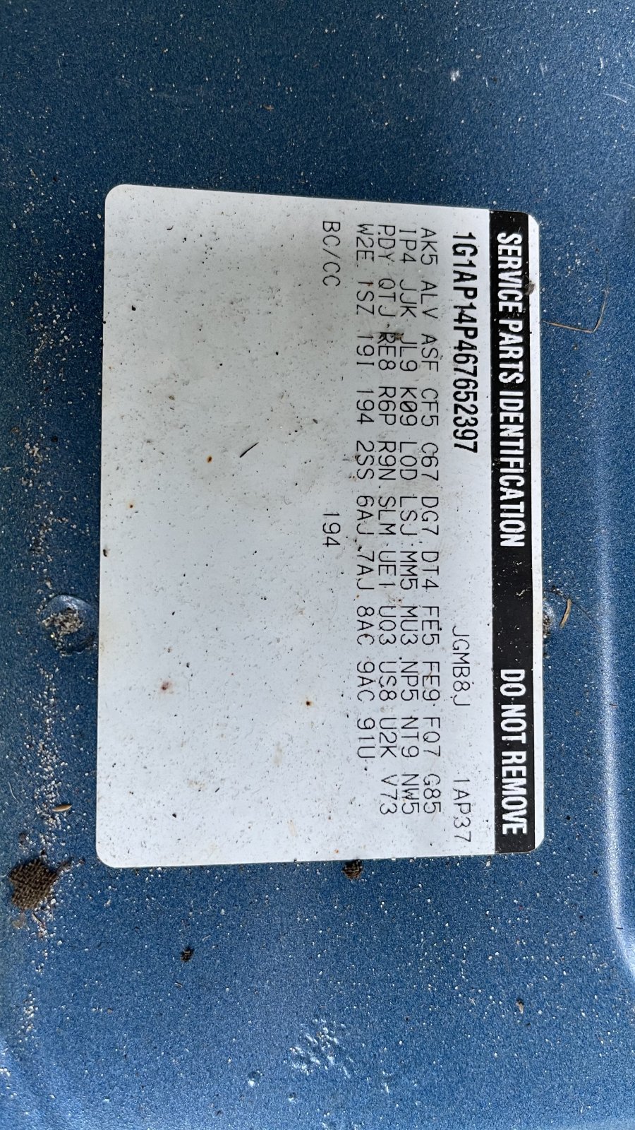

Be sure to take a pic or cut out the RPO plate in the trunk. This shows every option on the cobalt and can be handy when ordering parts.
Recaro seats means you have a LSD trans. Sweet.

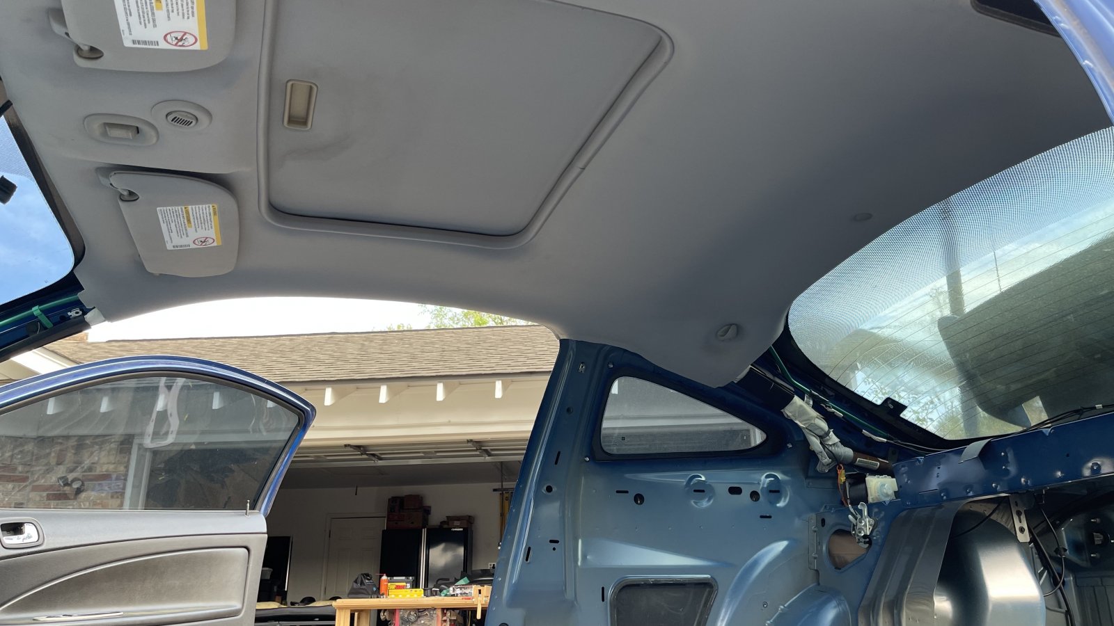

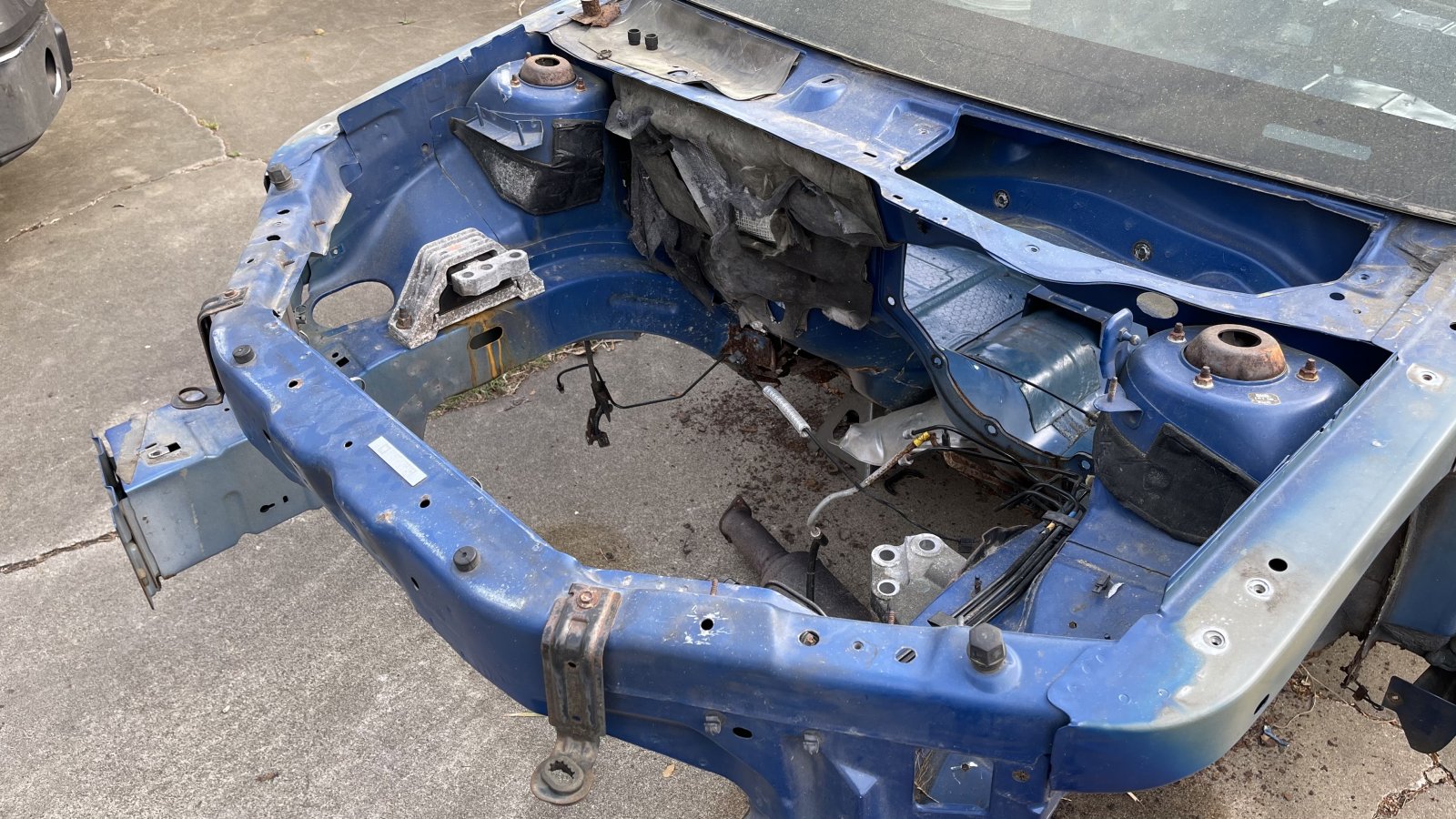

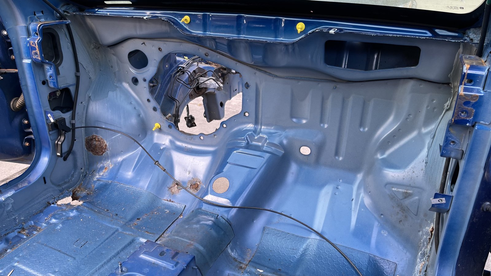

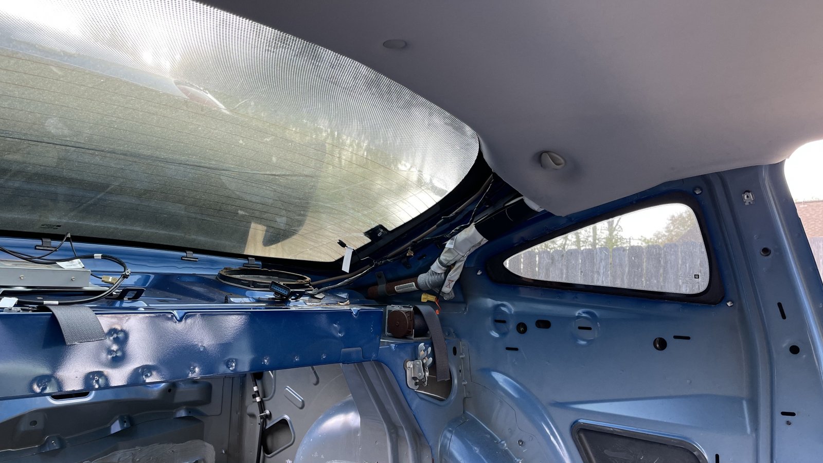

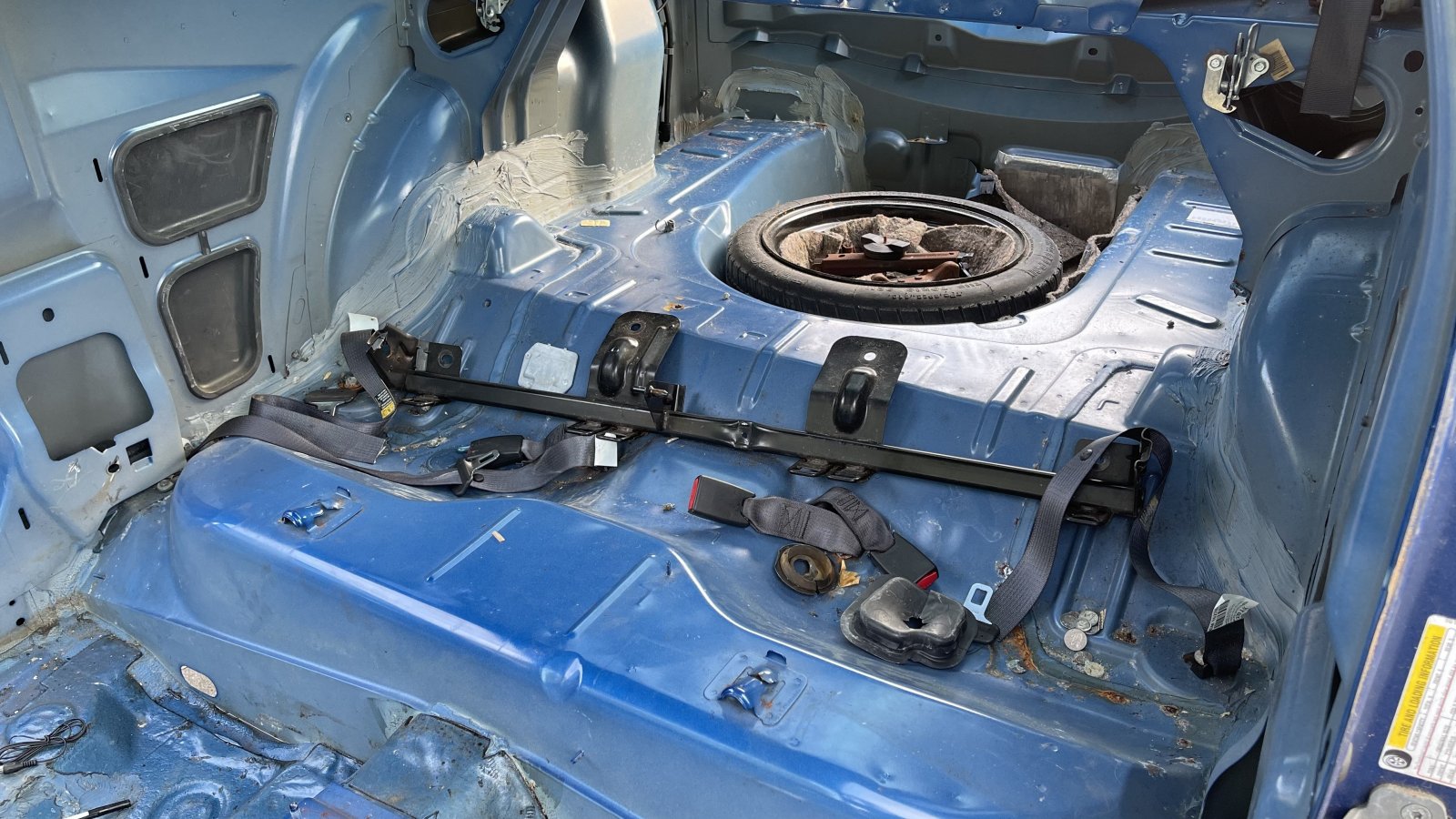

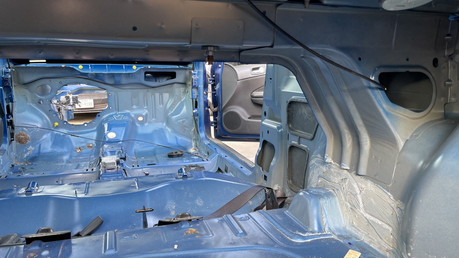

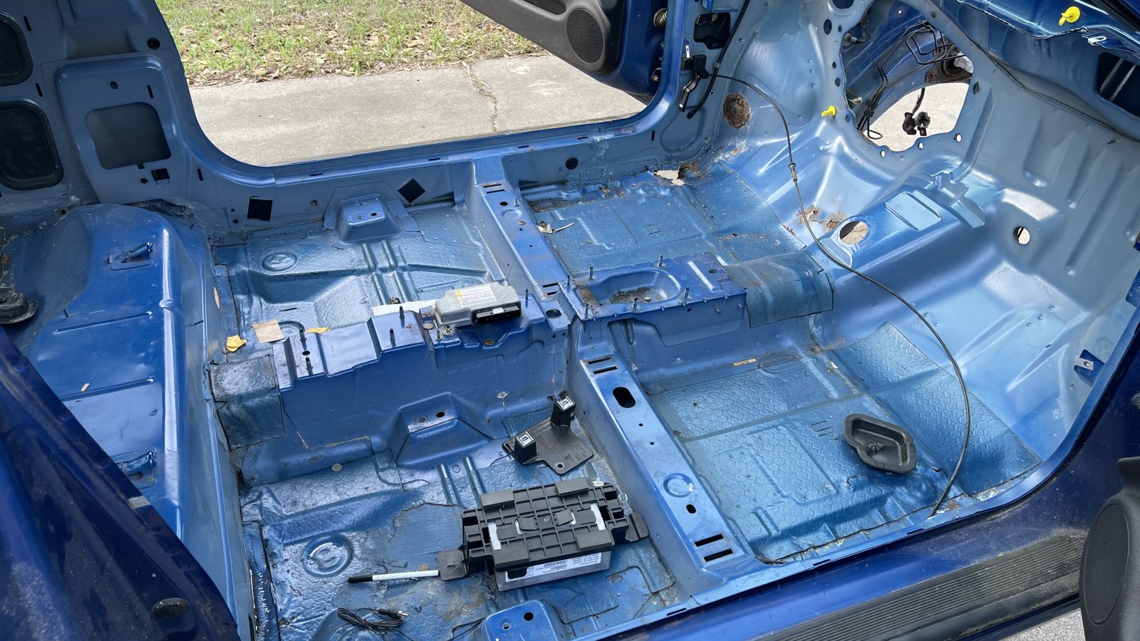

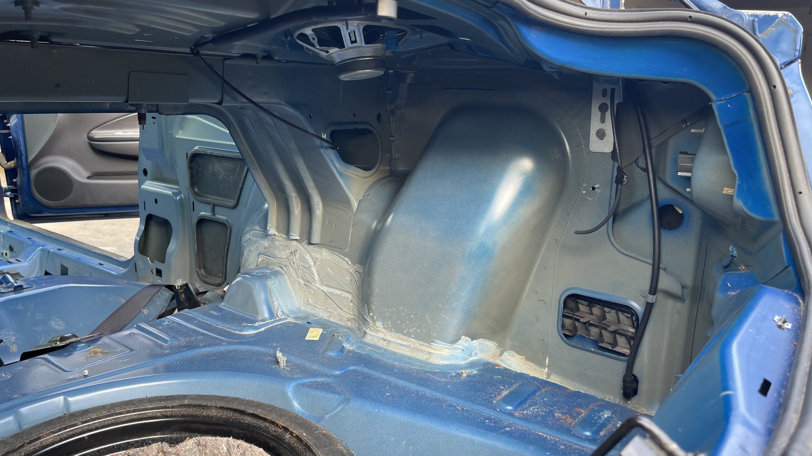

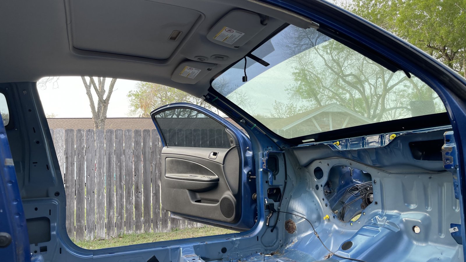

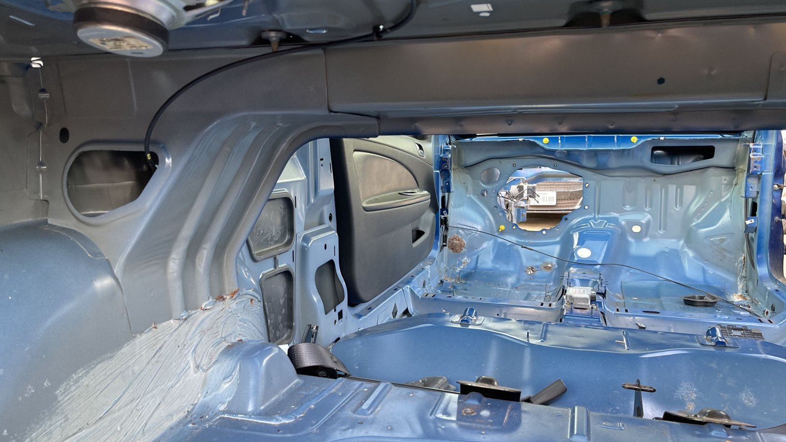

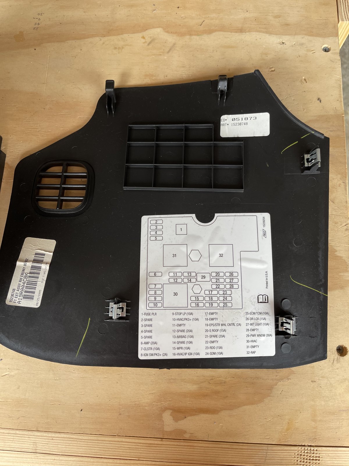

I pulled all the trim pieces out of the shell to take pictures of what's left to get a second opinion on if I need to keep anything else. So it looks like I'm not in an emissions county and don't need the evap parts, but I will be pulling the canister to save it just in case. I don't need anything from the headliner right? Here's the pictures of what's left. Here's what's left of the interior first.

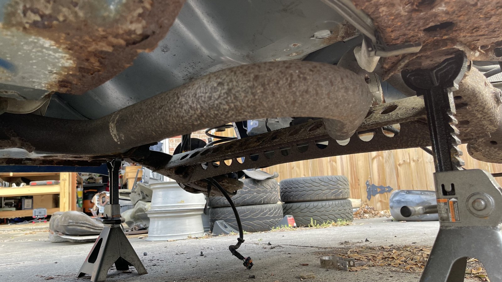

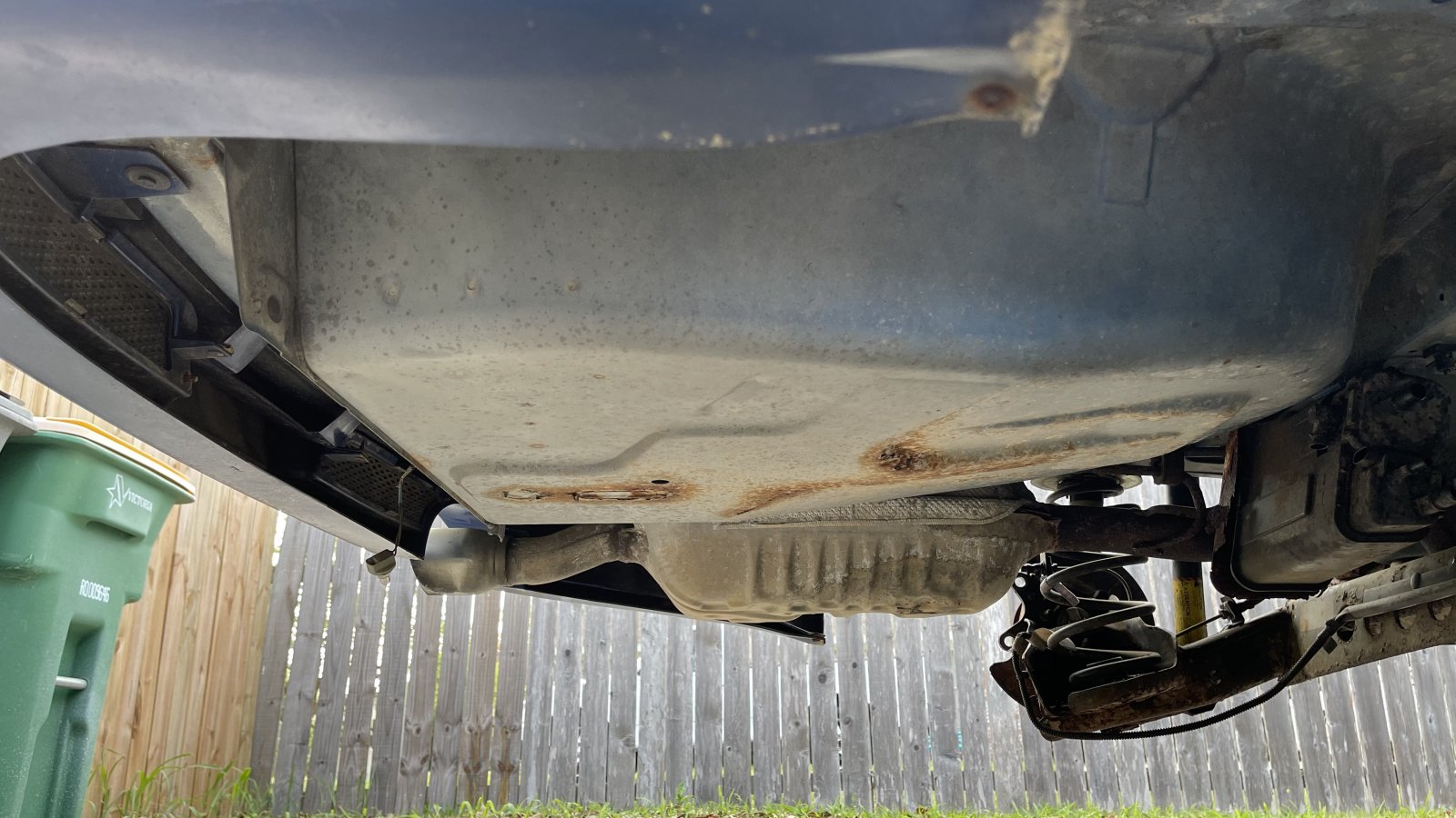

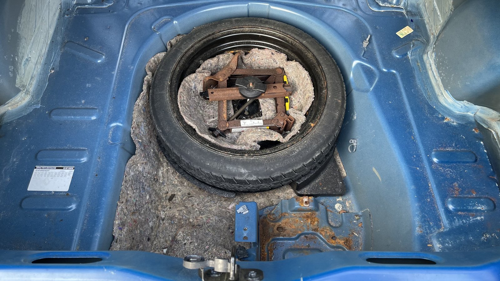

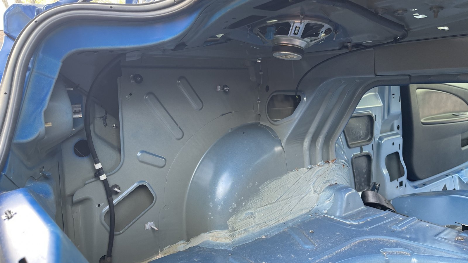

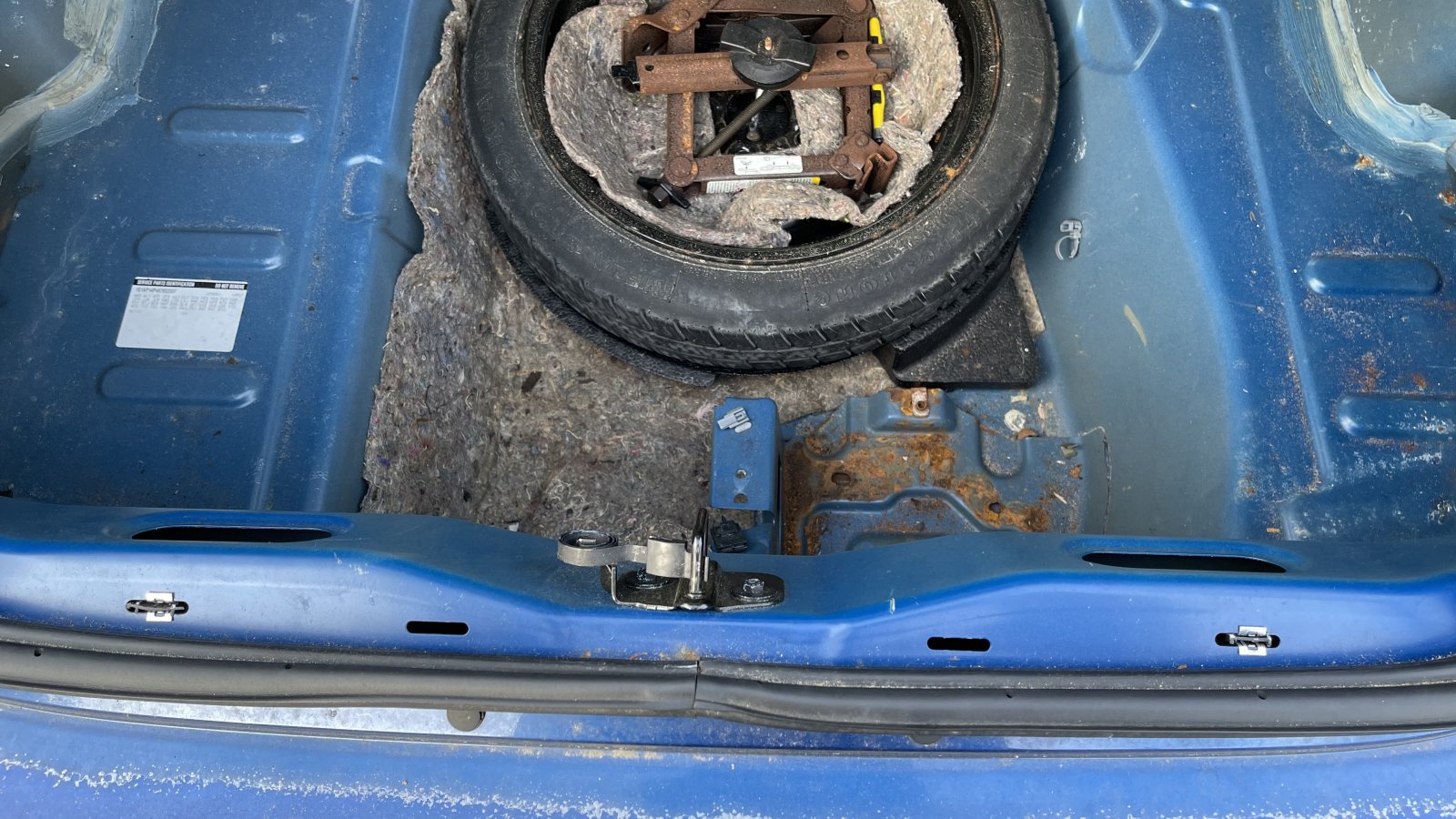

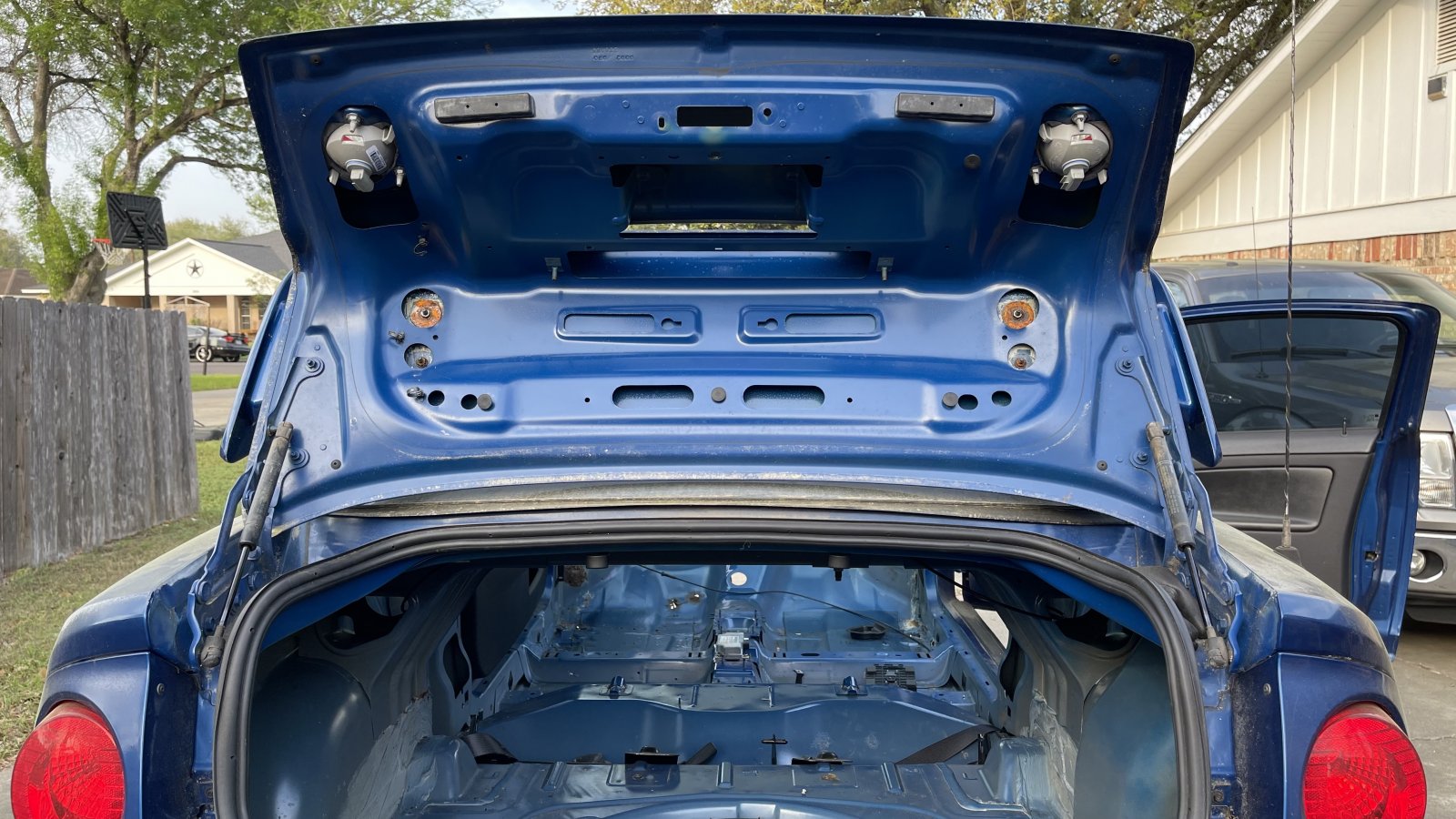

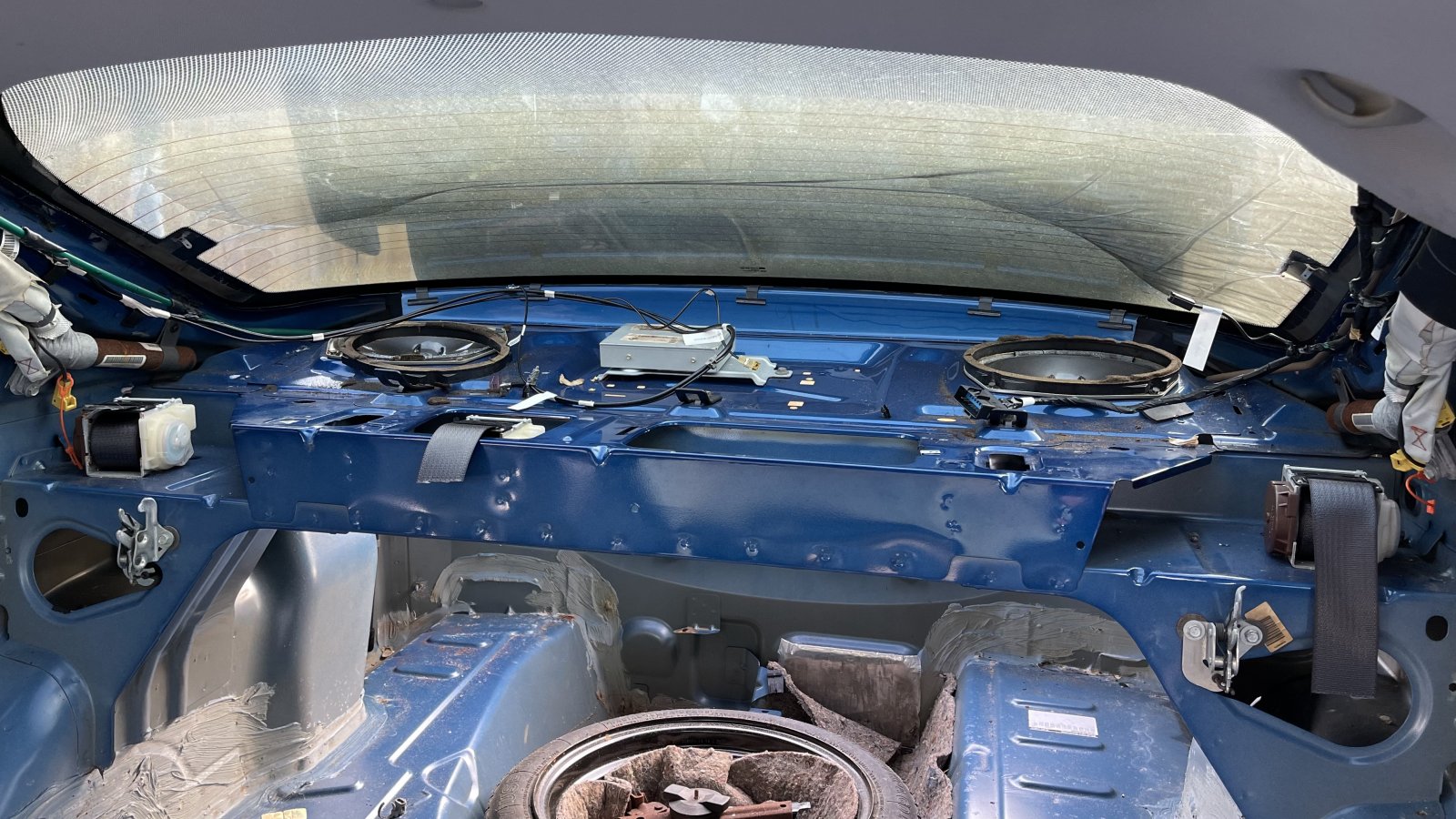

CodyP

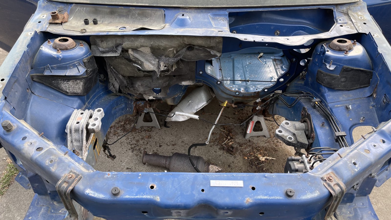

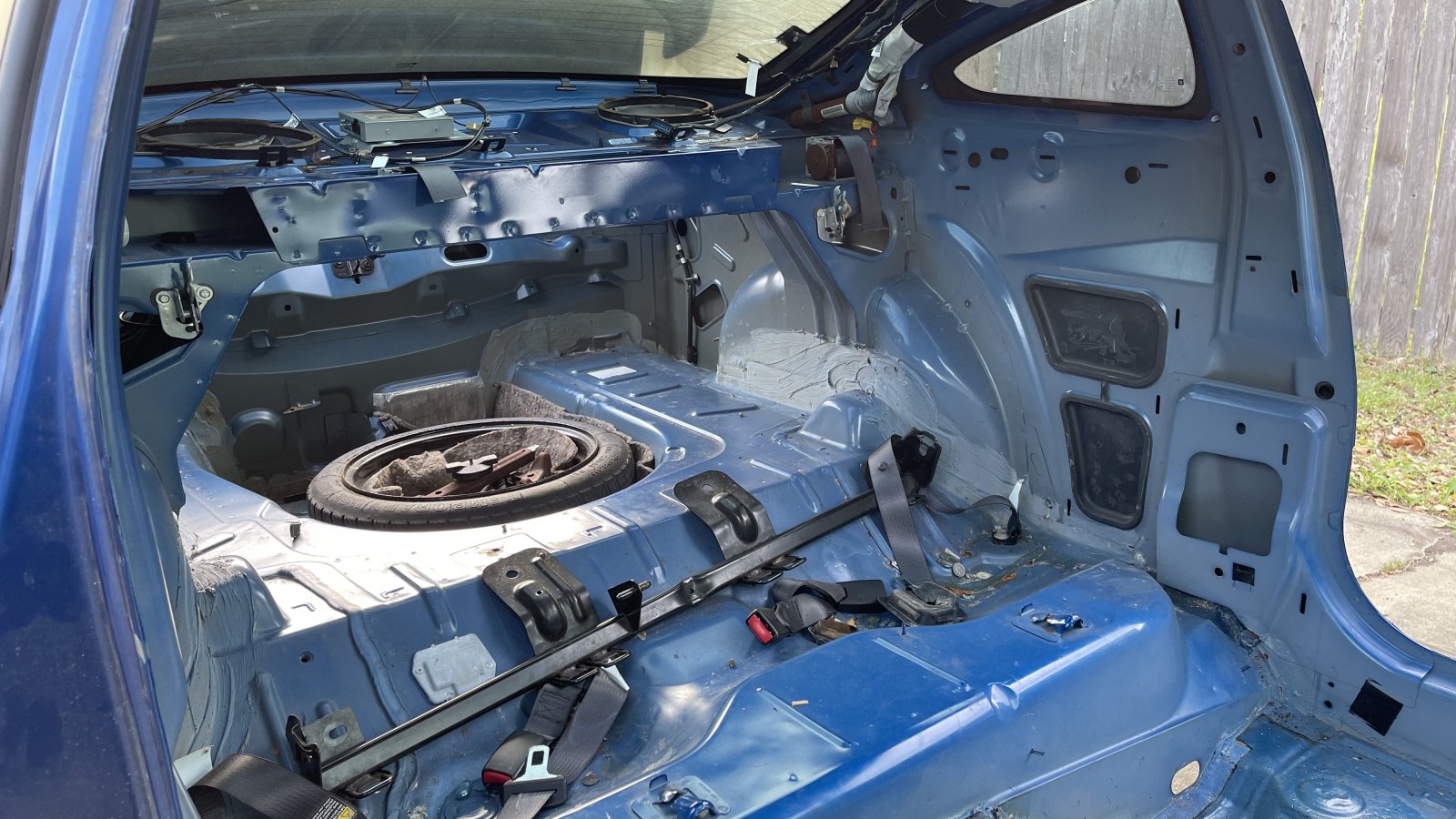

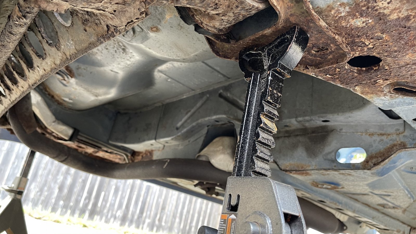

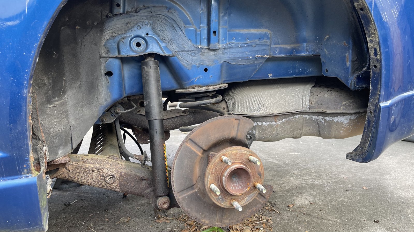

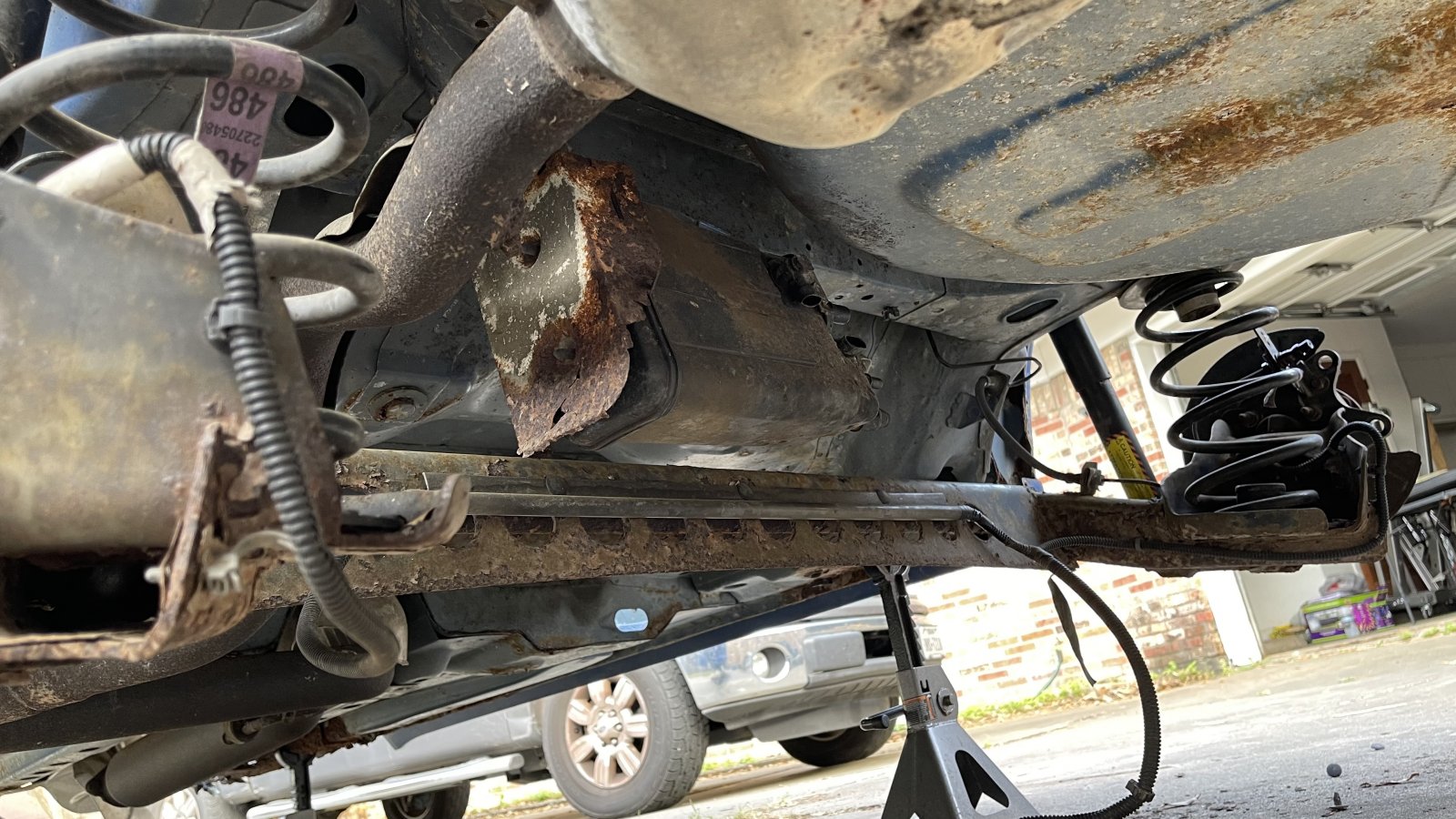

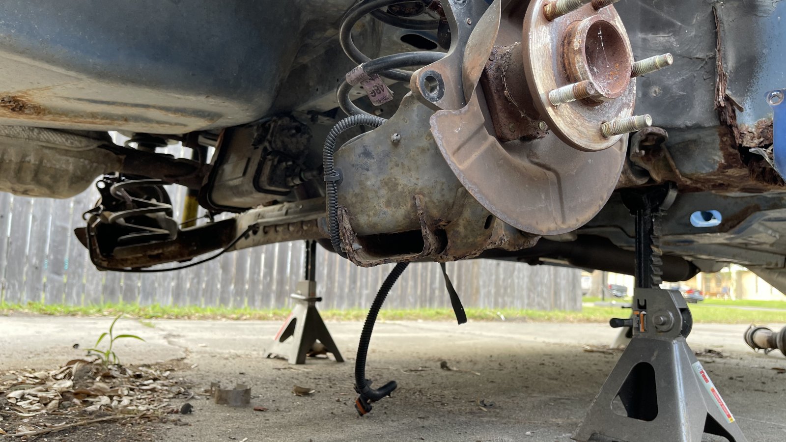

And here's what's left of the exterior. I don't need anything from three rear end, axle, suspension, or brake parts right?

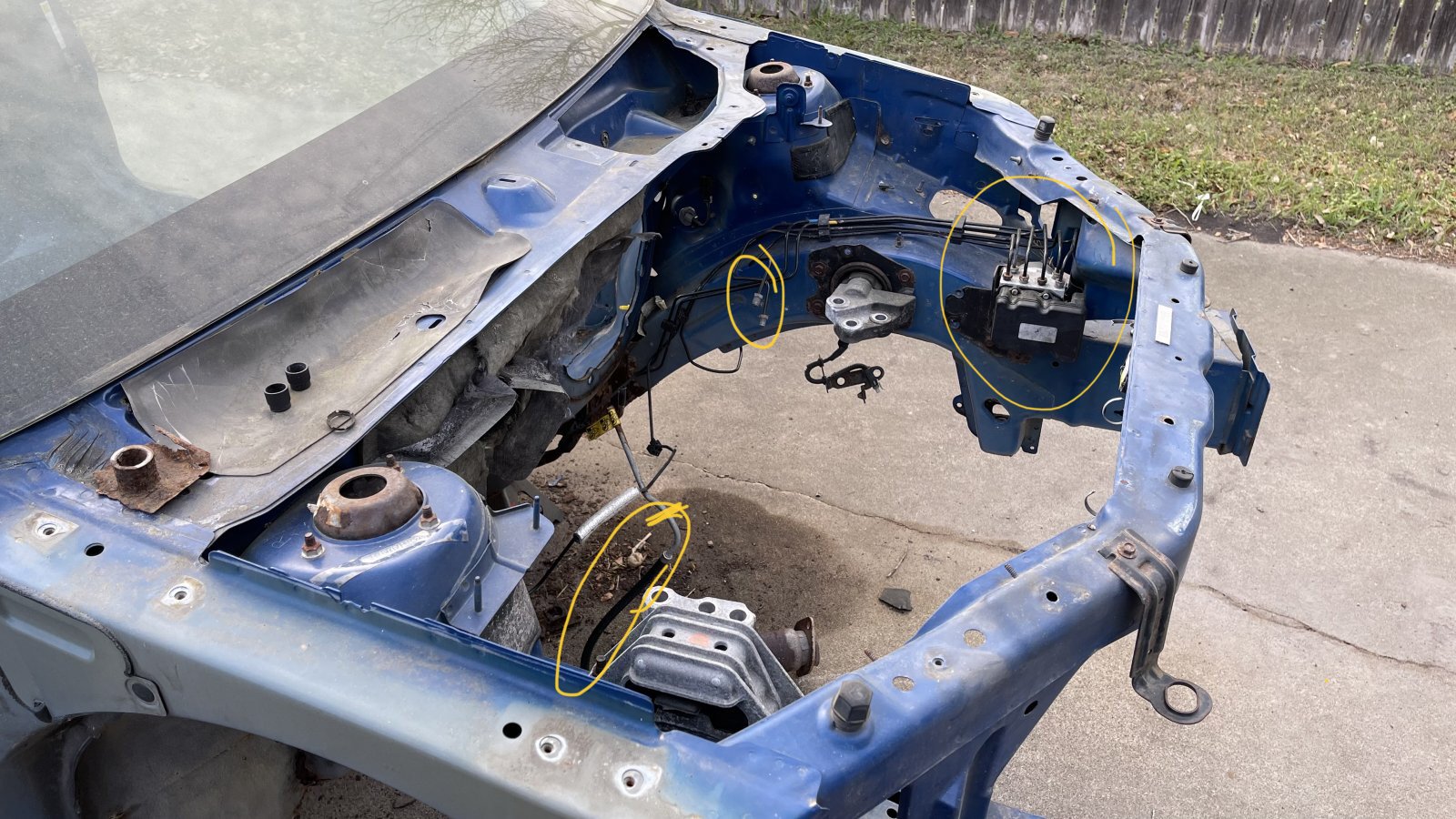

Adding this here for future reference in case I lose it.

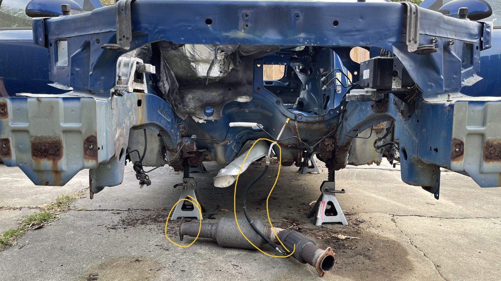

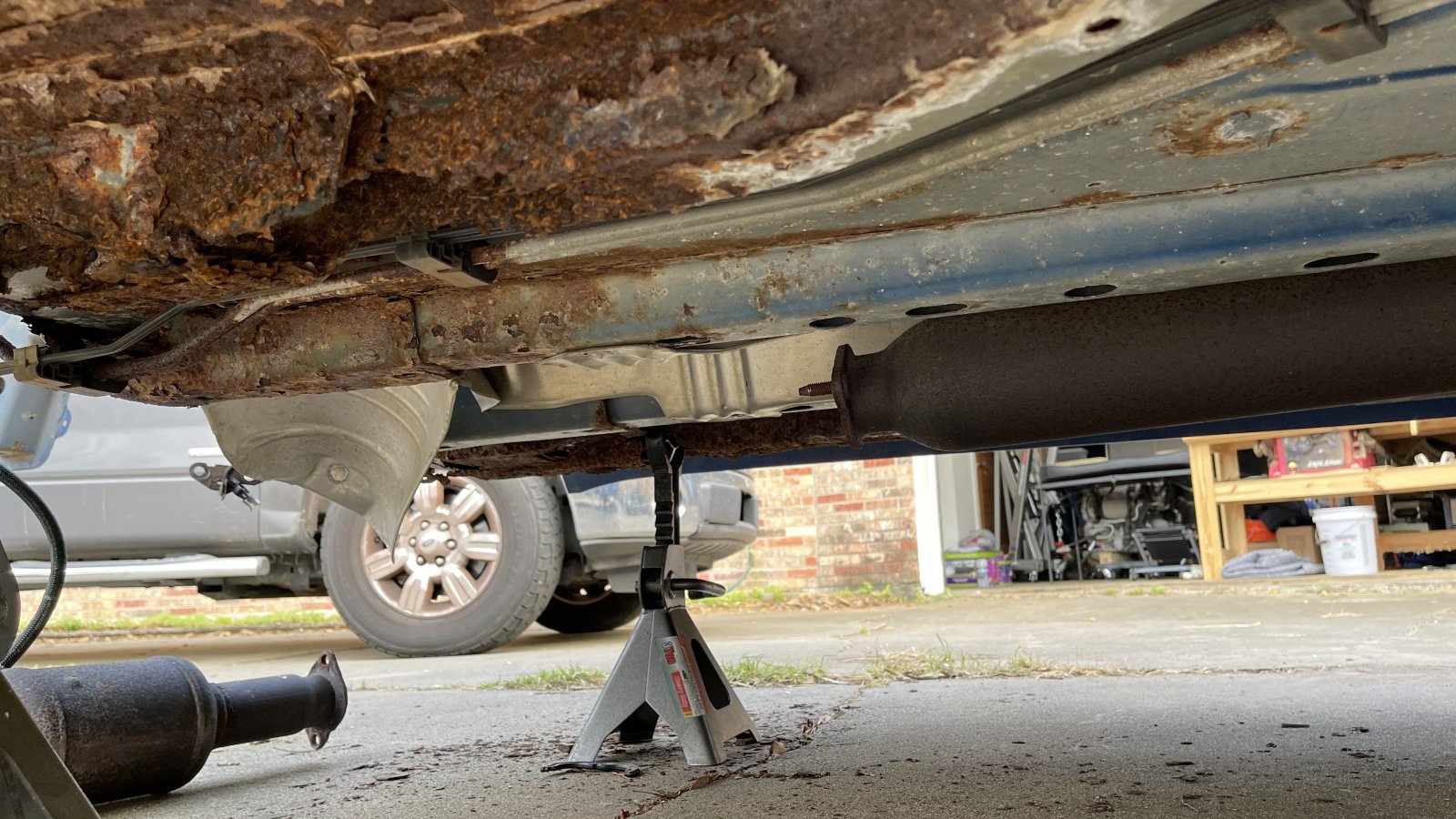

Brett
Looking through the pics and I think you are good. I kept the box above the rear axle. I wasn't sure if I will need it for emissions or not.
I see the rear hubs are still on. Fresh replacements are cheap so I wouldn't bother with them.
I would keep the flexible fuel line. the 45* bend works better on the engine than the supplied 90* fitting.
The abs module can be resold, but may take a while. Plus, either keep the brake lines going from the master to the abs module or gut the ends off at the master and keep the fittings. For a future project ;)
Of course, the cat is worth some money too, but cut the flange coming off the manifold in case you want to make your own exhaust. Then you will have a flange to build off of.

Oh. And take the nuts off the rear hubs that keep them attached to the rear axle. You’ll need those for your new hubs. And keep the brackets that hold the park brake cables secure to the body. Those can be reused too.

CodyP
I ordered the 5x114.3 hubs with my kit. Didn't think I'd need these.

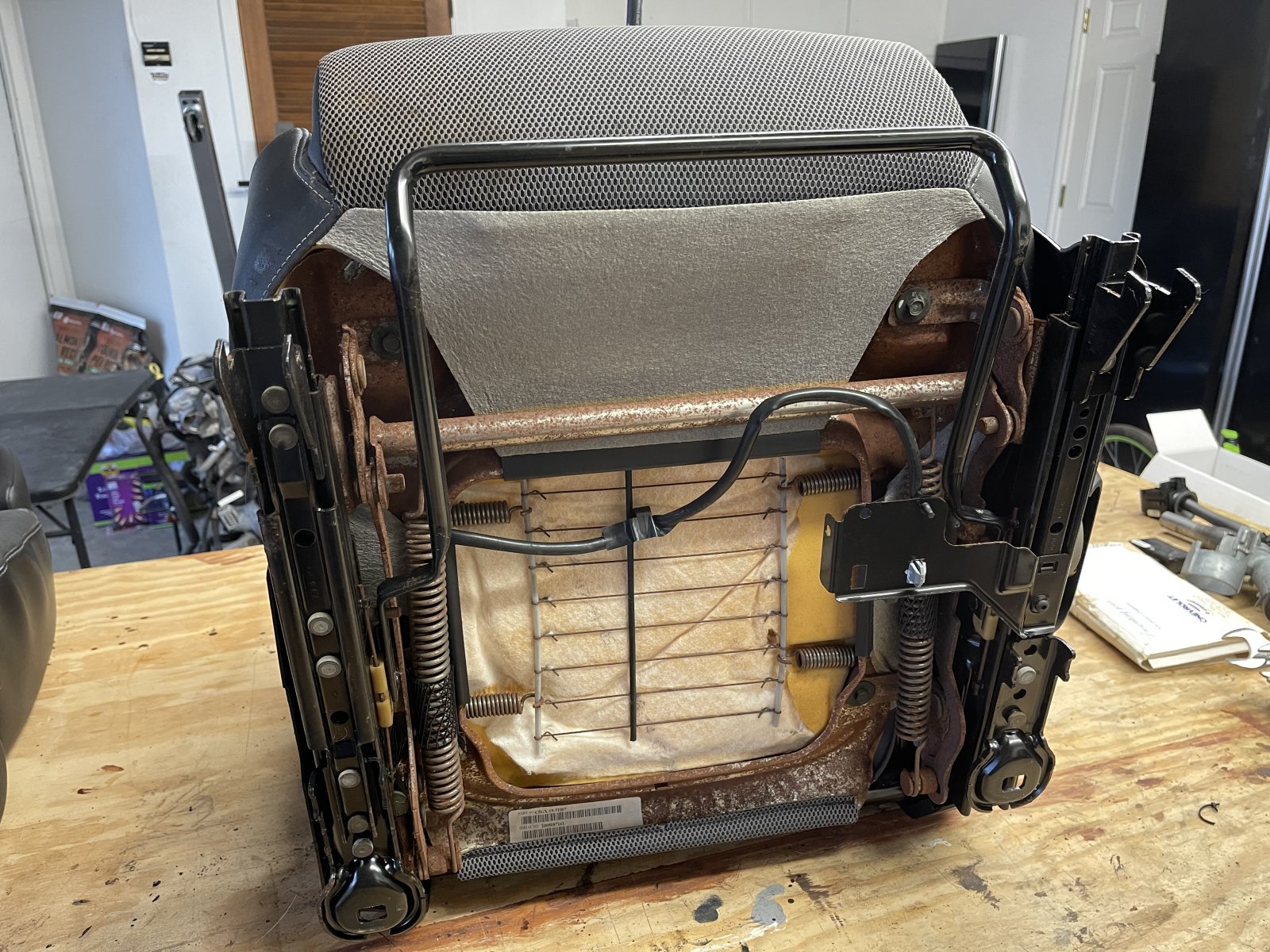

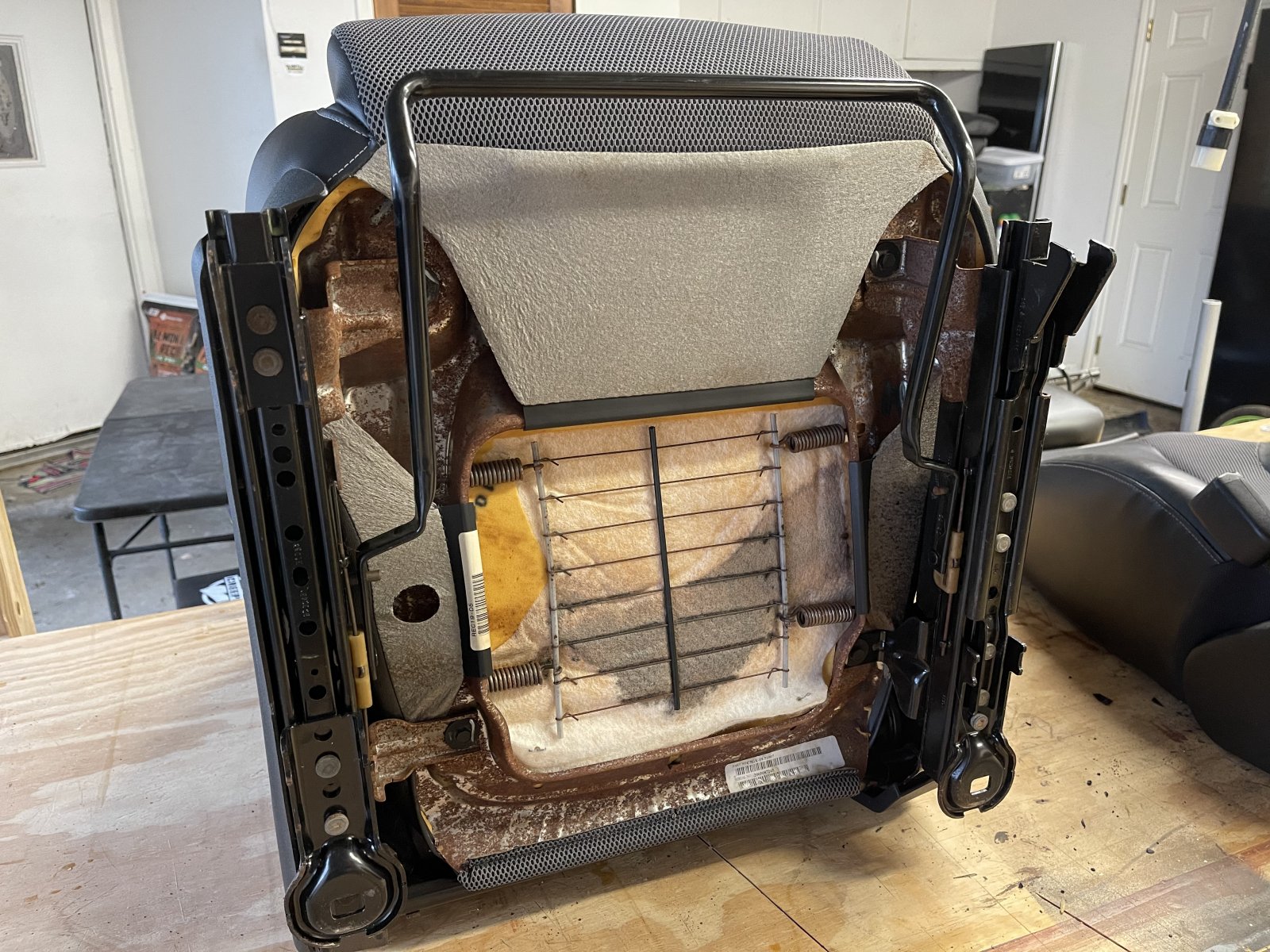

Someone mentioned saving a connector from the passenger seat for something? But I don't see a connector of any kind. There is however a connector that runs to the buckle on the driver side seat. Do I need to save that connector/cable? Also do I need to save the rails/sliding mechanism from the seats for my build if I plan on using braum racing seats? I will be selling the recaro seats to recoup some of the money from the donor, so keeping them around isn't an option. Here are pictures of the bottoms of both seats.
Not that I can think of. I think the seatbelt connection is tied together during the harness modification, so the seatbelt light stays off.
no on the rails or sliders either. The race seats should have their own mounting system.
Fozda
Powered seats have a nice big connector that can be used for the button panel but the Recaros are manual seats so we don't have one of those connectors.
