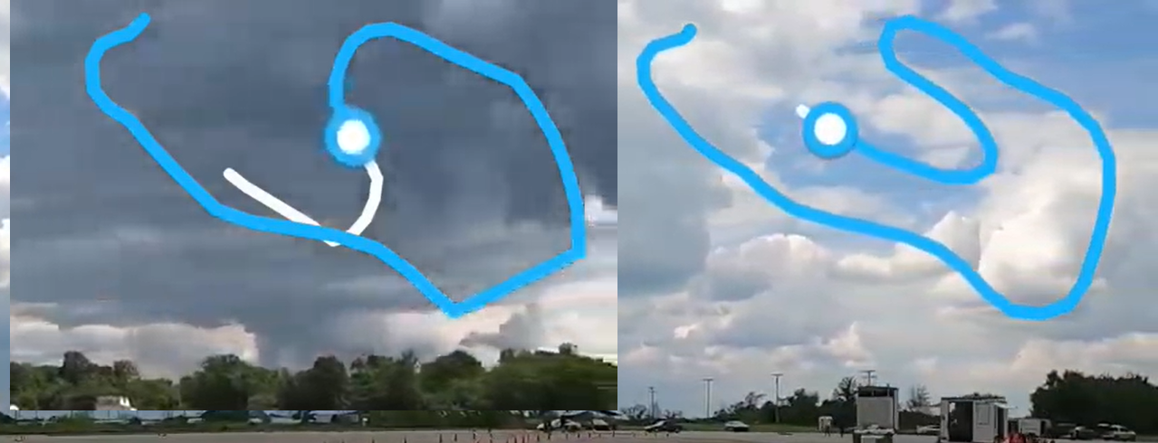

Heh. Part of the wonky overlays is my go-pro being dumb. Half the time it doesn't even capture GPS tracking even though it's mounted where it has clear access to the sky and I turn it on in plenty of time to acquire a signal.
That track definitely could have used more cones but I know it's a pain to set them all up and tear it down. Both of my DNFs were due to me missing gates. I also need to walk the course more. I did it a couple of times but there were other folks walking with me giving me pointers.

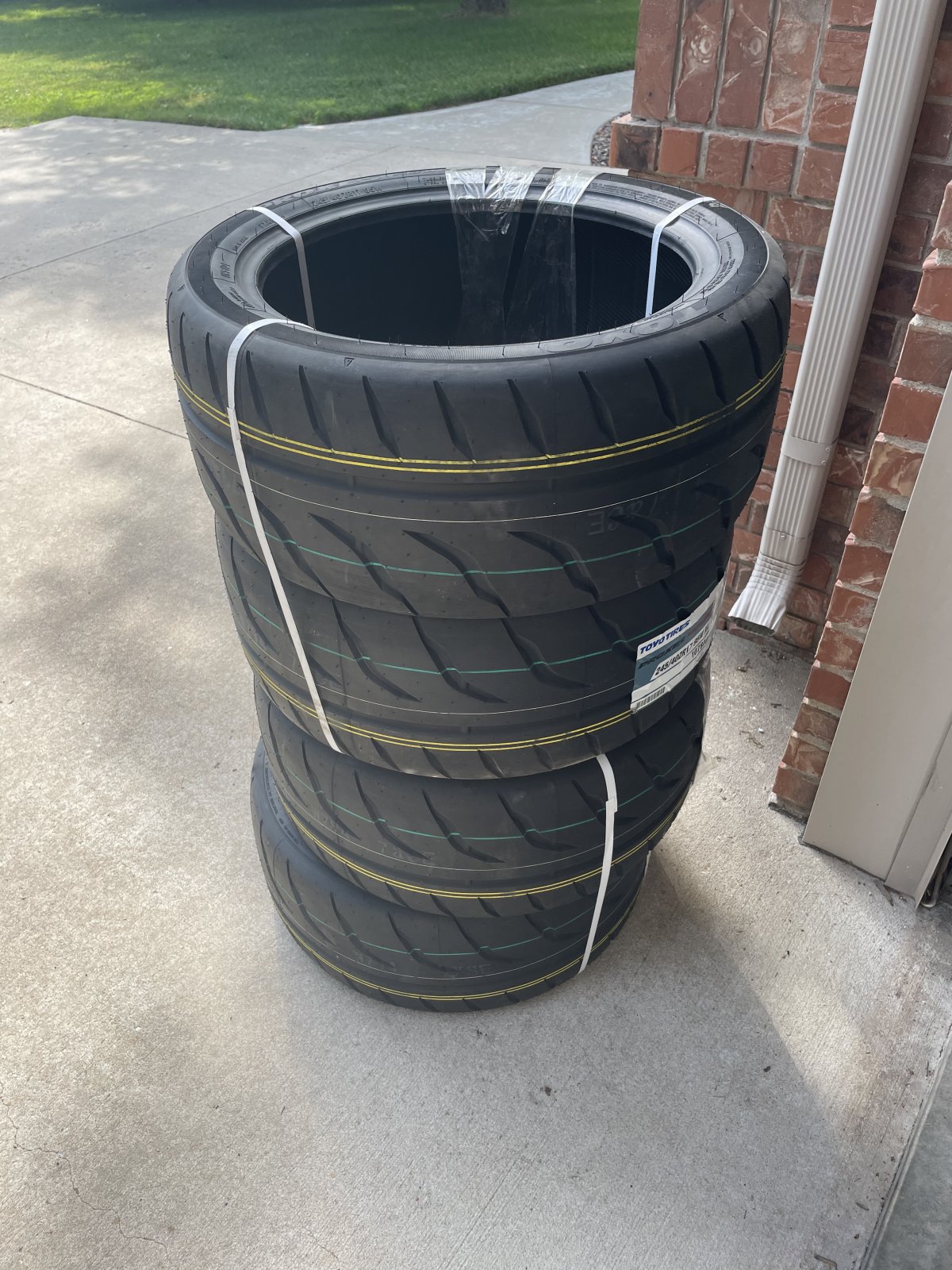

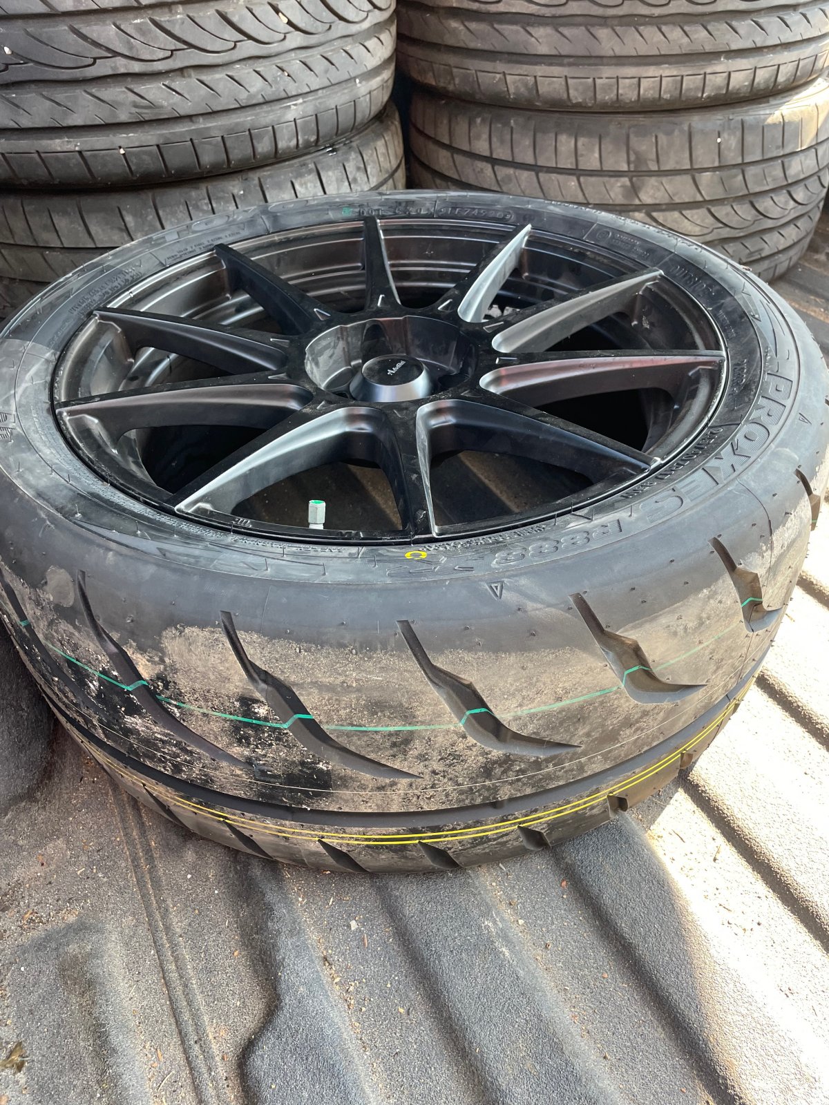

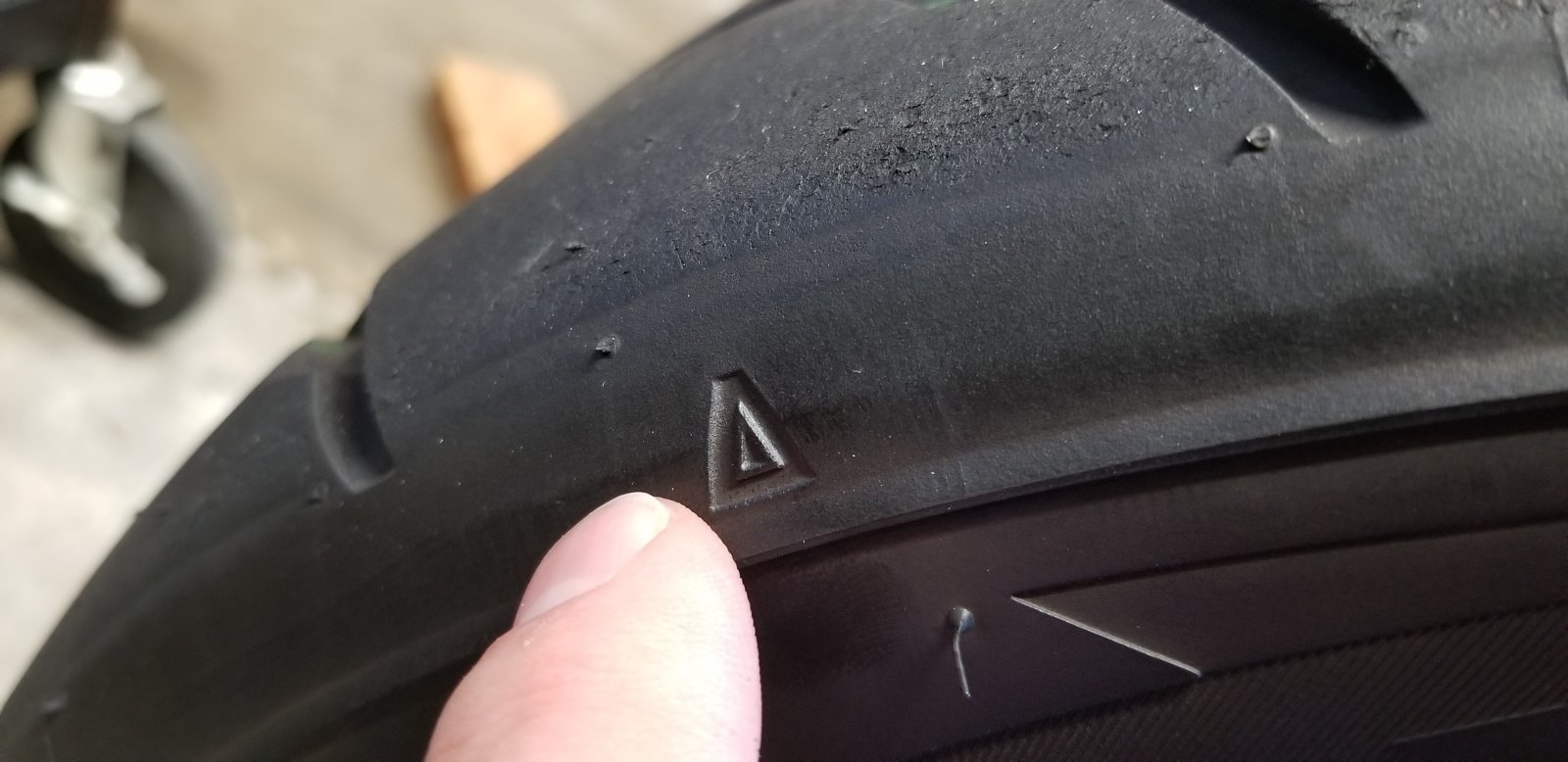

Got the new tires mounted and installed. One of the guys at the tire shop asked me what they went on. He got excited when I told him a Goblin. He'd seen them on youtube.
View attachment 24655View attachment 24653
They are definitely sticky :)

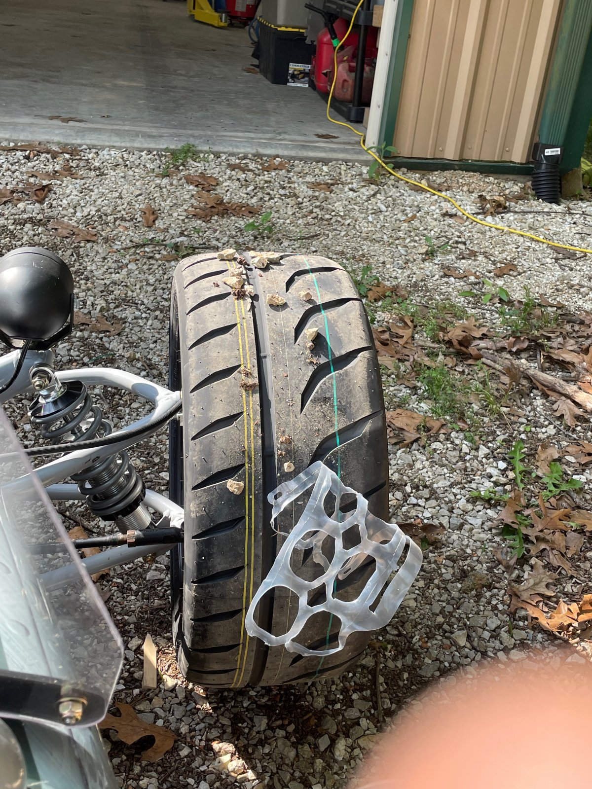

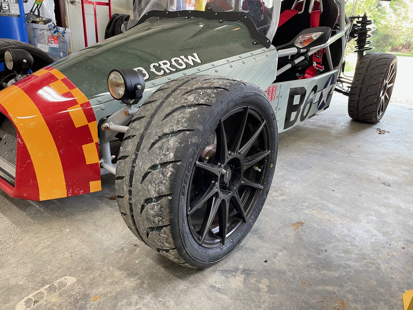

What camber are you running front and rear? I have the 15in version of your tire and I've experienced that -1.8 front and -1.5 rear camber has been too aggressive.
When you go autocross, tire crayon or shoe polish dab a spot on the outside shoulder of each tire before a run in this area of the tire.
It can help identify if camber and tire pressures are close to optimal.
Curious to see how your tires work out for you.

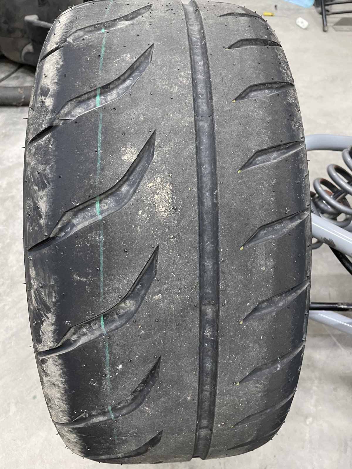

I had the Sumitomo's at about 1.2°. I originally had them at 1.5 but it was too much. The outside tread never touched the ground.
I need to read up a little more on tire pressures. I see some folks running lower pressures, and some running higher. I have a small air compressor in my trailer so my plan right now is to make a couple runs, then adjust one way and see how it does. I know there's some basic physics that I can learn from reading but until I actually try it, I won't really know what it's going to do.

Speaking of changes, I'm probably going to pull some more camber out. I'm running around 1.2° right now and I think I'm going to back down to probably .5°. There's still a portion of the outside of the front tire that isn't making contact with the ground. I'm also going to start tracking before/after numbers for tire temps and pressures along with the run times.

1.2 deg camber may be good for a narrow OEM tire, but if you put wider tires on, 0.5-0.7 works well.
