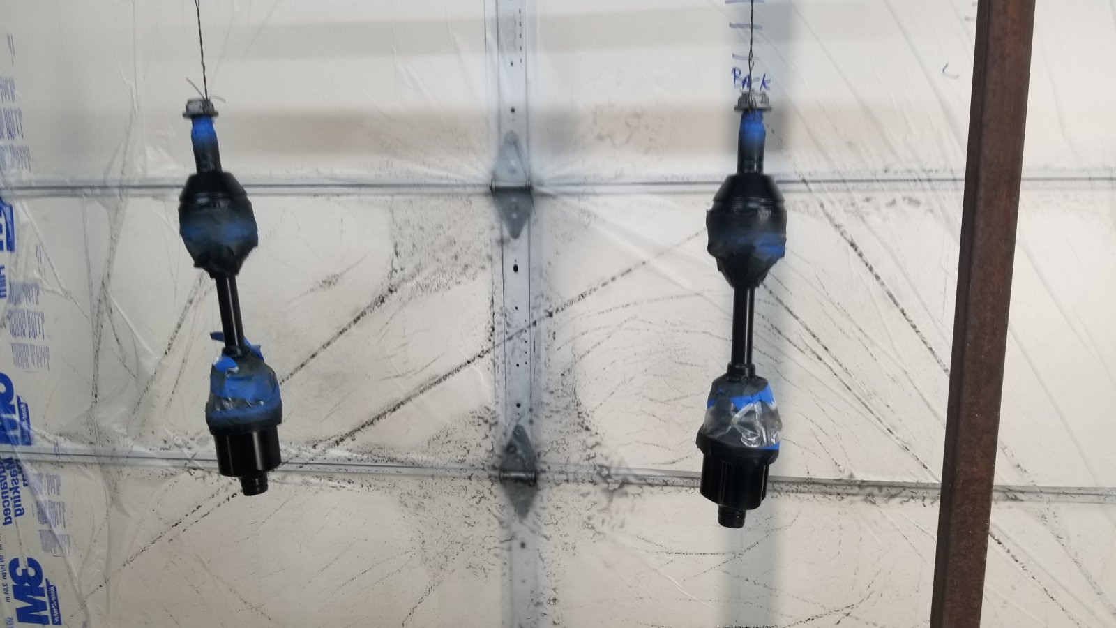

I cleaned up and painted the CV axles. Used VHT wheel paint. Nothing fancy, just a little cleaner.

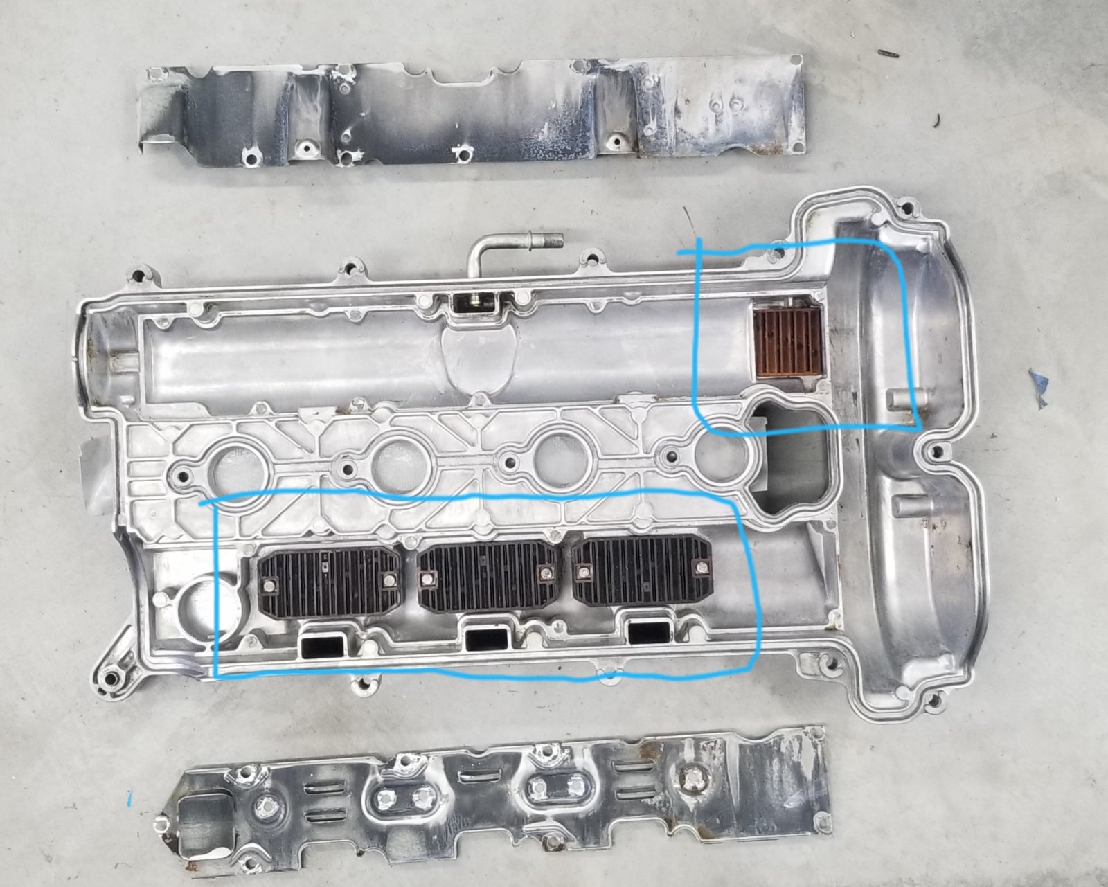

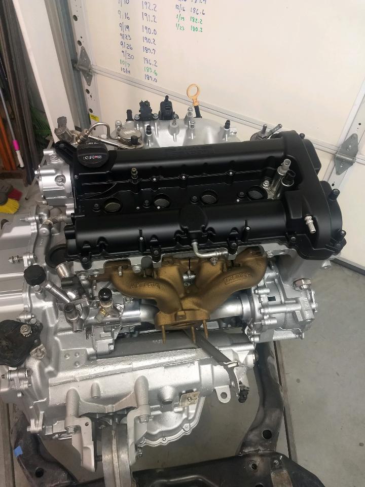

Decided to try and powder coat the valve cover. There is a company that will do it for $80. I'm not sure if they pull out the plastic "catch can", but if they do, $80 is a screaming price. If they don't, I'm sure the 400 degrees for 10 minutes will remove the plastic and force the external catch can issue. Only downside is they either do gloss black or red. I did mine in Prismatic Black Jack. Its not perfect, but good enough for me.

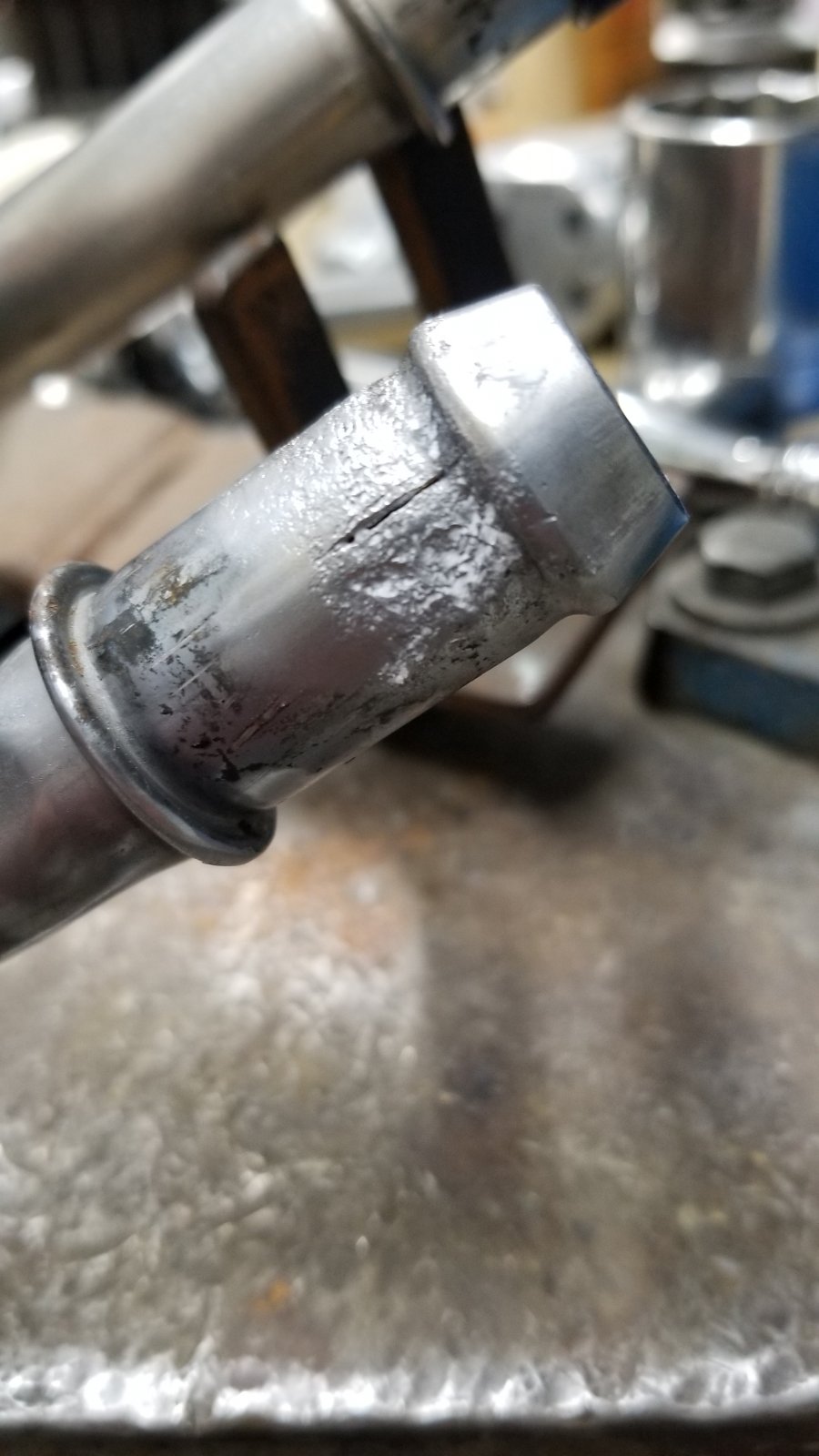

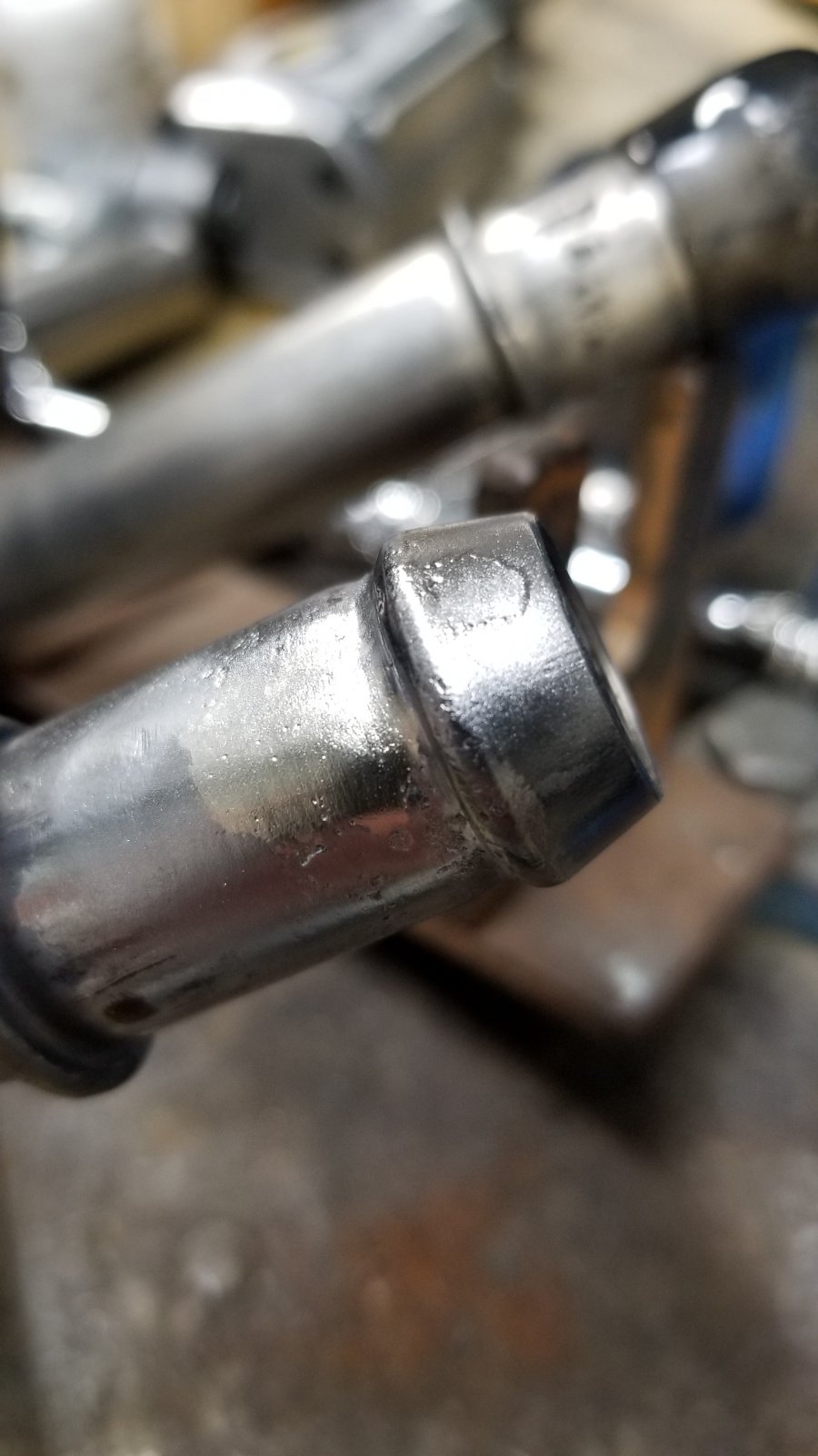

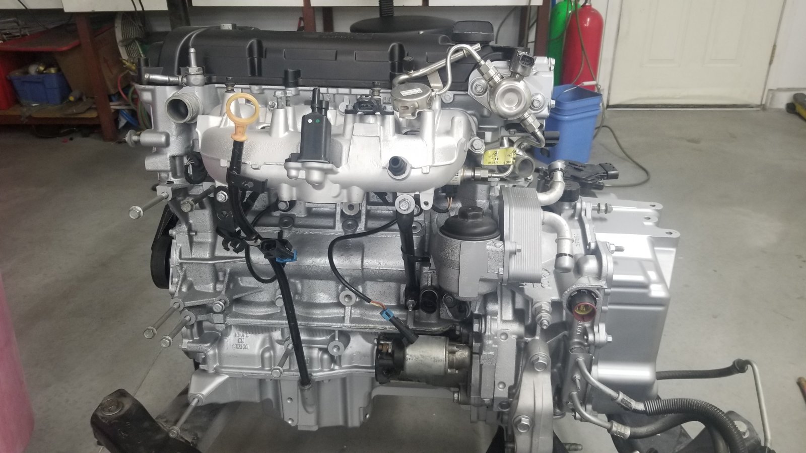

The heater line port in the thermostat housing had about 1/4" of corrosion. After I got it cleaned, I noticed a crack that I'm fairly sure was the culprit. Cleaned it up and hit it with some silver solder. Again, not a perfect job, but I think it will hold.

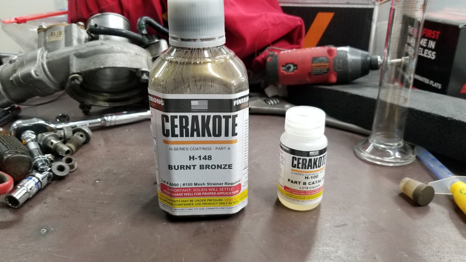

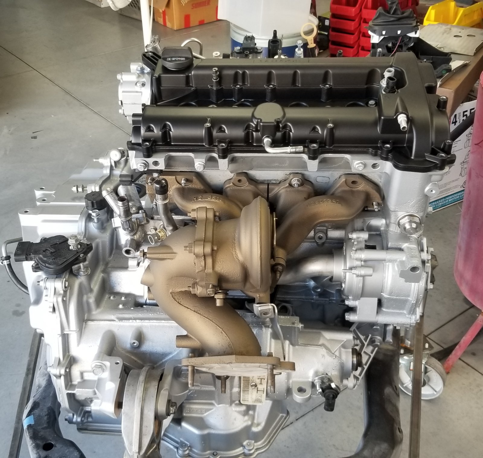

After cleaning everything else up, the old rusty exhaust looked bad, so thought I'd try my hand at Cerakote. I'm not sure how durable it will be, but it was fairly simple to apply. Granted, I had to pull the glass bead from the cabinet and put in aluminum oxide to get the right blast profile, 1 hr at 300 degrees gas off time, coat, and another 1 hr at 300 cure. Total time, 3 hours. At this pace, Kenny will be done with college and have 2 kids before I finish the car.

DCMoney
Cerakote has an extreme high temp offering that many of my suppressors are coated in and are holding up extremely well. I was planning on buying some to try on my exhaust since the high temp spray paints haven't been holding up on my exhaust.
