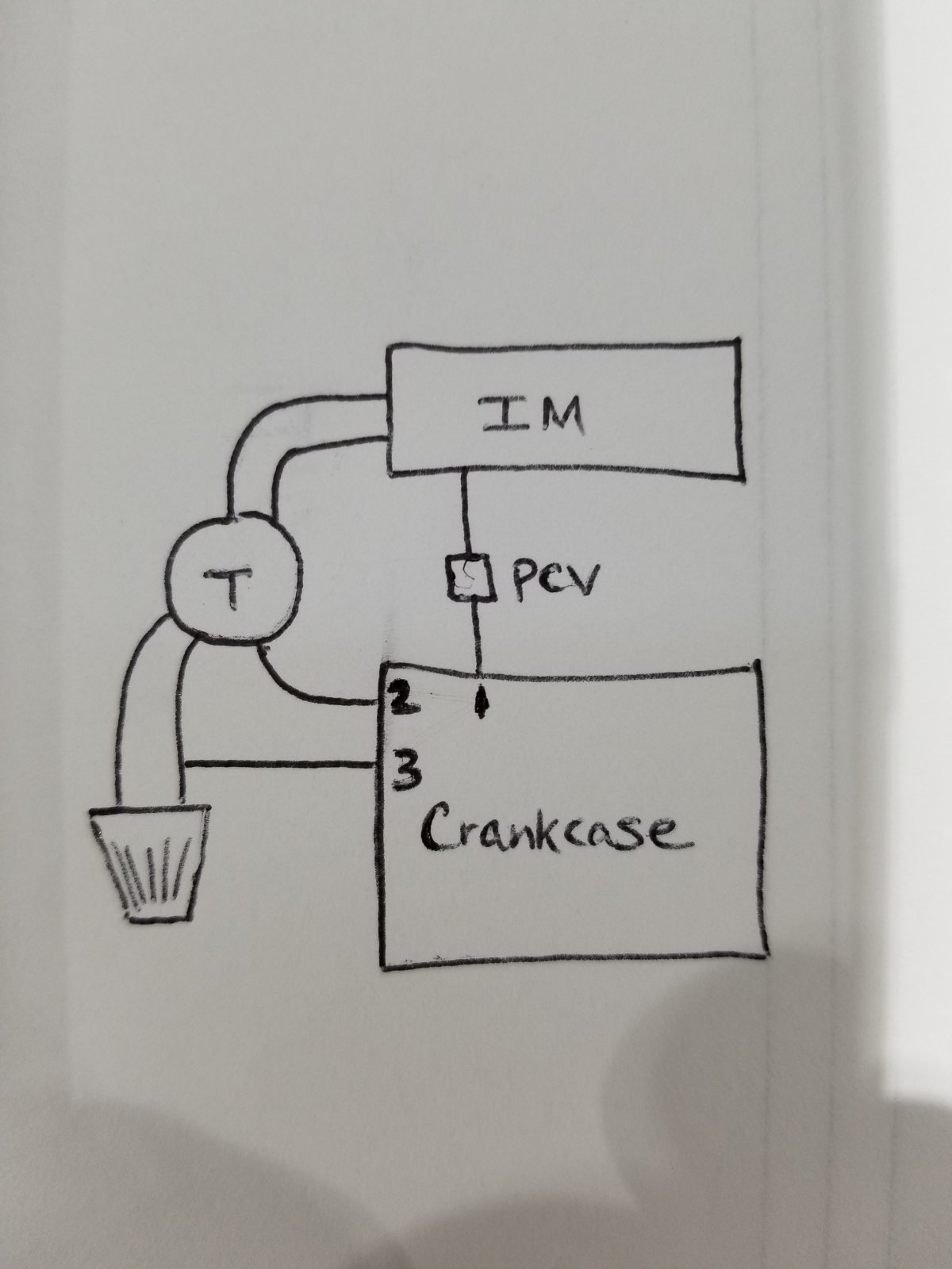

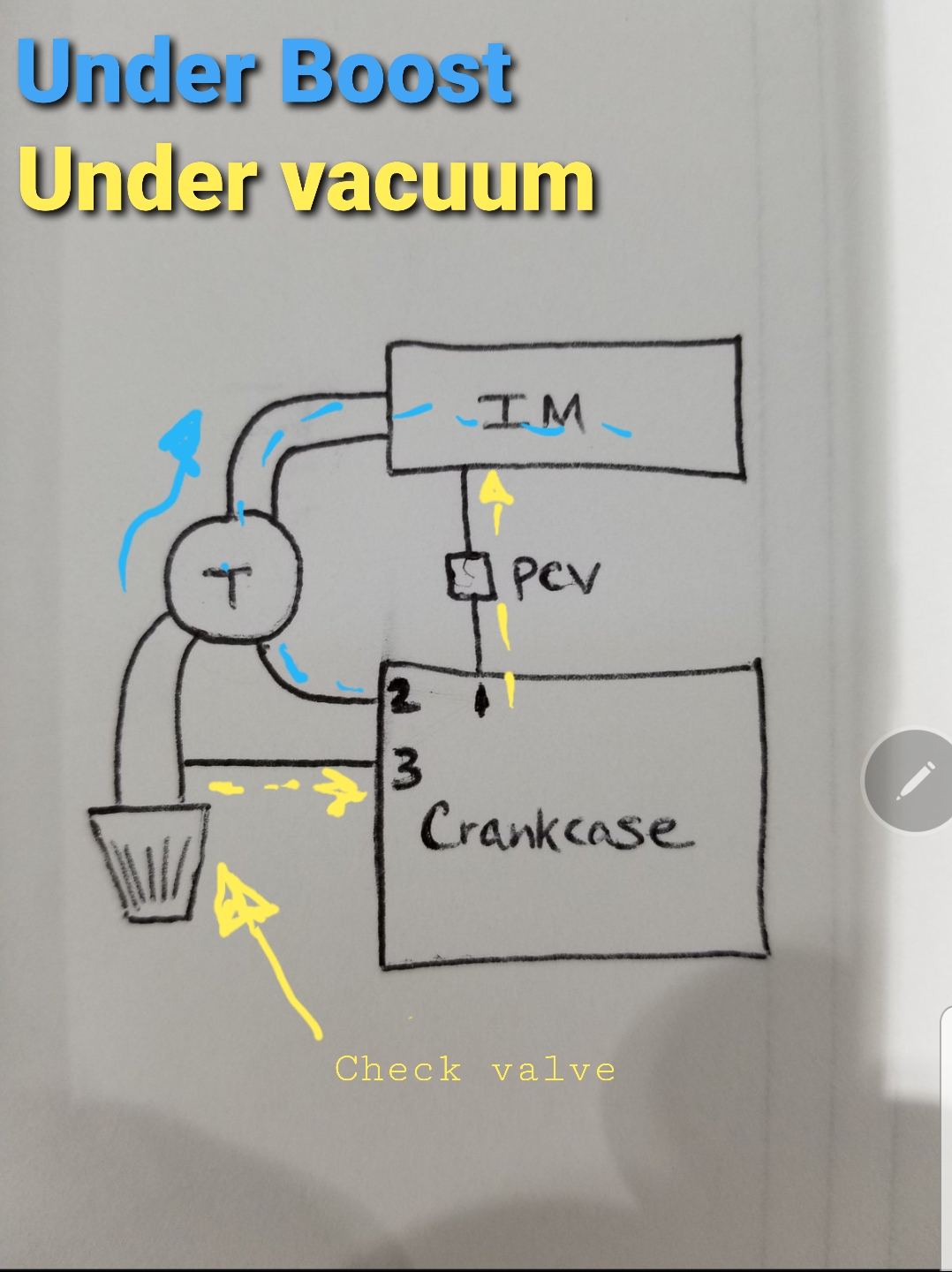

Here's a really crude drawing to help illustrate the basic system from a high level. This pretty much matches the factory LNF setup from what I can tell. Only difference is that the way I have it drawn it makes the PCV look as though it's external (it's internally located in the intake manifold (IM)). If the port labelled 1 (PCV port) is blocked off, you still have ports 2 and 3 to work with. These can both run to one catch can if the can has 2 IN ports or even if you simply T them together, and you would not have a check valve or anything in either line. I may need to revisit Optimize Primes thread on this, I think I mistook an inline filter for a check valve when this was being discussed on his thread.

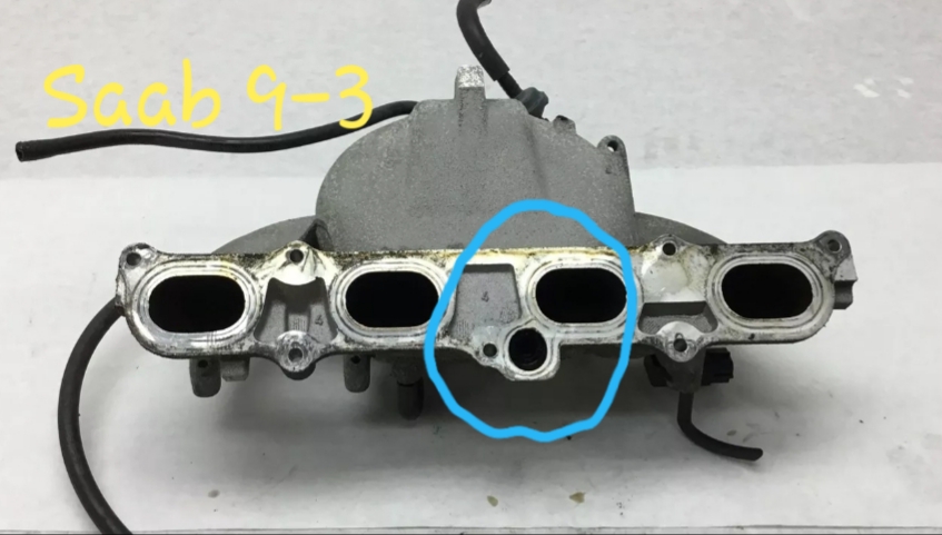

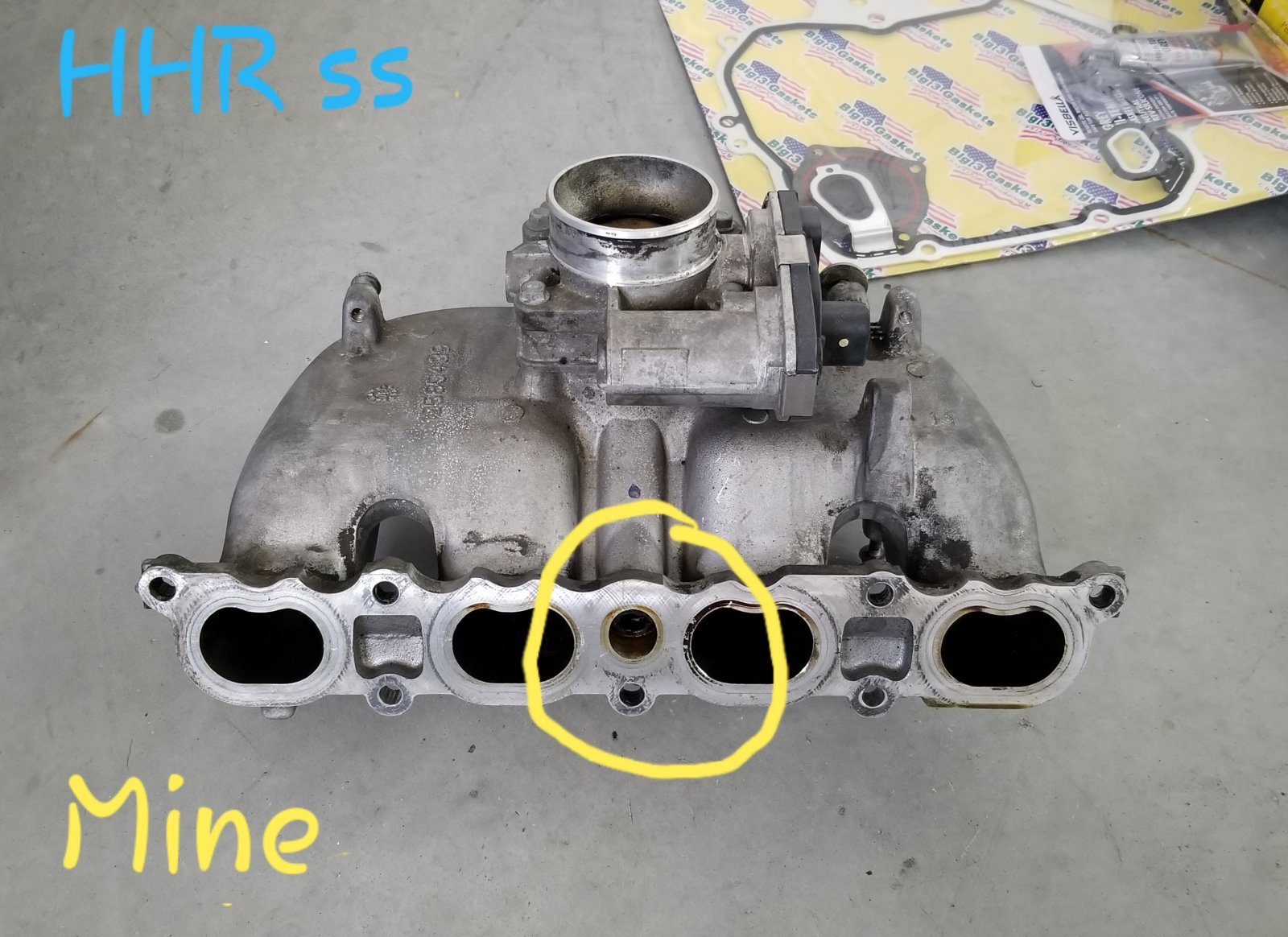

I only know the LNF at this point. But it's actually located in the intake manifold between runners 2 and 3, which I'm not particularly a fan of. This makes replacing it or eliminating it much more complicated and involved than on a car where it's external. IF it was still there, a PCV swap on my eclipse would be less than 5 minutes. Anyway, I'm thinking that the PCV could be pulled then the hole could be tapped and plugged using a set screw. I have no idea what the diameter would be at this point but would guess wildly around M16. I THINK this would be the same as removing and plugging the port of an external one.

This is what started my whole study on PCV, trying to figure out how the system works so I could install an intake manifold from a Saab 9-4. I want to eliminate the 180 in charge piping as it comes down from the intercooler on top of the motor, drops below the IM and then 180's back up to the throttle body. It was suggested to just eliminate the PCV valve and plug the holes, but you really have to manage crank case vapor in a boosted motor or you will have a slobbering mess. I dealt with it most of my career with Detroit 2 stroke motors. Catch cans alone don't get it done. You still have to pull a vacuum on the motor to control where the oil will be caught. Theres gonna be oil. I think I like your ideas.

A picture really is worth 1000 words. Your simple little drawing does a better job than my video last night.

I'll take another look at the valve cover tomorrow. I gotta get some sleep, but I think if you eliminate the PCV valve, plug the PCV port in the turbo, and pull a vacuum on line 2 via a catch can, you will get the best of both worlds. No CC pressure making a mess, and no oil through the intake runners. And, I don't think there will be much oil left in the air going into the catch can. Most of the oil should have condensed on the media in the valve cover.

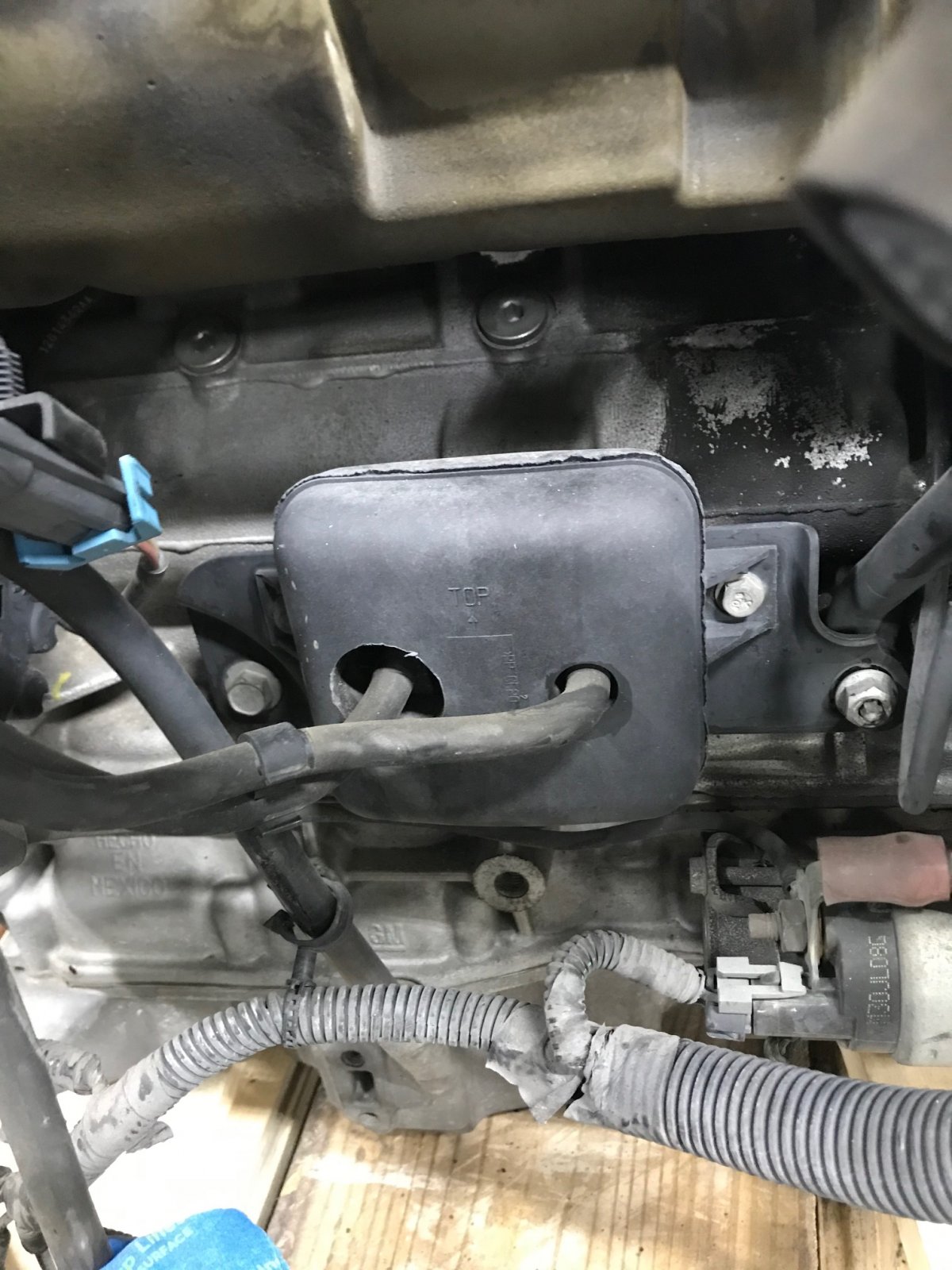

I stumbled on the thread below this morning. In addition to the routing above in your diagram from the intake manifold, there is a vacuum tank? (pic below is from my engine) What purpose does it serve? The guy in this thread removed it from the system. Post #40 has a link to a pic.

I was wondering about that little box myself but haven't put too much thought to it yet. At the moment I can't remember what it even connects directly to, I do have pictures I can dig up when it's time that I need to know. From reading the first few posts, I will likely retain that box initially. I will try it connected and disconnected and see what happens. Of course I'm a loooong way from that point.
That is the vacuum canister. It stores vacuum and provides it instantly to the bypass solenoid when you let off the throttle.
Interesting... I'm used to thinking of pressurized reservoirs, not vacuum.
