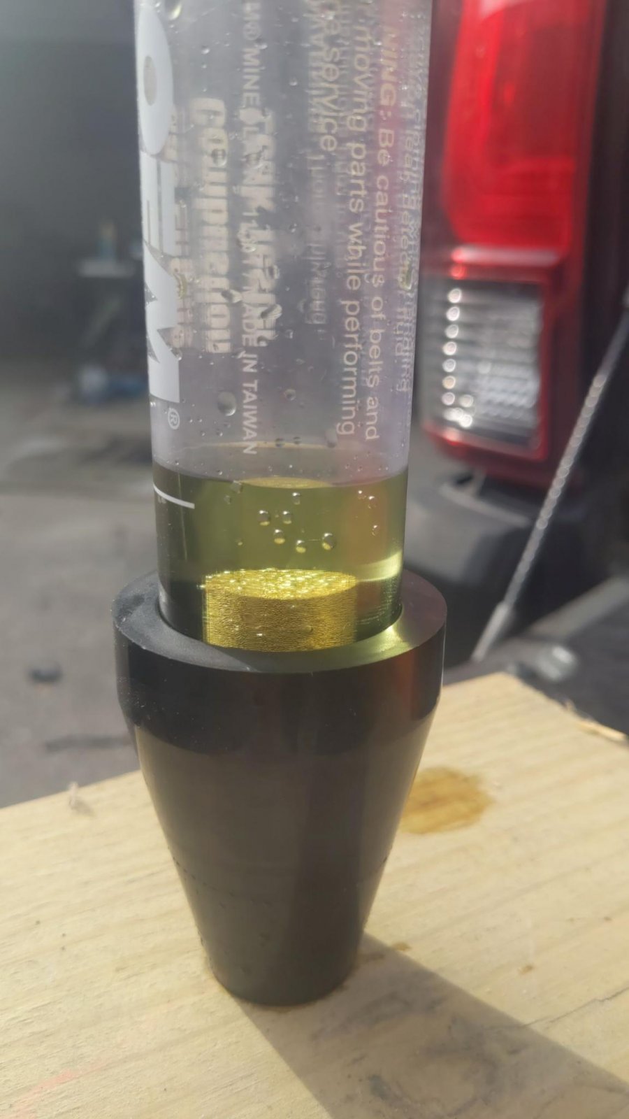

Have you tried the red neck radiator purge method?
My "no tool" solution to air in the coolant is to rev the engine up to 4000 rpm for 4 seconds, and let the water pump push the air thru the system. Then top up the coolant, and try redline (6500 rpm) a few times.
jirwin
I have many times. I suppose if Matt's theory was right it wouldn't matter much though
It still might be worth trying. A negative test wouldn't rule out a head gasket issue, but a positive test would be.
Sad I can only give your comment one like! I believe it changes color from exhaust in coolant. I've not used one in the past 2 decades, so I don't recall if it can be "a post run test" or not.
jirwin
If it can be post test I'll definitely try it!
It looks like its still gathering pressure. The coolant level it rises to was the level the res had when it was cold before the last run. Finally got it on video though.

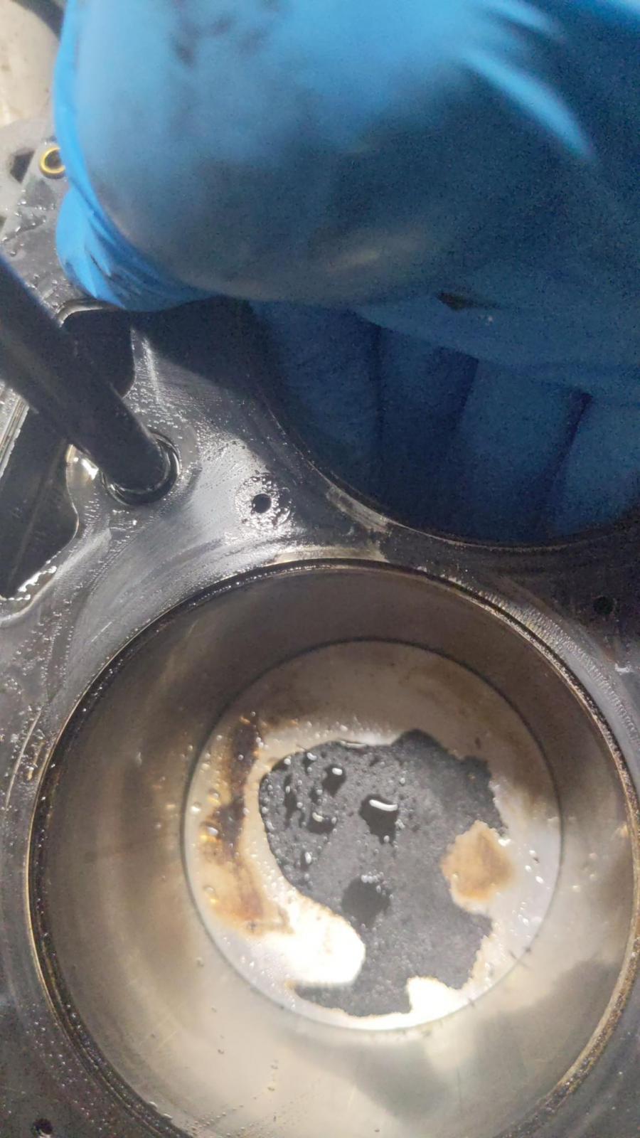

Well its what I feared... and by that I mean I have no fucking idea what's wrong. Everything looks fine. 1 and 4 I didn't get to BDC to check for cracks or whatever, but 2 and 3 look fine as far as I can see. Head gasket basically looks new except for one small (if I'm being super picky) imperfection here
