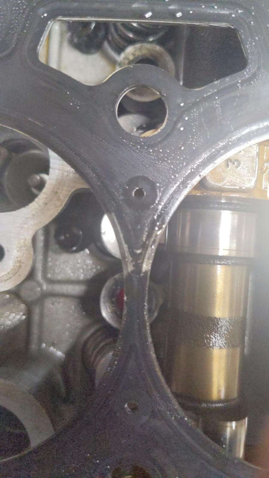

Gladly. Top side of 2-3 is the only visible "damage"
That doesn't look too bad. From the original (far away) picture I was expecting more coating peeling. It still could be the issue but I'm less inclined to think that now.
