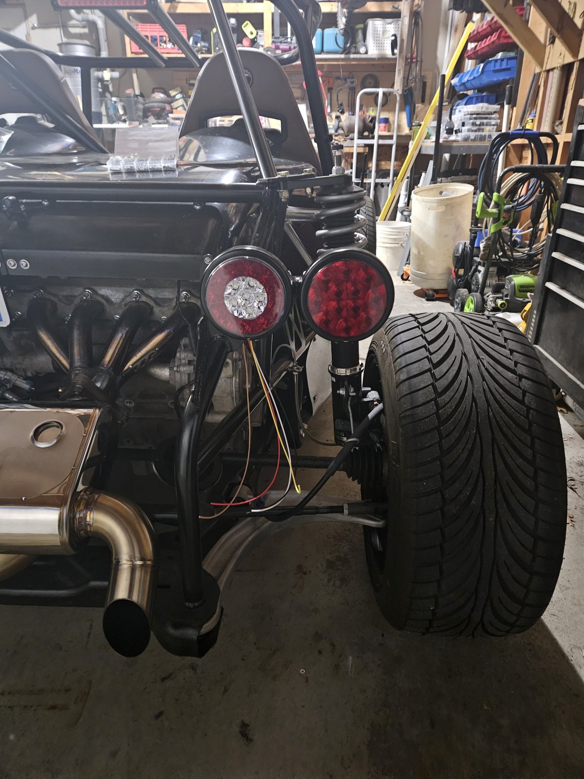

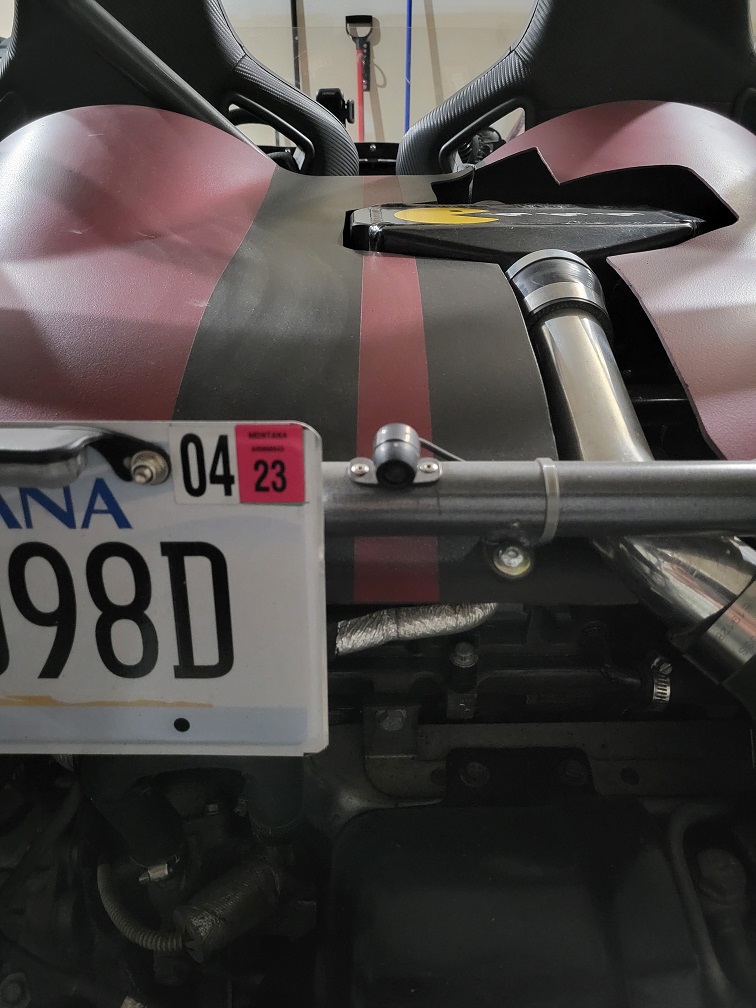

It's a continuous feed. Really easy to install and I think only about $50 total.
Yep. Super easy to do, and cheap. Really helps with backing up in cars equipped with harnesses.

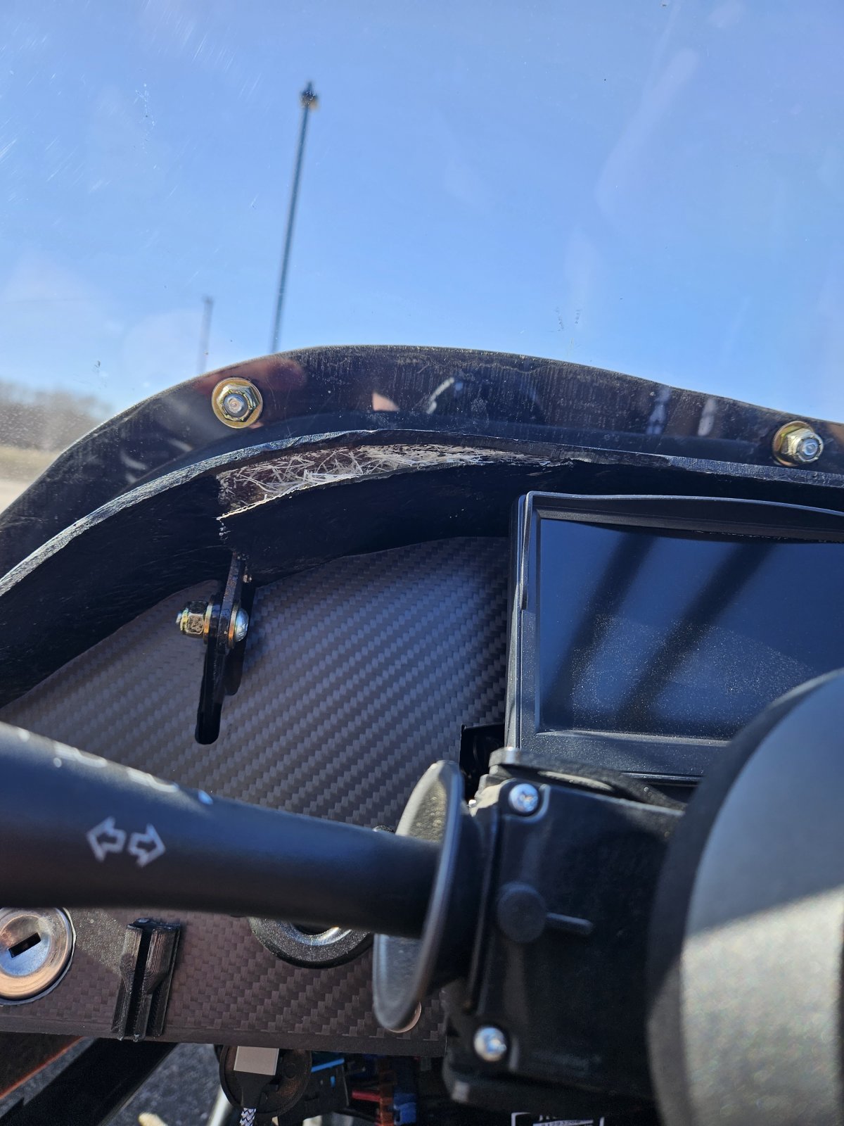

Sorry to hear, hopefully his insurance will be paying for the repair? Luckily these parts are not really hard to replace, just an annoyance that your Goblin will be out of commission for a period of time.
Jmar1622
They should, a little nervous how difficult it could be depending on the adjustor/company. But already trying to figure it out with DF so that's a good start

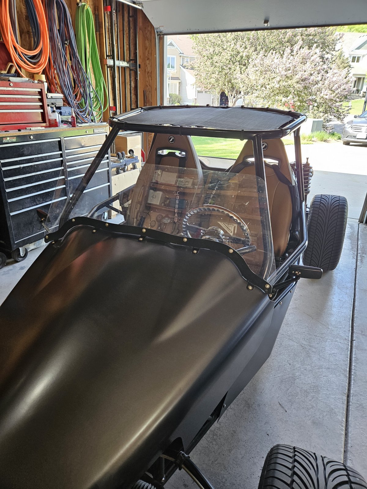

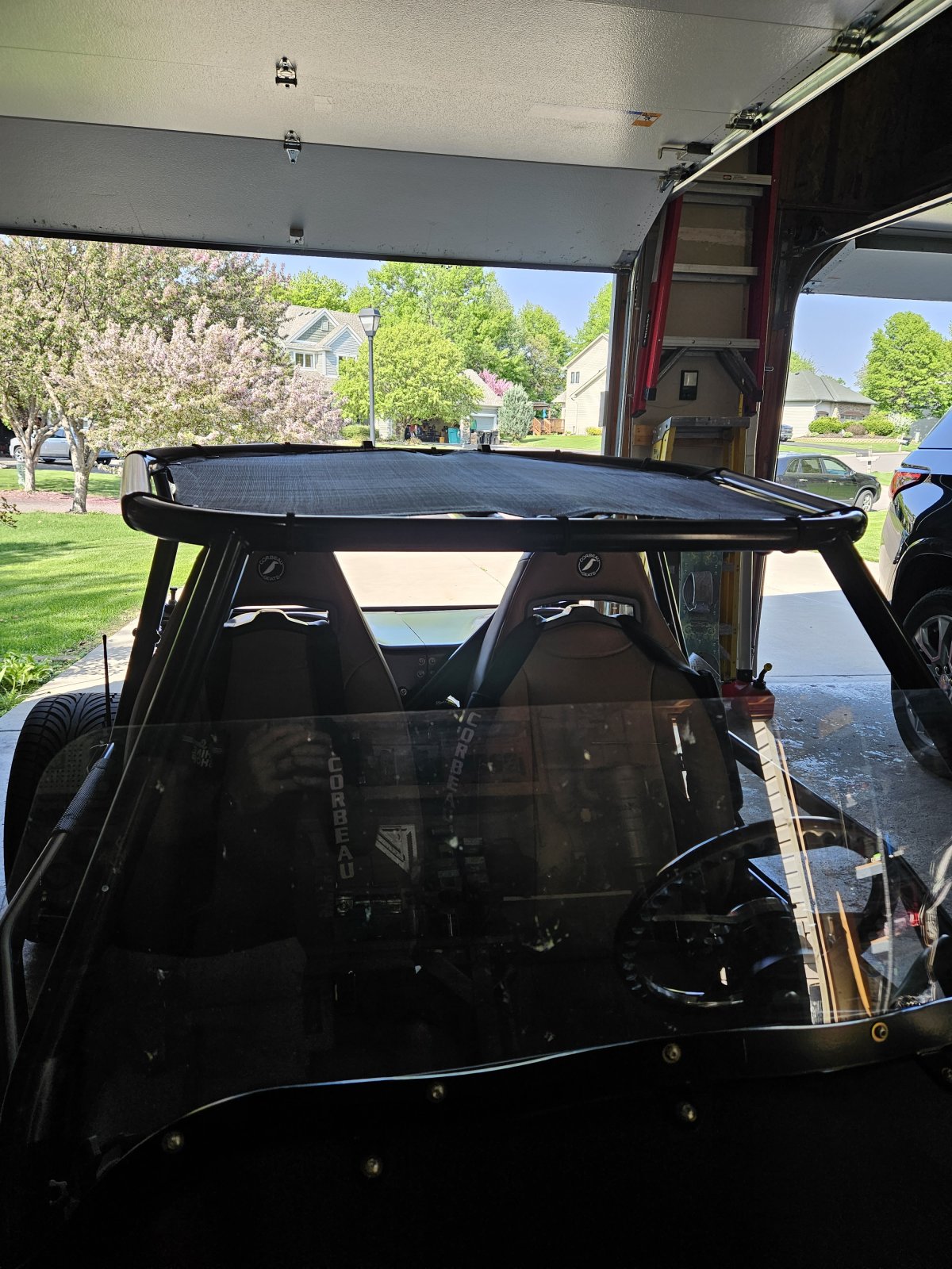

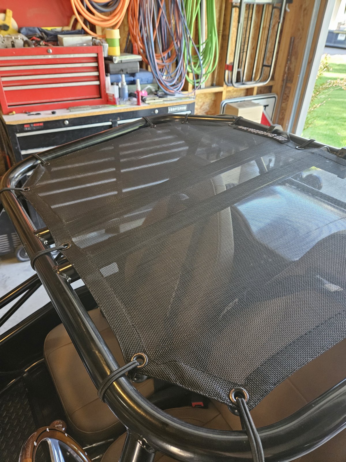

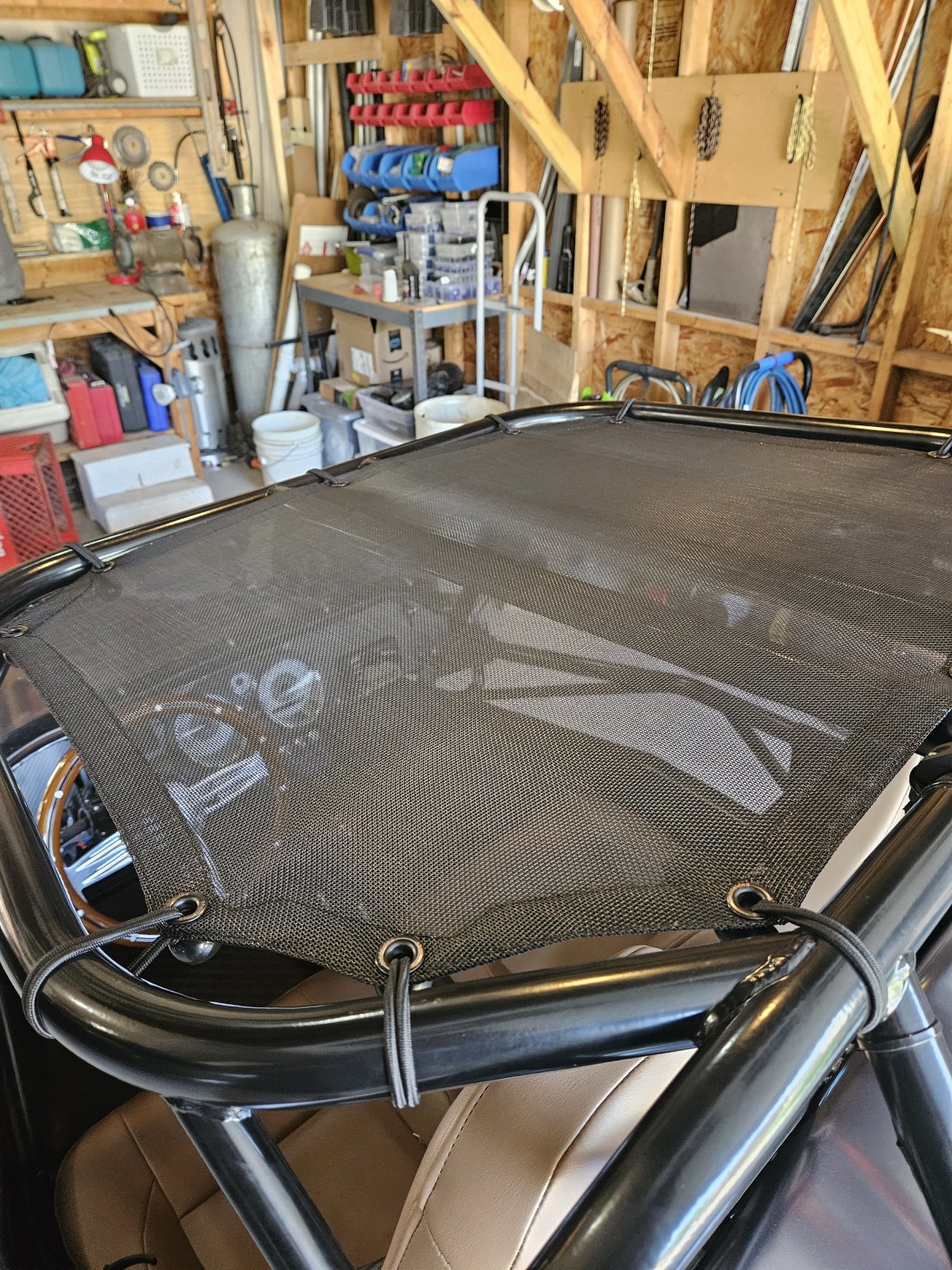

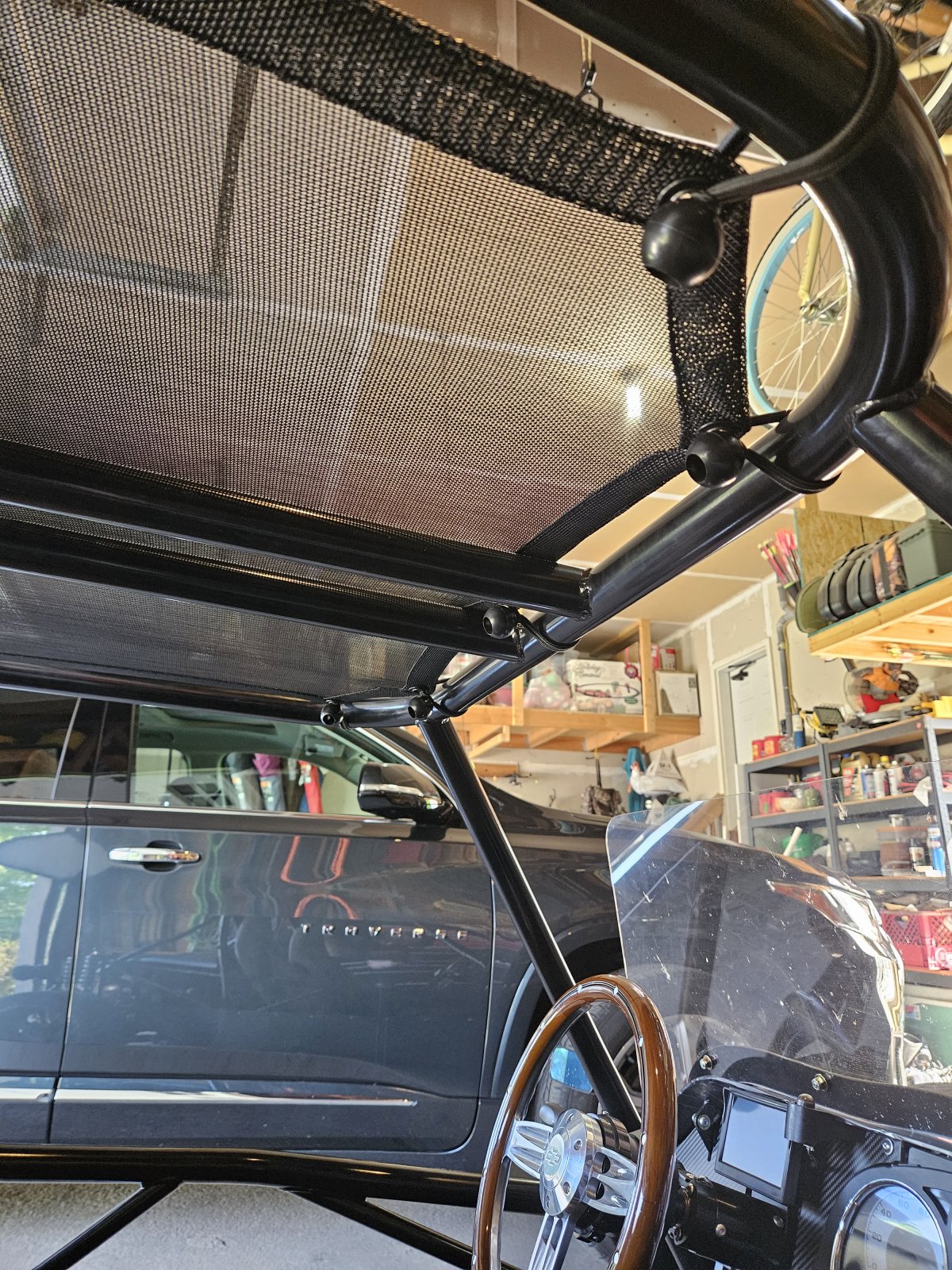

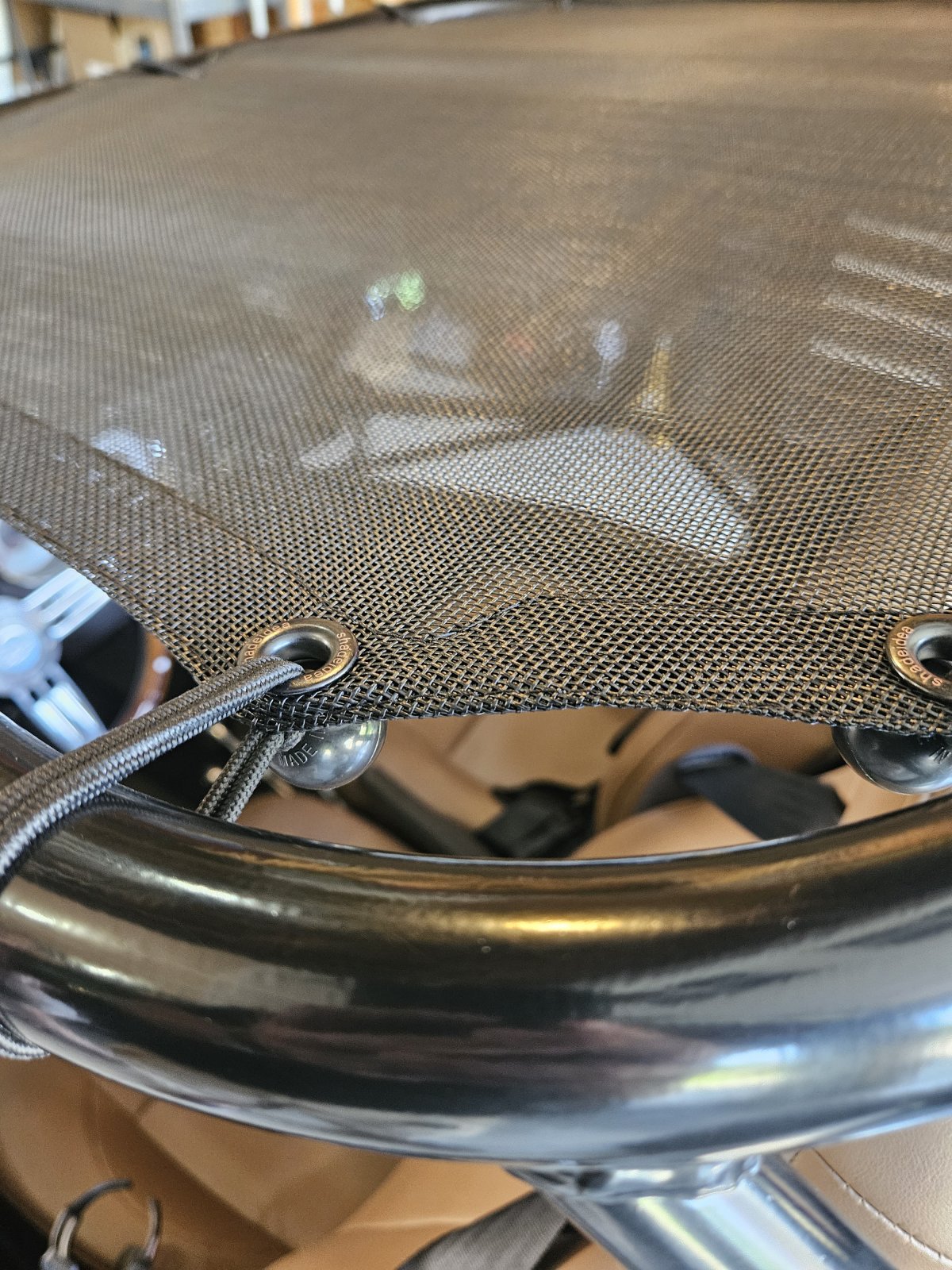

I saw your Facebook post too. Can you show a few more pictures of your sun shade? Does it attach with bungees? Any weird whistling or buffeting when traveling at highway speed+20? :D
Jmar1622
40567
40568
40569
40570
40571
40572

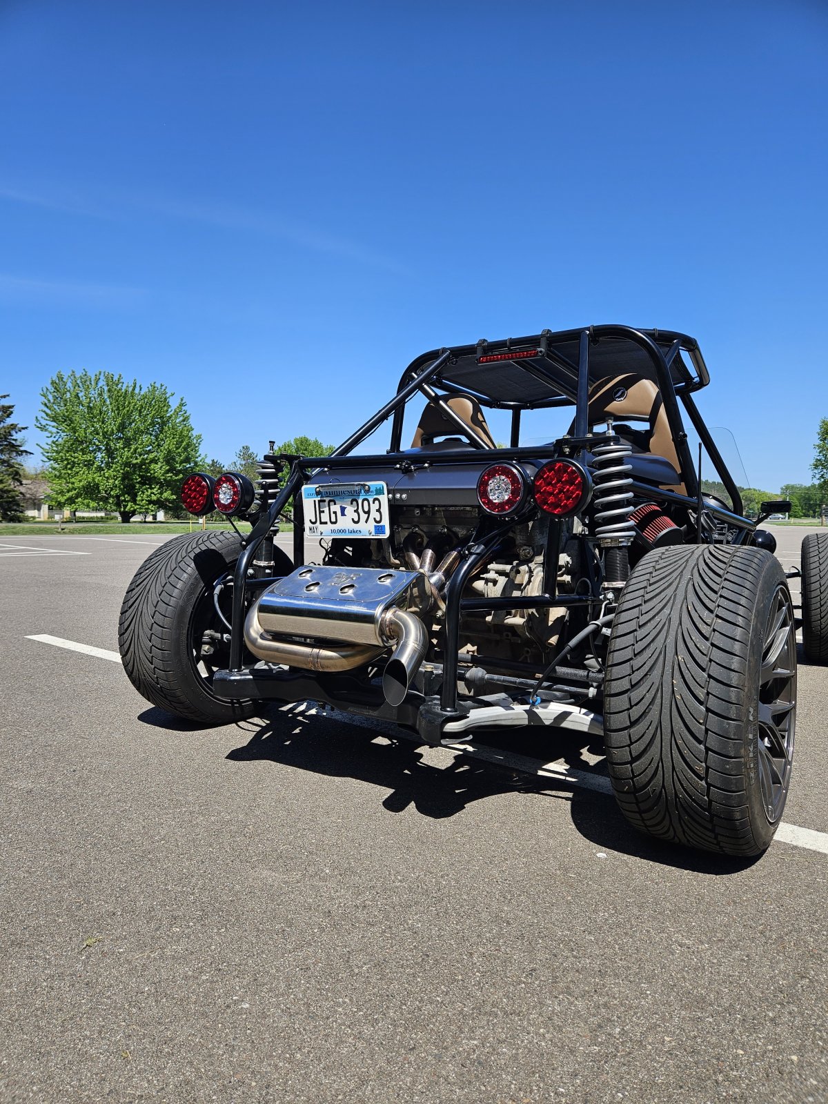

Held on with bungee. Only thing I had to do was shorten them. Haven't noticed and whistle or flapping yet. I think it's worth it!

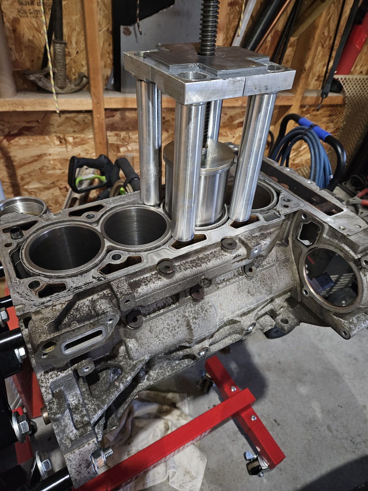

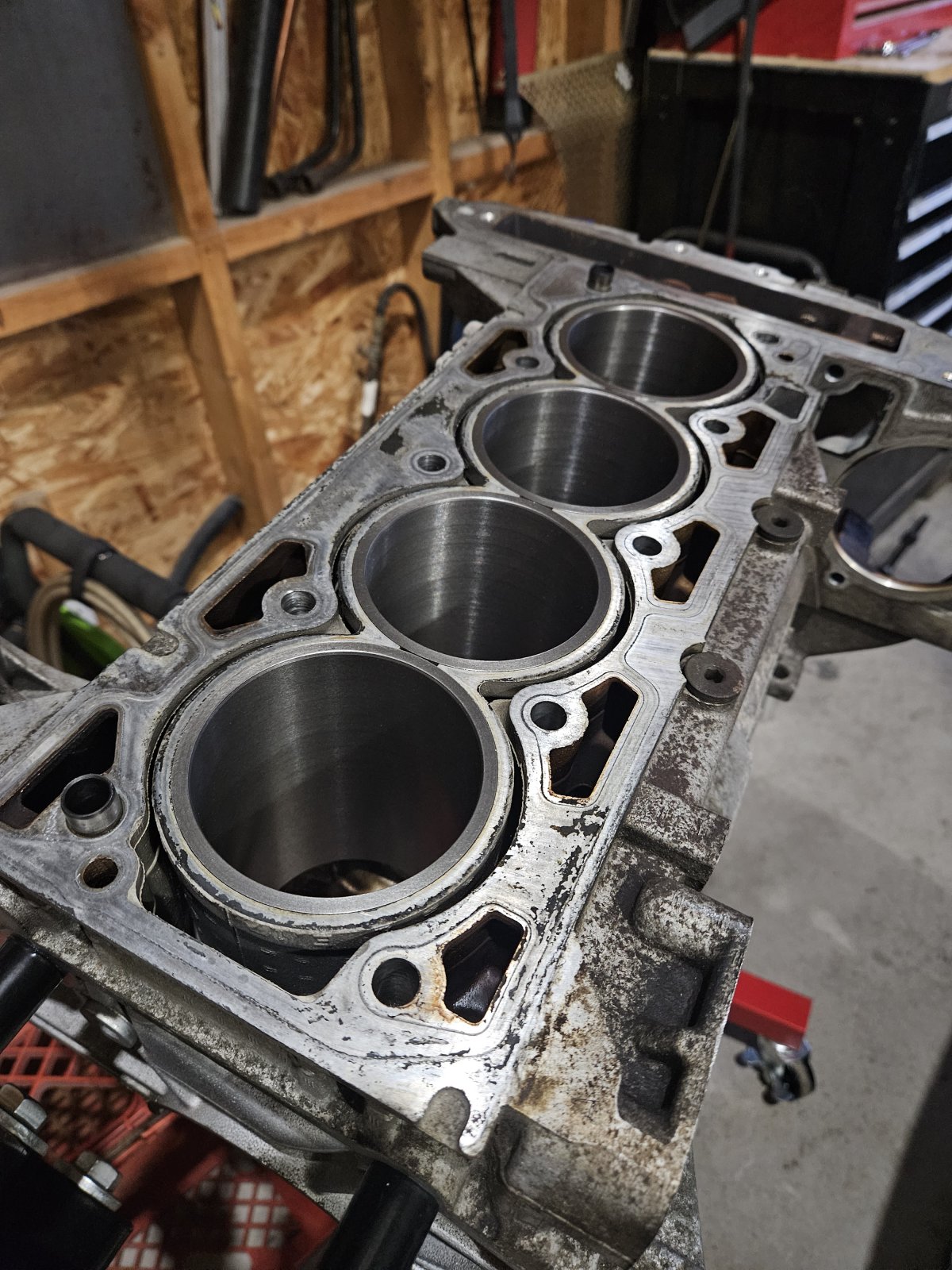

Darton sleeves? Did you freeze the sleeves before installing them (easier to press into the block)? Assuming the old sleeves were machined out of block? Have to ask, was this cheaper than purchasing another block, or did you do this to increase bore size?
Jmar1622
Just to beef it up incase I decide to go with more hp. OTTP sleeves, they claim their 200% stronger than stock and able to handle 600hp un supported. No freezing, the old ones pull out and the new ones press in. Ecotec oem style sleeves are very easy to change with the proper tool.

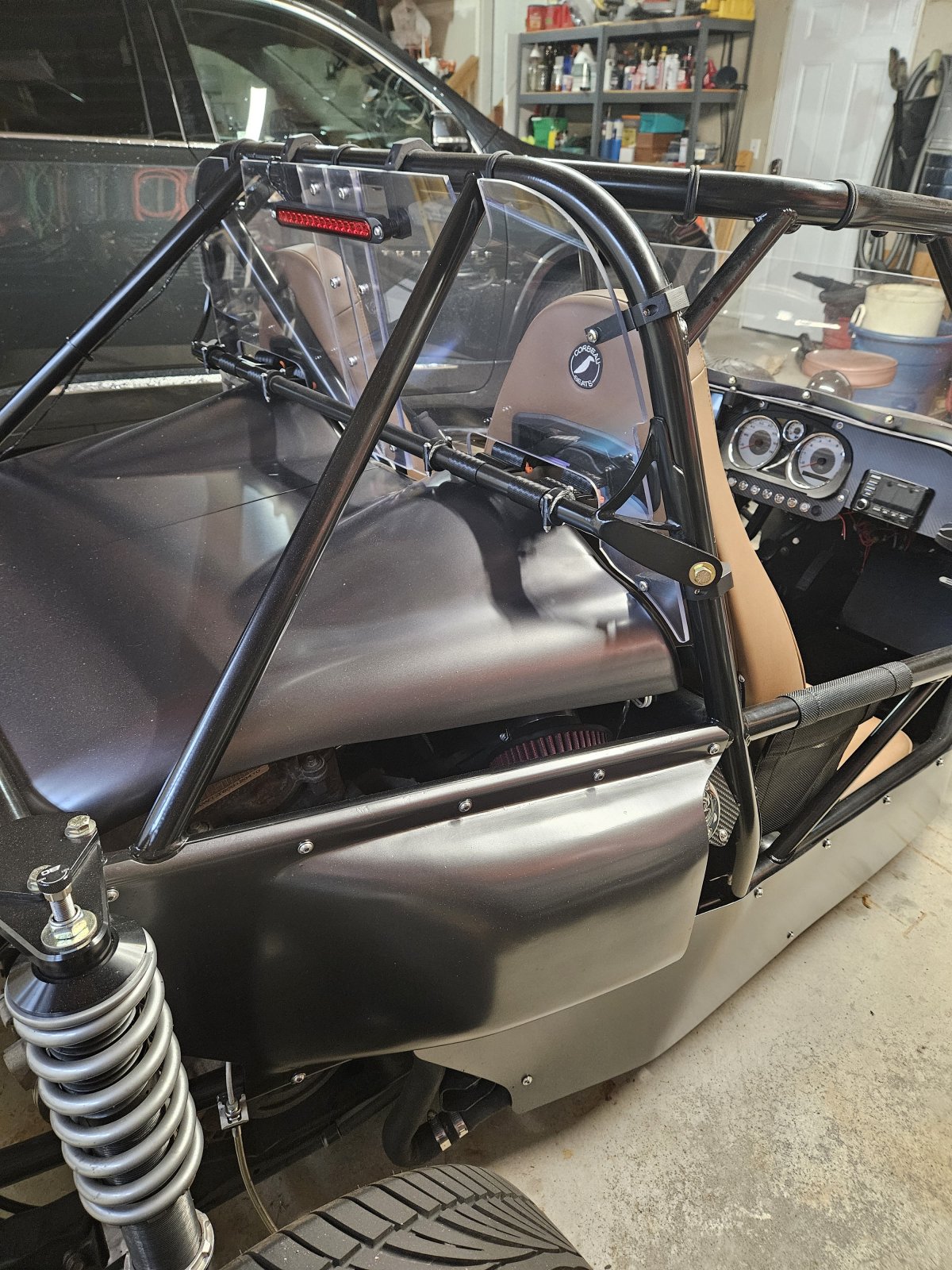

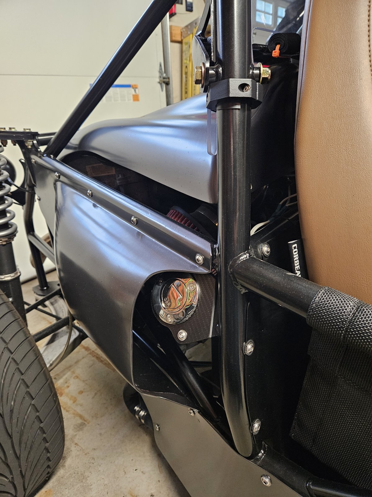

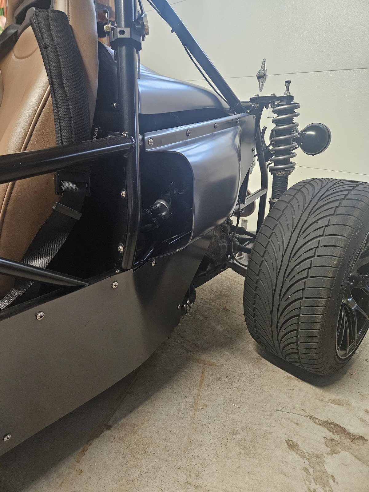

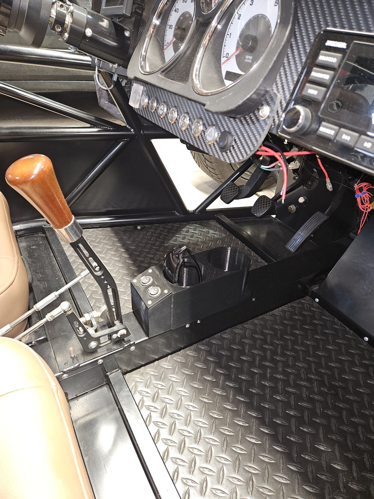

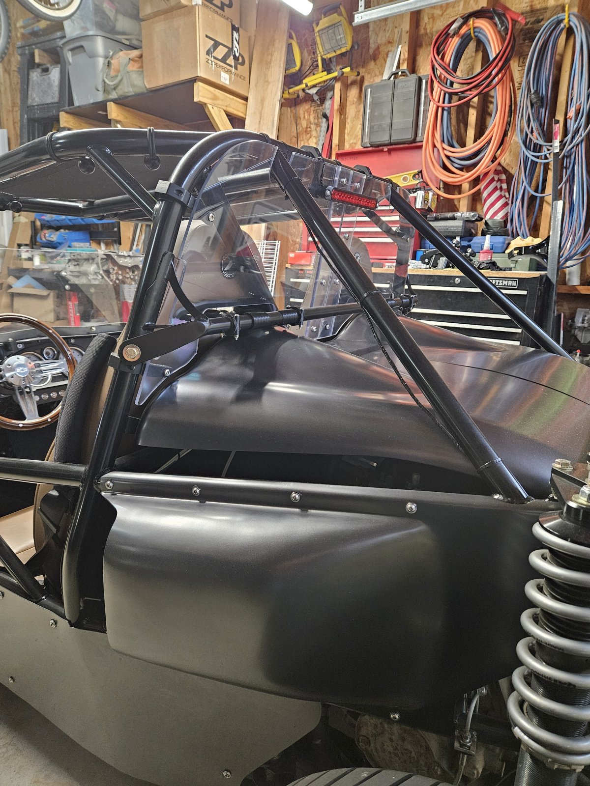

Annual update. I added a lexan rear windscreen, made a removable seatbelt bar, made and wrapped side scoops and redesigned a fellow Gobliners cup holder to reposition the seat warmer switches. I also changed out the gas filler cap.
