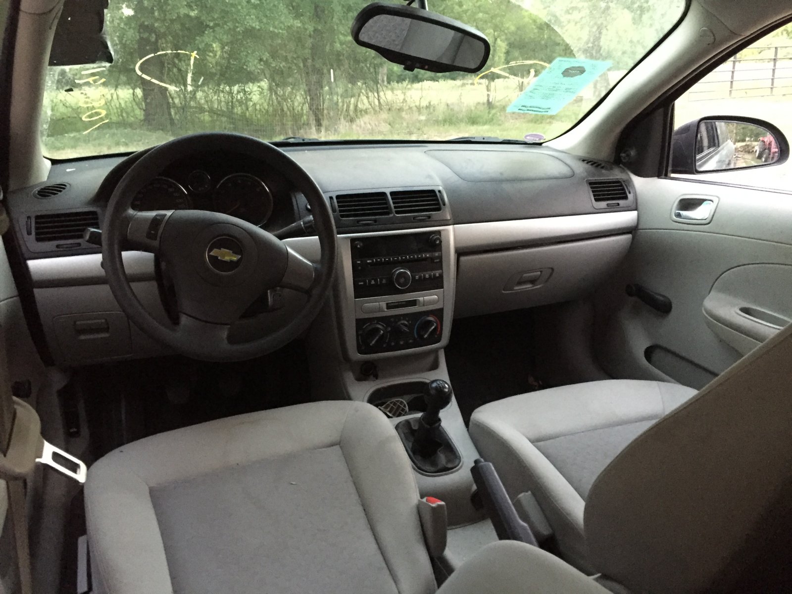

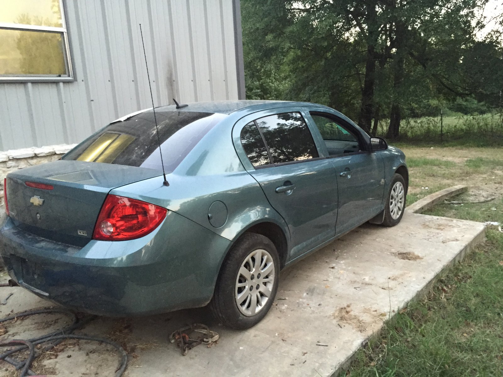

After going back and forth between an LS and SS, and searching through 1000's of photos looking for a manual shifter I finally found what I was looking for. I really wanted a 2009 or 2010, and it had to have under 120k. I found one in Arkansas, and while I definitely paid more than I wanted to, it met all the criteria well.

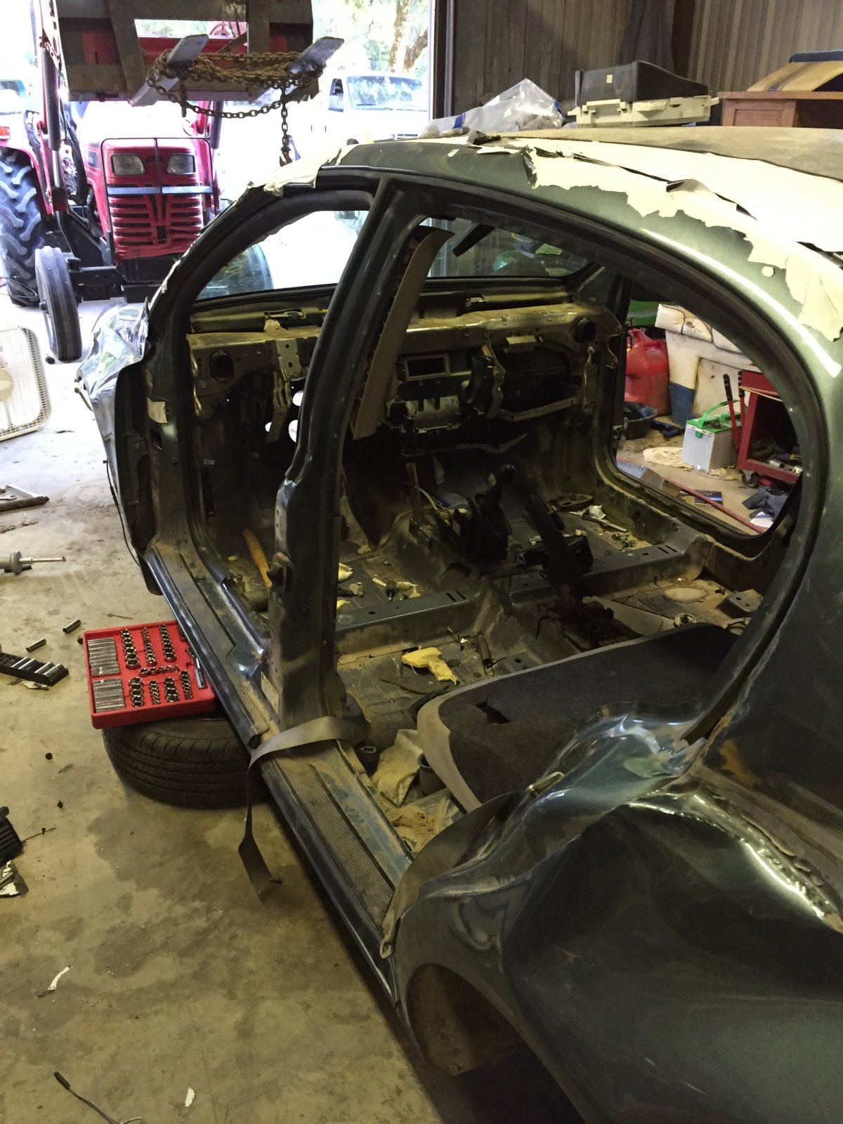

It was surprisingly clean, and after charging the battery it ran great. Brakes, clutch, transmission and electrical system all worked correctly, and no warning lights were present. Once I got it lifted up I was glad to find no leaks, there was some sub frame damage but it was from running over something and didnt appear bent.

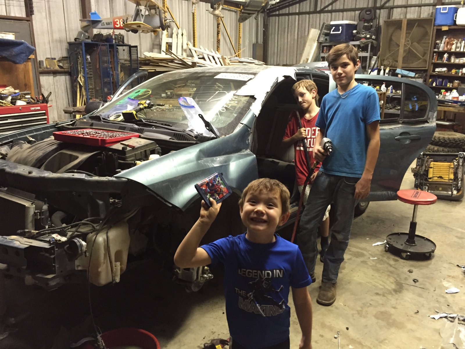

The disassembly went well. I only had one weekend available to work on the disassembly, as the car is at my parents house a few hours away from mine. I started Friday night, and finished early Sunday, it was a bit rushed, but it definitely can be done. A common assortment of tools was used, with ample crowbar and BFH action as I wasn't going to try and resell anything. ( that's probably one reason to get an SS, there is much more demand for the seats and various other parts whereas base equipment is just not worth the hassle to sell as far as I could tell)
Honestly I'd say the most important tool was a couple of little tools :)
Because working under that dash is miserable. Luckily they were able to remove nearly all of the under dash components while I removed the engine.

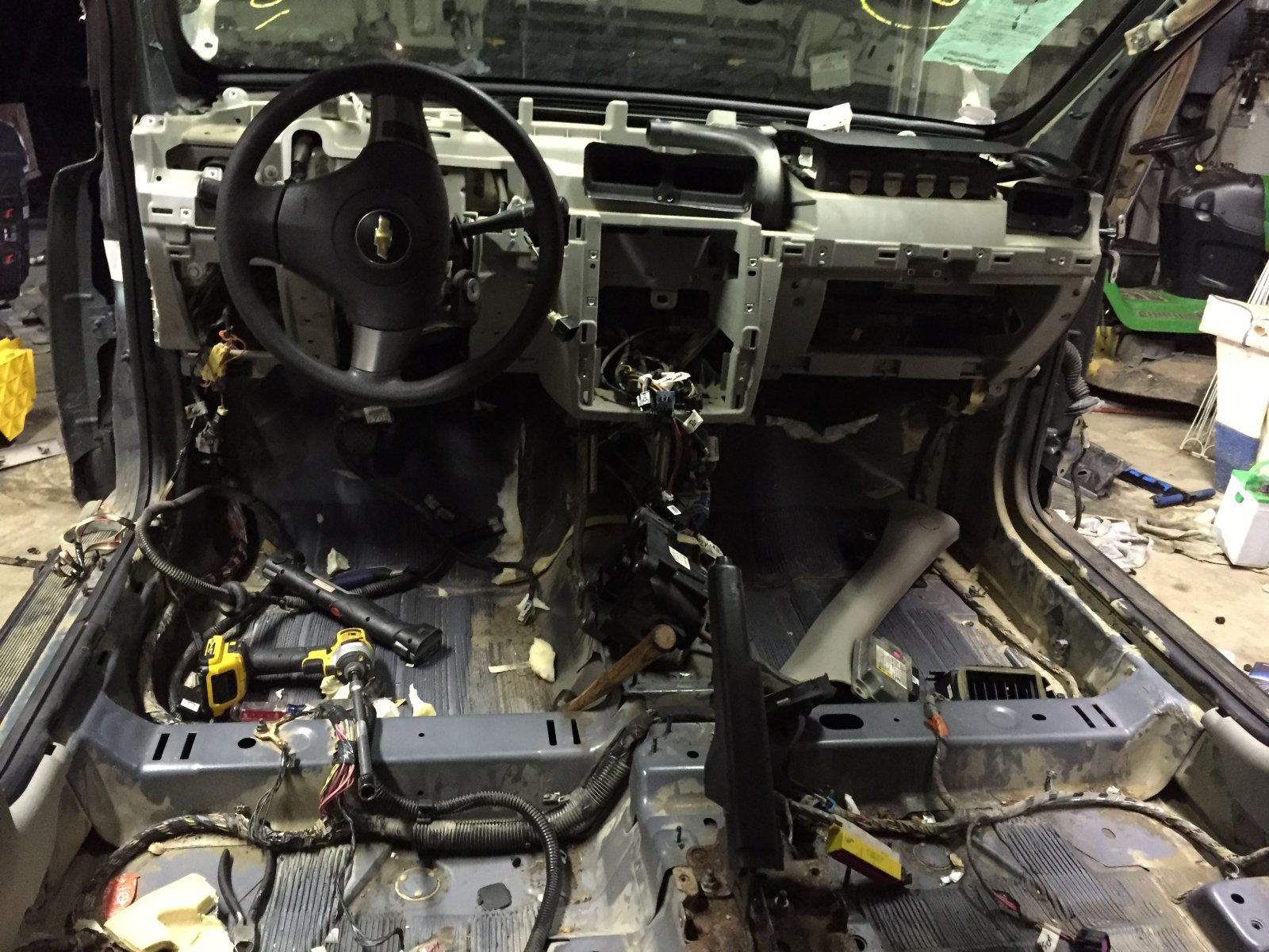

I did not remove the dash in one piece as suggested in the donor parts guide, mostly because it felt like you had to pull the whole thing apart to access the main bolts.
Pretty soon I had the front end completly apart. I was planning on doing a bit of work to the engine so went ahead and removed the engine harness before I pulled it. While the car was jacked up I slid a flat dolly underneath the subframe....
Then used some forks and lifted the whole frame up over the engine.

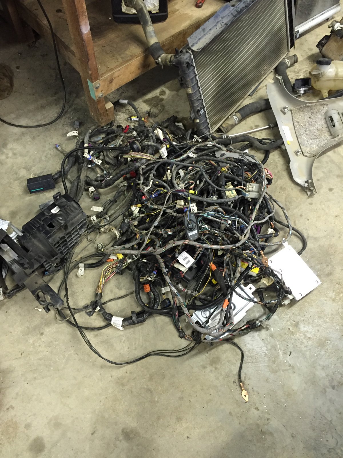

I followed Adam's instructions not to cut any wire, and probably went way overboard. I traced every single wire to its termination. I probably could have unplugged the doors at the hinges, and various other connections, but went ahead and left all large and small connectors connected. This required complete interior tear down. Every last piece of carpet, the door panels and the headliner and airbag covers had to come off. But eventually it was done, and.... HOLY **** THATS A LOT OF WIRE.
JSATX
Thats all for now. I brought all the wire home with me to redo, and left everything else there as I will probably take the frame to my parents larger shop when my first stage is finished.
DanPerryy
The wires look daunting, but it is not that hard, a bit time consuming. I think my harness has about 30 hours in it now (I need to add them up) and it is ready for installation (fit) into the frame.

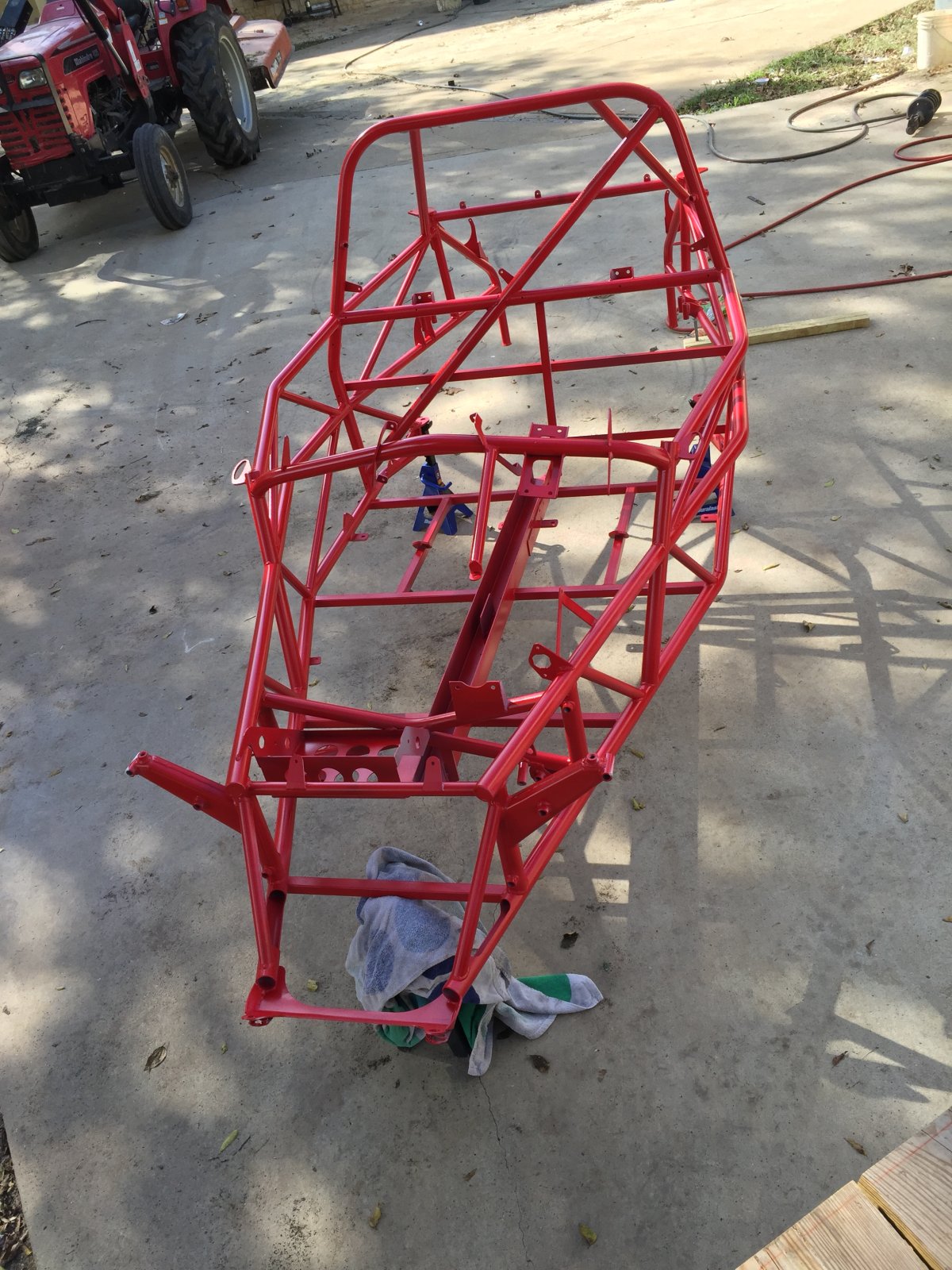

Went and picked up the frame Friday! Spent most of Friday night and Saturday morning cleaning the steel up some. Lots of mineral spirits and elbow grease to remove the surface oxidation around the welds and such.
I had pretty elaborate paint plans. But after cleaning and going to a couple stores I decided to just shoot it with Rustoleum enamel. The primer sprayed well out of my HVLP with no thinner or anything, was really happy with how it laid down. The paint however, was very difficult to keep from spattering. I finally thinned it down quite a lot but overall I'm wondering if I should have just rattle canned it. Because with the tube frame, it's actually quite difficult to tell a good spray pattern from a bad one since every surface is curved.
I really only decided to paint for two reasons. One, it was one small way to save some money on the build, and two if I want to install additional brackets I can just sand back an area and hit it with a quick coat when done. For those wanting less work, definitely get it powder coated. I've seen 7 or 8 that they've had coated and it's pretty awesome.
JSATX
I was lucky it happened to be a cool calm day. We have a large spray booth but it takes several hours to set up. So I took two tow straps and tied the front of the frame to a tree and the back to the tractor forks. It looked seriously redneck but I was able to rase and lower it with the forks so it worked out well. Def a few bugs in the paint but they will hopefully buff right out.

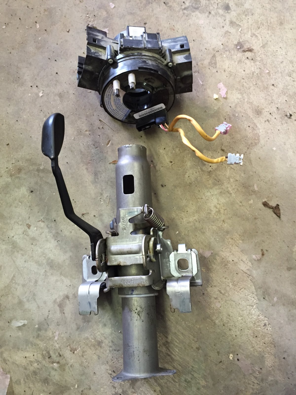

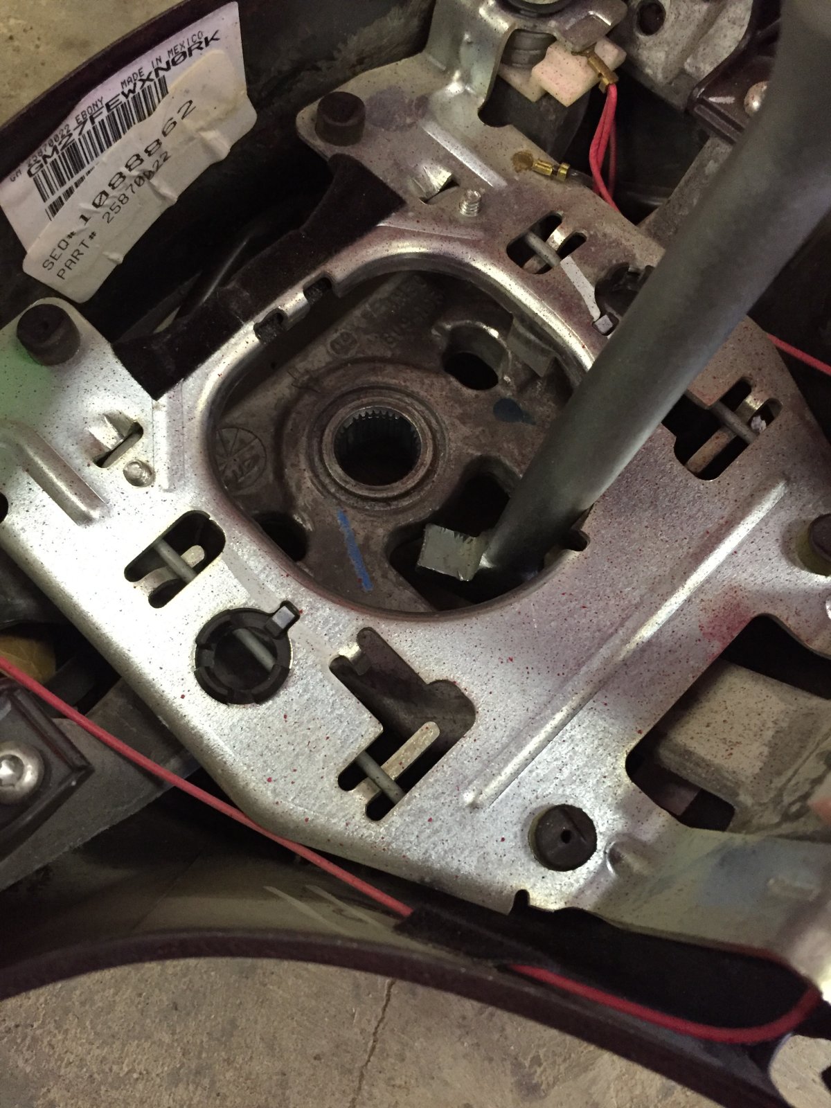

And for future reference for anyone else, I was unable to get the steering wheel off by beating the back of it ala first stage assembly instructions. So I hooked a slide hammer and bearing puller to the steering wheel bracket immediately below the shaft. It took several hard hits before it let loose.
