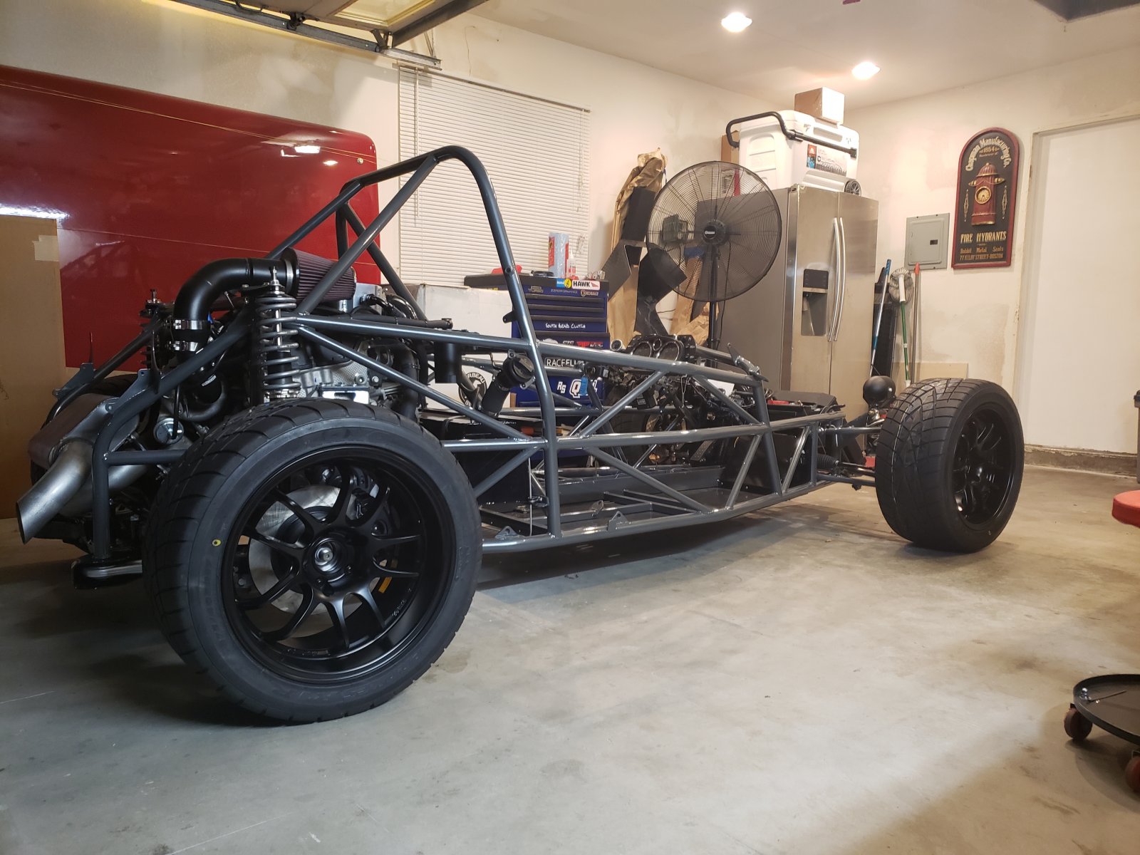

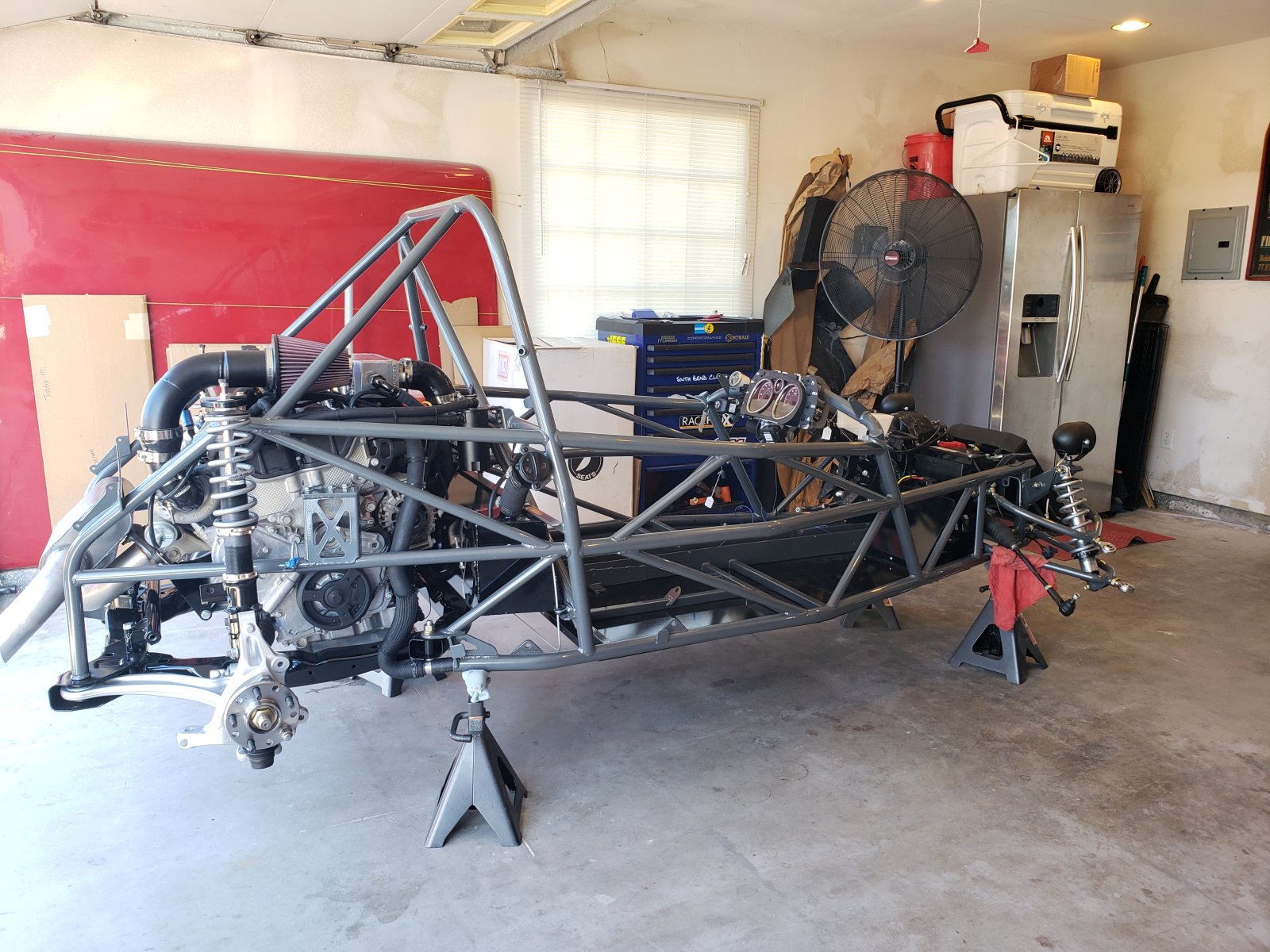

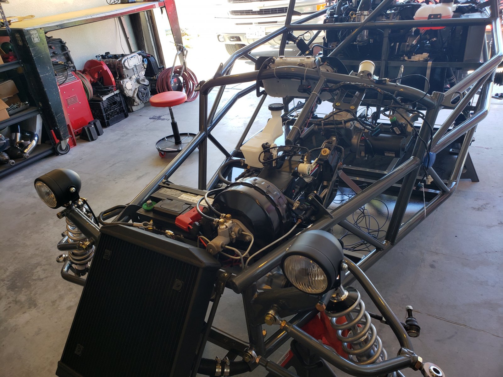

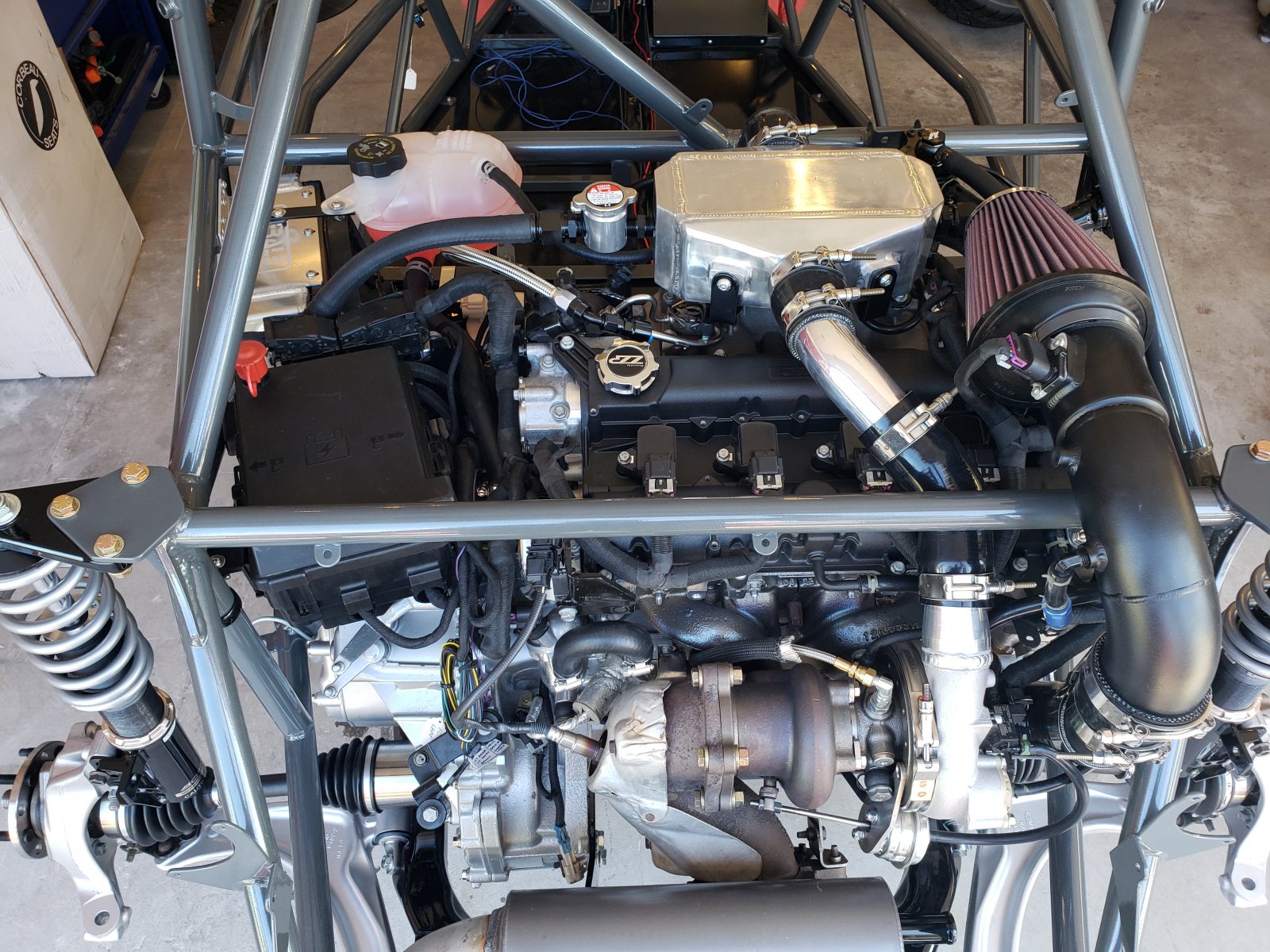

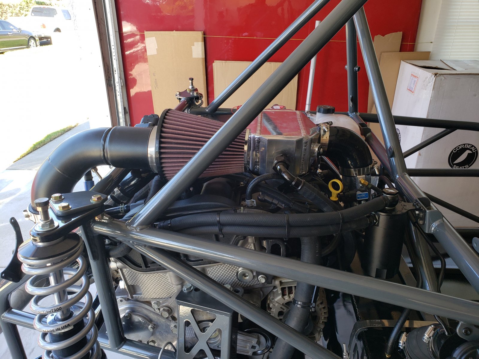

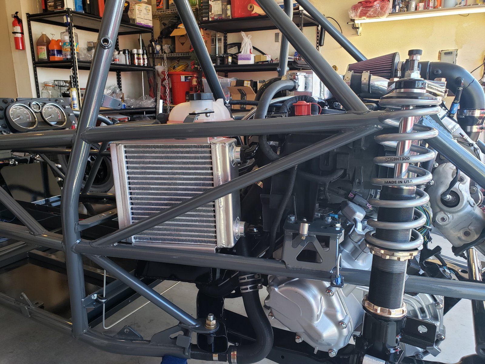

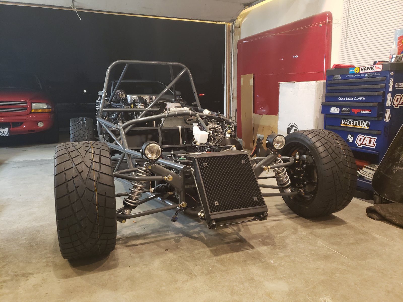

Hello everyone. I have had my kit for awhile now, I believe it's chassis #101. I think it's long overdue for me to start my build log. I kinda lost interest in the project for the last several months but work is starting to slow down for me and I now have some time to dedicate to the car and hope to have it on the street before the end of the year. I started my car for the first time today and just hearing it run is really motivating. Here is a list of the mods that I have done to the car so far.
-Ldk crate motor from zzp
-Wiseco pistons and zzp forged rods
-Opel fuel injectors
-South bend stage 4 clutch and new flywheel
- built f35 trainsmission with quaife lsd, cryo treated gear set and 4.45 final drive
-zzp zfr 6758 turbo
- derale heat exchanger
- And I changed the intake ( didn't really like the stock one)
Here are some pics of the progress I had made so far.

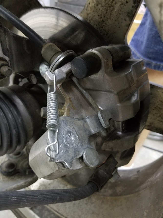

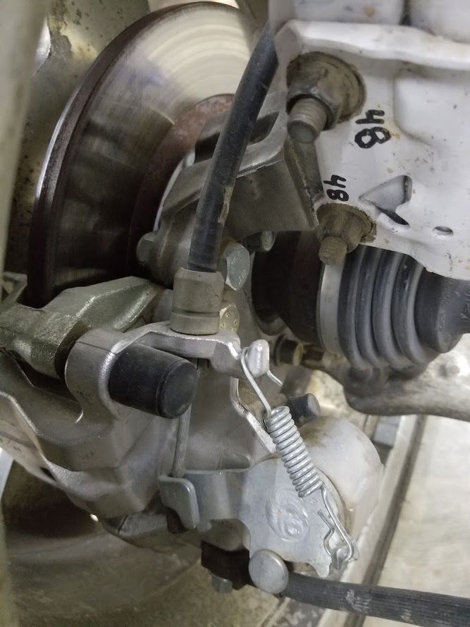

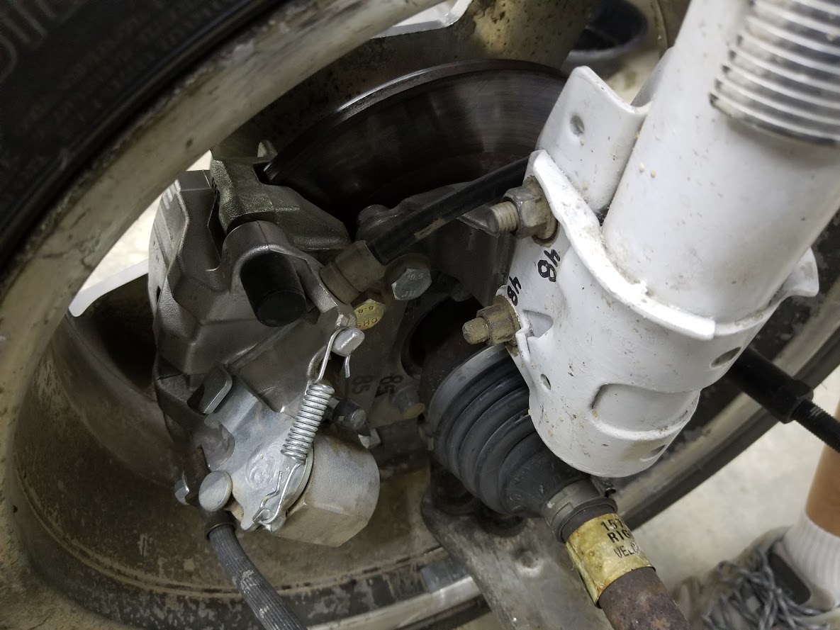

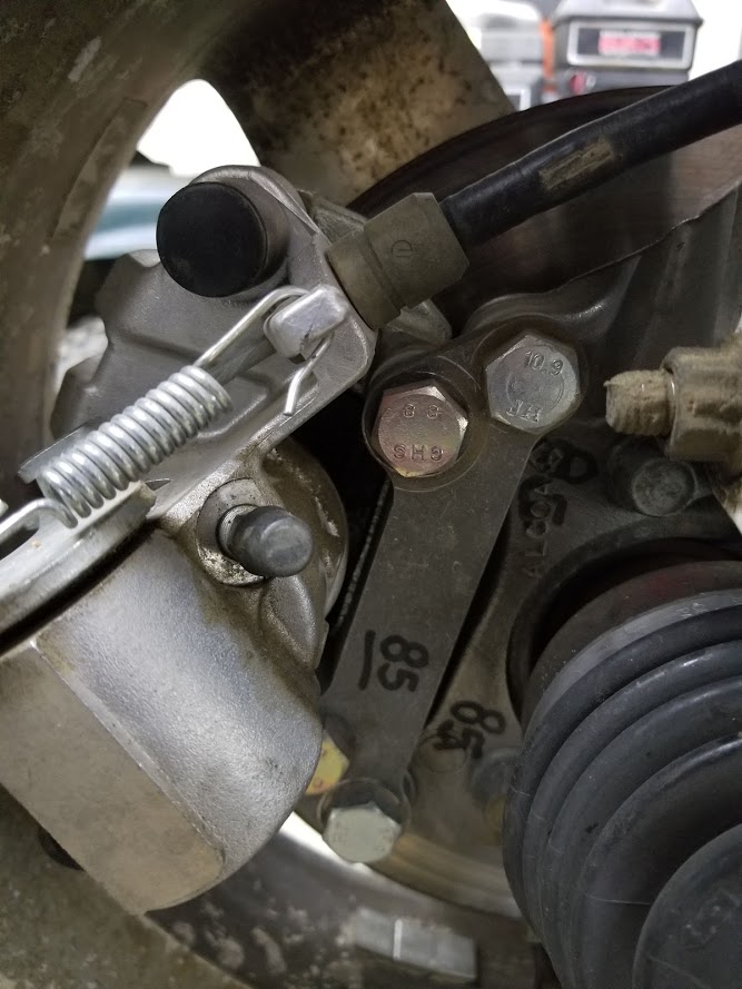

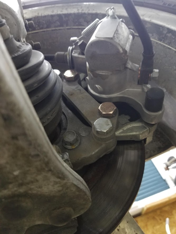

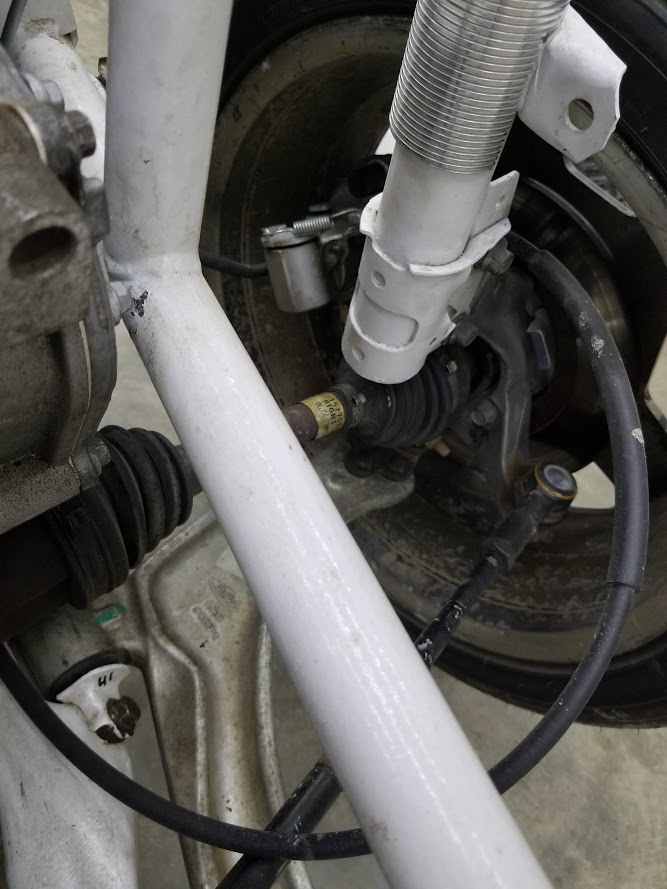

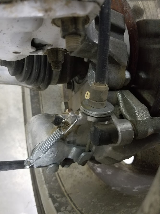

I'm trying to put on the rear solstice calipers on but I dont know what the torque specs for the 8 bolts that came in the kit, also it came with 4 washers, what bolts get the washers? Any help or pictures would be greatly appreciated
The numbers written beside the bolts is the torque specifications (in foot pounds).
I took some quick pics, the wheels were in the way, but hopefully they are of some use to you.
It is dirty - looks like someone recently dragged it out of a autocross ditch.
9849
9850
9851
9852
9853
9854
9855
9856
Washers generally prevent the steel nuts and bolts from digging into the aluminum parts. I don't think I used any of them as spacers.
Update: I see some washer spacers on one wheel cable - this was to balance the 2 cables where they join near the parking brake handle. You might not need these.

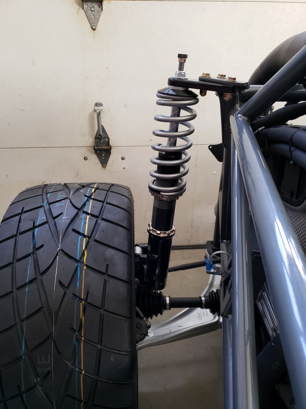

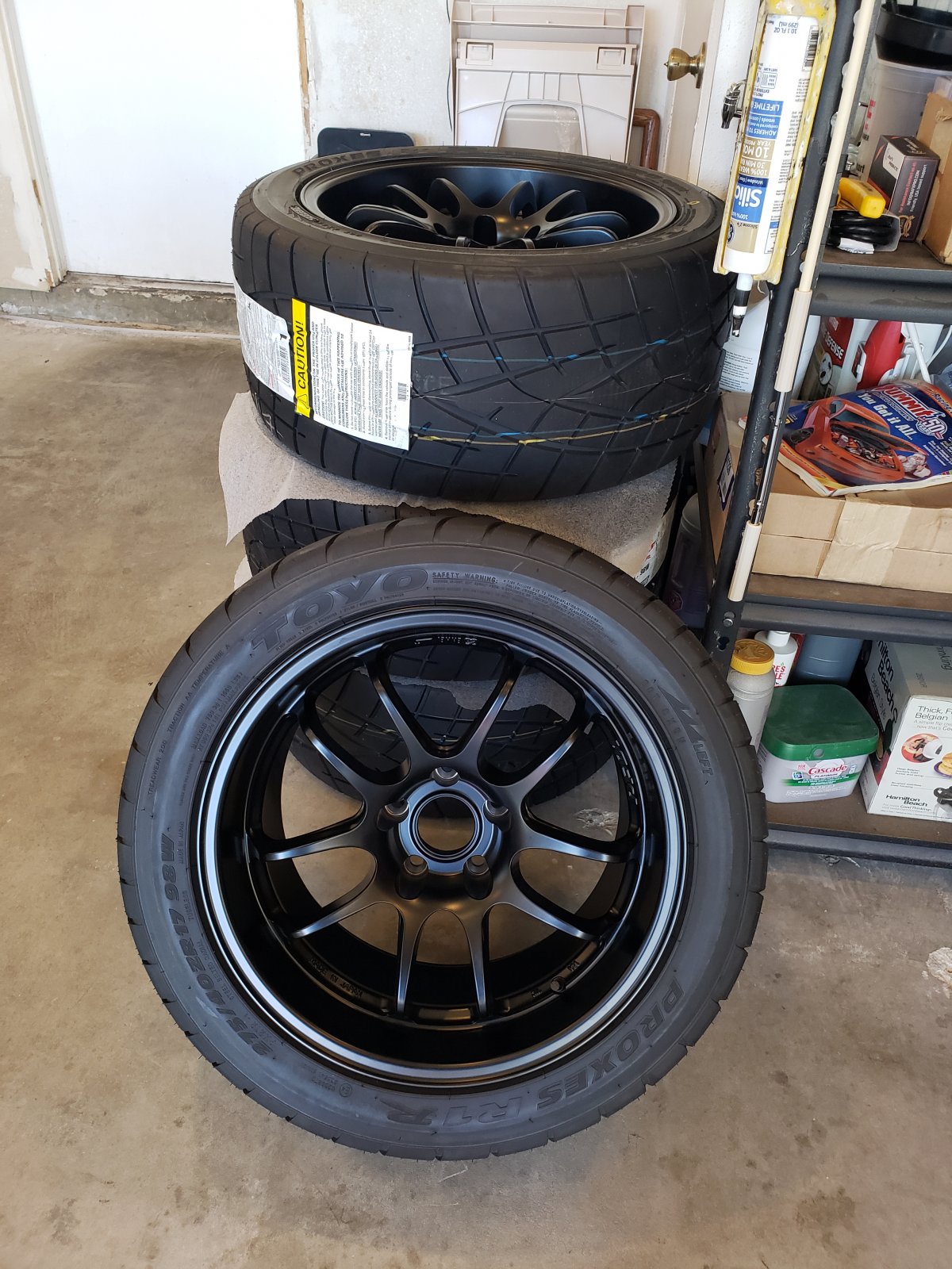

They are enkei pf01 evo 17x9.5 0 offset. With 275 tires. No spacers required, looks to have plenty of clearance front and rear.
