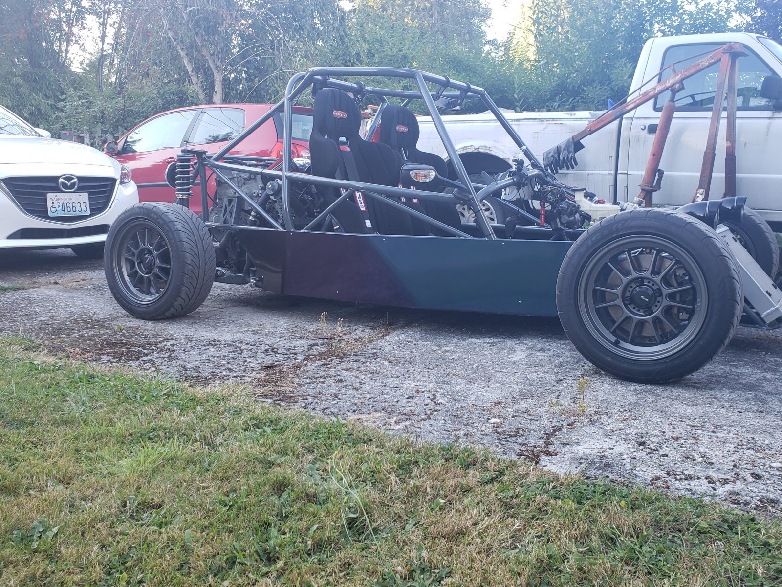

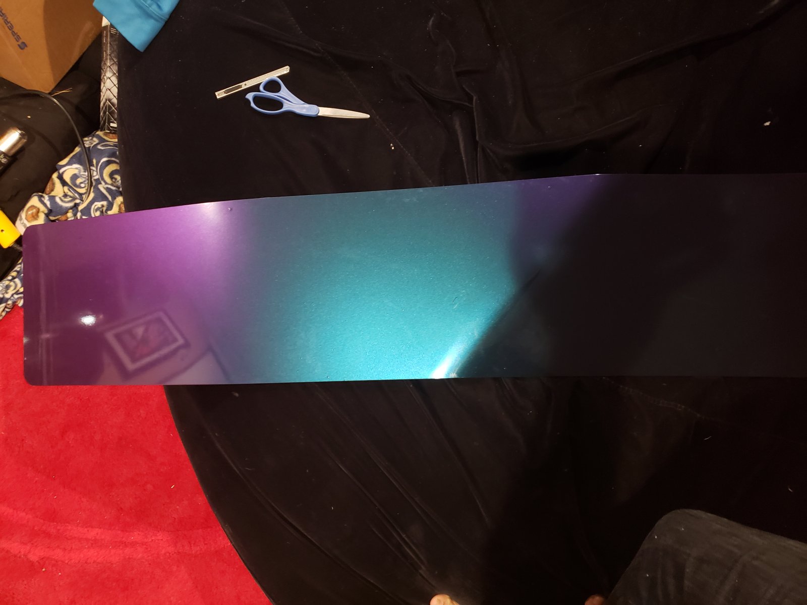

After rushing my dog to the emergency vet clinic 30 miles away this morning because one of her recent surgery sites opened up and she was bleeding profusely from the abdomen, I actually worked on the car. Side panels are now wrapped, inside and out. Needless to say, I have much more appreciation for the skill of those who are good enough to make money at it. Also, for those looking to wrap their cars themselves, I can't recommended Avery Dennison's SW900 film enough; it's so easy for a total noob to work with. Interior is finished with satin black, and the exterior is the rushing riptide gloss colorflow (purple/cyan).

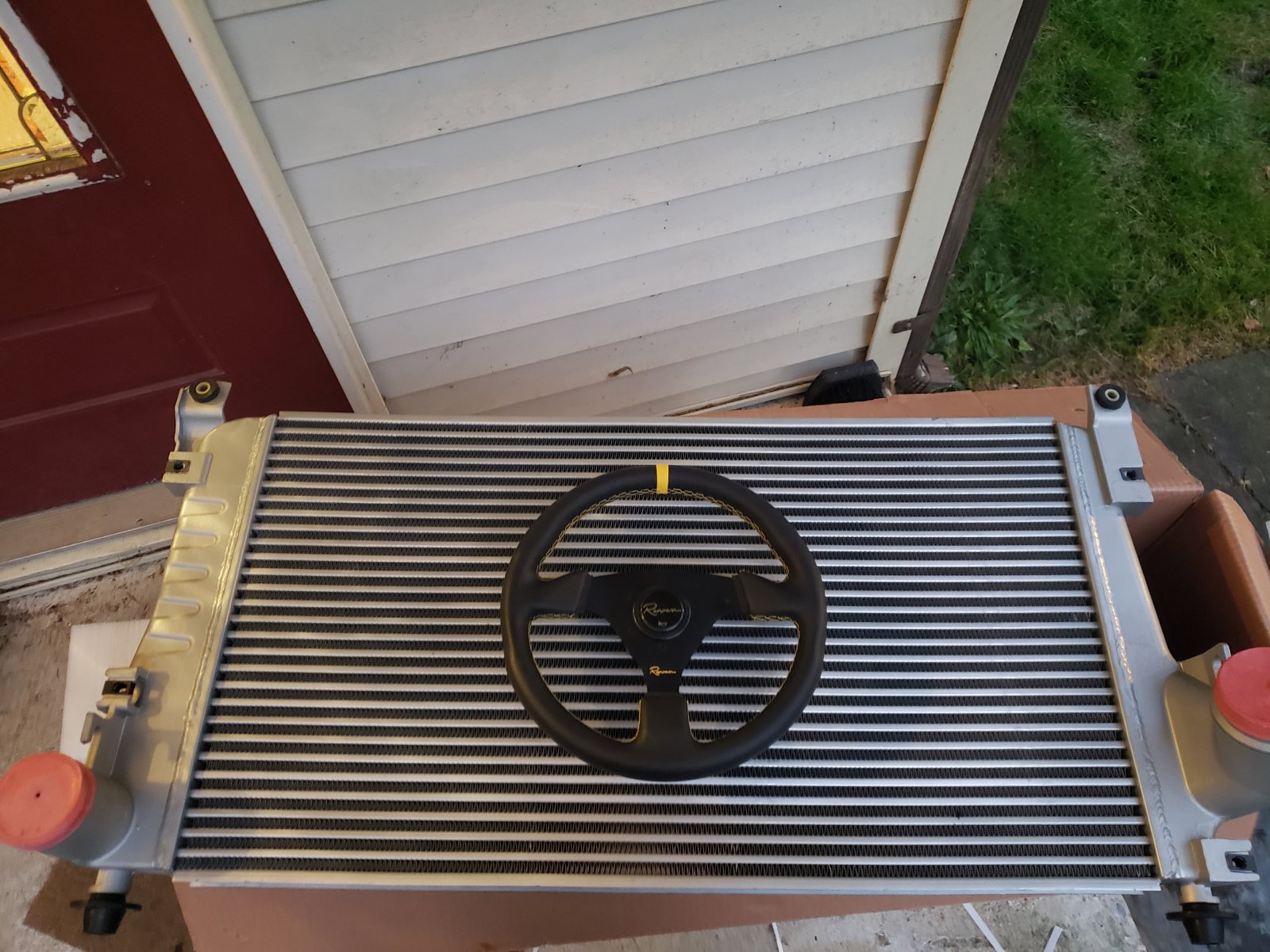

I'm also back on collecting parts for budget boost, having just snagged an intake manifold from a LK9 (B207R) equipped Saab 9-3 because I prefer the position of the throttle body on it compared to the LDK intake manifold from the Buick Regal. With some oil and coolant lines, tubing, and an air to air charge cooler, I should be able to turbo my car. I think that the stock Gen II L61 rotating assembly will survive the stock LNF turbo if I don't exceed the wastegate pressure.

I was planning on using that exact film to wrap my hood and engine cover, but after practicing on my hood with a cheap piece of ViViD, I got cold feet. Looks good!

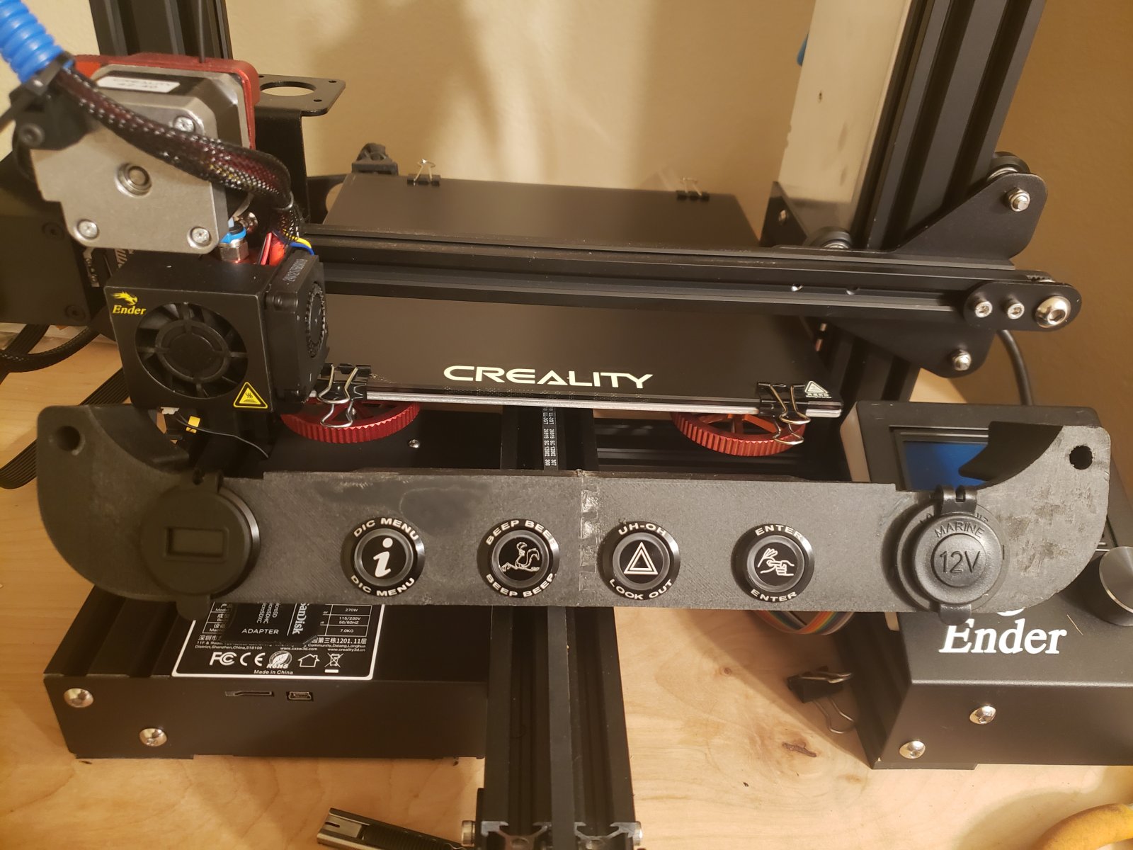

Printed a temporary switch panel because I didn't want to go to Metal Supermarkets to get my dashboard material.
