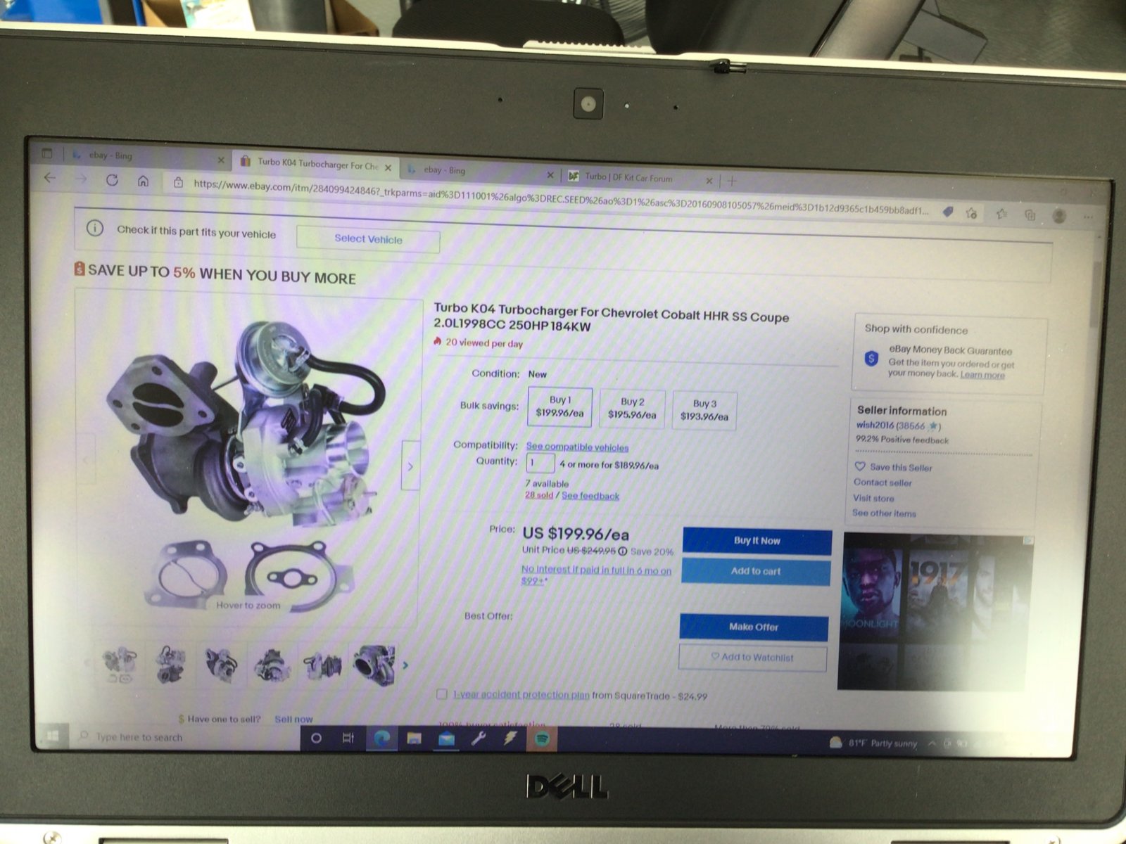

I still have the OEM PCM so might just buy a KO4 turbo and go back to original.
Ebay has them for 199.00 new but then I would need to get the lines to hook it up from somewhere
Oh hi! The clean turbo sold but the chunk one was mine and works great - have the lines and everything.
edit: Those are not legit Borg Warner turbos on ebay btw, from China.

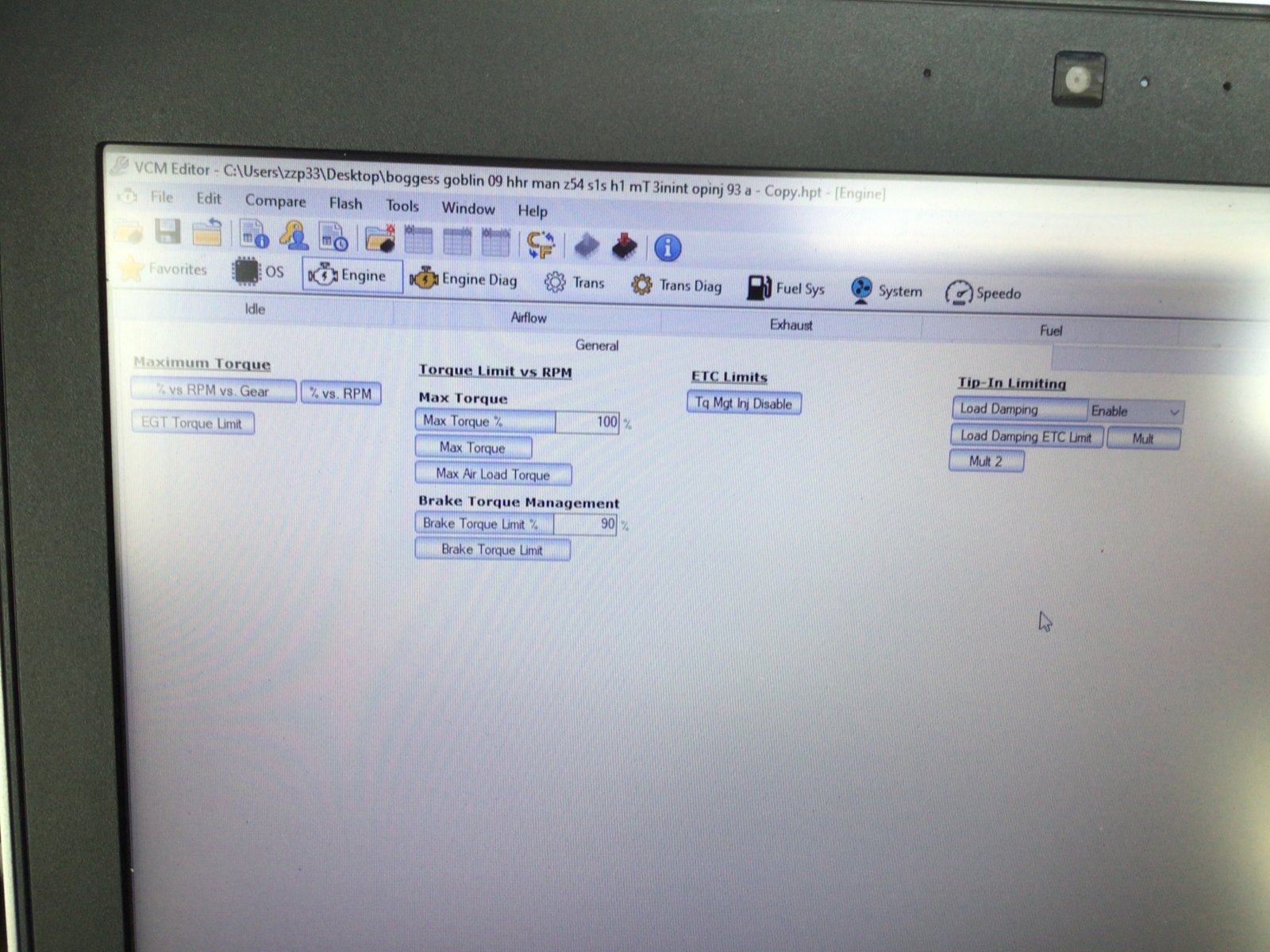

I figured out how to get to TM , And it’s set high , what do you recommend changing it to

Chad has been asking for the torque management to be set back to stock settings...
Post 10 and 23 of this thread have the tune with stock TM.
You can compare your tune to the stock TM settings, and copy over the tables you want.
Feel free to call me, we can set up a Zoom with me, and/or Chad, and walk you thru this.

Yes Chad just took over my computer and went in and changed stuff back to original, Thank you Ross and Chad my new best friend :)
